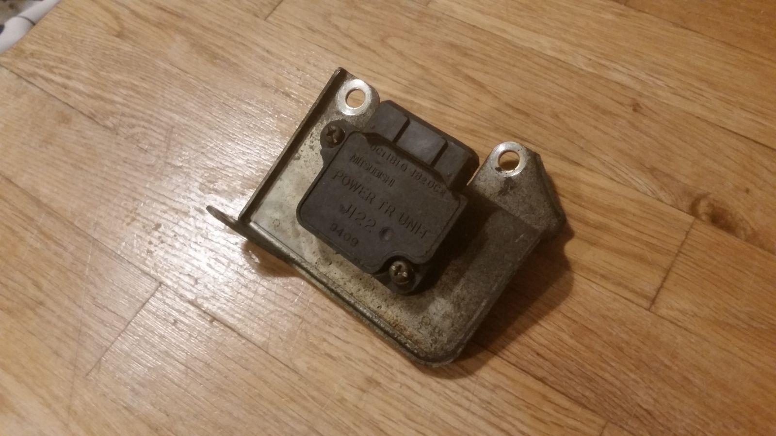

I assume when you first turn the ignition to on, you see the check engine light come on, then go off? If so the ECU is not totally dead. You have replaced the ignition coil, so that's not it. Did you check the transistor module? It bolts below the ignition coil down behind the timing belt enclosure. The ECU drives the ignition coil through this power transistor unit, and it is a common failure point.

You will be interested in page 8-74 of the above PDF. Make sure you have 12V at pin 3 of connector B-14 coming from the car. There might be a test procedure in volume 2 of the Factory Service Manual to test the transistor unit. I would look but mine is way out in the shop. Anyway, there is a thread on here about testing these as well:
BTW- Have you had the capacitors replaced in the ECU? If not they need to be. I can't see any obvious corrosion in the photo. I may have some of those transistor modules in my parts stash if you confirm yours is bad.
