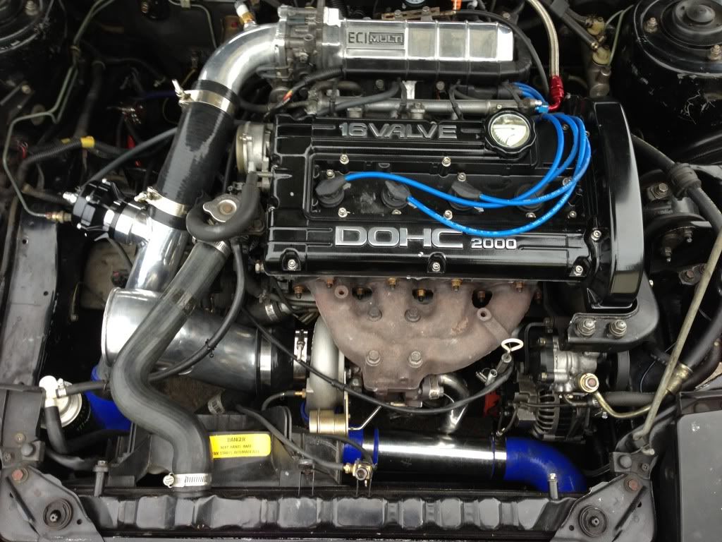

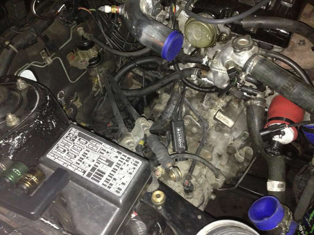

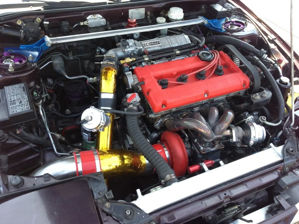

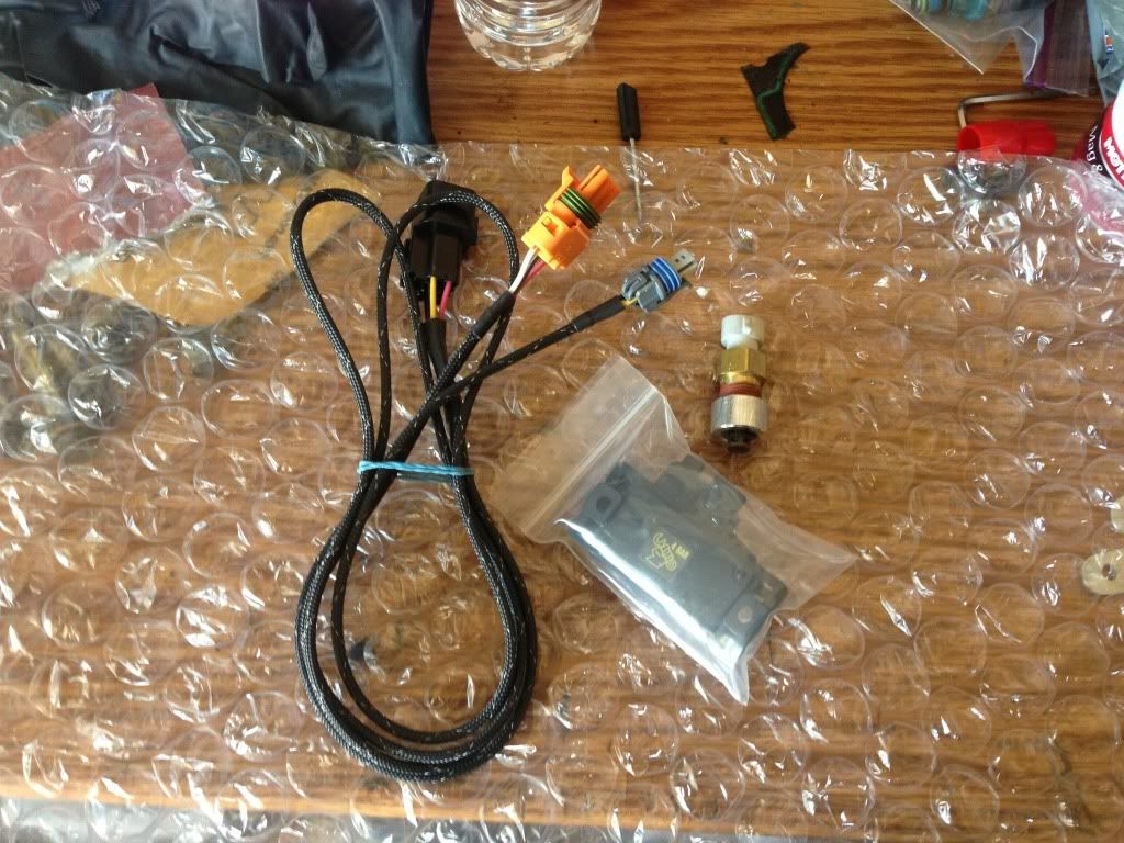

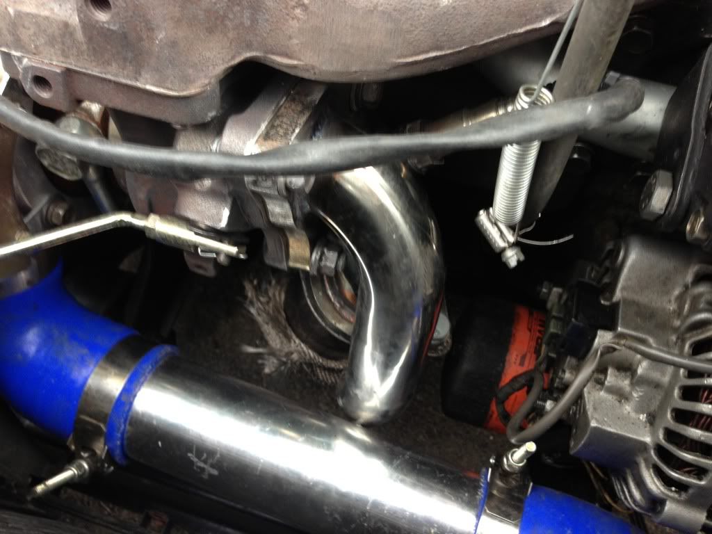

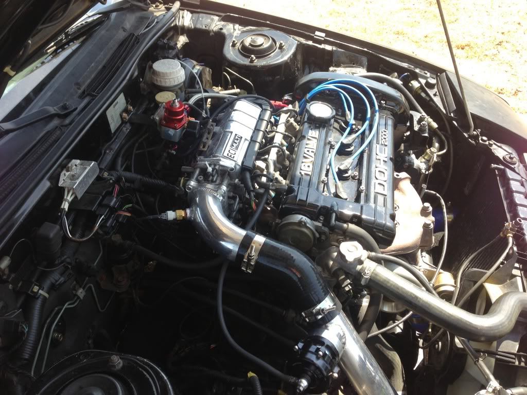

Great update guys! :thumb: I finally received my speed density kit! I couldn't wait to get it all installed. So I started by screwing in the IAT sensor into the upper intercooler pipe. I then installed the 4 bar MAP sensor. It is in a very convenient spot. I also got a black 45 degree coupler to get rid of that horrid blue coupler. :hellyeah: After installed everything I went ahead and started boost leak testing. I had no major leaks. I tested at 25 PSI. My throttle body shaft seals and gaskets held great. I did have a small leak from where the FIAV plate goes. I sealed it up with a small amount of RTV. After I got rid of most boost leaks I went ahead and changed my settings in link and decided to go ahead and try a startup. When I started it it kicked on pretty easily. It went much better than I expected. Idle was a little high but I'm sure I just need to work out some of the kinks. I did also start on the fuel pump and just waiting for a sender gasket to go ahead and finish the job. Here is a video of first startup and some pics! Enjoy! :thumb:

Have you given any thought into painting/coating or swapping out the stock exhaust manifold? The rest of the bay is getting clean and it's starting to become an eyesore LOL
Oh yes of course! I originally wanted to get an FP manifold, but my current budget won't allow it. For the sake of my sanity I'm just gonna leave it for now. Then whenever I decide to go to a different turbo ill probably just ditch the whole setup and get all new parts!

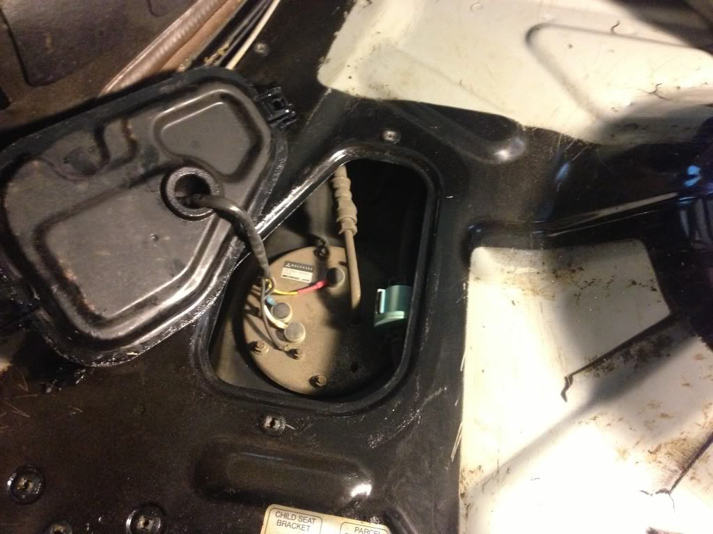

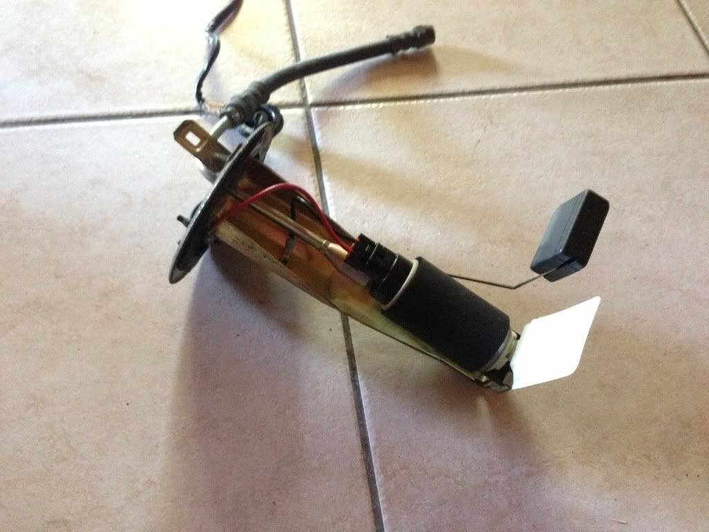

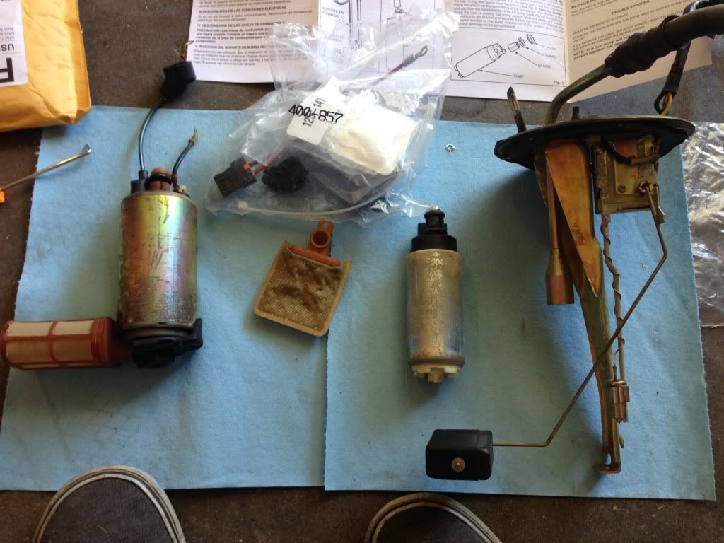

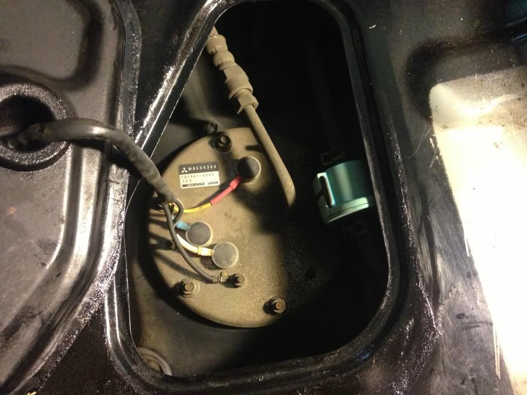

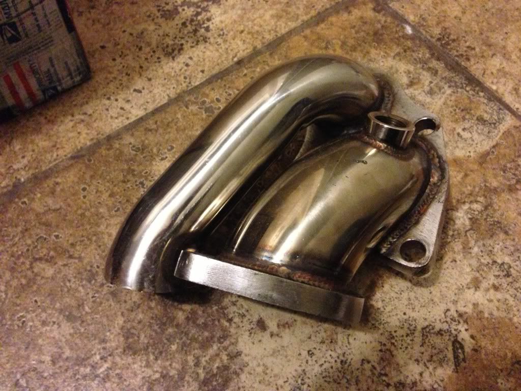

Well guys. I finally got around to installing my fuel pump and o2 housing. The install of the o2 was pretty straight forward. The fitment was a little bit of an issue. I am going to get a set of slim fans and have to clock the turbo to get the lower intercooler pipe away from the o2 housing. I then went onto the fuel pump. Everything was going smooth until the stud on the sender where the Walbro power wire goes onto broke. So I had to grind off all of the plastic that holds it to the sender and add a rubber grommet with a new stud. It works well and does not leak but sometimes the power wire will disconnect from the sender. So to remedy this I am going to just run a solid wire through the sender to the pump and remove the stud and seal it up. After the install I took the car out for a spin and a bunch of stuff just decided to take a crap. I was stuck in open loop and was throwing CEL # 0012. Also had a problem with my boost gauge not reading. I gave up for the night and sat on it for a day. Yesterday I decided to start tackling problems one by one. I started the car and it was in closed loop and not throwing the CEL anymore. Maybe the car just needed a nights rest to soak in the new parts, but nonetheless it was running. I now need to rewire the fuel pump and start dialing in everything. I do need to purchase a new boost gauge before I start anything. Here are some pics of how the weekend went.

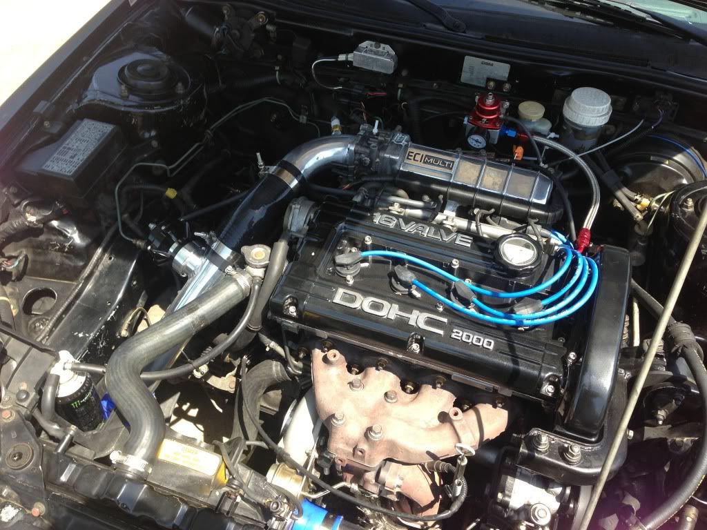

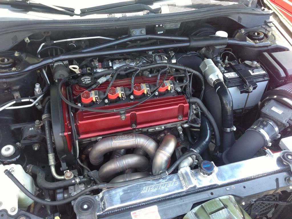

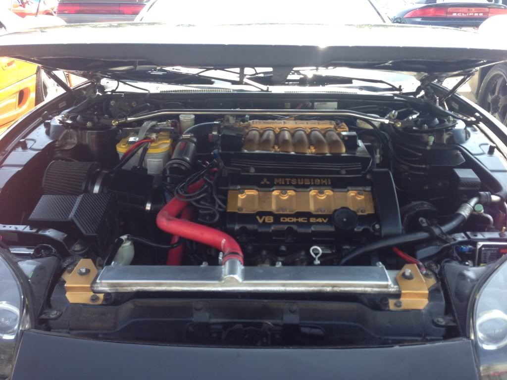

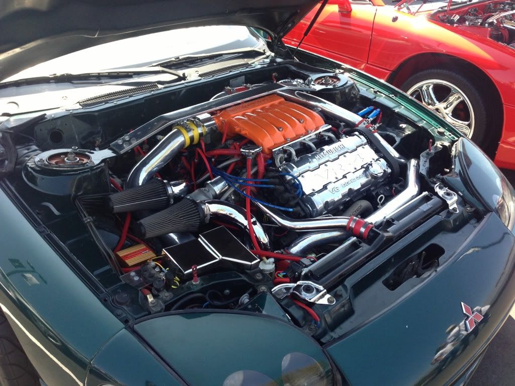

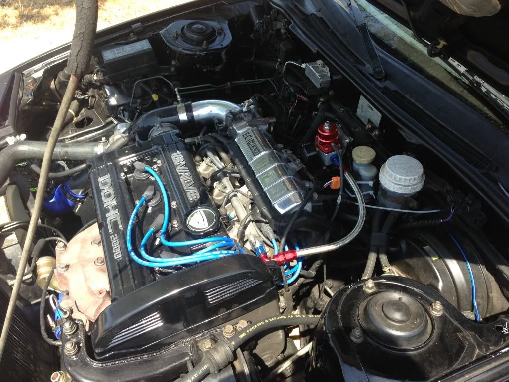

Heres an updated picture of my engine bay.

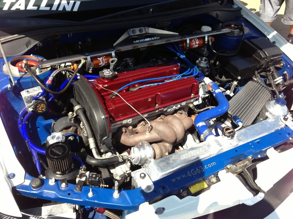

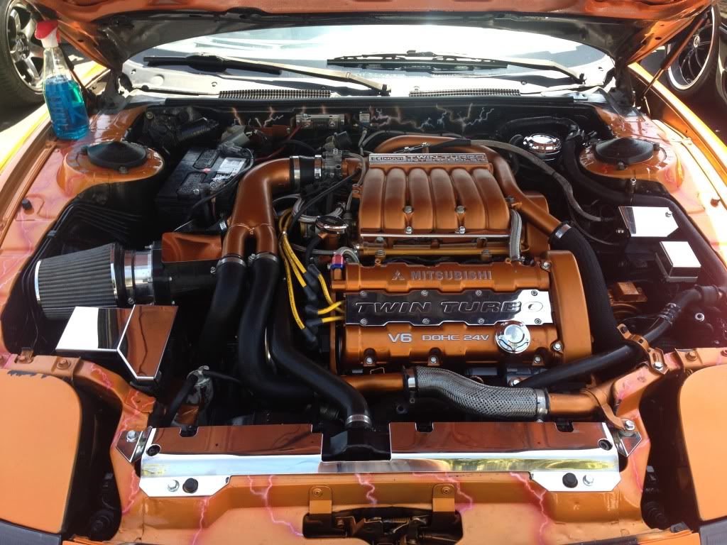

MOD 2013

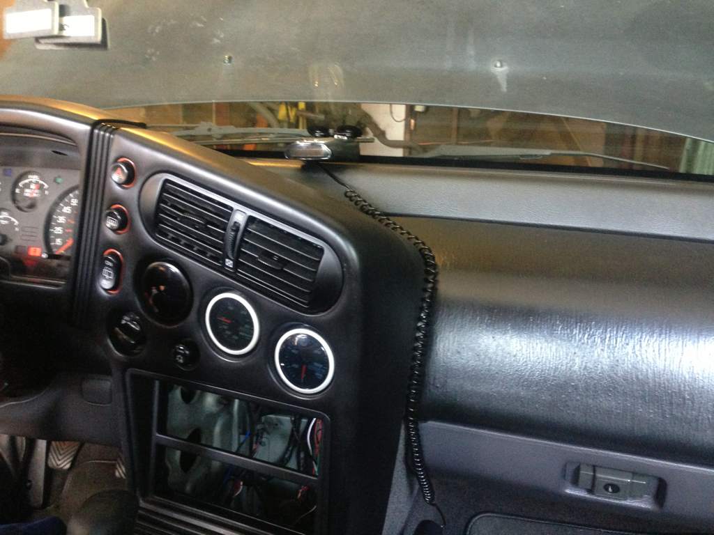

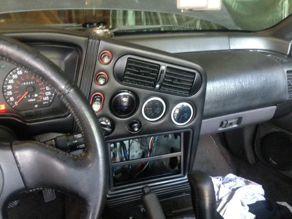

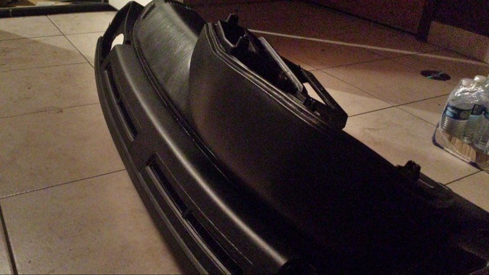

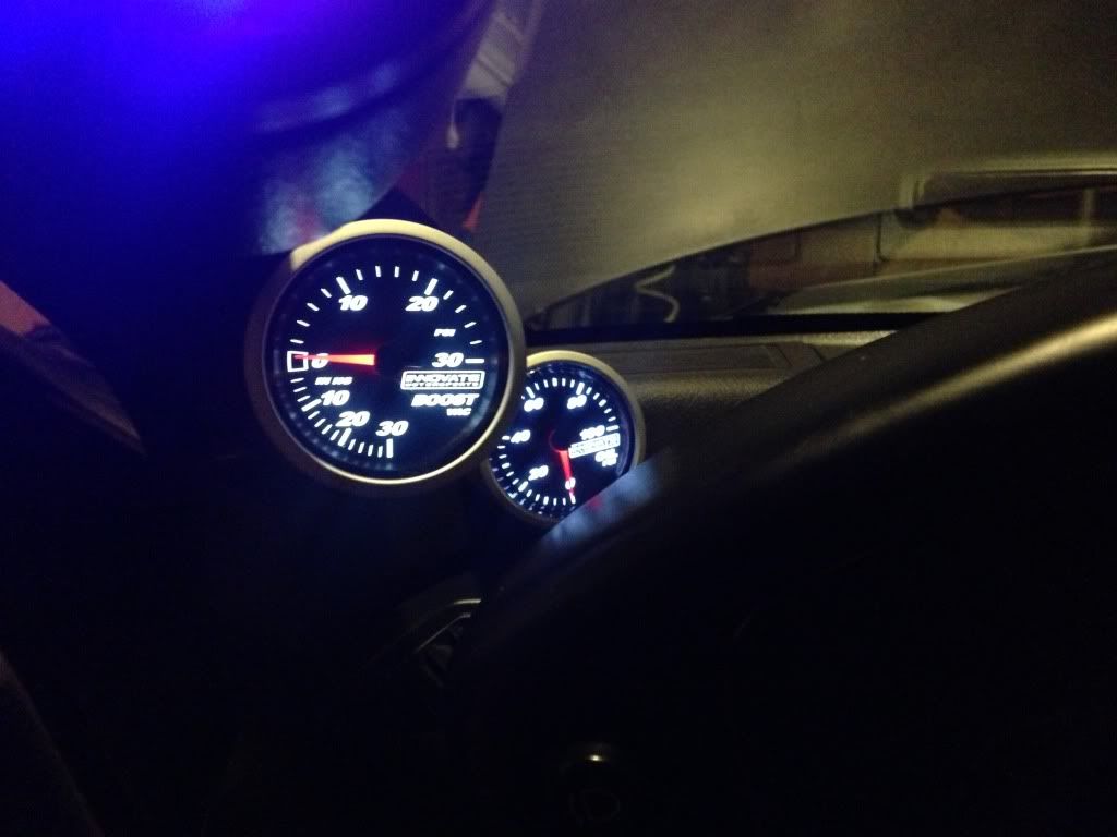

Not very much has been going on with the talon. I decided to shed some more weight from the car. I am experiencing some slipping of the clutch under hard acceleration. I figured this would eventually start to happen. I am in the process of saving for a new clutch kit. I finally got rid of my old bleed style boost controller and grabbed a hallman pro rx! I also decided to remove my gauges from the A pilar since it draws a lot of unwanted attention. They have been moved to the center console where the ac controls used to be. Here's some pics.

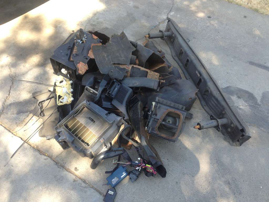

Big pile of clutter! Dropped weight to 2770 lbs. Not too bad! Removing the dash was a major PITA!! Don't wanna do that again!
Here's some shots of the gauge setup. Also blacked out the dash for fun. Looks pretty nice.
Is just me or there is a problem with the pictures? I just see a photbucket logo.
interested to see those gauges.
You really think it draws that much of attention, is something that can be dangerous? I ask because my plan is to use that same spot.

Sorry about the photo bucket link! I have no idea why it's doing it. I tried uploading the photos via tapatalk. Hopefully they work! I did not like the attention from police when I would drive the car at night. I do like them a lot better in the center console!
those gauges looks awesome there! i still want to have AC.
Some dsmer's put the ac controls under the radio.

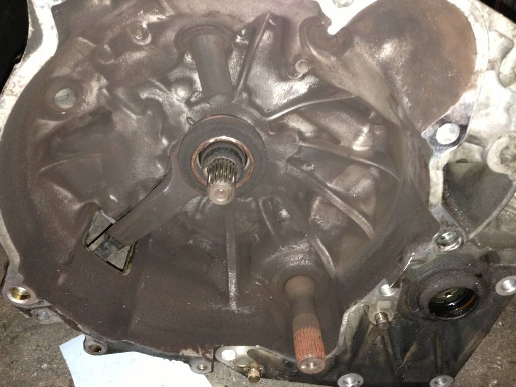

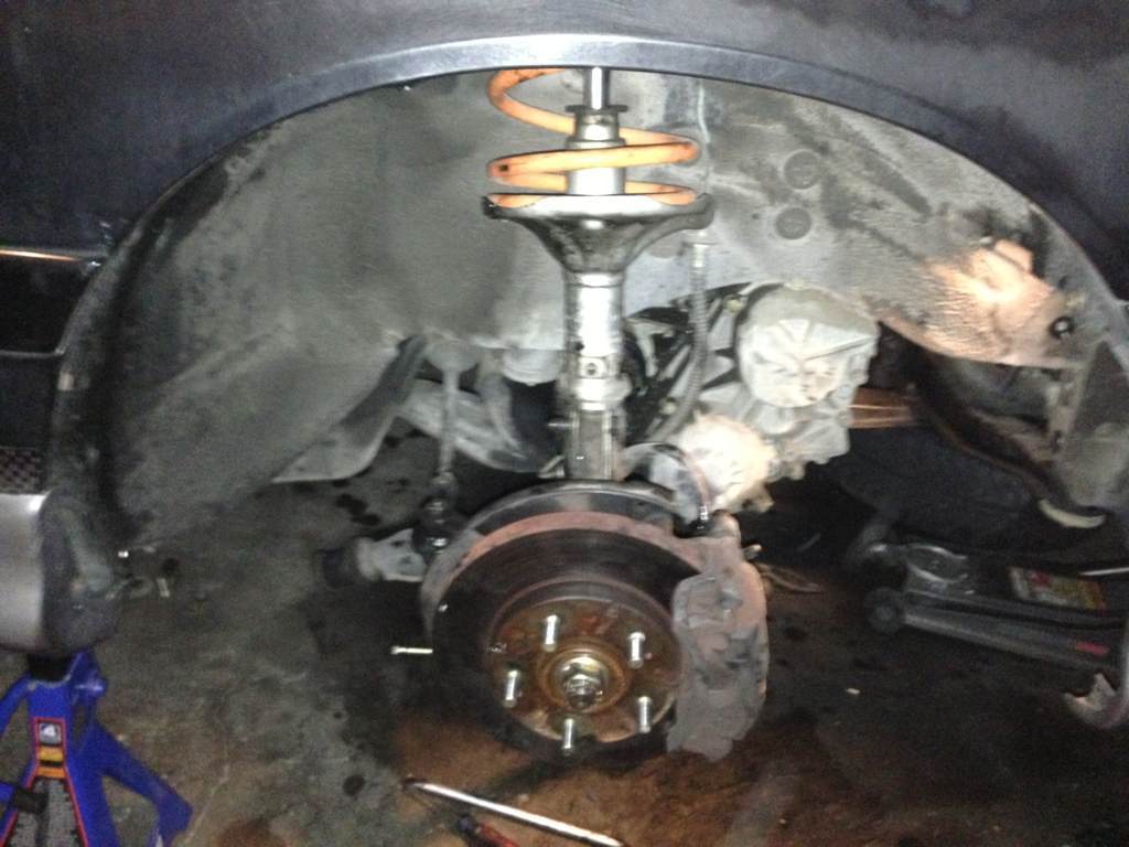

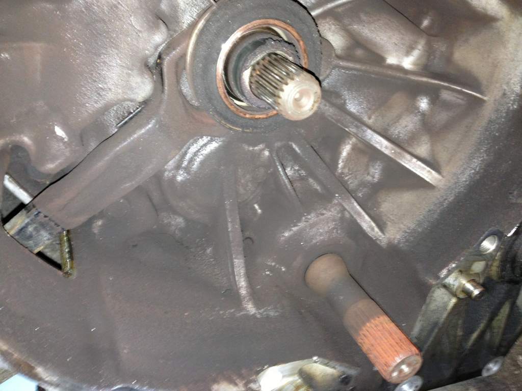

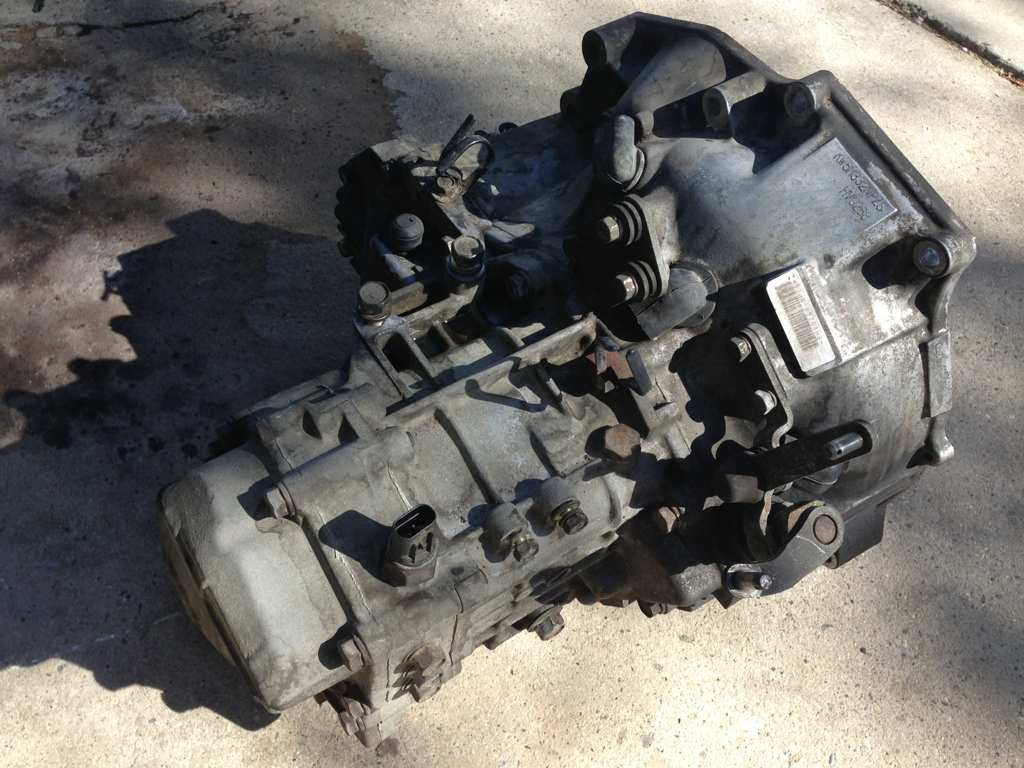

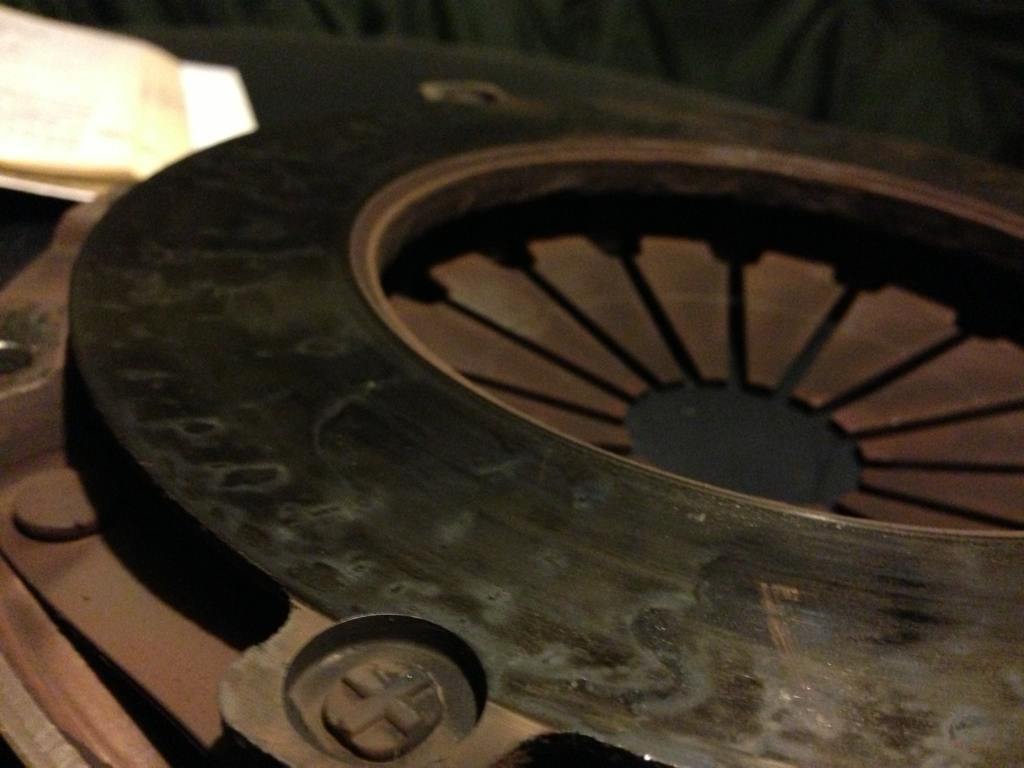

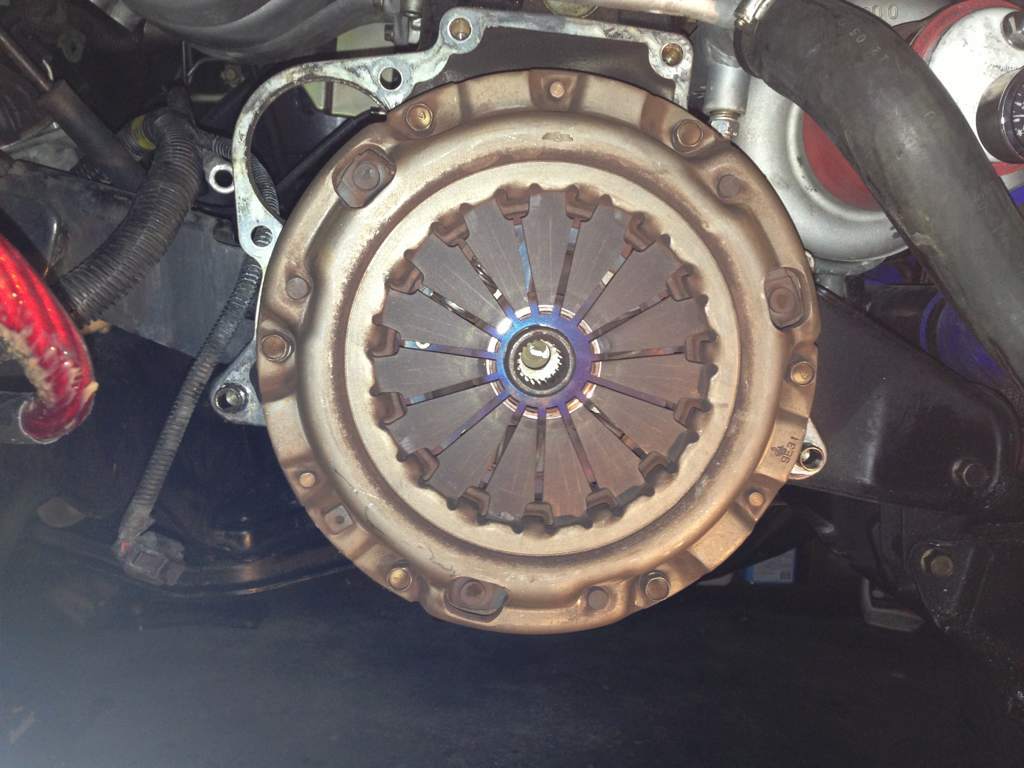

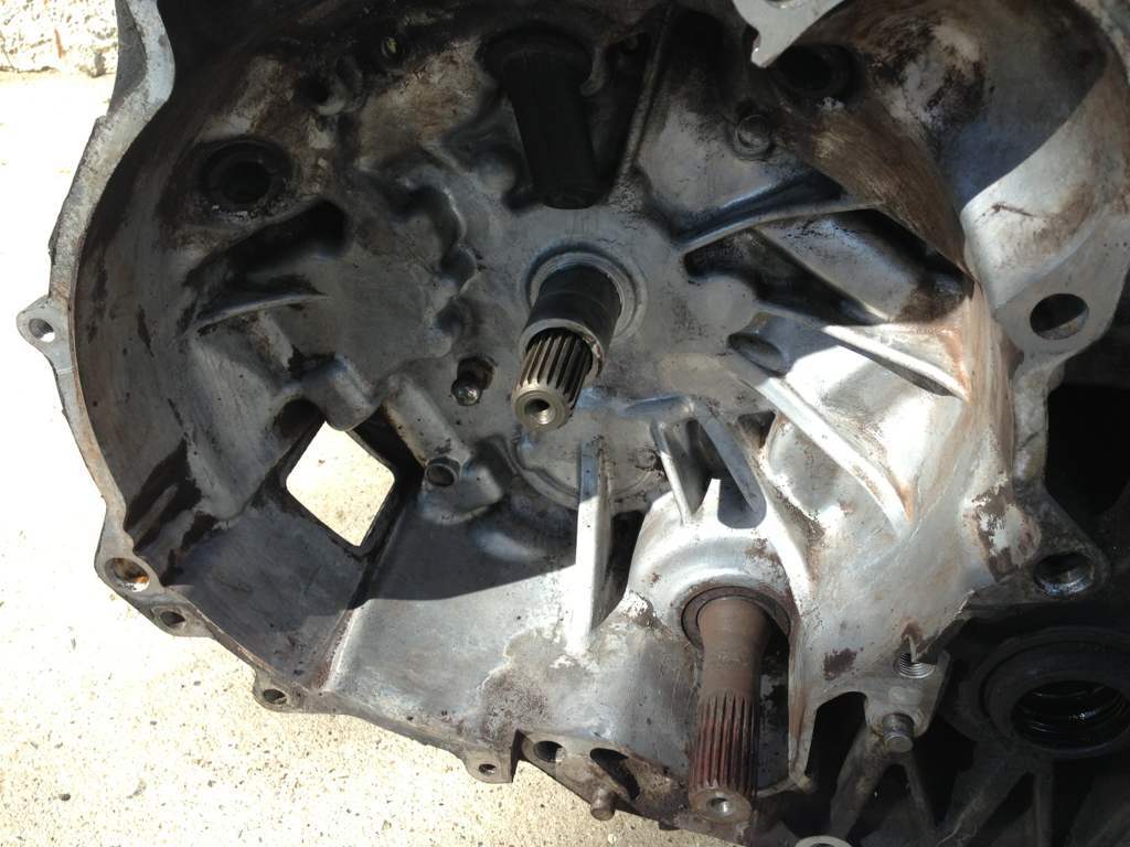

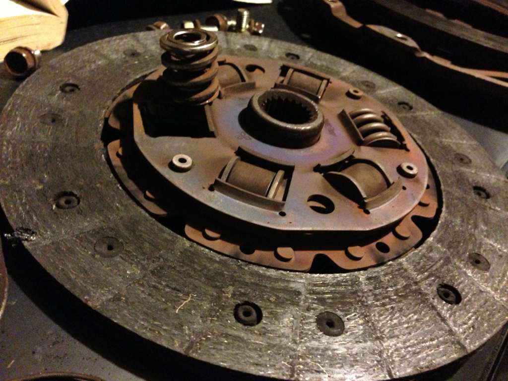

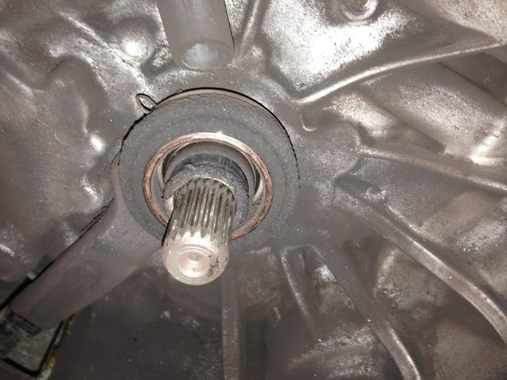

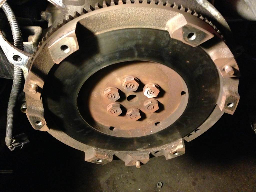

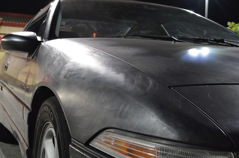

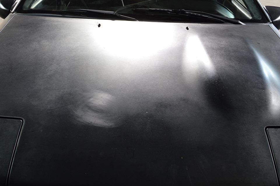

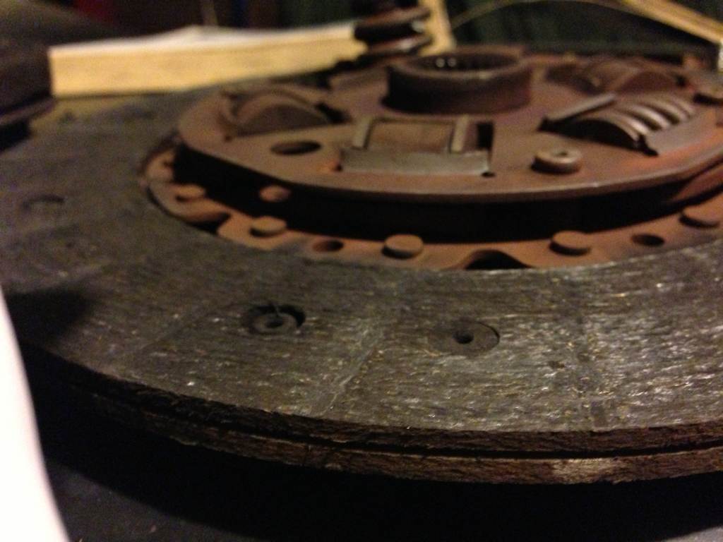

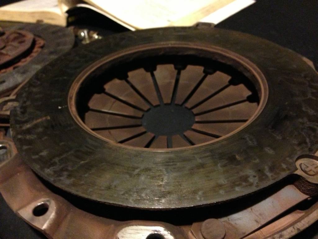

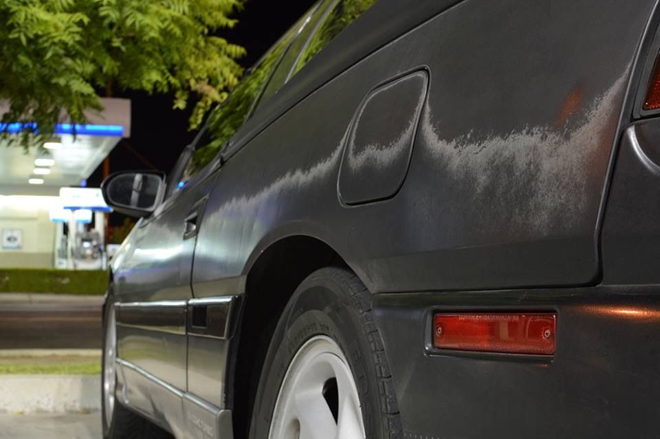

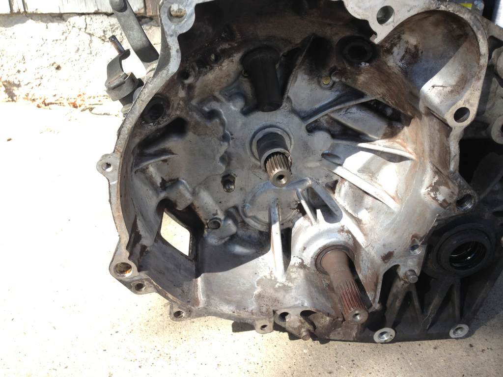

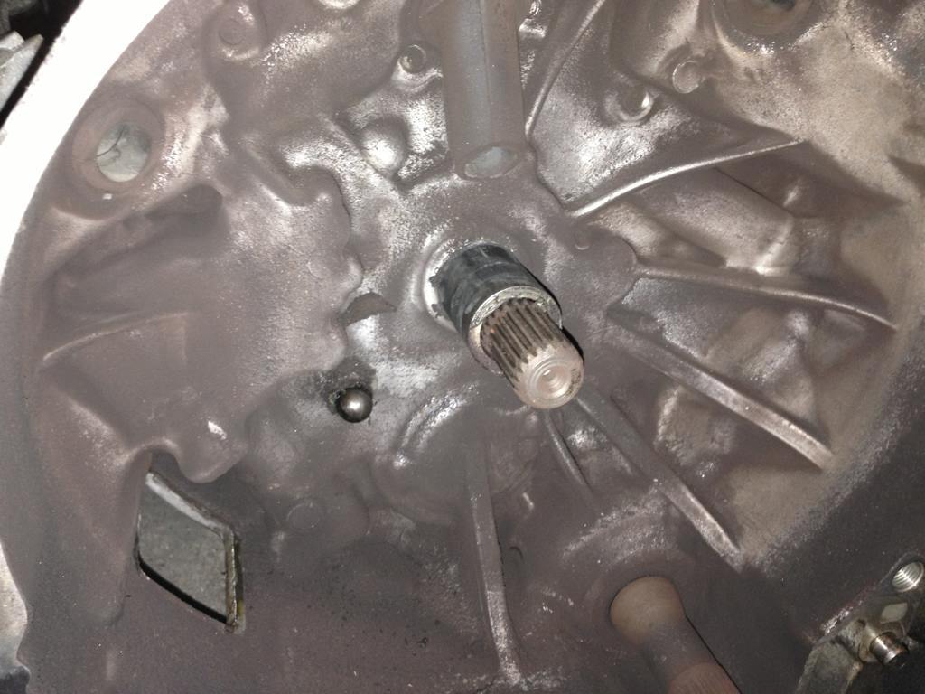

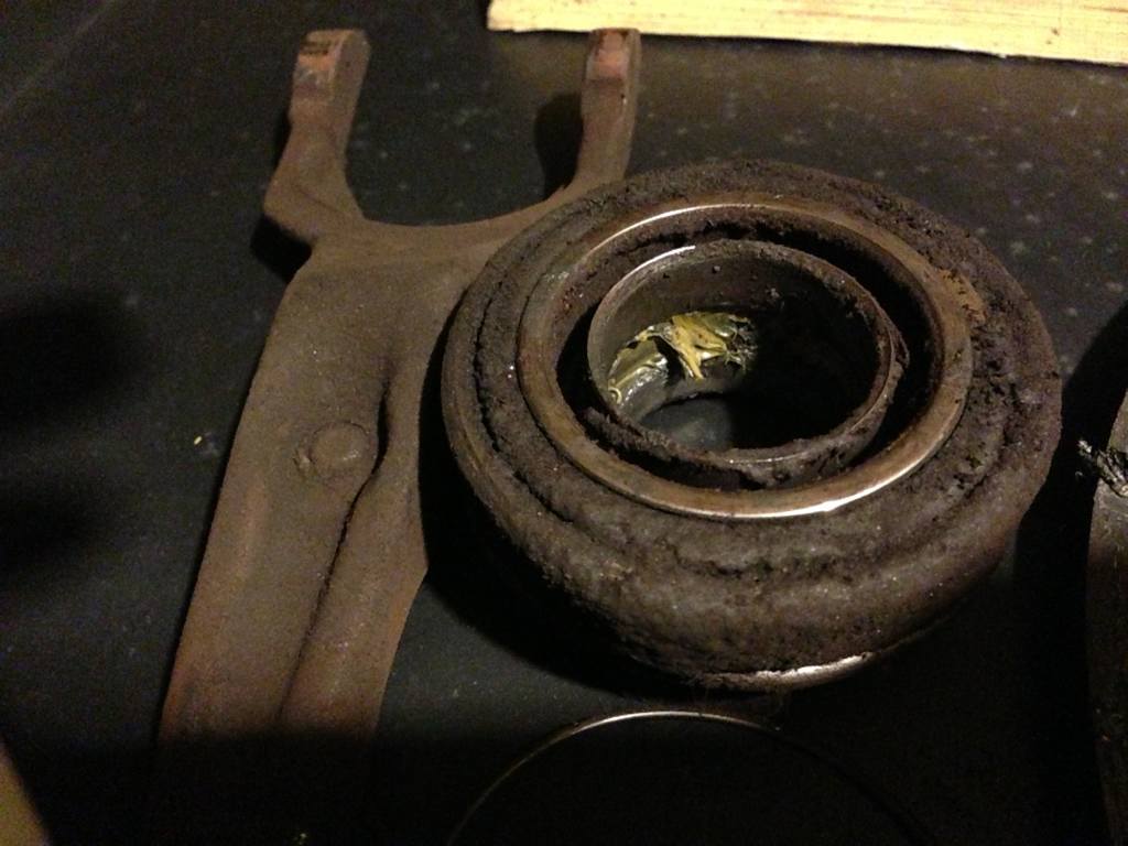

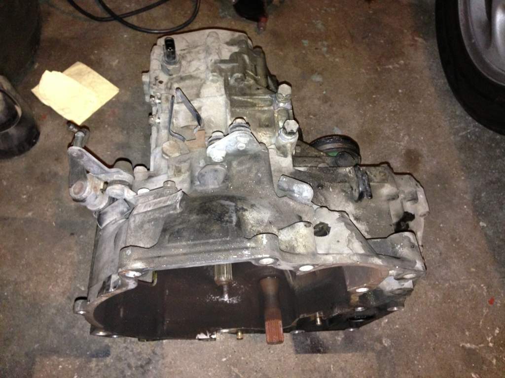

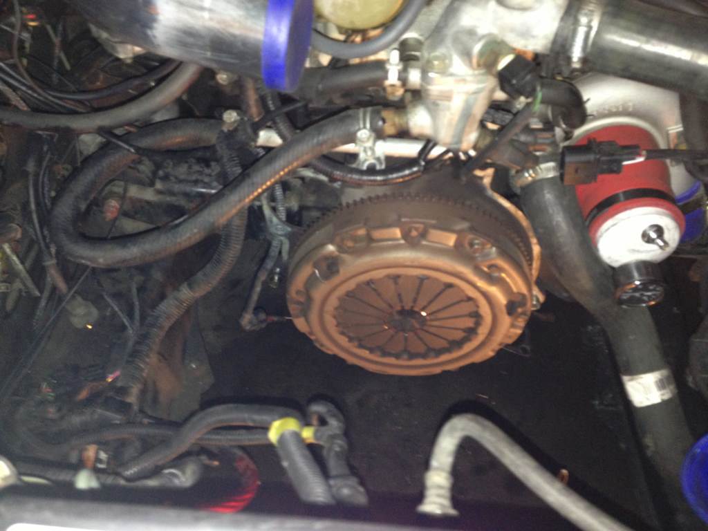

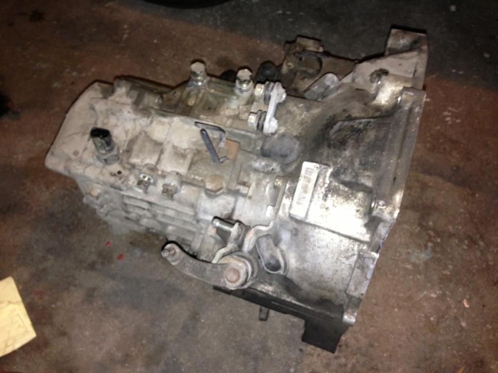

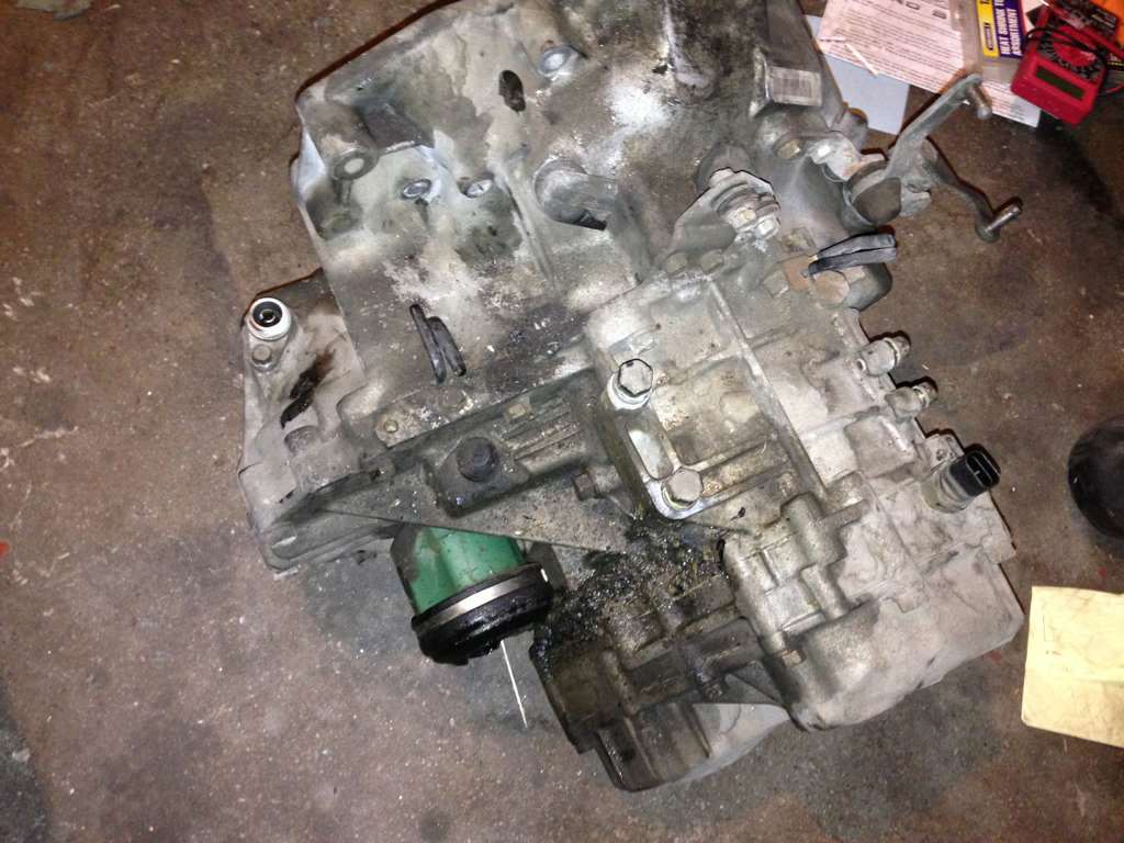

Well guys! Got some professional grade pictures of my car about 2 weeks ago. I wanted to get these pictures taken to show how my car looked in detail before I got the paint job done. I was scheduled to paint it on the 7th of September but I decided to replace my clutch. So I rescheduled towards the end of September. I didn't want to drop the tranny and do some heavy work around the fresh paint. So I'm currently doing the clutch job right now. My clutch got to the point where it would slip in almost every gear. I could be in 5th and go wot at 3000 rpms and it would slip. So I basically purchased a whole new setup. I decided to go with a fidanza 8lb flywheel. I didn't have the funds to throw towards a nice quality setup so I settled for an xtd stage 4 pressure plate with their 6 puck disk. I also purchased all new hardware with a new fork and pivot ball. Here are some pictures.
