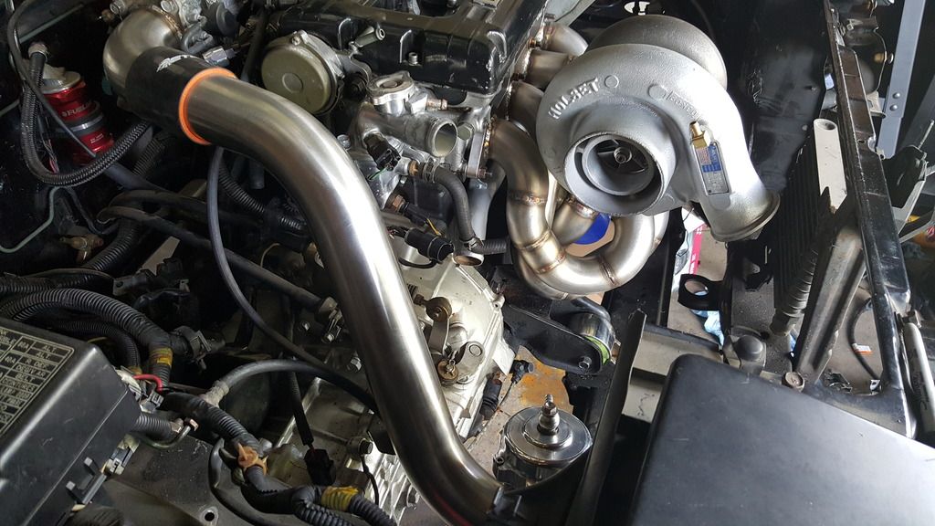

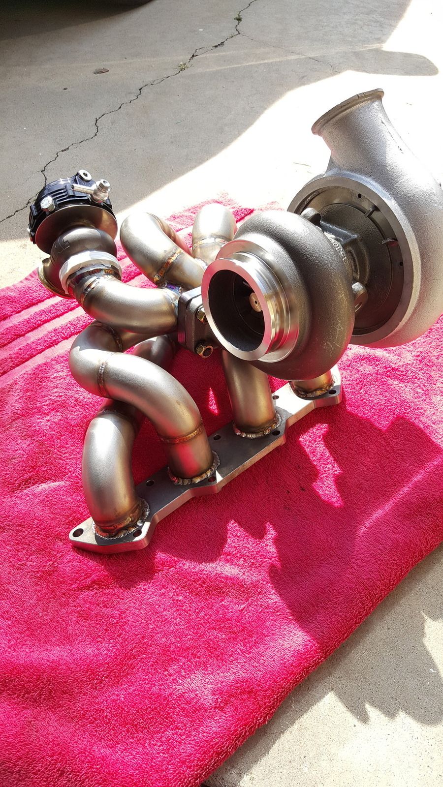

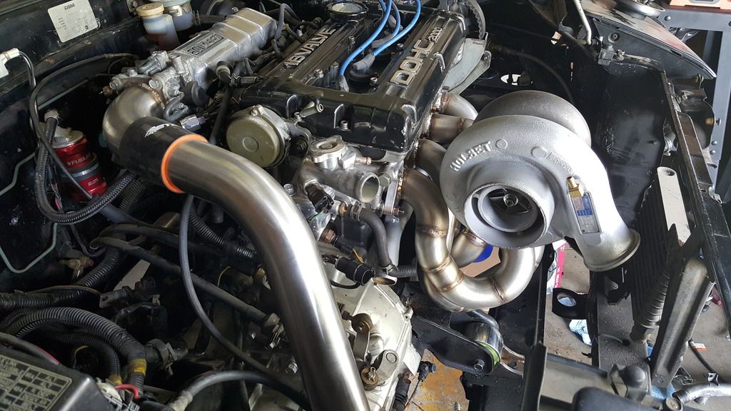

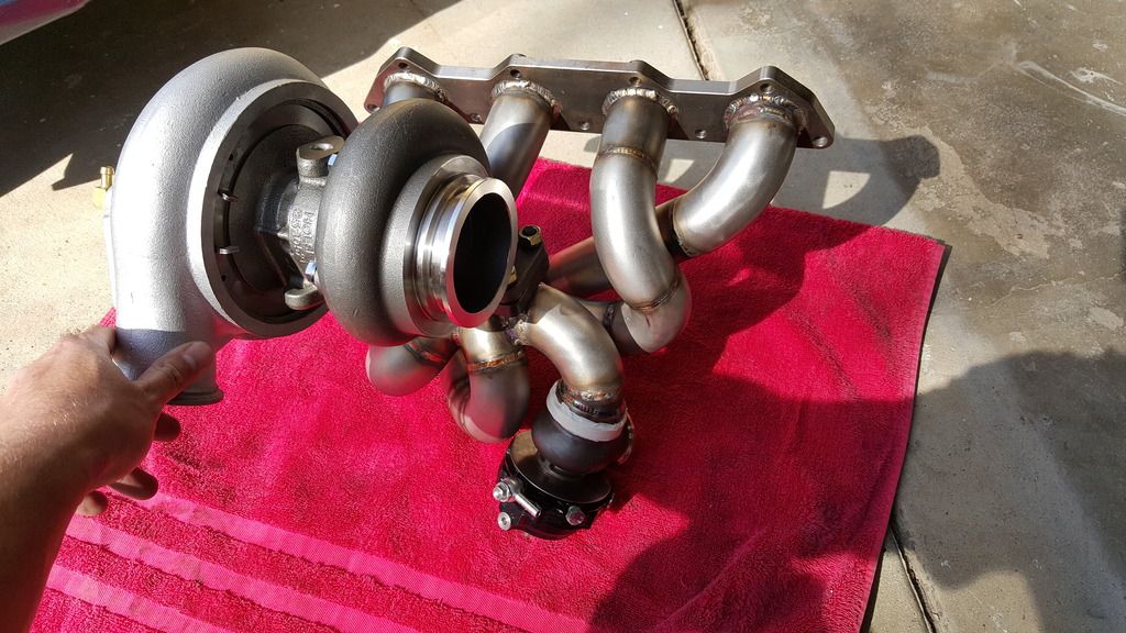

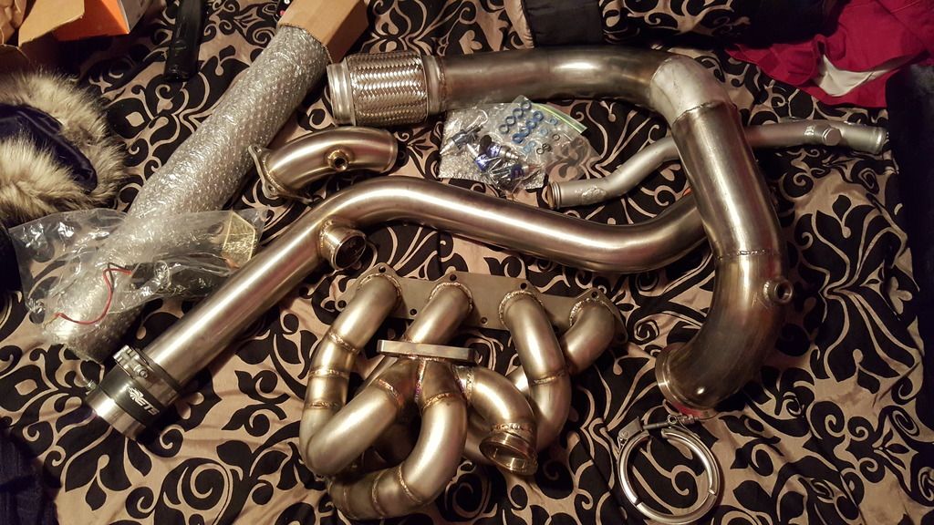

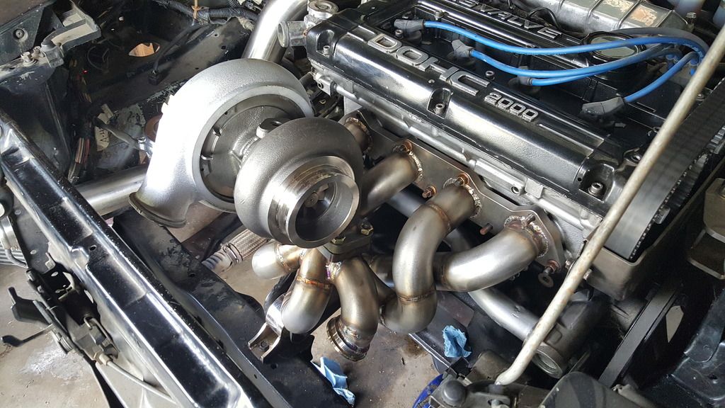

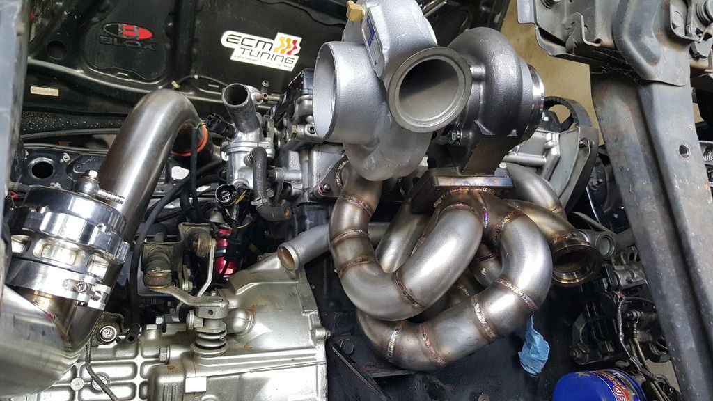

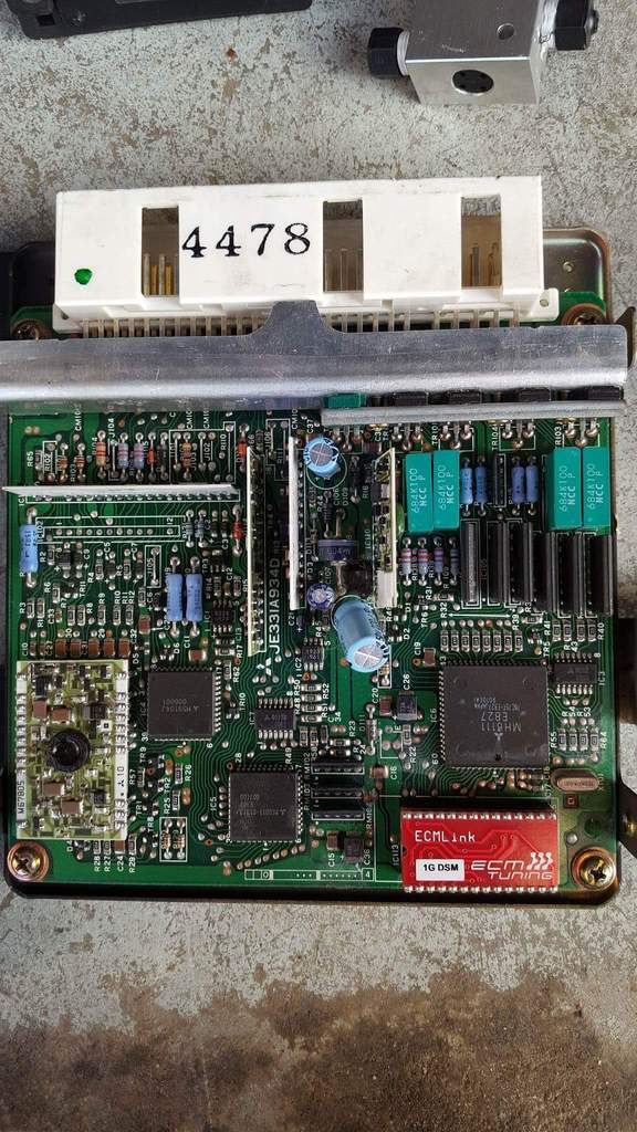

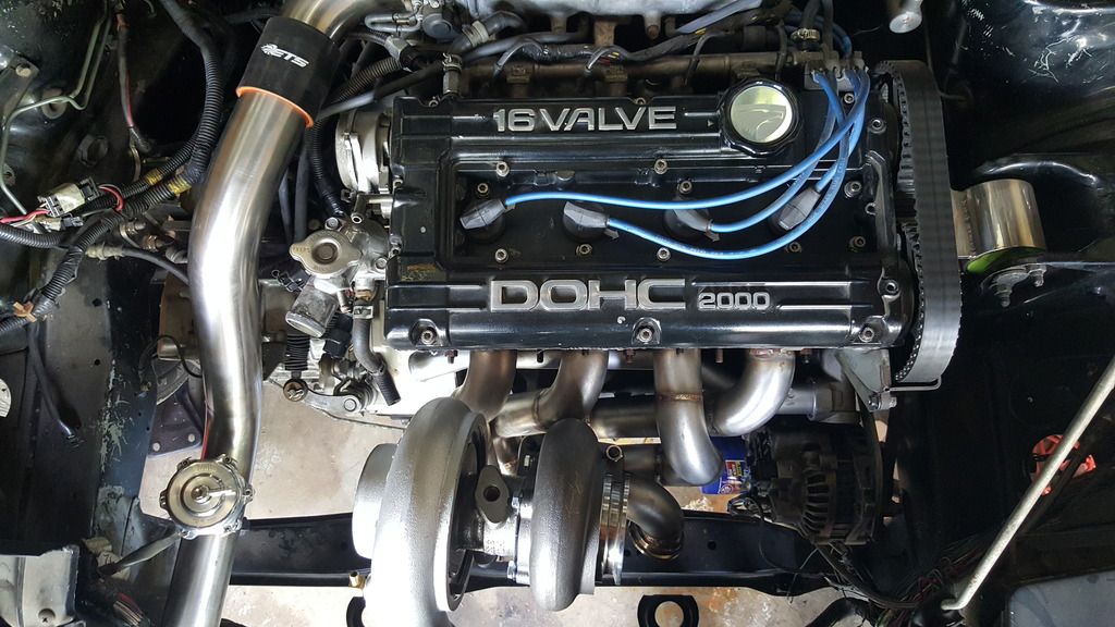

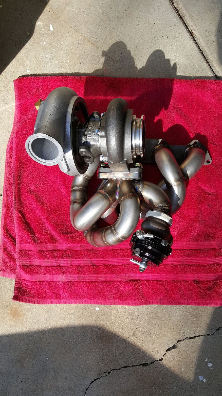

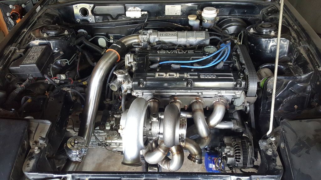

Can't believe it's been over a year since I've posted any kind of update on the talon. During that time is done alot of sitting. Recently I finally started purchasing some parts and got some sweet deals from my buddy pewpewlasers. The goals have changed again. I originally was gonna go with an hx40 with a dsm bep housing. Then I got an opportunity to get another setup. I got a true street performance manifold that will house a holset hx40 super. I will be running 1450cc injectors with a 255 walbro double pumper tuned on link. I still have quite a few parts to have fabbed up. I seriously will do my best to keep the thread up to date within the next couple of months. My goal is to have it done and ready for Racewors 2016 in Sacramento. Here's some pictures of the progress.
Awesome thread. I have a 90 and wish it was as clean as this. Great build and the detail is beyond the norm. Kudos!!

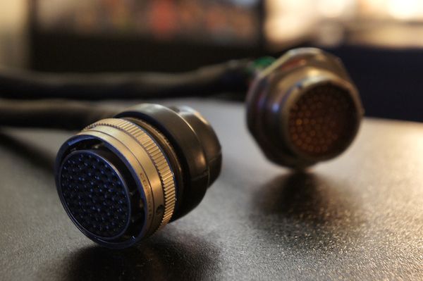

In case anyone is looking for answers, the quoted post below is a photo of a cannon plug (foreground) and jack (background). They are indeed milspec and aviation uses them extensively. They are quite costly and most of the pins are 22-18 gauge on alot of the ones you find. They have 14 and 12 and even coax for radios and such but it's over kill for all but the highest of vibration environments. I rewired my other project, a 1983 v8 Ford Ranger and used GM weather pack connections. The GM style enables you to use a 24 pin (I think it's 24 pins) bulkhead connector held together with a 1/4 inch bolt. It's the best I have found for affordable and secure custom automotive wiring. PM me any questions you may have about it if you're interested.
If I Pulled my Harness again and did it over I would just add in one thing
THIS ^
I'd Just Run it all threw the Stock place in the Firewall it will be much easier in the End Trust me.
Looking good though you are on the right track. :thumb:
