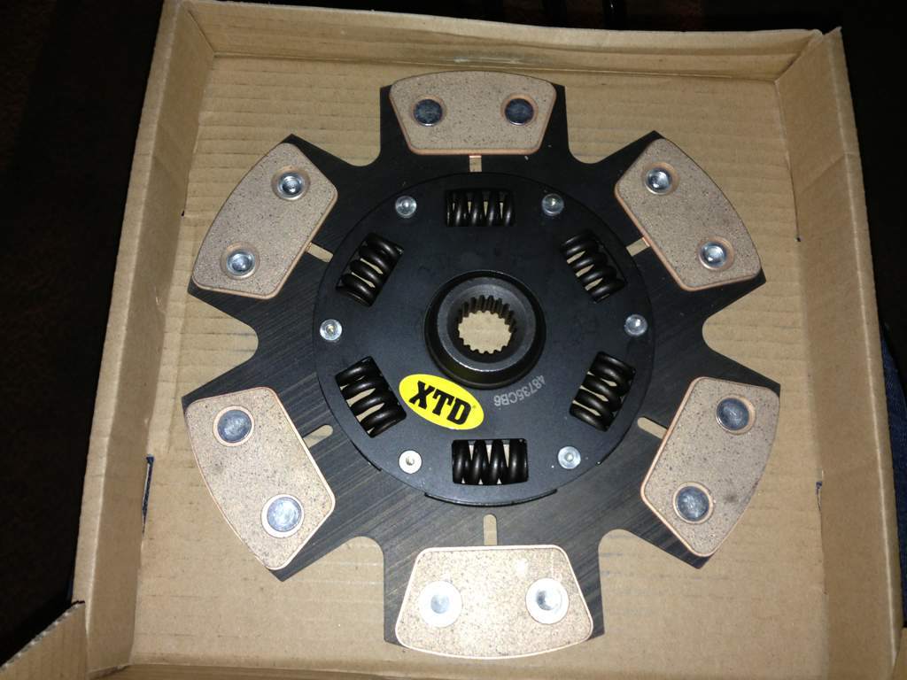

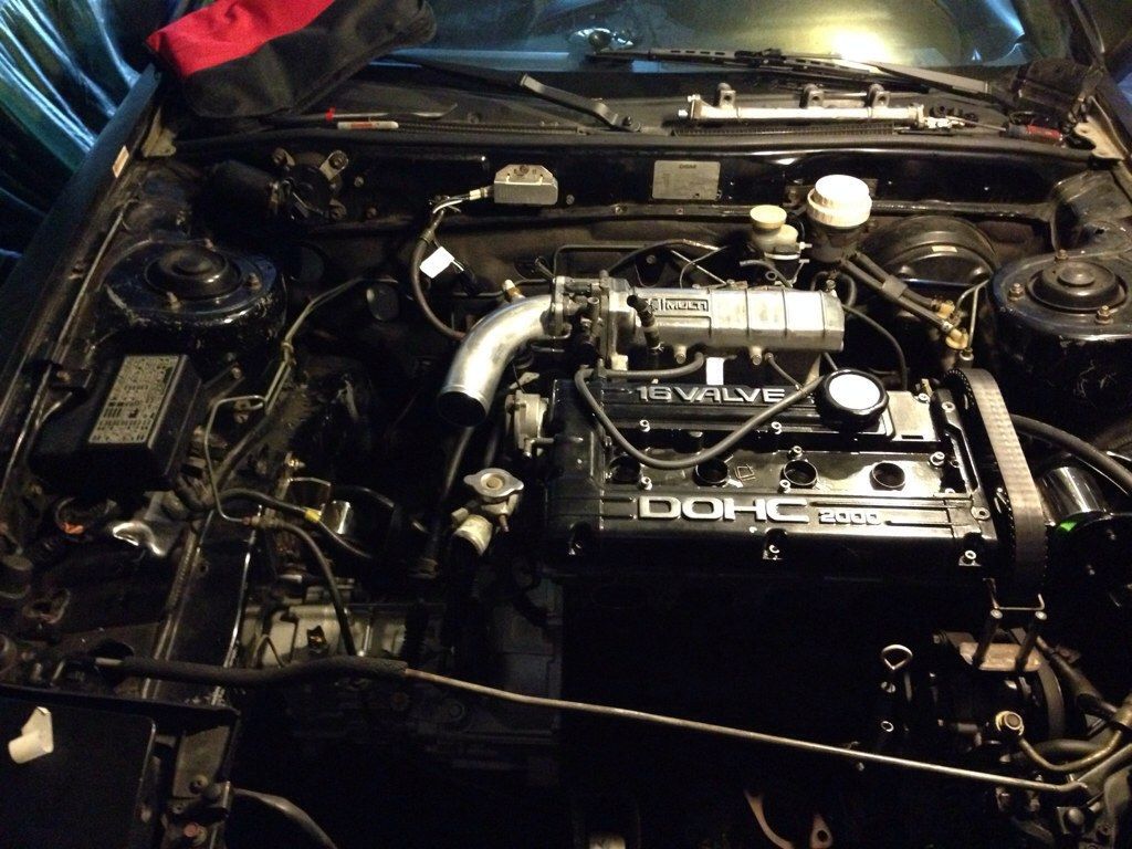

Some parts arrived last night! Please save the criticism for another build thread. I chose this setup due to being the only one I could afford at this particular time.

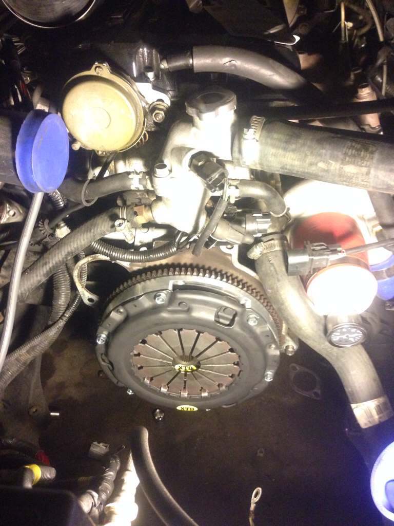

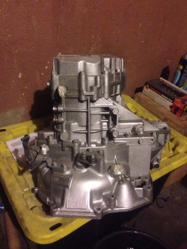

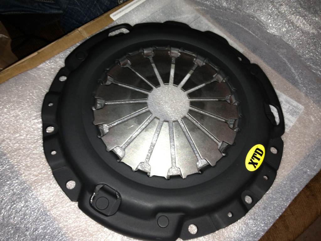

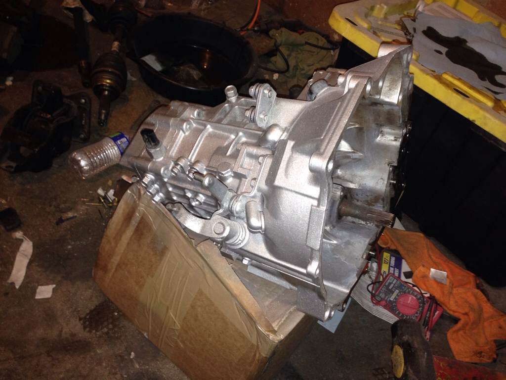

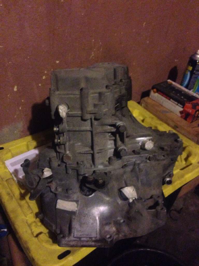

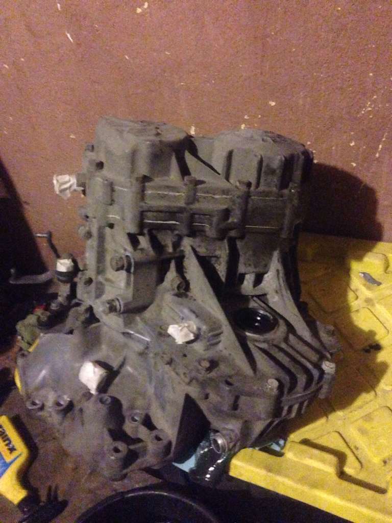

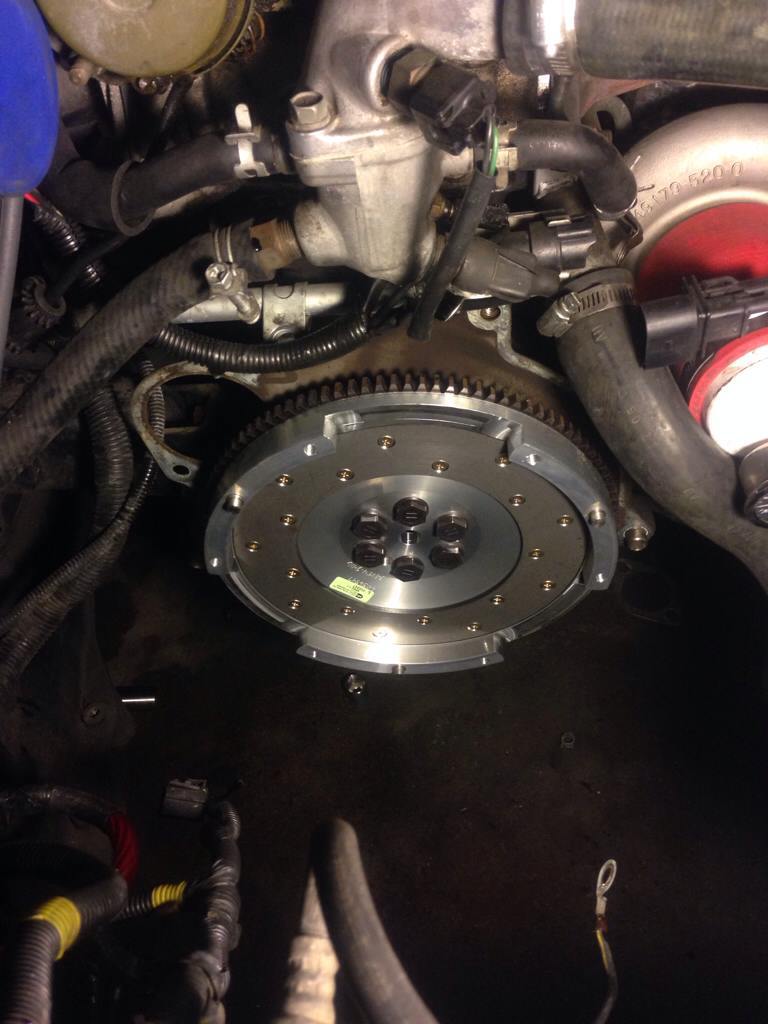

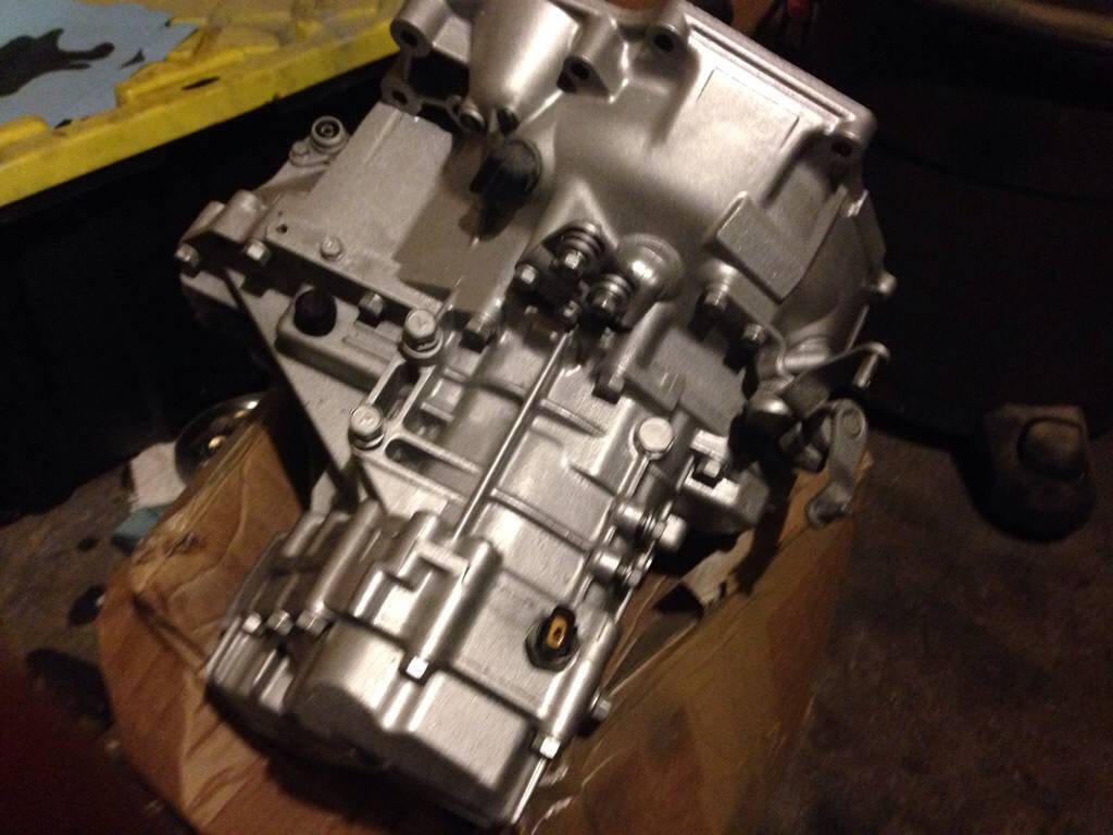

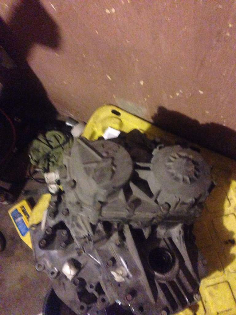

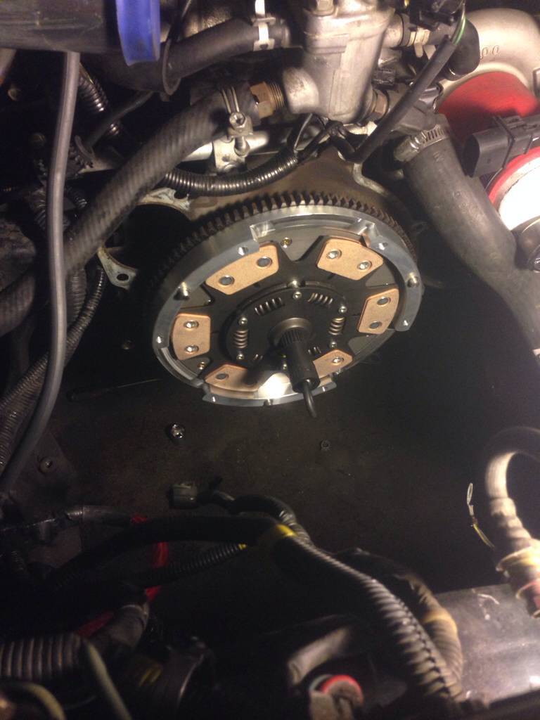

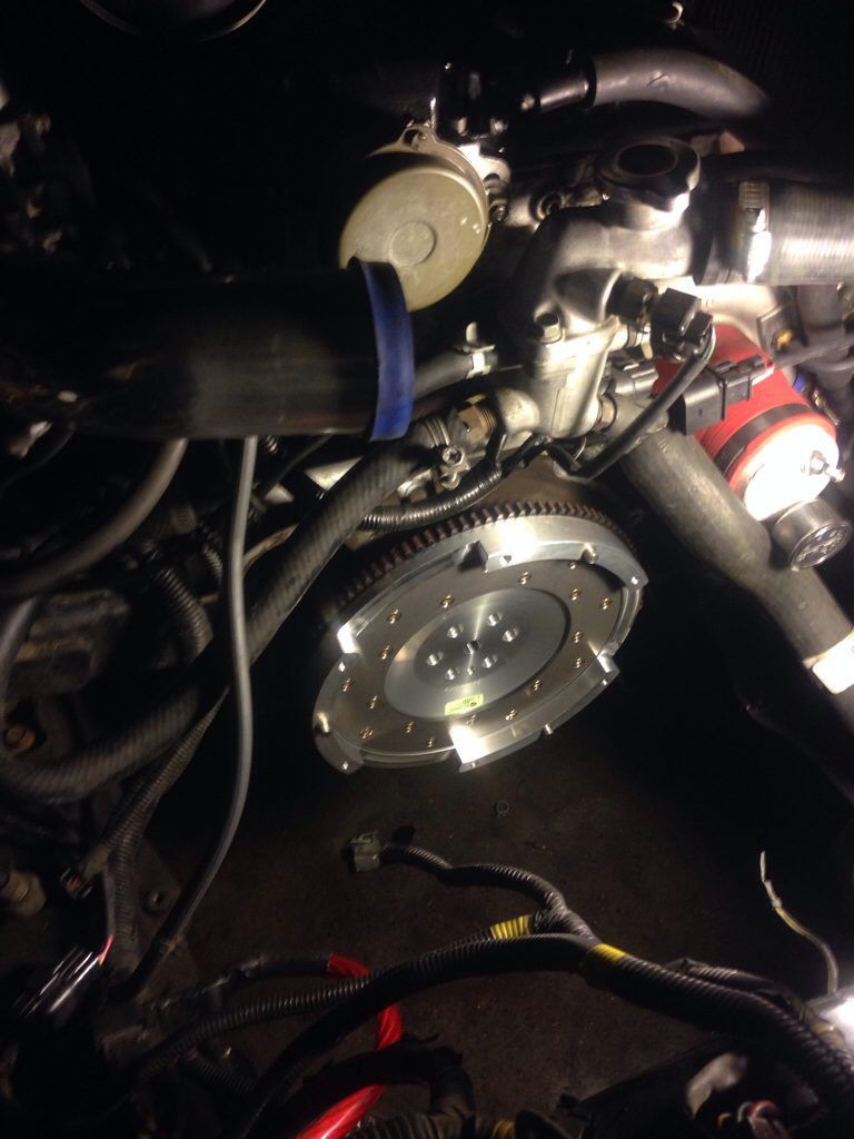

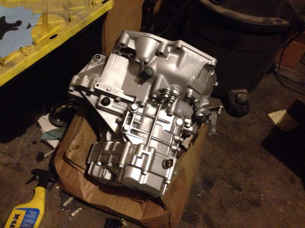

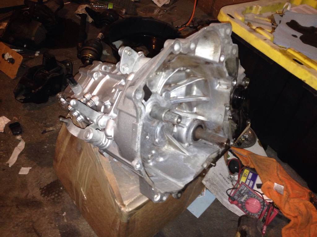

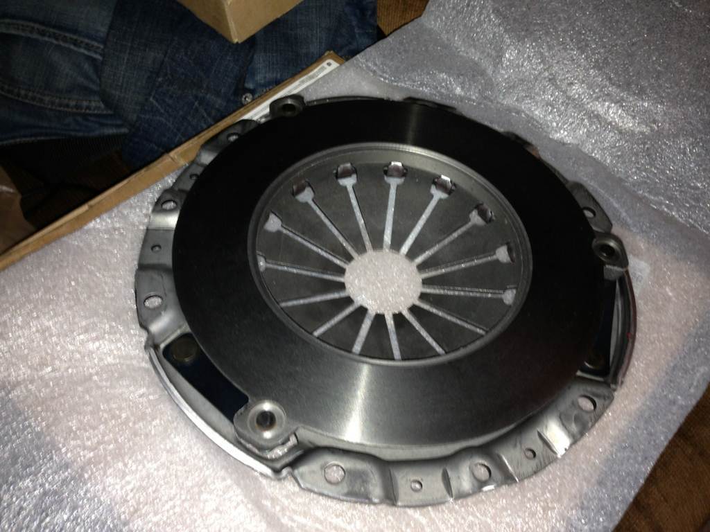

Got some more done with the talon. Finished cleaning up the transmission. Also got the clutch assembly bolted up. This weekend I'll be putting it all back together and starting the break in process with the clutch. Here's some pictures.

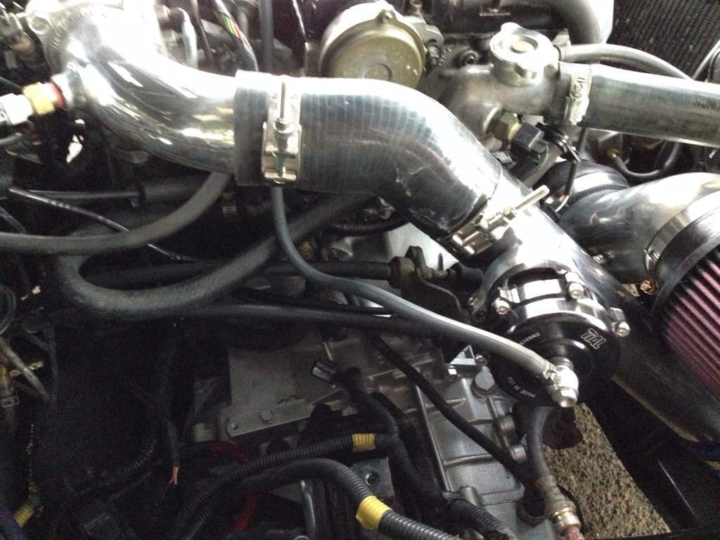

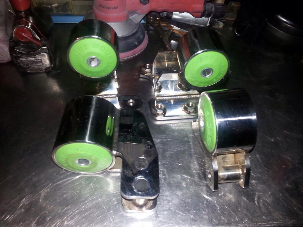

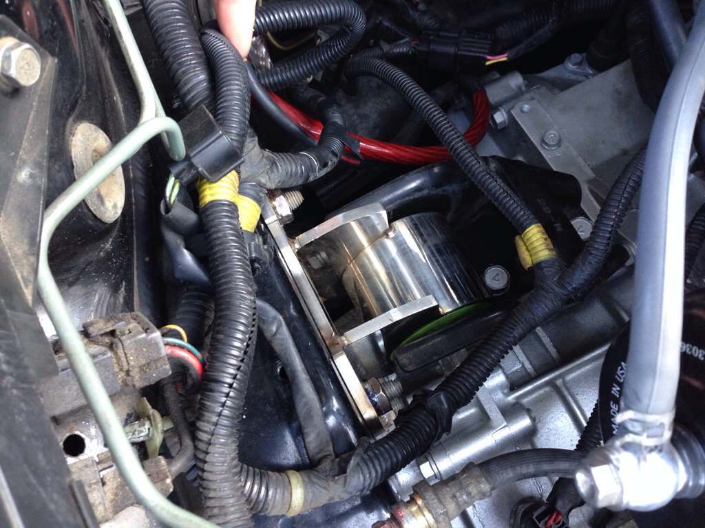

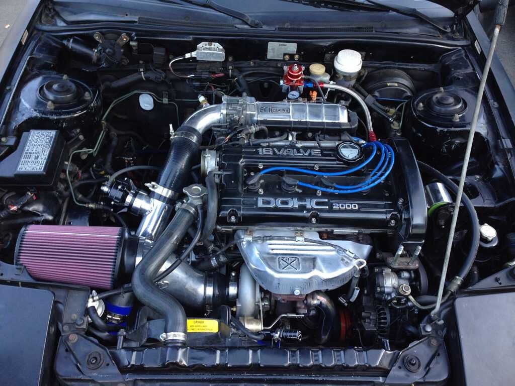

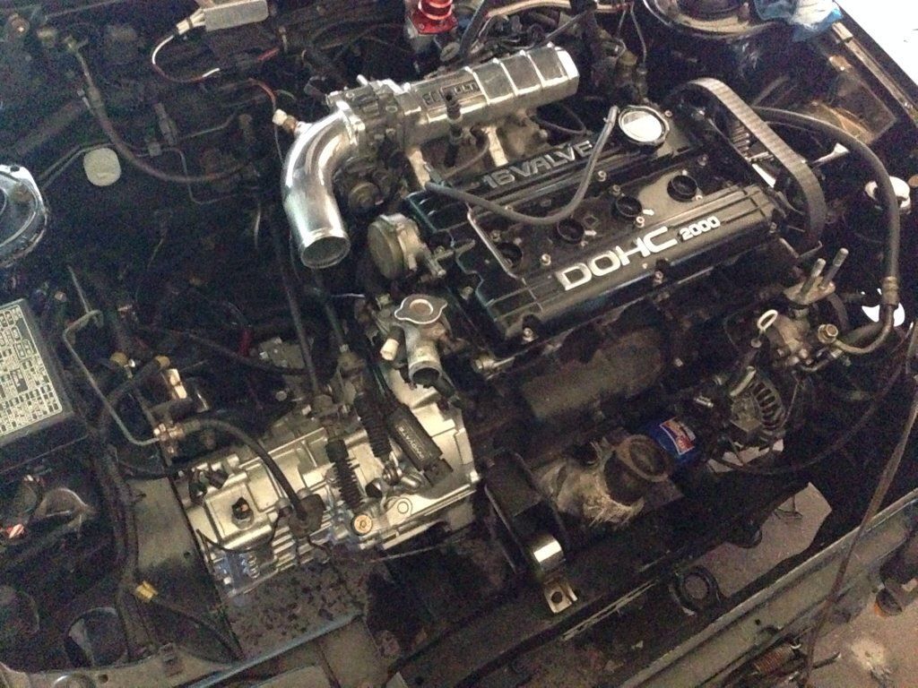

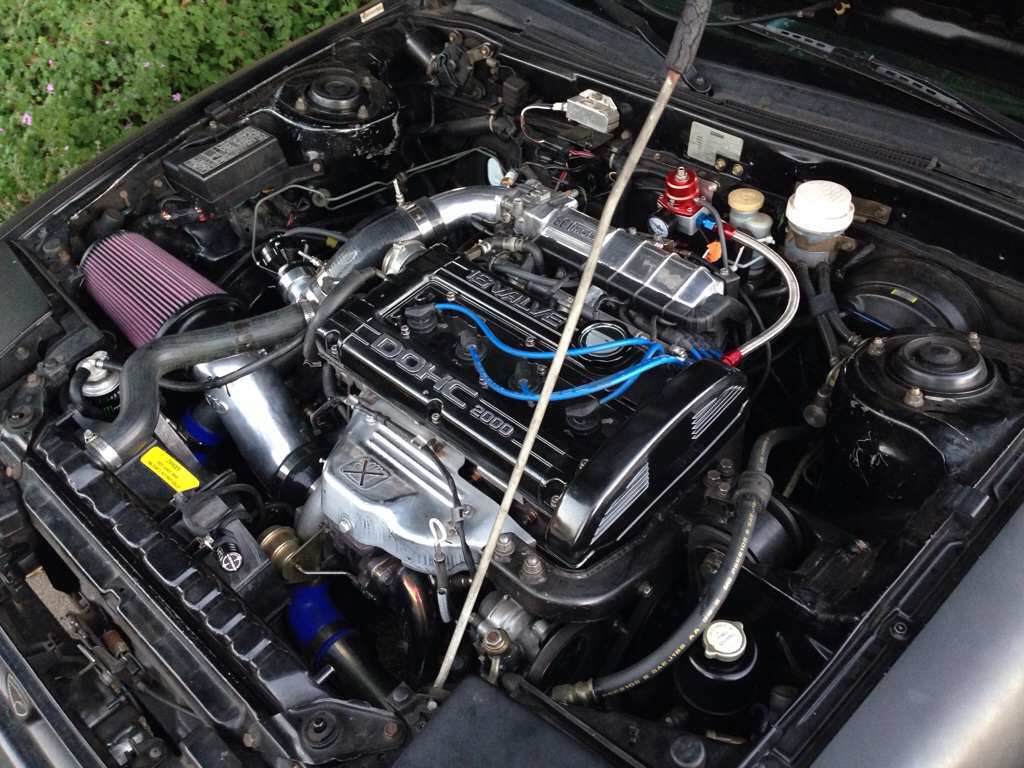

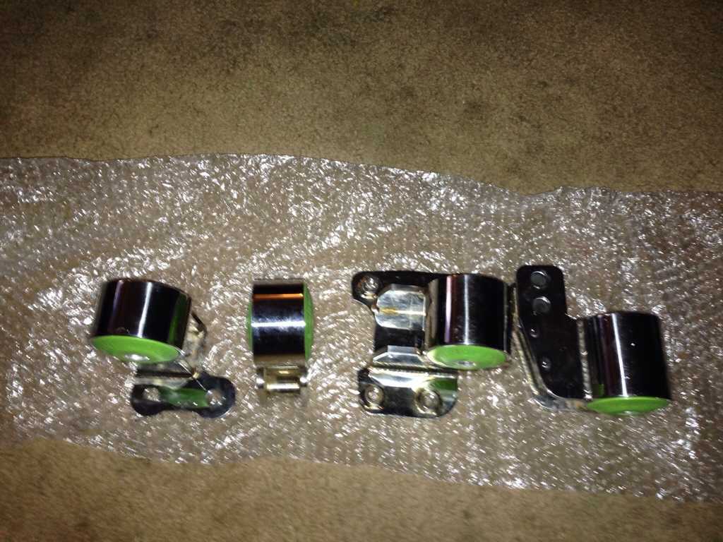

Got the car all buttoned up and back on the road. The break in miles for the clutch have started and I am now at around 150. The clutch feels great. I haven't really ripped on it yet given that the clutch isn't broken in fully. I also couldn't pass up a set of Drop Engineering motor mounts that were on the classifieds. Props to Gtrej01 for a great sale. He is a great seller with great detail, communication, and fast shipping. I'm looking forward to doing business with him in the future! I grabbed these mounts solely because of the great price. Just couldn't pass this one up. They also have a lifetime warranty and will make the bay look a tad bit cleaner. I just love the one time buys. I also had to find a way to hide my rusted exhaust manifold because everyone one my buddies would comment "only if you had an aftermarket manifold" LOL I made a run to the junkyard and grabbed a stock heat shield and gave it a nice shine. Here's some pictures!
You can see the tranny after the cleaning packed in there.

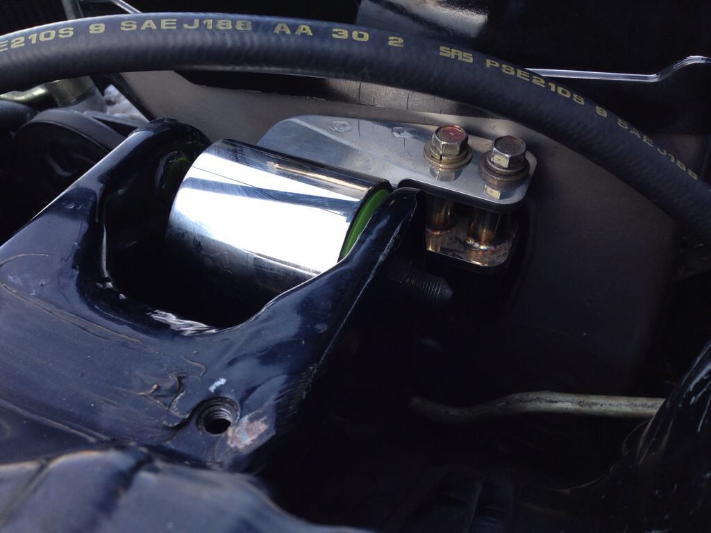

Here are the mounts I picked up!

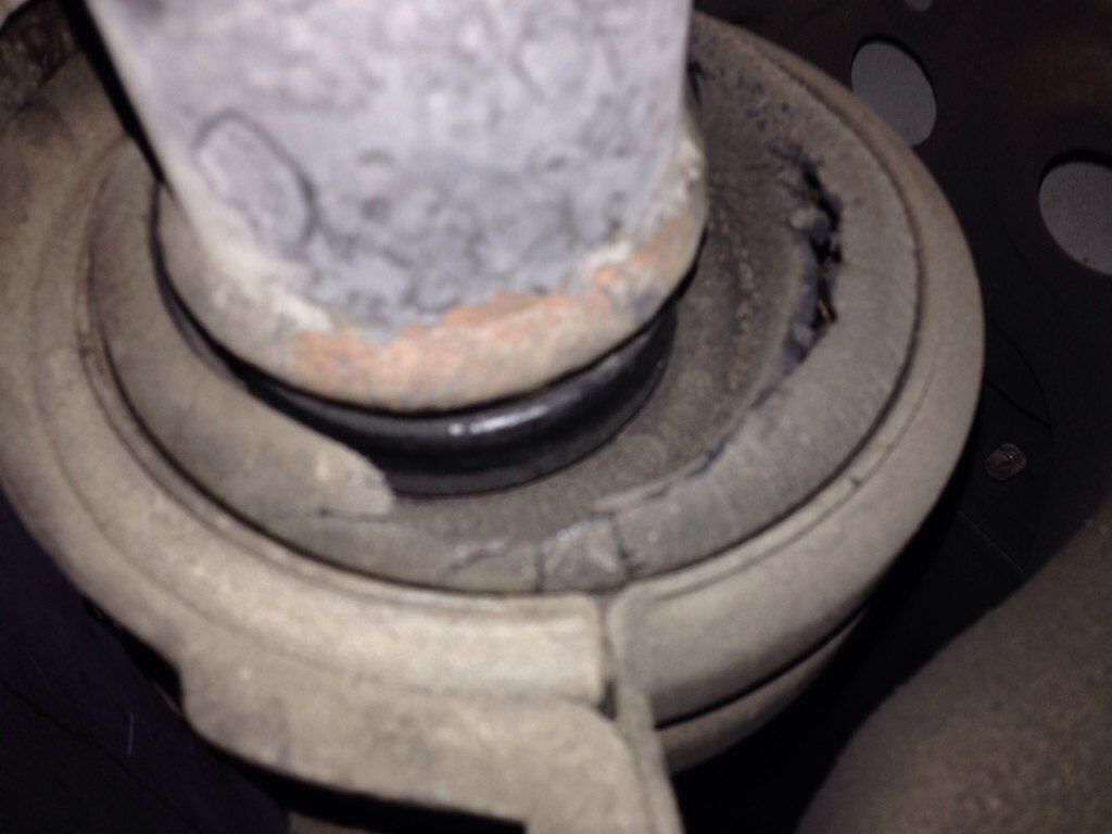

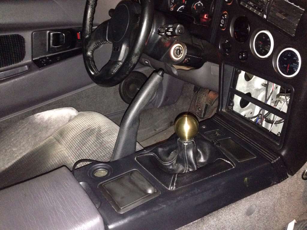

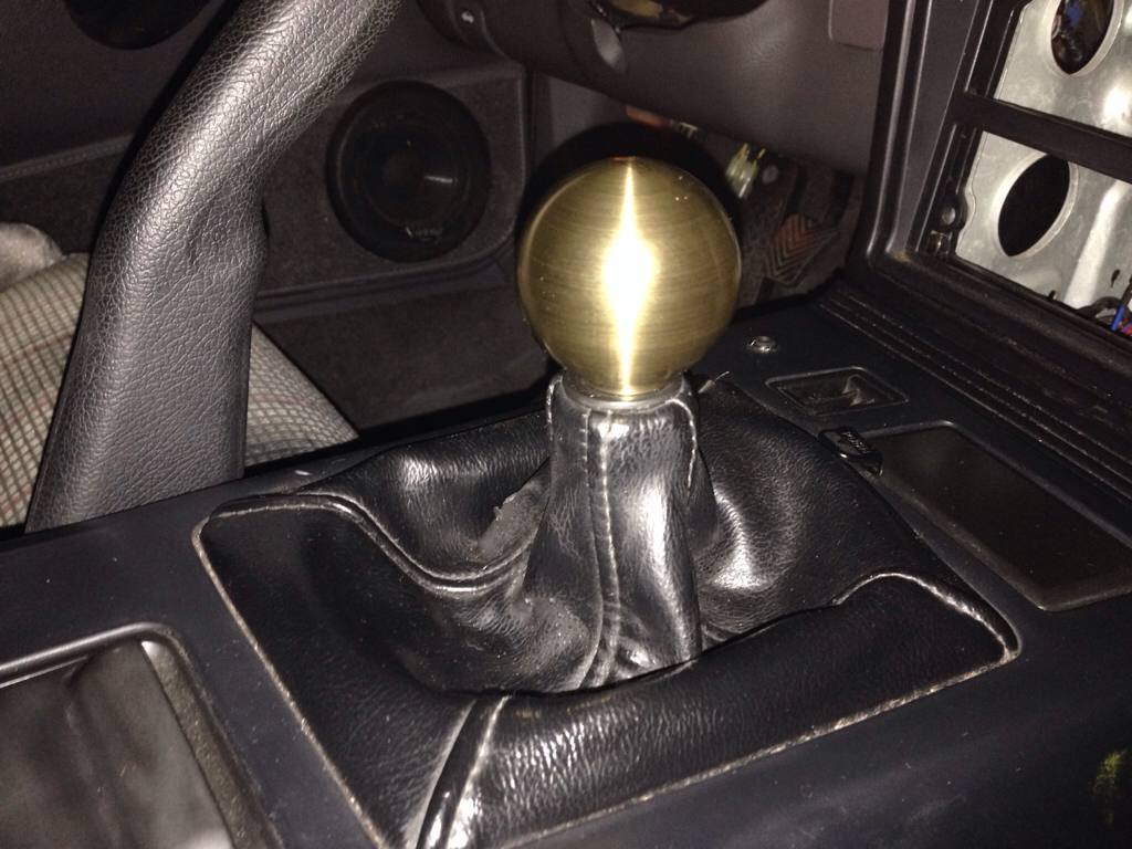

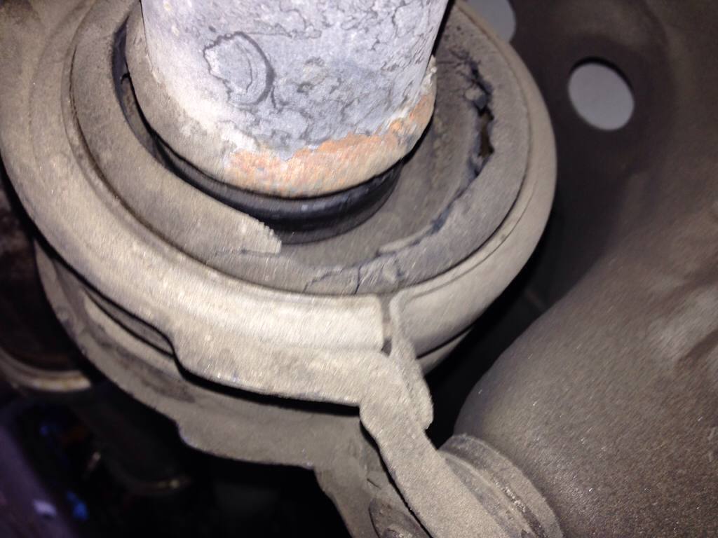

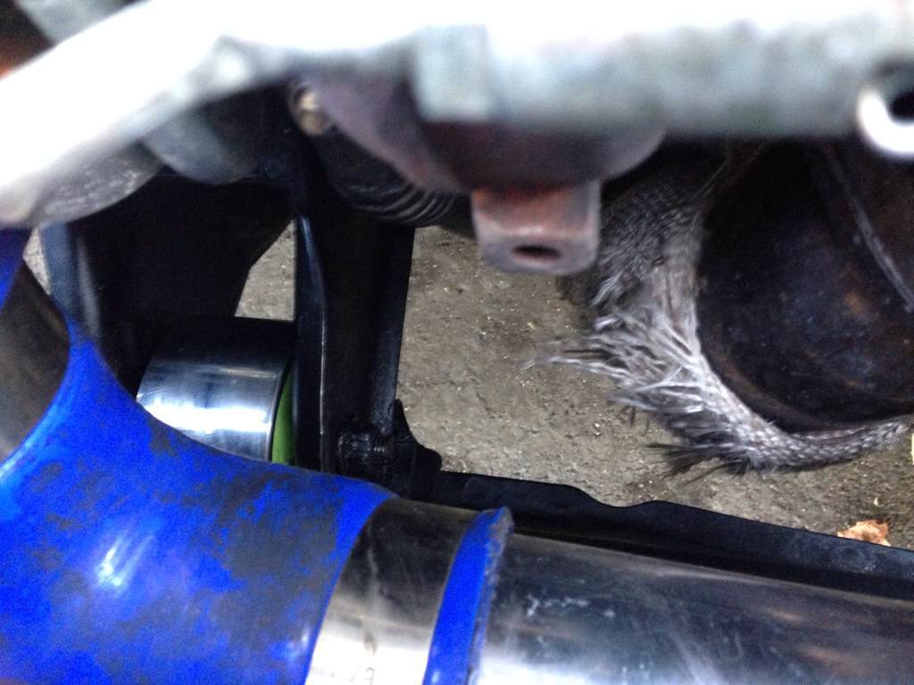

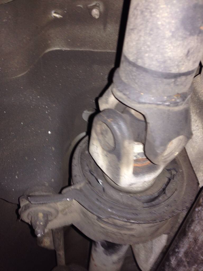

Got a small update. My mounts came and they look great! Also I picked up a blox 490 shift knob. It's a quality piece and it weighs a ton. Made driving my car a lot more fun. Sucks that the only color they had in our thread pitch was matte gold. Oh well. I also did little inspection of my driveshaft assembly and seen that both of my carrier bearings were toast! Here's some pictures.

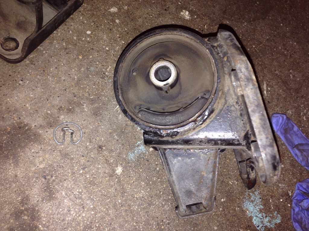

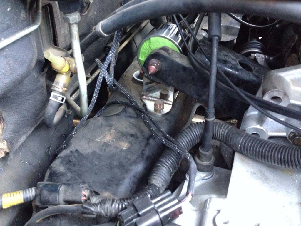

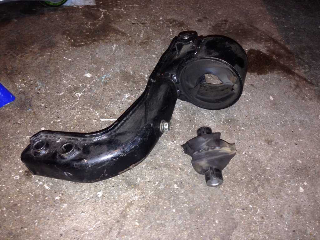

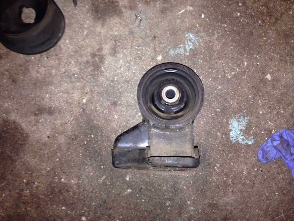

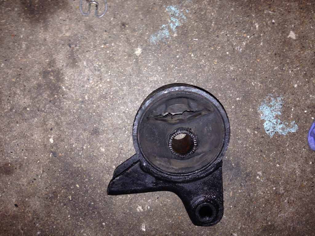

Finally for the mounts installed. It was actually very straight forward. I used just a floor jack and was able to get all of the mounts done! I started with the front and rear roll stops then did both sides. The mounts fit very well and bolted right in! They are truly a quality part. Thanks again to Drop Engineering and Gtrej01. The old mounts were in decent condition aside from the driver side mount. It was completely ripped. The new mounts are great the car feels more solid a little more responsive and best of all the transmission doesn't move my shifter anymore. :) great purchase and very pleased. I did get a small scare. I started the car after a couple days of rest. Let it warm up for about 5 mins and then took it for a spin to make sure the mounts were fine. I heard a little knock/rattle noise that would accelerate with the rpm's I pulled over to pop the hood and see where the noise was coming from. I hit the throttle body and it was coming from the long block. I let the car idle for about 8 mins then continued to drive it. When I got home the sound was completely gone and the car sounded completely normal! I did have nasty lifter tick so I'm guessing it's about time to throw in a new revised set of 3G lifters! Let's hope that fixes that noise. Here's some pictures!

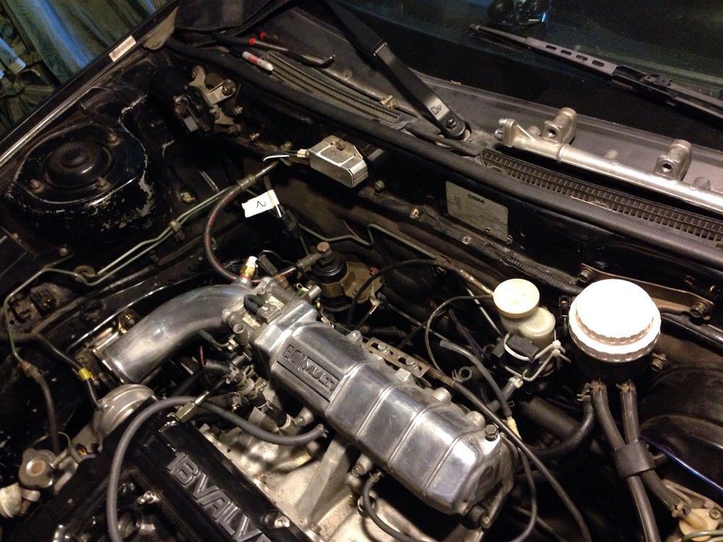

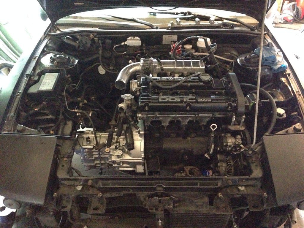

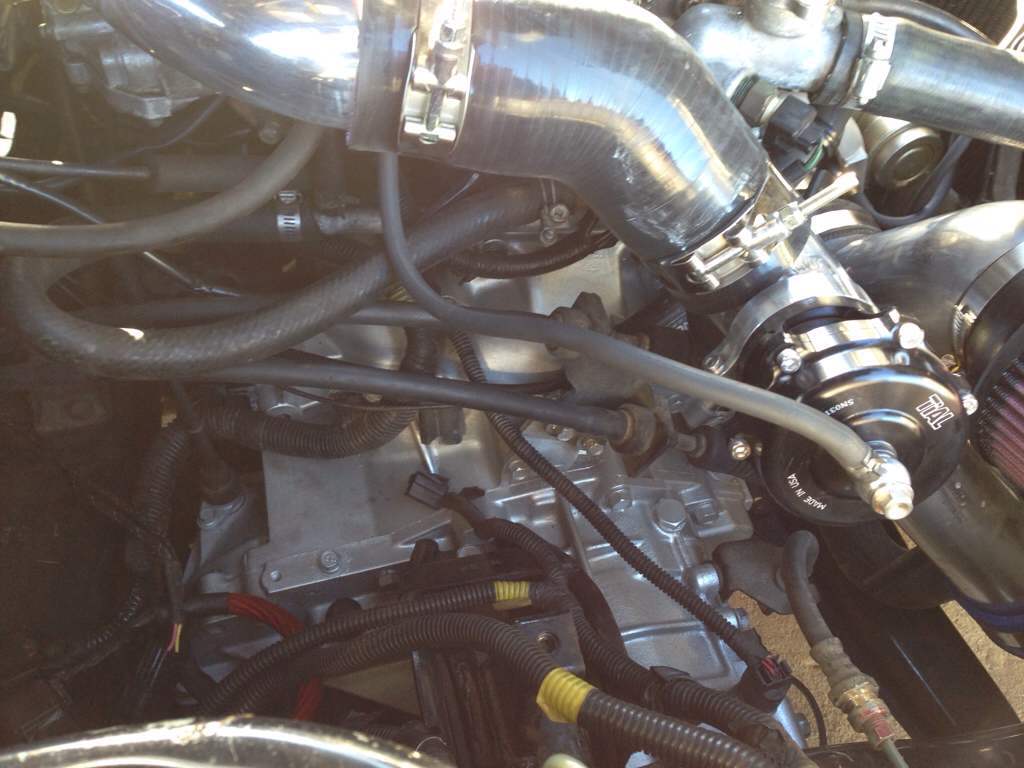

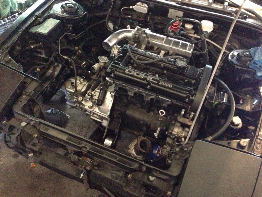

Here's an update on the Talon guys. I decided to put it down for the winter in search of more power. I got bit by the tuck bug and now I'm planning to do a fuse box relocation and harness tuck. I yanked off my old turbo setup and am now in the process of moving on to a new setup. Here's some pictures guys.
The disassembly begins.

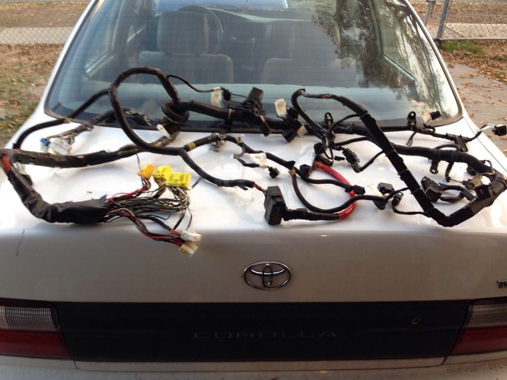

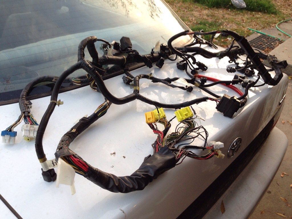

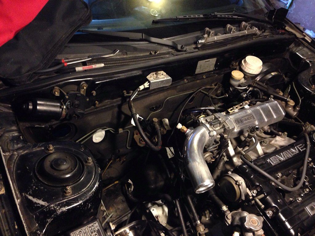

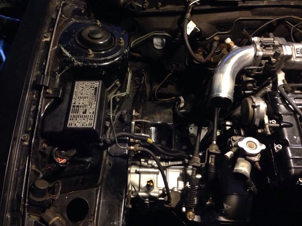

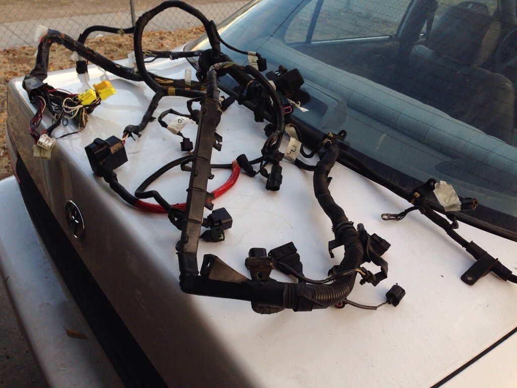

Yanked out the harness. Getting ready to shrink it. Believe it or not but that thing weighs like 15 lbs.
Here's the bay after it's been removed. So much more work to do! Sure is gonna be fun and a learning experience though!

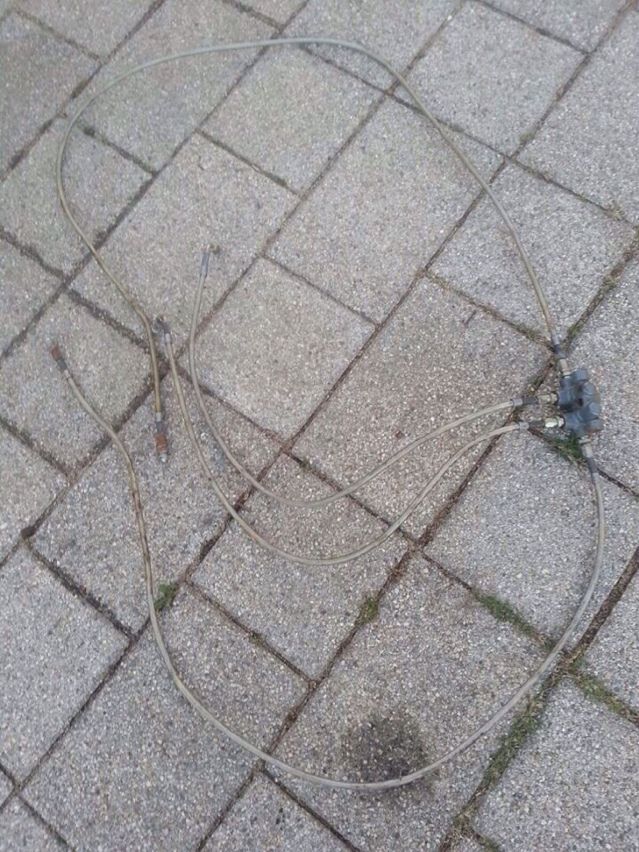

I purchased an abs delete kit solely because the front brake likes are steel braided. I am going to tuck them as well as upgrade my clutch line to a steel braided line to get rid of the hard lines.

Thanks for dropping in! I figured that the braided line would be easier to hide away. :thumb:
For any of the tuners that are interested in my plans for the wire tuck and fuse box relocation I'll try and explain my plans as clearly as possible. Well I decided that I will be cutting any harnesses off that will not be used. I will provide a list of what I'm planning to delete. I'm planning to relocate the fuse box to the passenger side foot well. I will lengthen the necessary wires and lead them through the fender to the engine bay. I will be cutting out a 2 1/4 inch hole on the middle lower part of the firewall between the shift cables and steering joint. This is where the main harness will branch out from. I plan on keeping only the necessary harnesses and making it as thin as possible. I am looking to use nylon expandable mesh loom to give it that clean look.
Here are the harnesses I plan to delete. (Keep in mind this is a 1990 harness)
-AC harnesses (still determining harnesses and harness codes)
-EGR Temp B-08
-Cruise Control A-11
-Wiper Motor A-09
-Wastegate Solenoid A-51
-Engine Coolant Temp Switch for AC B-31
Also considering deleting power steering.

Small update guys. I have stripped most of the wire loom from the harness and now have exposed the wiring. My plan for this is to take one clip at a time and trace it's wires back to the ecu clips to delete them. I did notice that some wires are tied into other wires. It's going to be a very time consuming job but I just keep a level head and try not to move too fast.
