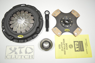

XTD Sprung Puck Disc 6k Mile Review
This clutch disc was used with an ebay xtd "2300lb" pressure plate.
(I know for a fact that the pp is heavier than an act 2100) The friction material wear was very decent actually. I had a brand new one side by side and you can see. Again this was after about 6k miles and lots of abuse haha.
However....
So the spring was starting to try and come out. Who knows if it would have ever made it free or not. I do know that my new act unsprung street disc is about 3x lighter than the sprung xtd puck is. I'll probably get another xtd, except next time it will be the unsprung.
