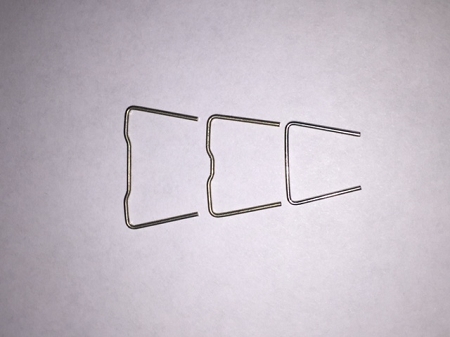

1G Where to get injector clip retainers?
I made my own, with some wire. You can even use a paper clip, with a little patience and couple pair of pliers you can make identical ones pretty easy, it's just a U shaped clip
You and your car will love the quick connectors!!! Good choice!
I pulled the 2g style connectors out of a Sebring, or was it an avenger...Oh who cares they are the same car LOL, also the Dodge caravan, Plymouth voyager, Chrysler town and country "96-"00 minivans all have a quick release connector that works with dsm injectors, a lot of Dodge Chrysler Plymouth and Jeep cars will have a quick connector that works with dsms.
This is a great upgrade, especially when you consider how many times you remove these clips, if not to add bigger injectors, then to clean them, or just crank the car over without fuel etc.
