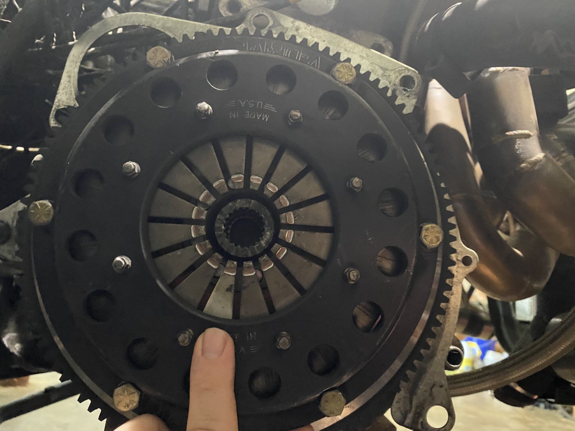

I’m posting a couple pics of the pressure plate, one of the teeth is wearing a little different than all the others. Is this a cause for concern?

That wear on the pressure plate fingers seem a bit excessive to me for only 7k miles. Someone correct me if i'm wrong, as I have never run a twin disk so that may have something to do with it. But I would definitely be looking at the throw out bearing to see if it has seized. From what I can hear in the video, it sounds like my car did when I over adjusted the clutch and crushed my TOB. If the TOB is in good shape, the wear on the pressure plate may be from the TOB not riding on the pressure plate while the clutch is engaged. Even when the pedal is not being pressed, it should still be making contact with the fingers which keeps the bearing spinning at the same speed as the pressure plate. If its not then you might get the wear you see on the fingers. Maybe you shaved to much off of the OEM fork?
https://www.dsmtuners.com/attachments/1de957f3-58d3-4882-8550-828de46a9f97-jpeg.639189/
If this is the pic you mean, the wear from TOB contact on this pp finger looks the same as the other fingers to me.
What's different is the color of the whole finger. That is just the way QM color codes their pressure plates for what strength spring they have in it. They paint one finger some color. Looks like that finger is/was white, which means you have the "white" spring. That is pretty much the default spring and it's a pretty "heavy" spring.
Take a look at the pics of a new QM twin in my build thread, where I put more info about it:
