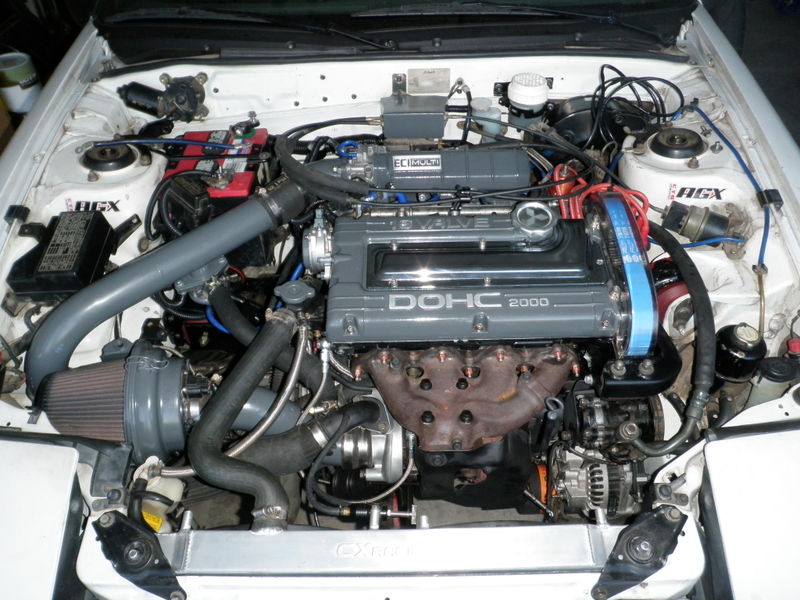

Day 1:
At the end of my last blog, the engine was completely assembled on the stand. I got it off the stand, attached the Fidanza Flywheel, the ACT 2100 clutch, and the transmission.
I stopped taking pictures at this point but the engine went in without much difficulty. I sent the rest day hooking everything back up. Everything went surprisingly smooth. Once everything was reconnected I added the fluids and called it a day. I wanted to check everything again the next day once I was fresh again before starting it.
Day 2:
I installed the 3" downpipe, AEM wideband, and a few misc things. Time for the moment of truth.
[video=Startup, Take 1]67[/video]
Startup, take 1. It started up in the first crank. It ideled high at first, then started reving from about 600 rpms to 2,000 rpms. AFR was off the chart lean, switching from 17.9 to ---. CEL was on. Oil pressure good. I let it run for a while and then while I was checking things out under the hood I noticed the fuel was pouring out from the fuel inlet on the fuel rail. I shut it off right away.
Turns out it was a torn o-ring. Also the vent line on the intake pipe was open so I routed it into the catch can. This would explain the erratic idle.
Startup, take 2. Once again, started up on the first try. Idled high again, searching from 1500 - 2000. AFR was ---, off the chart lean. CEL on. Bad air leak at the throttle body. Shut it off to fix.
The throttle body gasket was upside down. Once again, a quick fix.
Startup, take 3. Idle 2000 rpms, no longer searching. AFR was high 16s-17s. Oil pressure was around 60-70 psi. Fule pressure 40 psi with the line attached. Vacuum was about 12. CEL was still on. Lots of chatter from the engine had me concerned so I shut it off again.
That evening I bleed the clutch but I didn't mess with the engine anymore.
Day 3:
I did a compression check, the results from cylinders 1-4 were: 150, 150, 150, 145. I started it up again and the chatter was gone. I let it warm up and then setting everything. I got the idle set to 750. I got the fuel pressure set to 37 with the hose off, 30 with it on. Checked the timing but it was already dead on at 5 BTDC. With everything set and it warm the oil pressure was around 30 psi at idle. AFR was still 18 to --- lean at idle.
With everything looking and sounding great I decided to slow roll it around the neighborhood a few times. I was only running a downpipe and non hood so I didn't want to take it out on the roads. Everything went super! I kept it around 2,000 rpms at most, only got 3 lbs of boost but it was running! Everything seemed to perfect. After a few loops around the block I smelled something burning so I returned to my house. I inspected everything but was unable to find the source. Everything smelled fine the engine bay.
My 3" Punishment Racing cat-back system and 3" test pipe were ordered a few days ago and as soon as I get them on I will proceed with the break in process. Until then I will wait but I am super happy with the progress so far. :thumb::thumb::thumb:

Exhaust is on and I drove it 100 miles today! Only problem so far is that the silicone vacuum line from the BOV to the intake manifold is collapsing under vacuum. I need a stronger vacuum line, any suggestions?
Just an update: I finished the first 500 miles of the break in. I just switched to synthetic oil, Castrol Syntec 10w-30, and will continue with the second 500 miles. Can't wait to finish so I can open that throttle up!
You can got WOT now if you wish. Rings break in within the first 100 miles or so. There are people who baby the car to break it in and there are also people that break in their motor going down the 1/4 mile track. Do what you wish.
Congrats on the swap though and it sounds nice!
Try siliconeintakes.com silicone hose. Very good quality at a great price. They even have a comparison of their silicone vacuum hose and the competitors on their website.
Yeah I know everyone has there own opinion on breaking a new motor in. I had this motor in 5 years ago and blew in the first 200 miles so I'm definitely babying it this time. Another week or so is all I'll need anyways. I't running like a champ though, I'm very happy with it.
I replaced that line with a standard rubber one for now and it is working fine. Eventually I'd like to replace all my lines again so they are the same and when I do I'll check out that site. Thanks!
