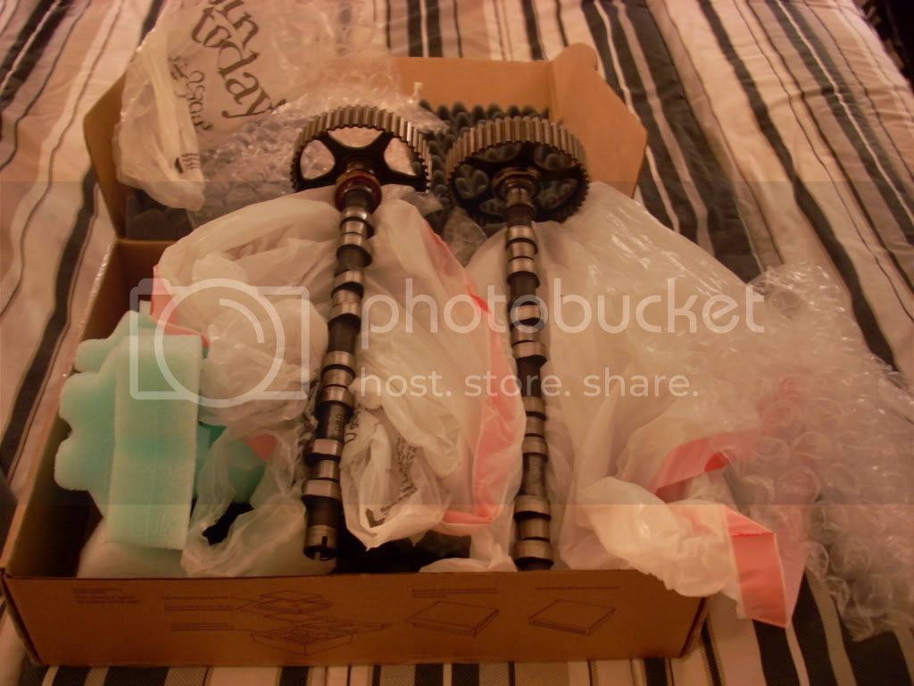

That was simply unacceptable. So a couple of days of hawking the classifieds and some (im)patient waiting yielded not one, but TWO packages waiting for me! Of course, I forgot to take pictures of the 'boring' box, but you bet your butt that I took pictures of the fun one.
What could it be?
FP2's, son!
(The boring box was 16ea. revised 3g lifters)

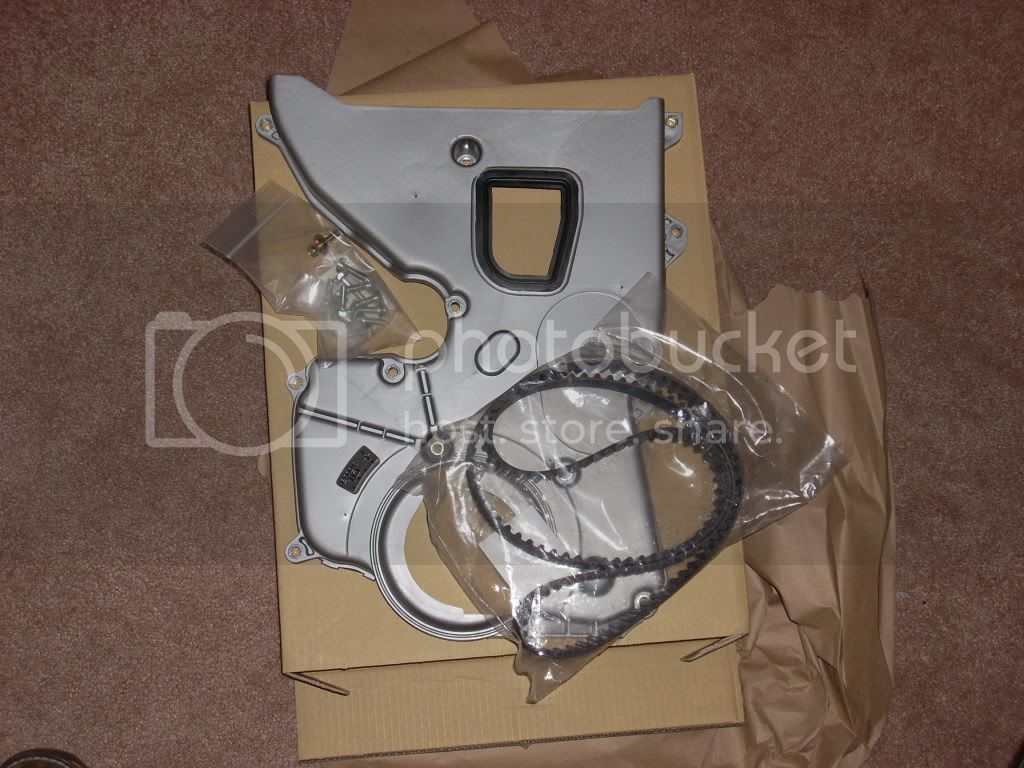

The cams and lifters blew the DSM budget for about a month and a half, so I had to look at the box sitting in my apartment anxiously waiting for the chance to install them. Once the budget was replenished, I got all the timing parts needed to complete the install, plus a swanky new cover to replace the busted stocker. (The tensioner and pulleys were all younger than 15k miles and checked out ok prior to re-installation.)

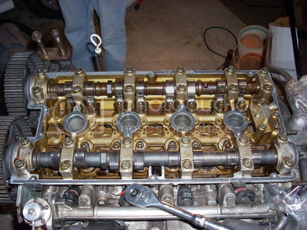

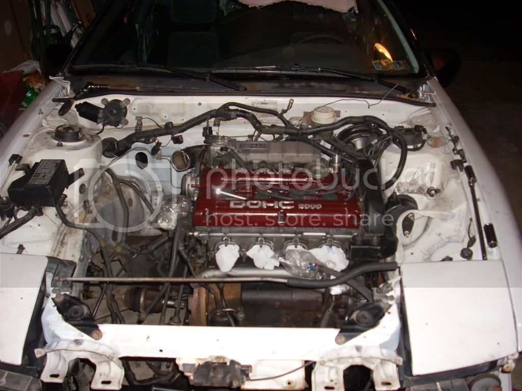

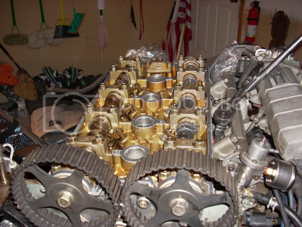

Naturally, the fun started with the cams and the lifters. I didn't snap any pictures of the lifter install, but come on, that would have been quite the boring picture. Here's a couple shots after the intake cam was installed.

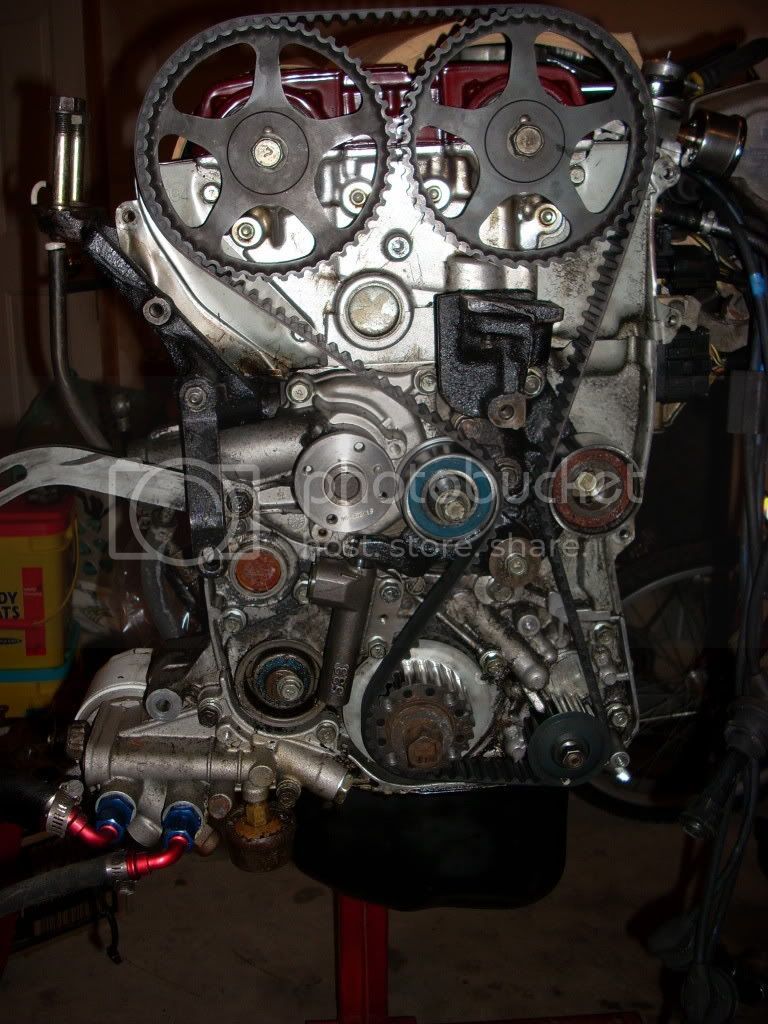

Next up was the timing. This was my first t-belt job, and let me just say I was very gracious that the engine was out of the car. The grudge is from a failed cam seal that was oiling down the engine for a good 6k miles before I pinpointed the problem.

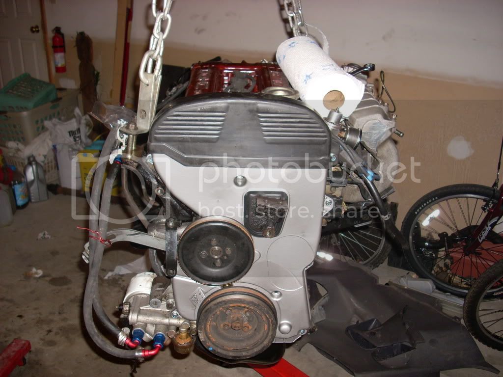

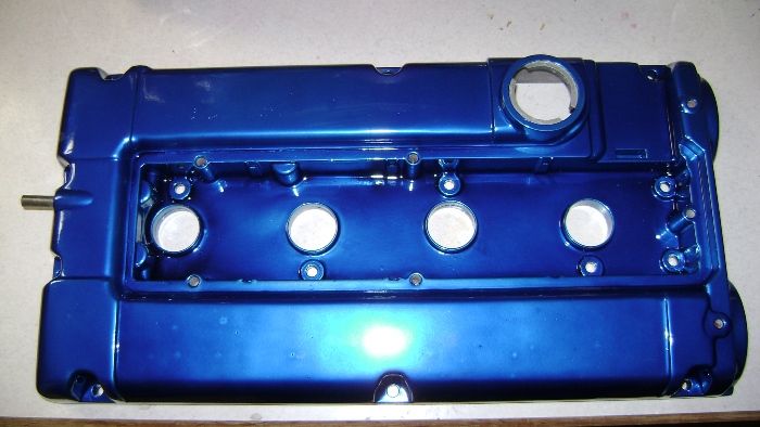

Now all that was left was to button up the engine and slap on that shiny new timing cover. Follow that up with some pulleys and we're just about done with the weekend's task.

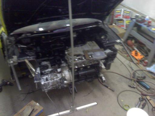

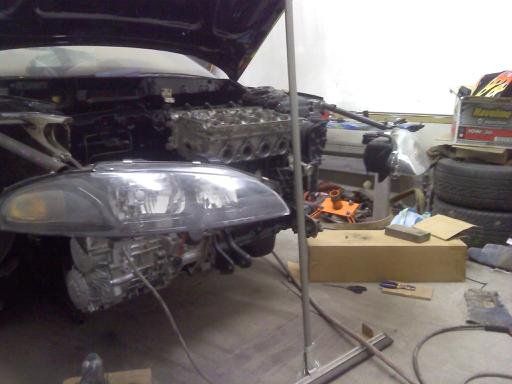

After calling it a night, I retired to watch some college football (this work was all done late Friday and throughout Saturday). Sunday's a day of rest, but how hard could it be to drop in an engine?

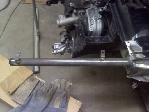

Well, all those proverbs about not counting your chickens until they're hatched are proverbs for a very good reason. The fact that there was no rear engine mount on the chassis had escaped my attention until this point. Needless to say that was more than a small issue. Luckily, a couple hours later I was back on track thanks to a local DSM'er. Slapped the heart into the Eclipse it was all over but the crying.

Also, how hard was it to do the timing stuff with the engine outside of the car?
Tunernewb, doing the timing with the engine outside of the car is stupidly simple. Hardest part was to get the tensioner to retract.

Thats a nice valve cover you got there. Keep up the good work.
