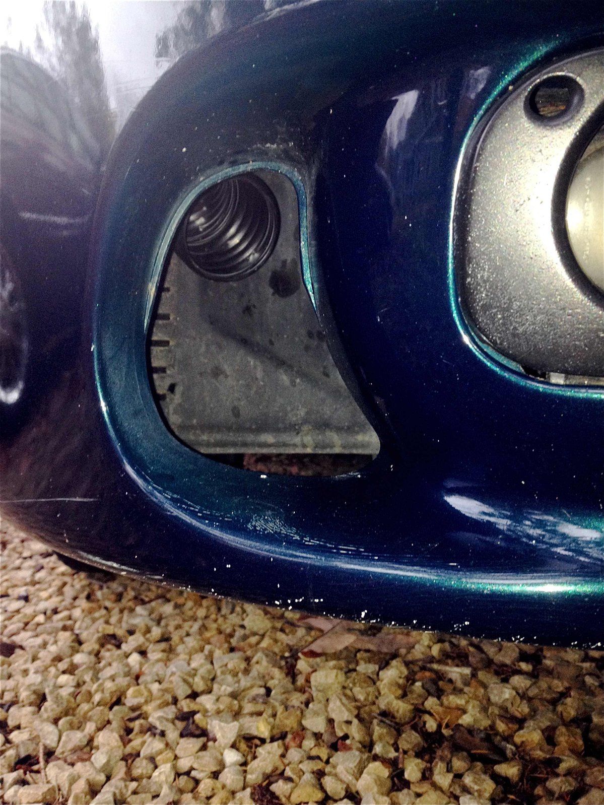

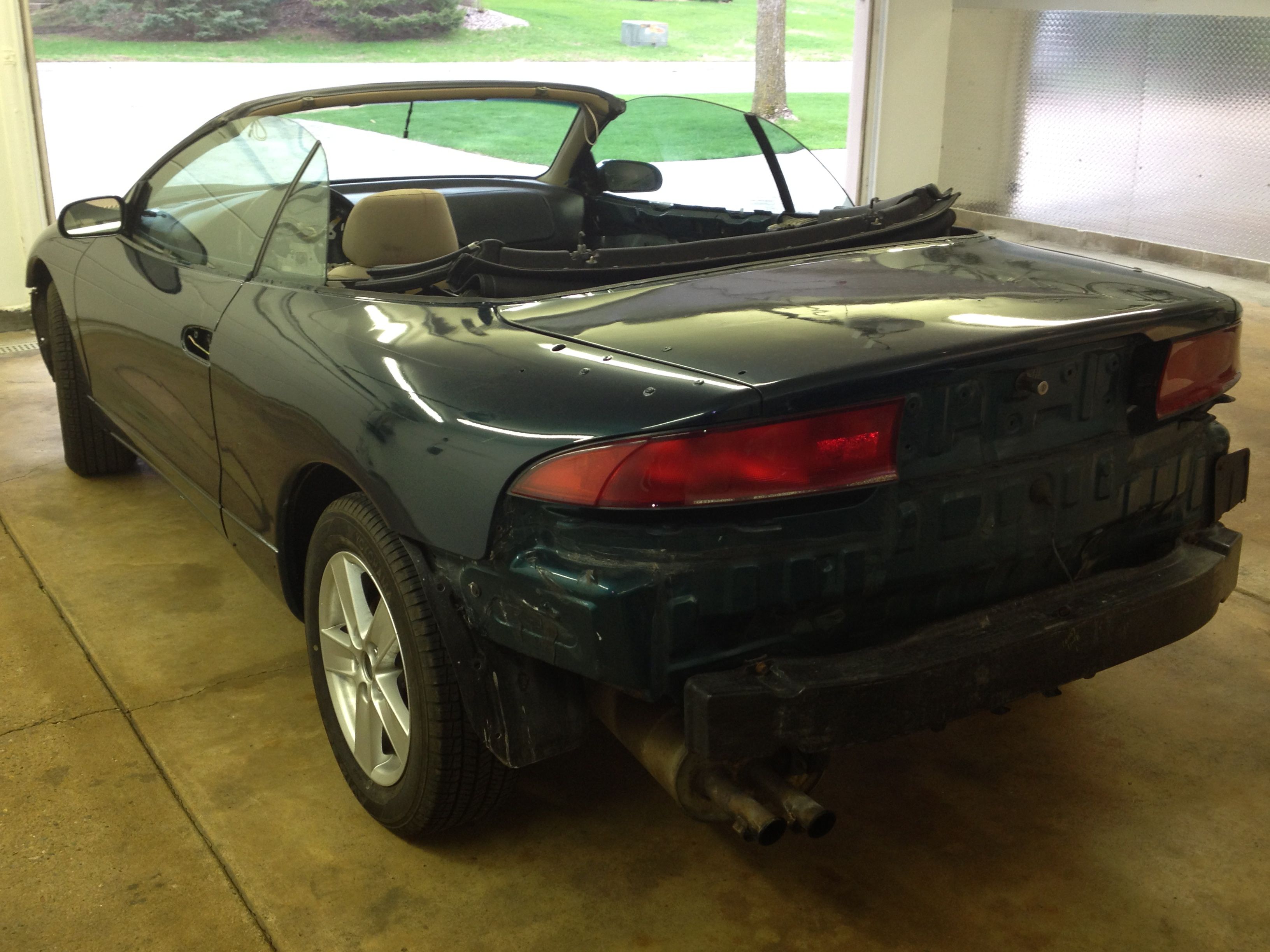

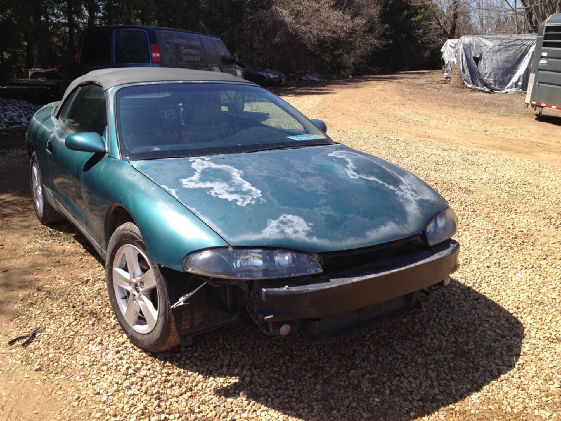

The sun had baked off a lot of the paint. It’s hard to see here, but it looked like it had a bullet hole in the front bumper. Rockin’ Infinity wheels.

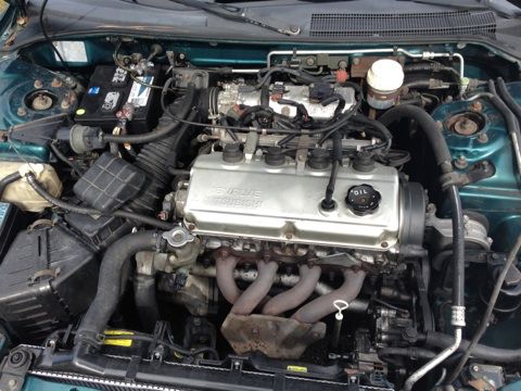

The engine ran and looked good.

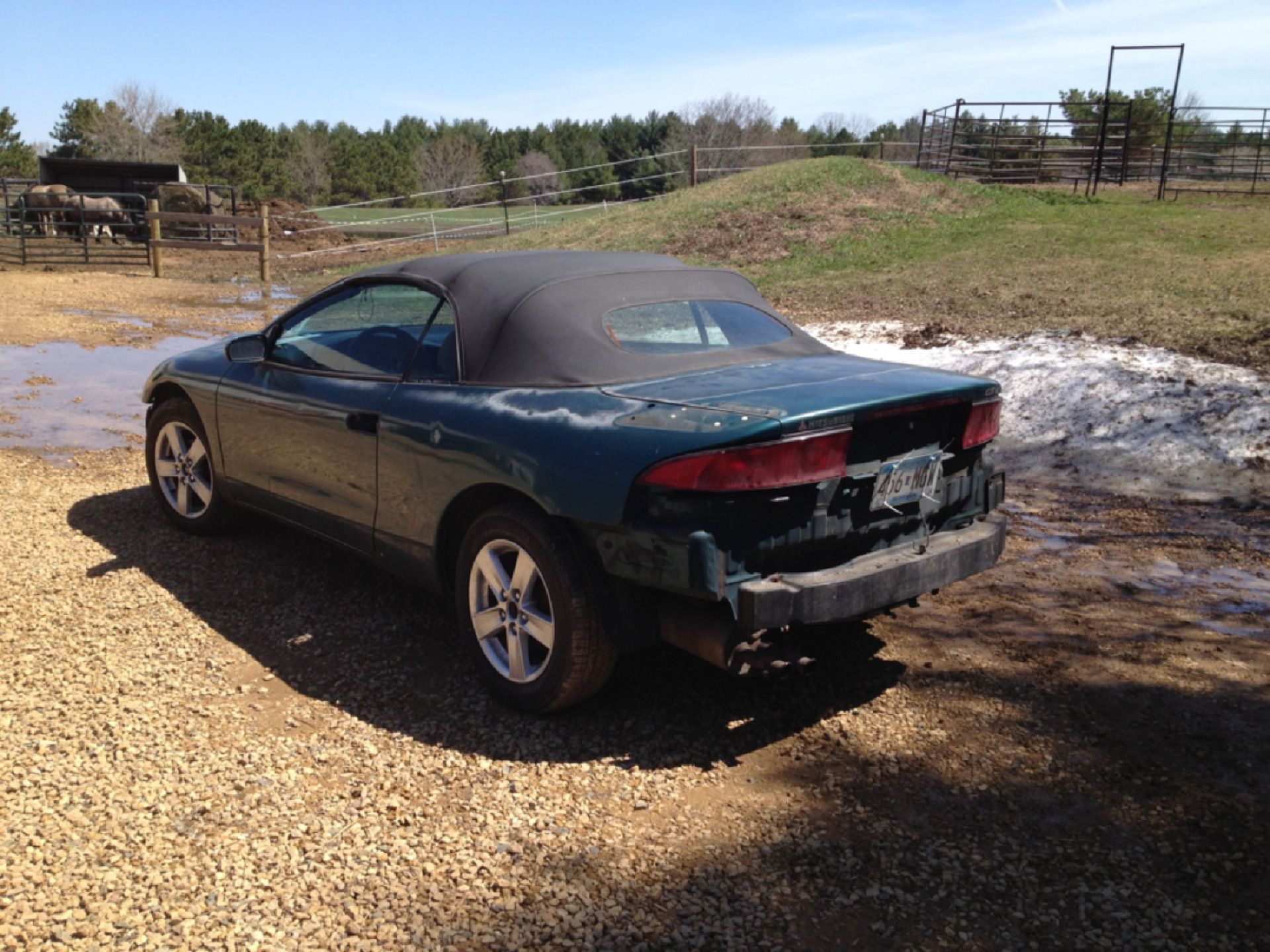

A. Trip Prep: My son and a buddy volunteered to make the 1200-mile drive home in January. I had the oil changed and all other fluids checked.
To make sure there were no tire issues on the road, I put on a brand new set of Lancer wheels and Yokohama tires I got from a friend. It gives it a more dsm look.
Then I bought a second identical transmission and sent it along with the car to a local trans shop. Had them pull both apart and use the best pieces out of each, along with new snap rings, clutch pack, and seals. Replaced both drive axles while we were at it.
The electrical drain would have to wait. If they stopped for overnight, the guys would have to pull the battery cable.
They stayed extra time to enjoy the beautiful Florida weather before heading north.

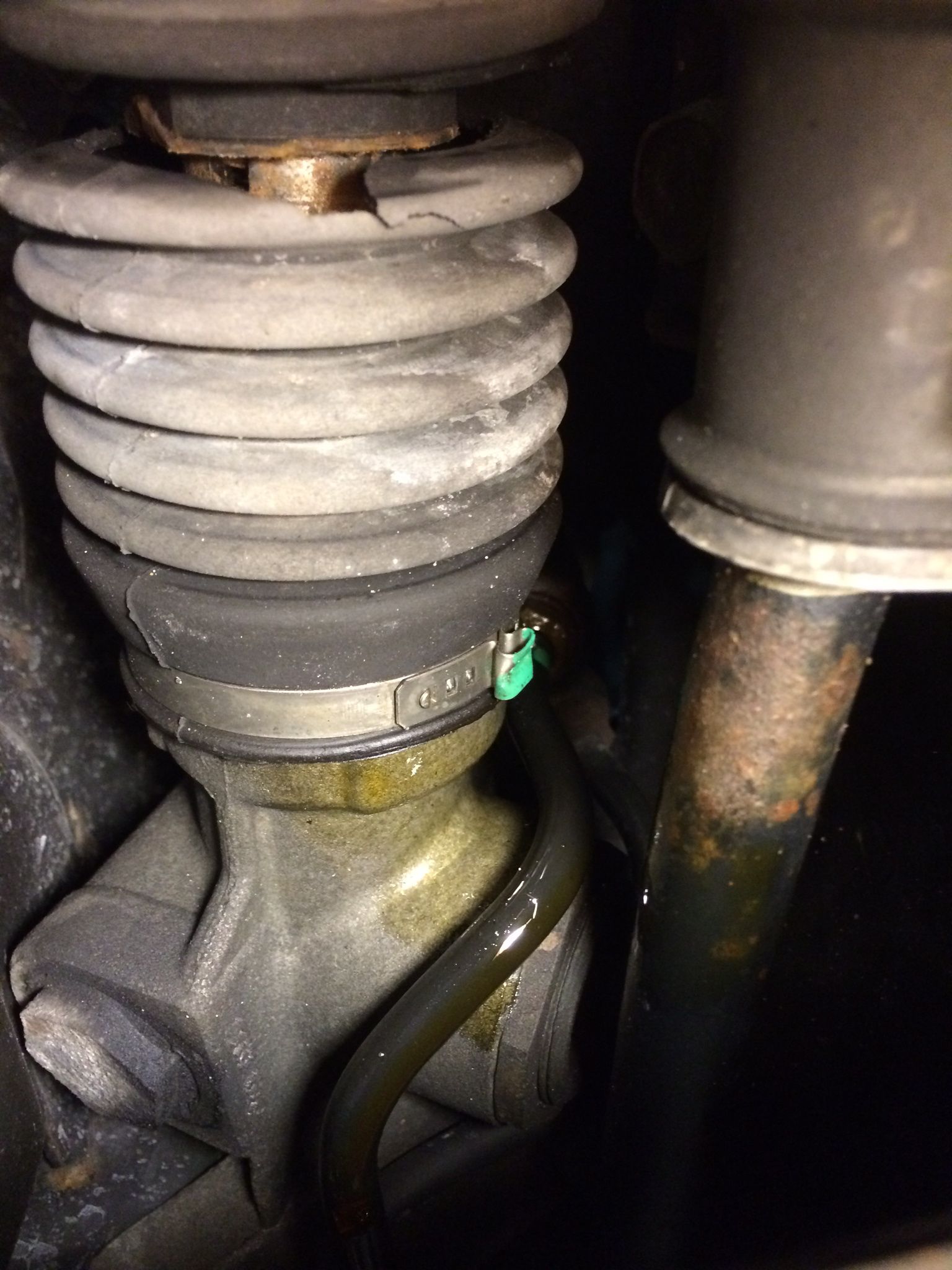

The trip went almost without incident until Kentucky, when the power steering line broke and pumped out most of the rack fluid. It was leaking so fast, you could not pour more fluid in fast enough to last very long, so, manual steering for the rest of the trip!
The weather was good until Wisconsin, which had a raging ice and snow storm in progress. I was proud of how the guys made the little fwd car follow the ruts in the highway, made by trucks, while other cars spun out into the ditch.
Made it to Minnesota – finally!

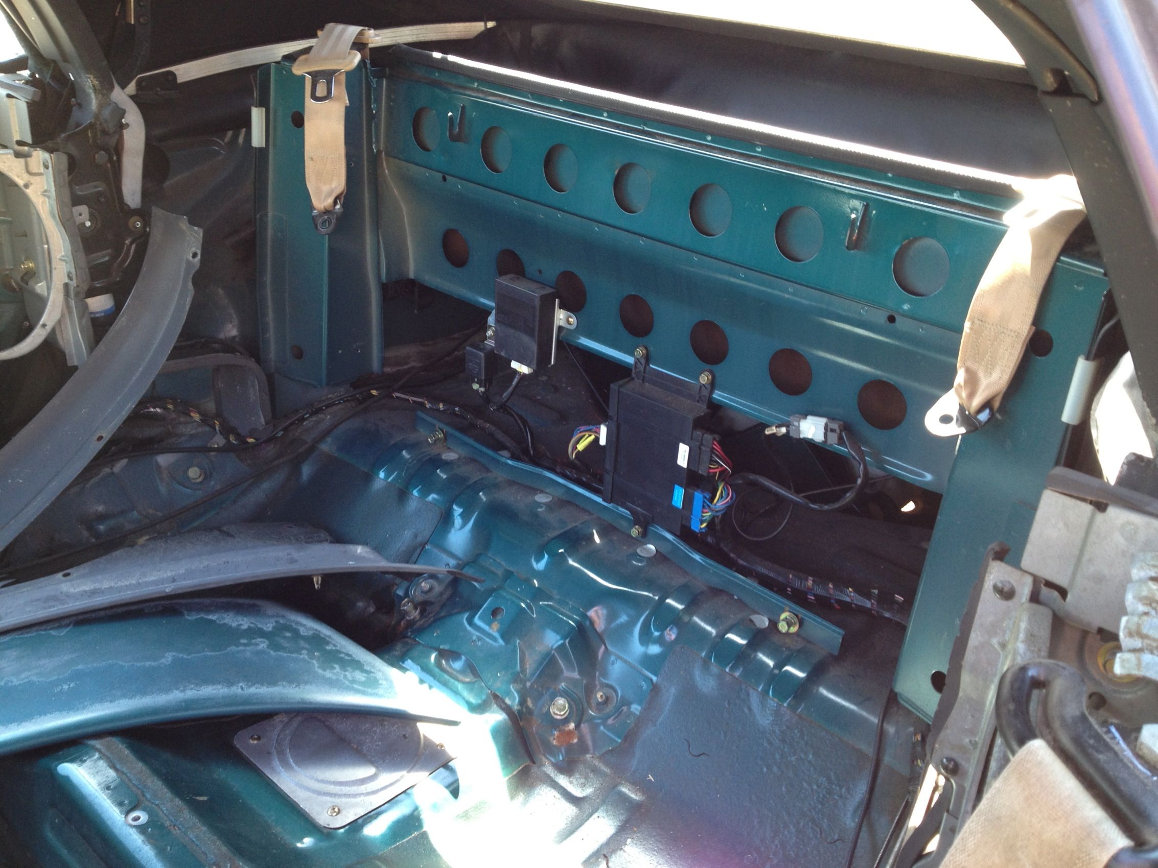

B. Electrical Repairs: I did some tests, then inspected and traced the wiring harnesses. "The problem" turned out to be three problems: 1) A partially-fried ecu because someone had previously hooked up the battery cables backwards 2) Missing ground straps on the exhaust and an intermittent short in the battery ground cable from corrosion, and 3) A bad Fuel Pump Relay Module that went crazy after it heated up (see our Write-Up on bypassing this in the Tech Section: Electrical). It shifted fairly well, but put in another ’99 Spyder tcu just in case this one had been zapped along with the ecu. Shifts great now.
That's all the photos it will let me load for now. I'll continue as soon as I find out how to load the rest.

Time to replace the leaking steering rack:

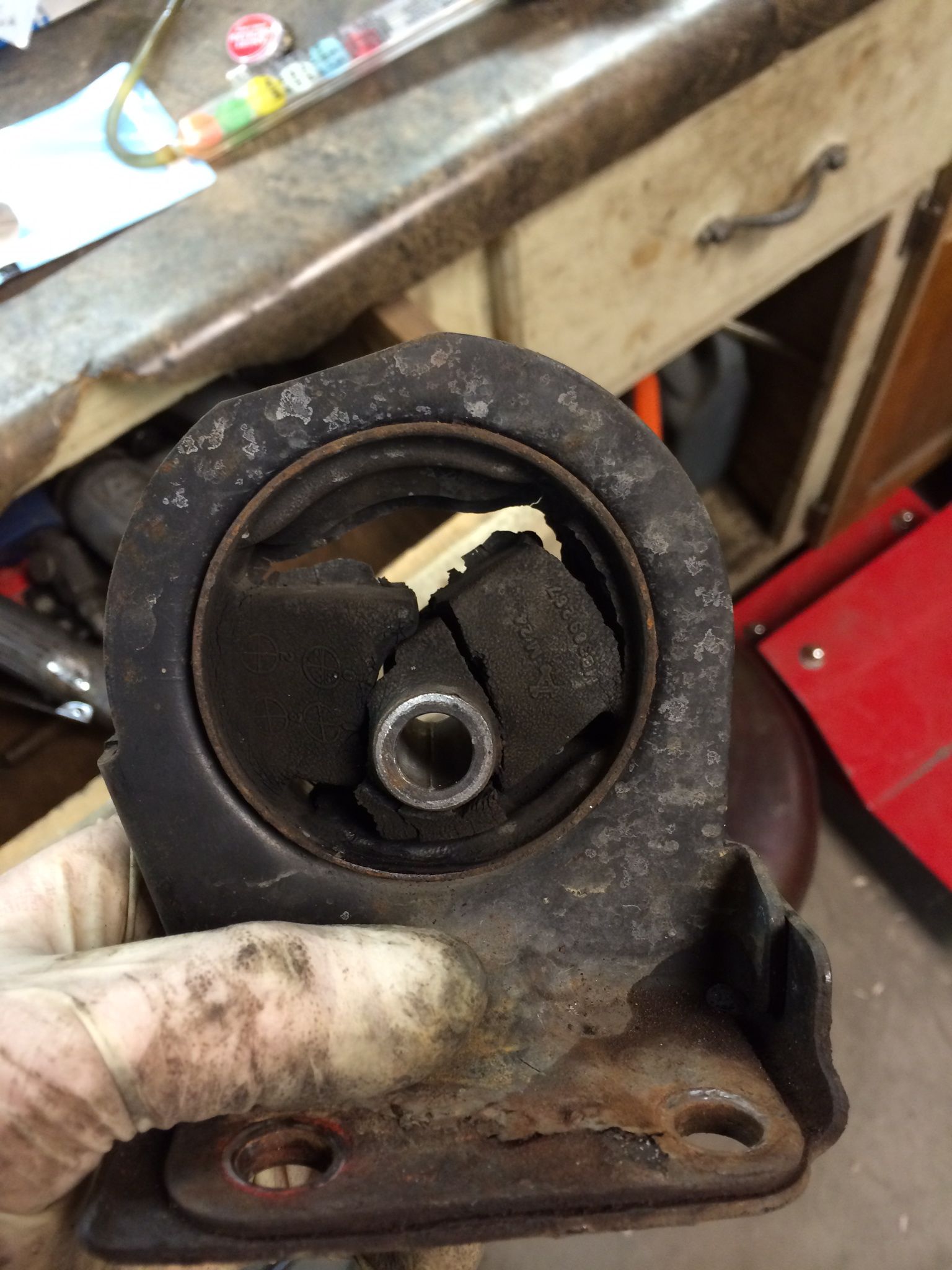

And broken motor mount:

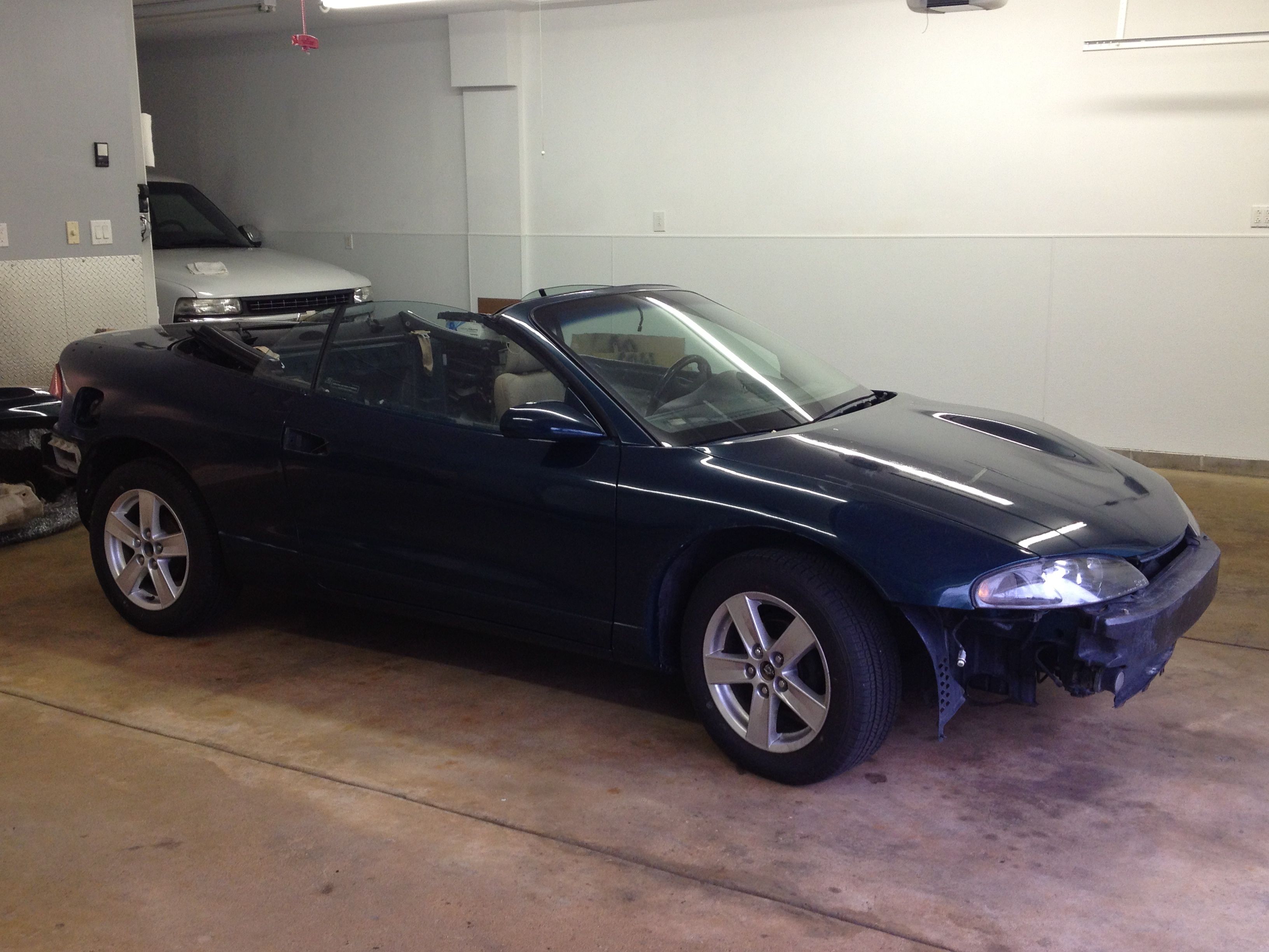

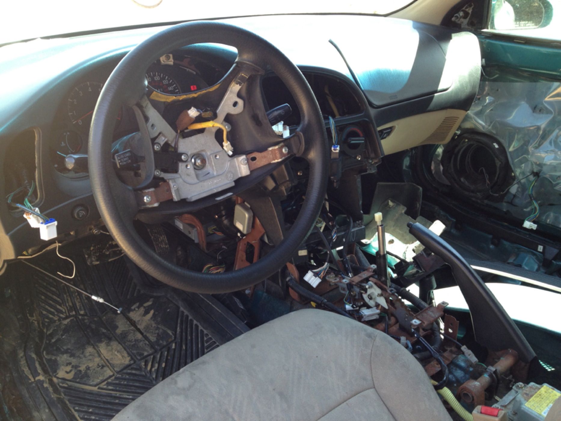

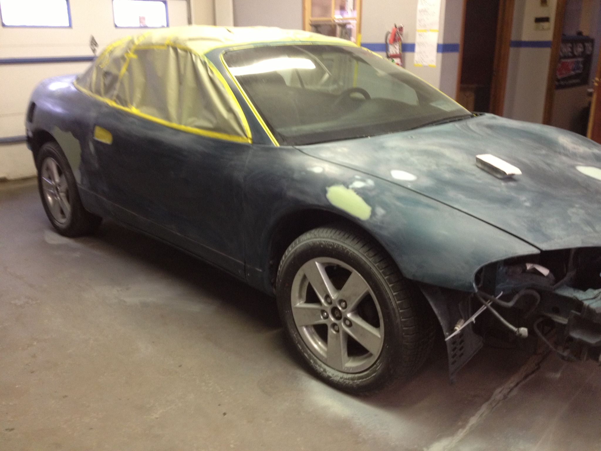

D. Exterior Paint: Time to strip the car down and get it ready for paint!
Interior first:
Body next:

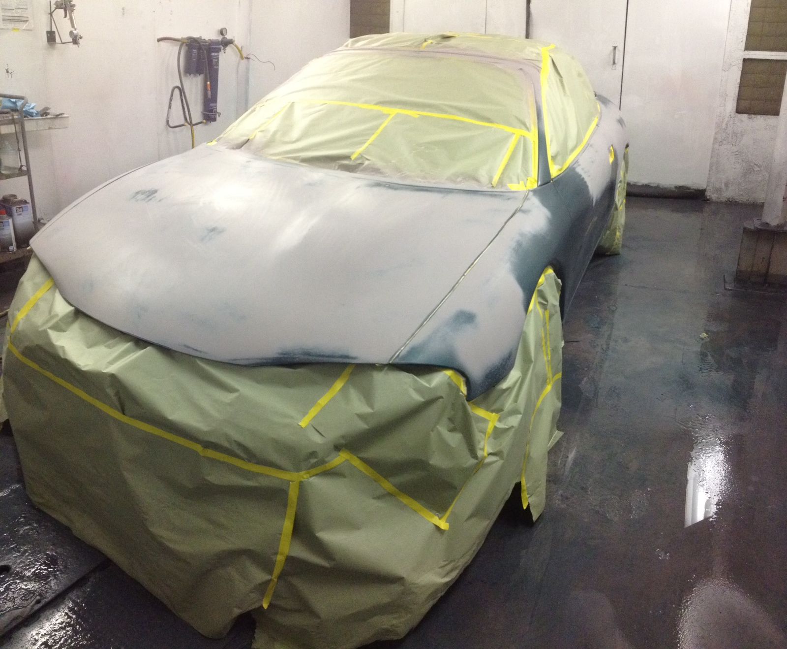

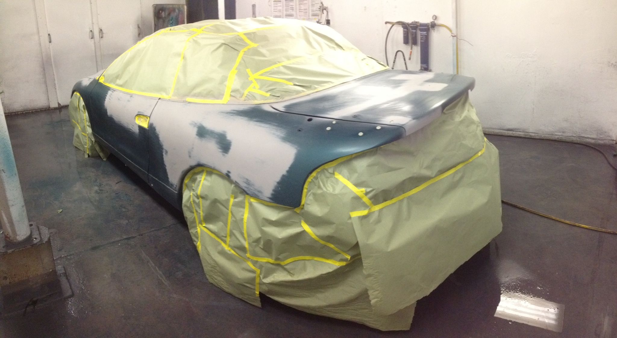

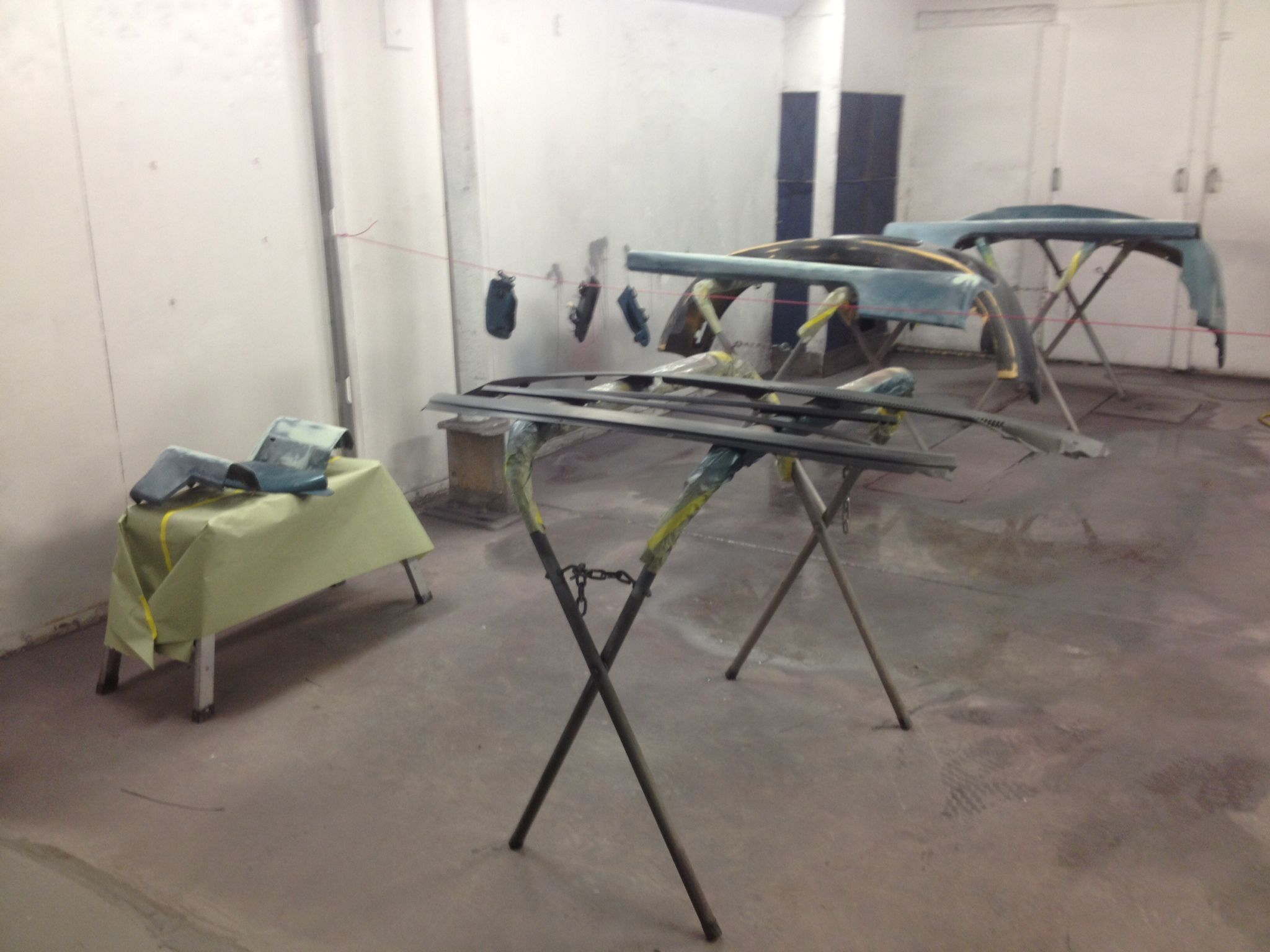

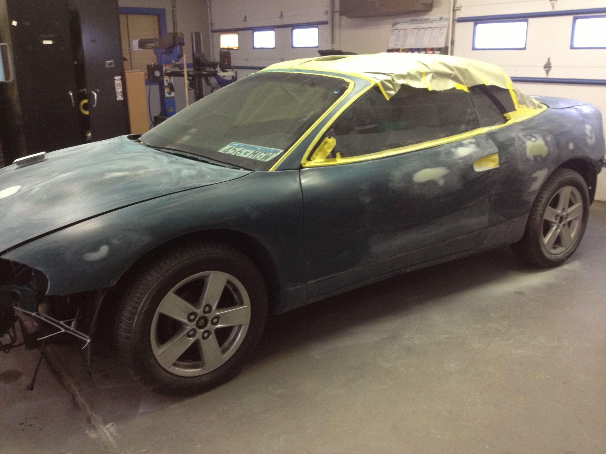

Repairing dents and prepping the surface:

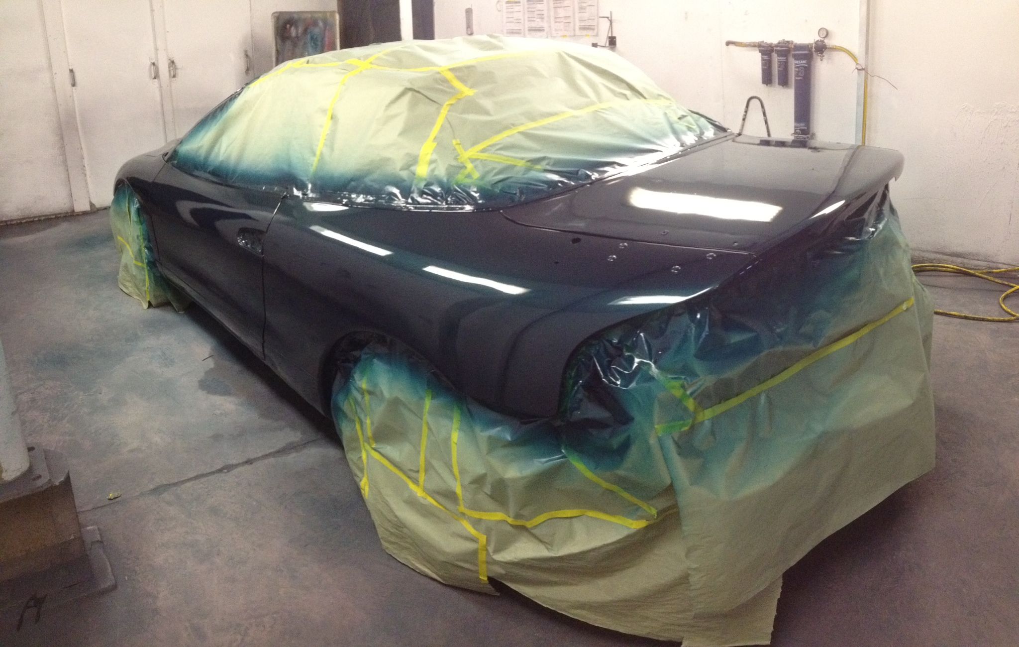

Next: Into the paint booth for blocking and sanding and primer

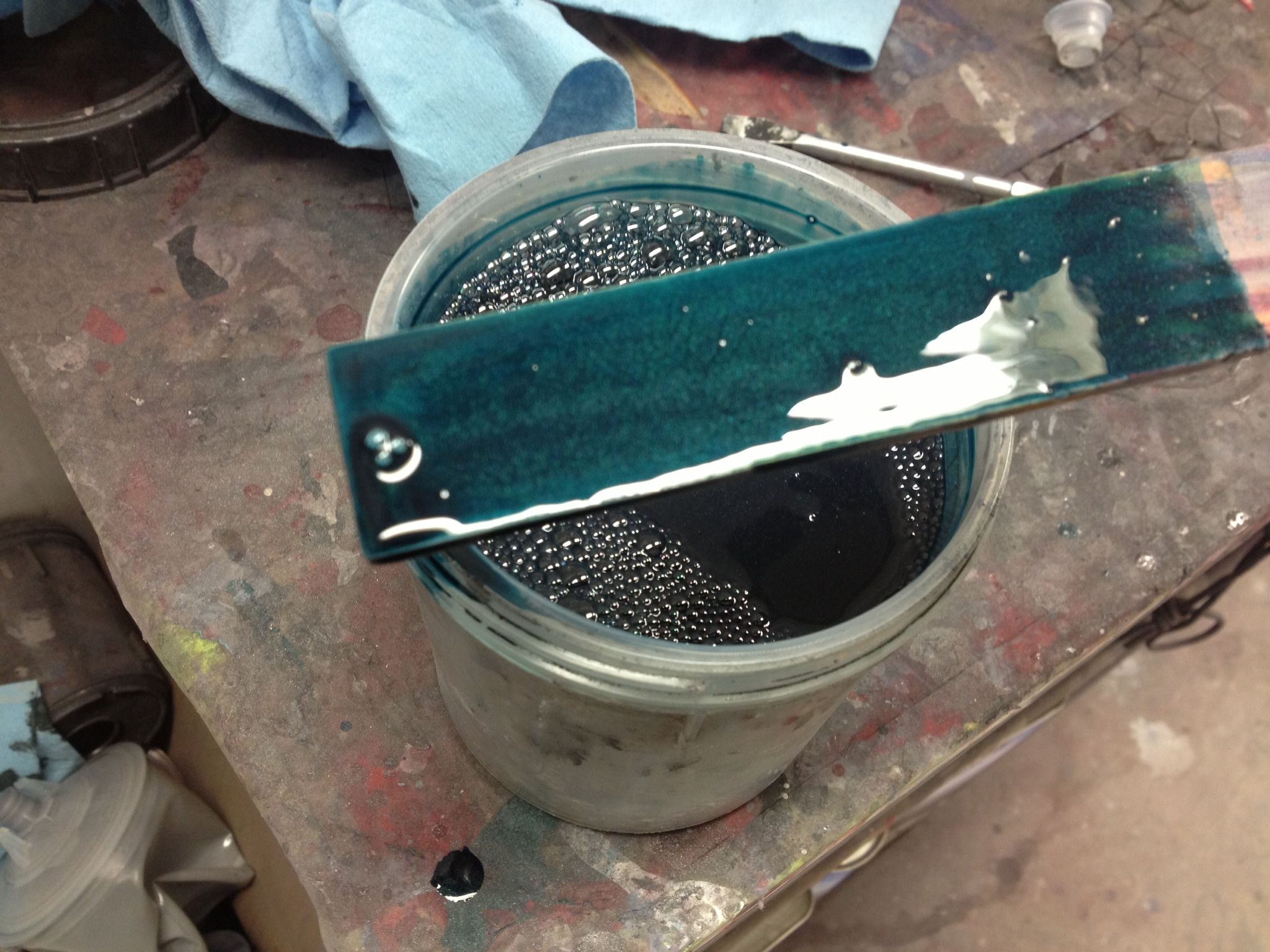

Picked out a custom color that is a little more blue than the original Emerald Pearl, but not so different that I had to have the jambs shot too:
And finally, shooting the paint!
Three coats color and two coats clear. Turned out great!

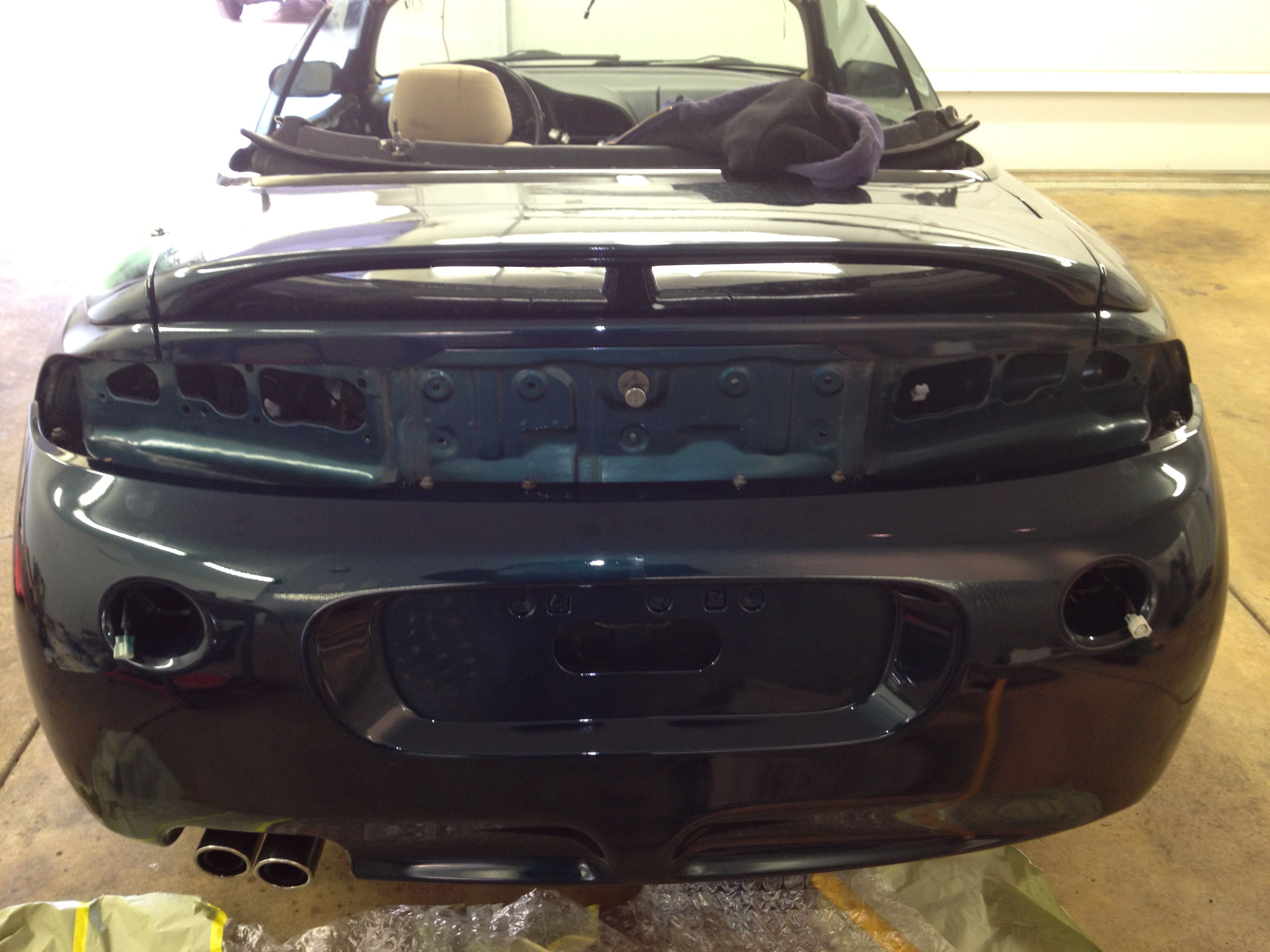

Now, exterior reassembly, with the help of a good friend:

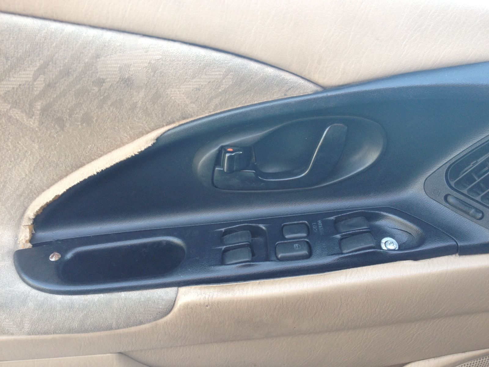

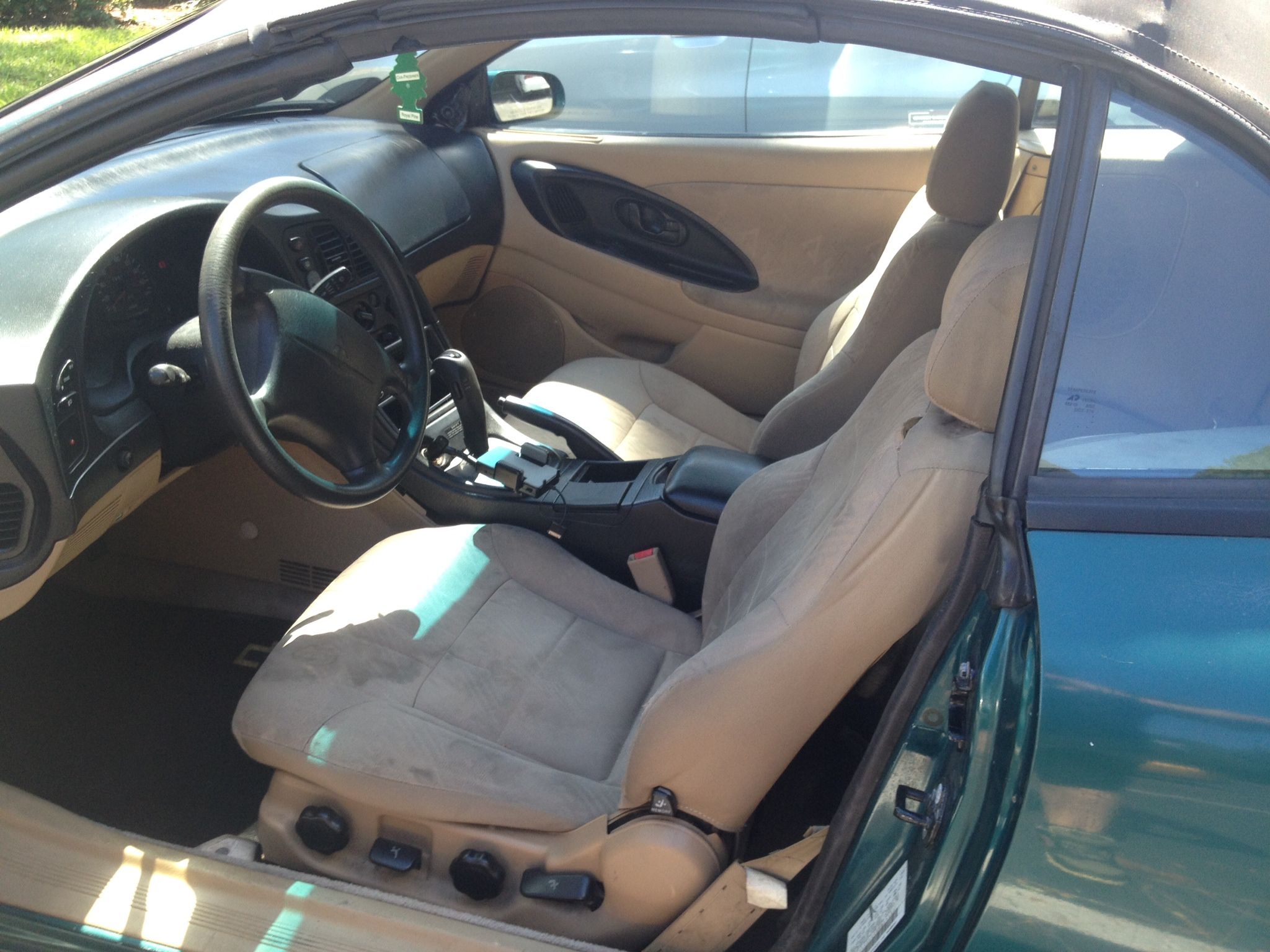

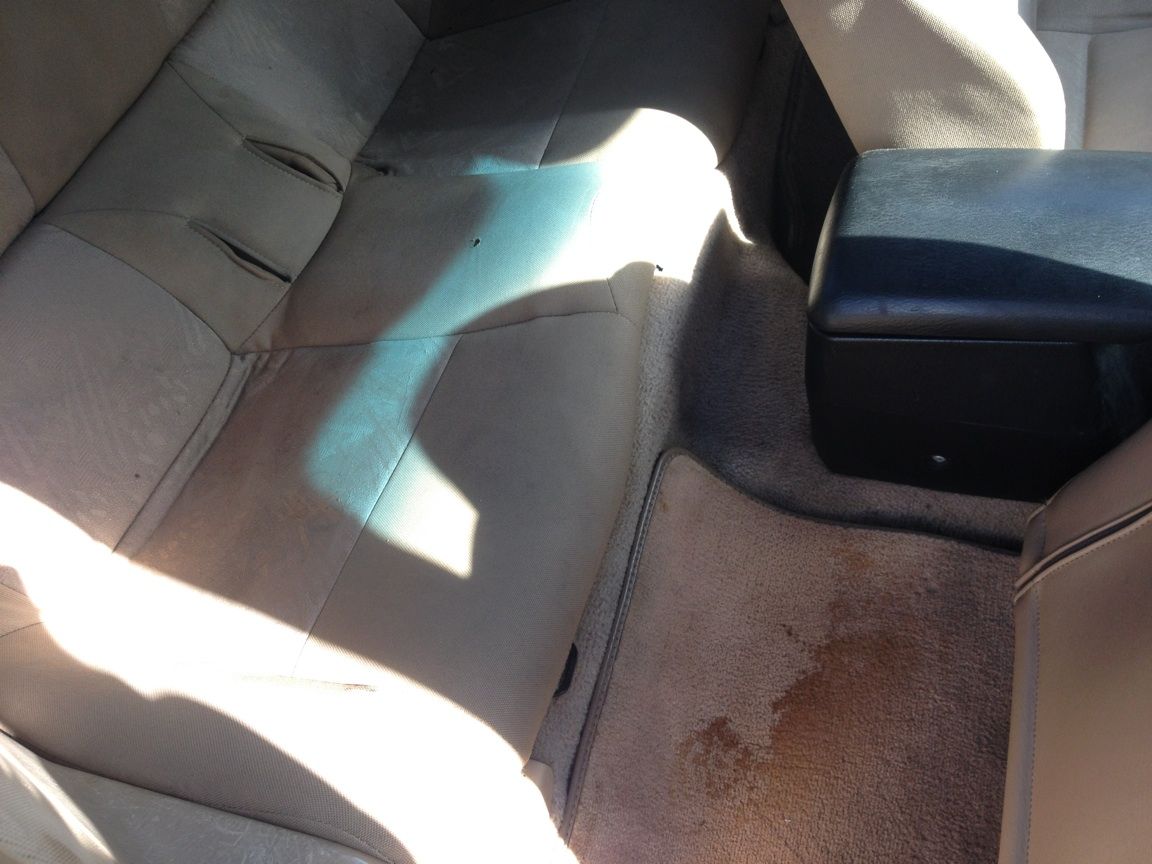

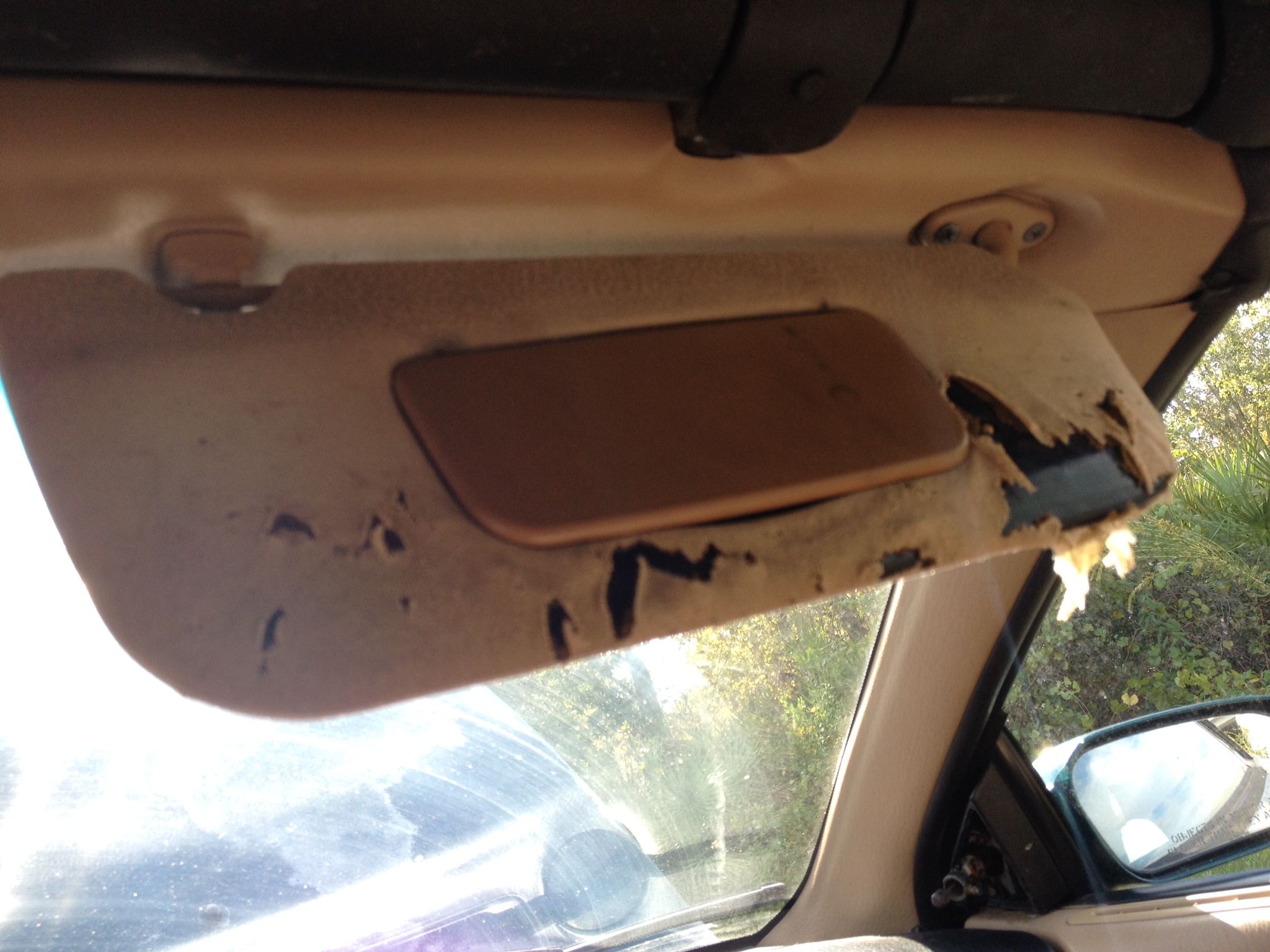

E. Interior had some issues. Here are the ‘before’ pictures:
The carpet and belts could be removed and scrubbed, but the seats and visors were beyond help, so I got busy contacting members of this forum and local dsm guys. I bought visors in perfect condition and leather seats.

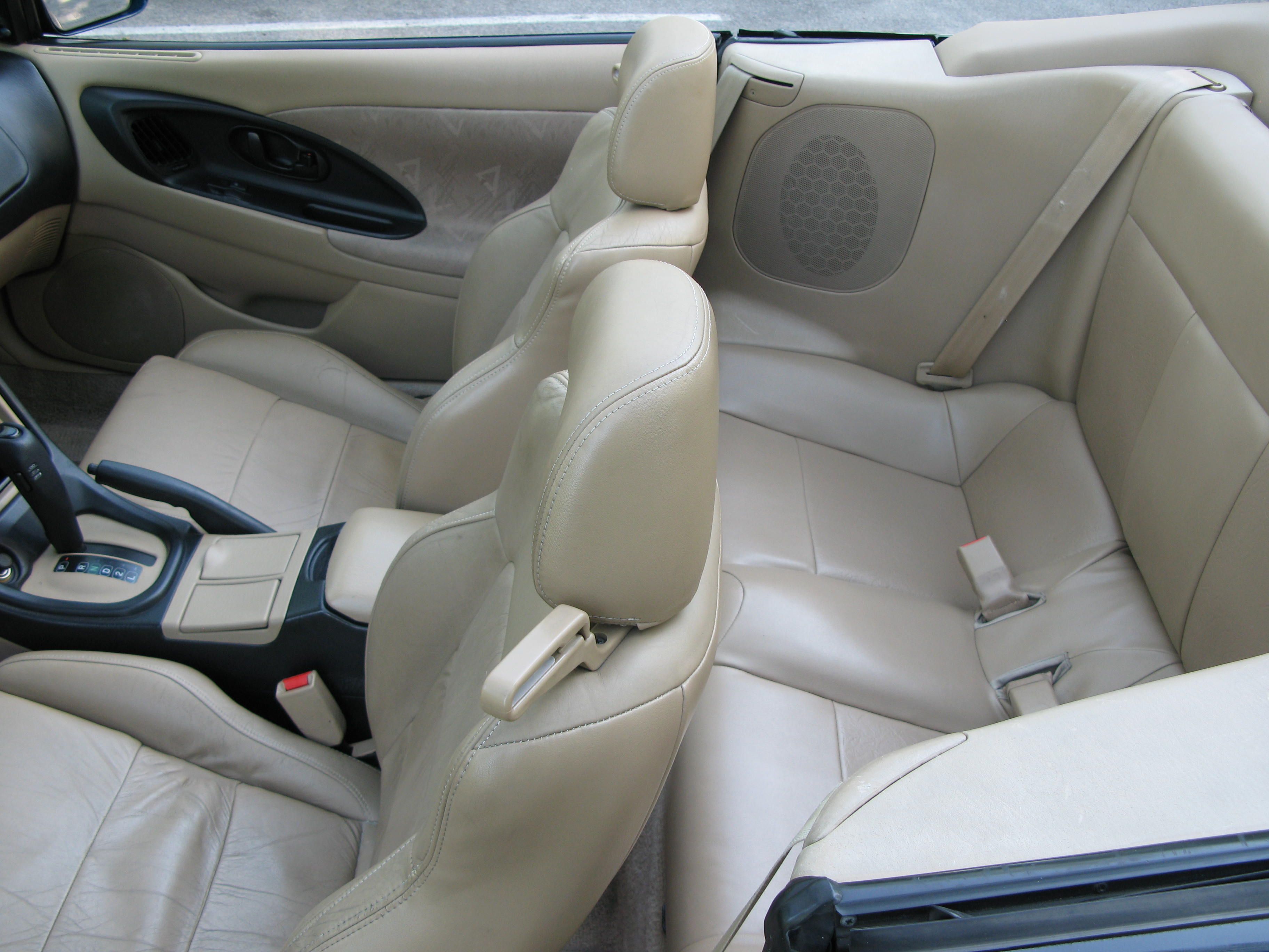

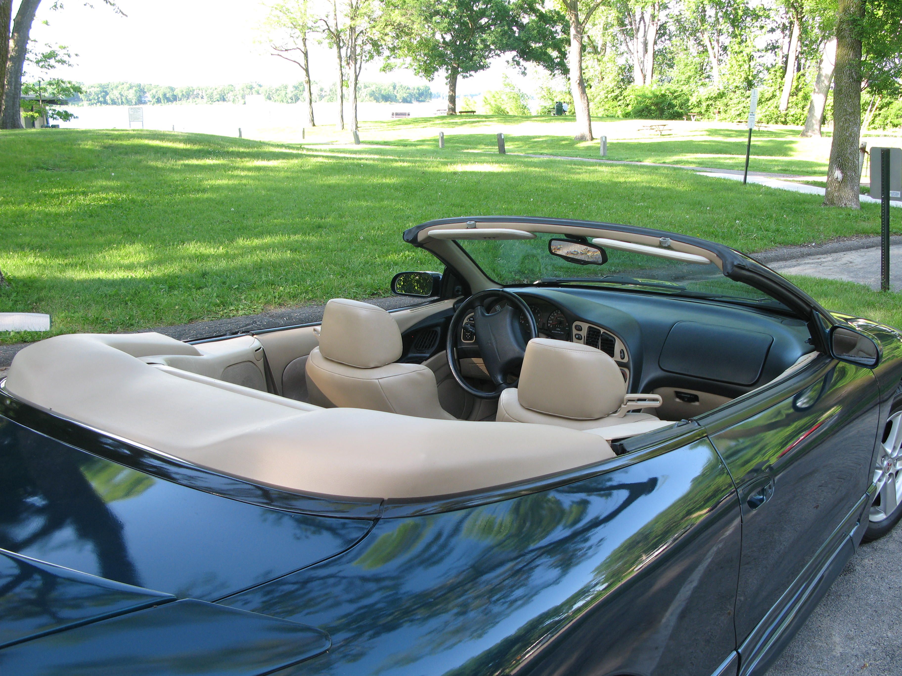

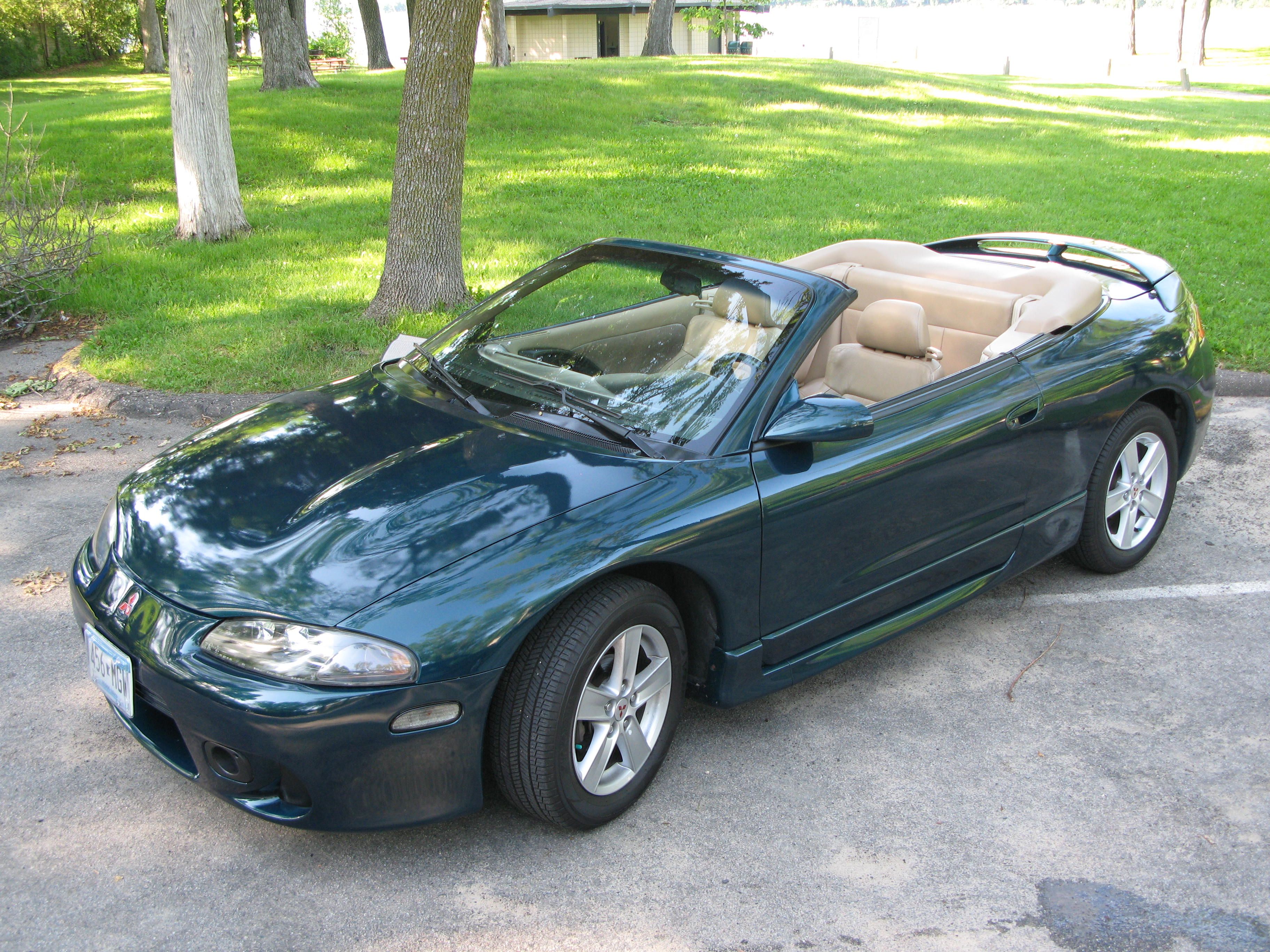

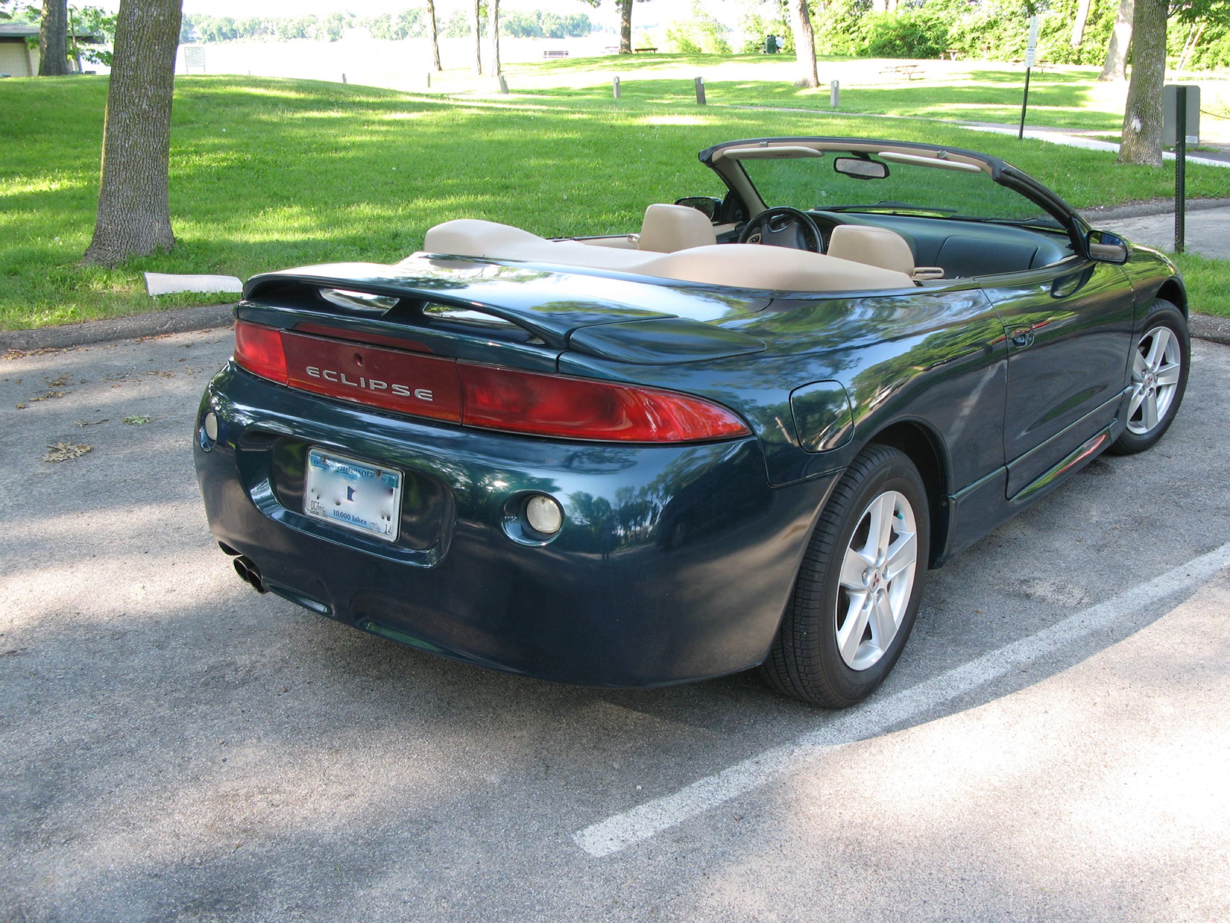

Here are the ‘after’ pictures:
All back together!

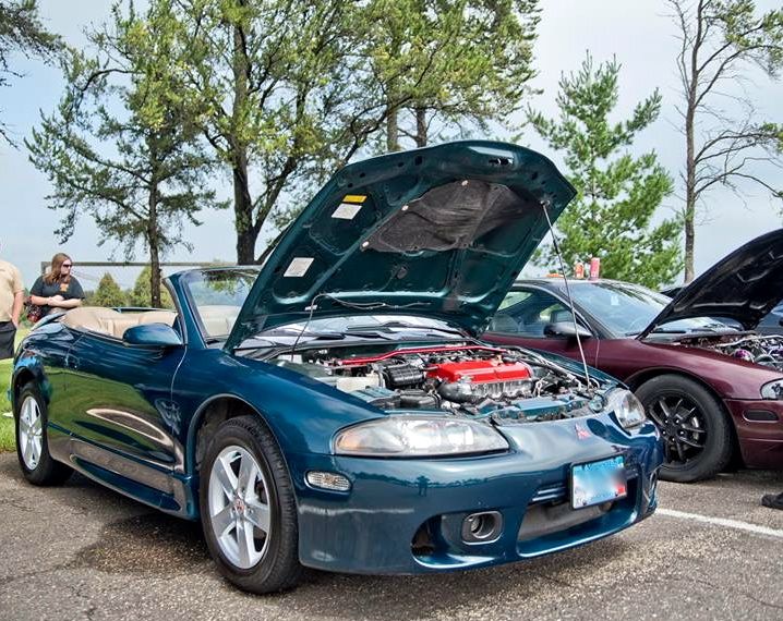

And now for the real surprise: I presented it to my wife for our 25th wedding anniversary! We both enjoying driving it. The 2.4 n/a is a great engine for this car. Enough torque and power to keep it fun.
When it goes into storage this winter, I will pull the engine to rebuild it just to make sure everything I can’t see, is also in excellent shape.
Thanks guys. As in every build, you get in the middle of it and wonder whether it will ever get done, and will I be happy with the results? In this case I had the added pressure of a definite deadline date (our anniversary) and the question of would my wife like it. I made the deadline with about 45 minutes to spare, and both of us like the way it turned out.
We're having even more fun entering it in local car shows and meeting other Mitsu owners.

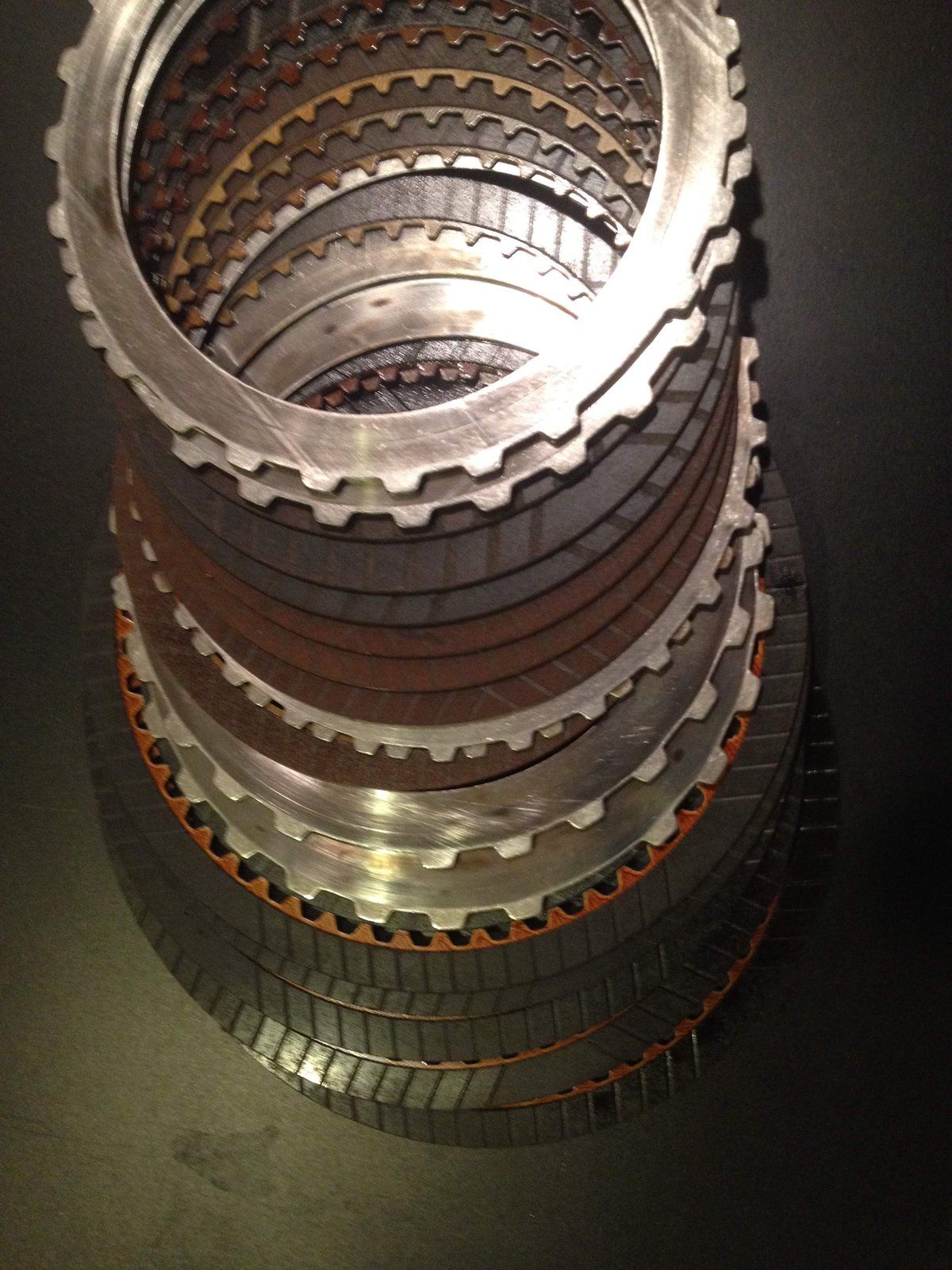

You can see that the clutch packs were in pretty good shape. Those that were part of the end pack set, were just replaced. But they all got replaced anyway.

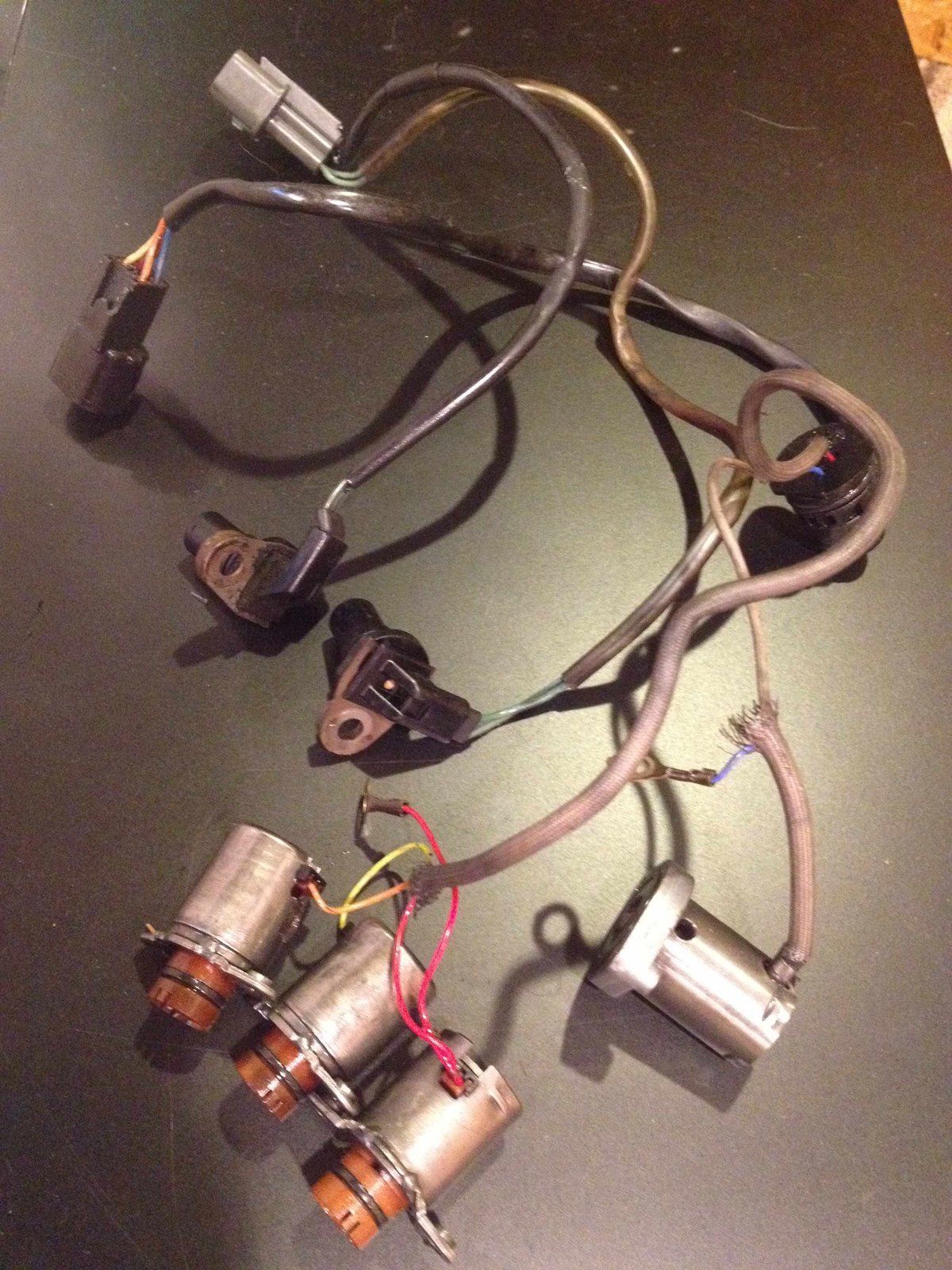

Although it was working apparently correctly, the solenoid harness was pretty cooked form the heat and years of service

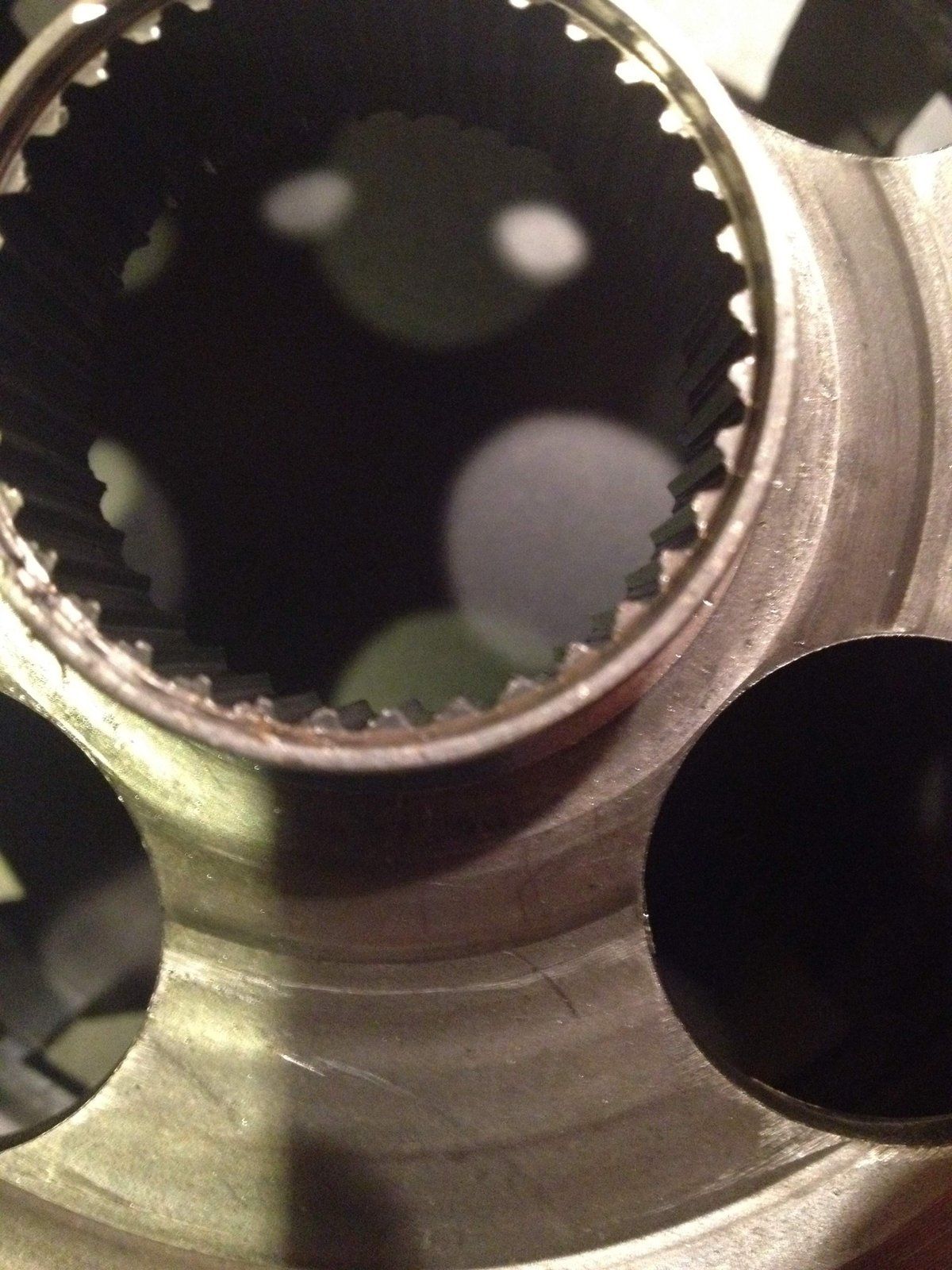

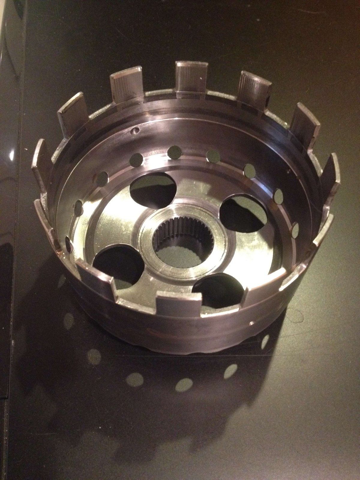

Even the clutch basket and pawls were looking pretty good
...until a closer look

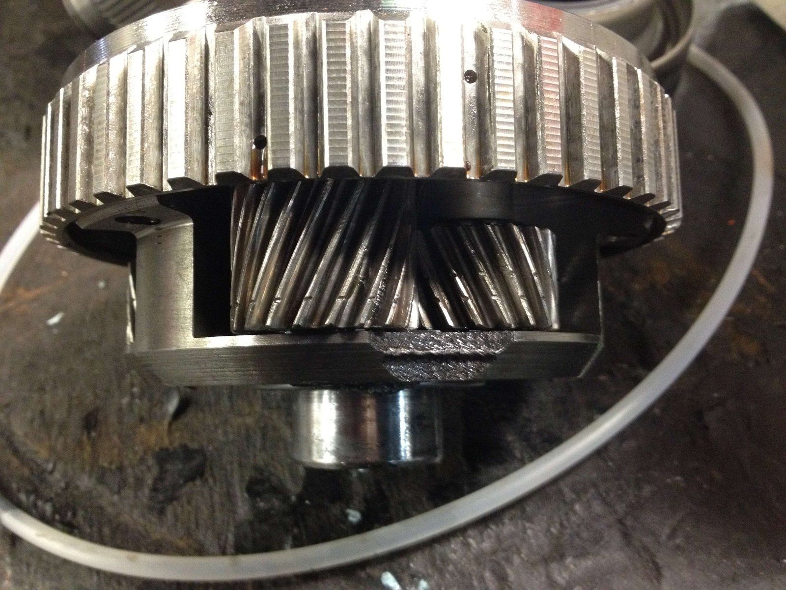

You can see that the spline teeth were ramped, wearing heavily on the driven side. This is a very common failure point on the Mitsu auto trannys since they were not always properly hardened.
More bad news: The main planetary gear set looks like a carrier fragment got into the gears and damaged them before being ground up.

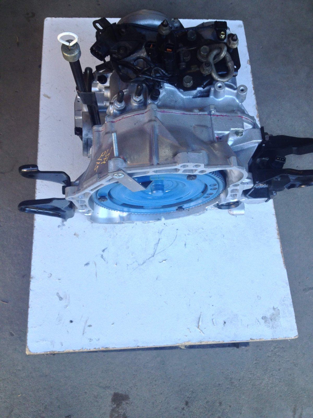

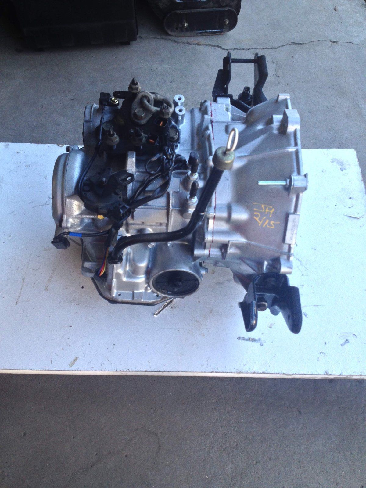

Here are a couple pictures of the finished transmission ready to go, waiting for the engine work to be finished.

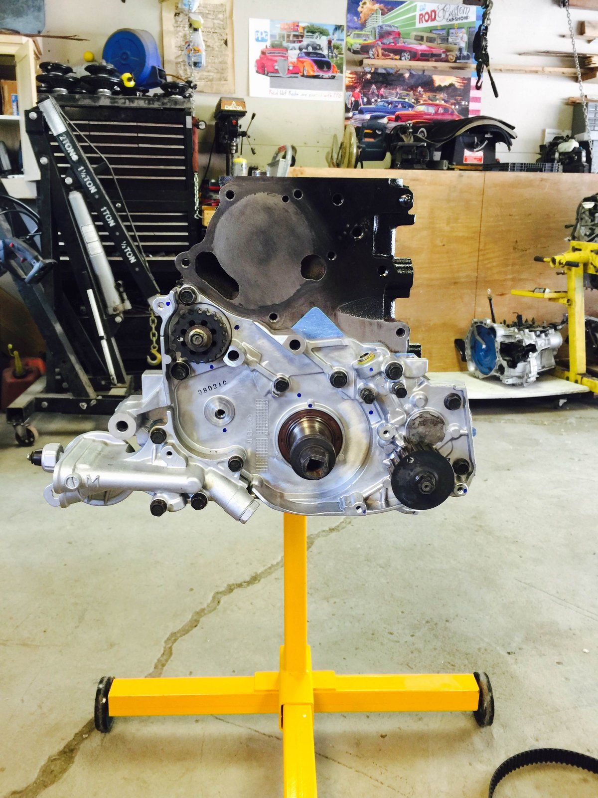

The goals for the rebuild were simple: Go through the block from top to bottom, stay N/A and SOHC, and reach 200whp if possible.
I discussed the goals with our engine builder, Aaron Lindeberg from Aaron's Precision Machining. He has rebuilt several engines for us over the past few years, including a few 4G63s, and he is very exacting with his work.
Based on the goals, we decided to raise the compression ratio to 10.25:1 by decking the block and milling the head. Of course we would be installing .020-over pistons. Unfortunately, no higher compression pistons are available for the 4G64. Since we would be keeping the head, he would port and polish the head passages and port the intake manifold throat to match the 62mm throttle body that will be installed. At some point, we could install a more aggressive cam if we are not satisfied with the results.
The plan also included reflashing the black box ecu to wring every last hp out of it. So to be on the safe side, I picked up a knock sensor and added the correct wiring to the car's engine harness.

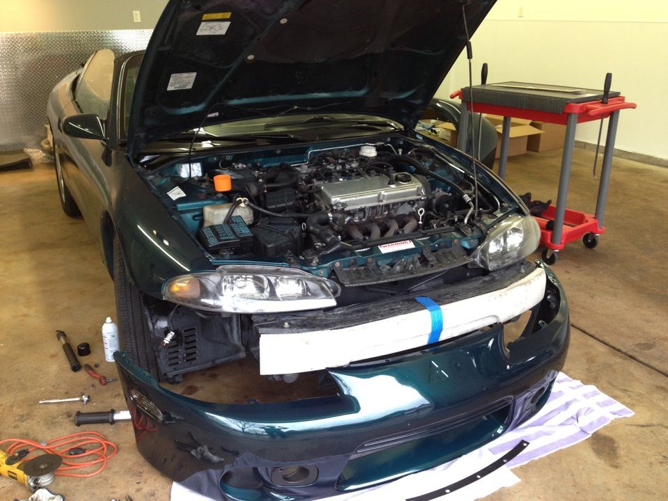

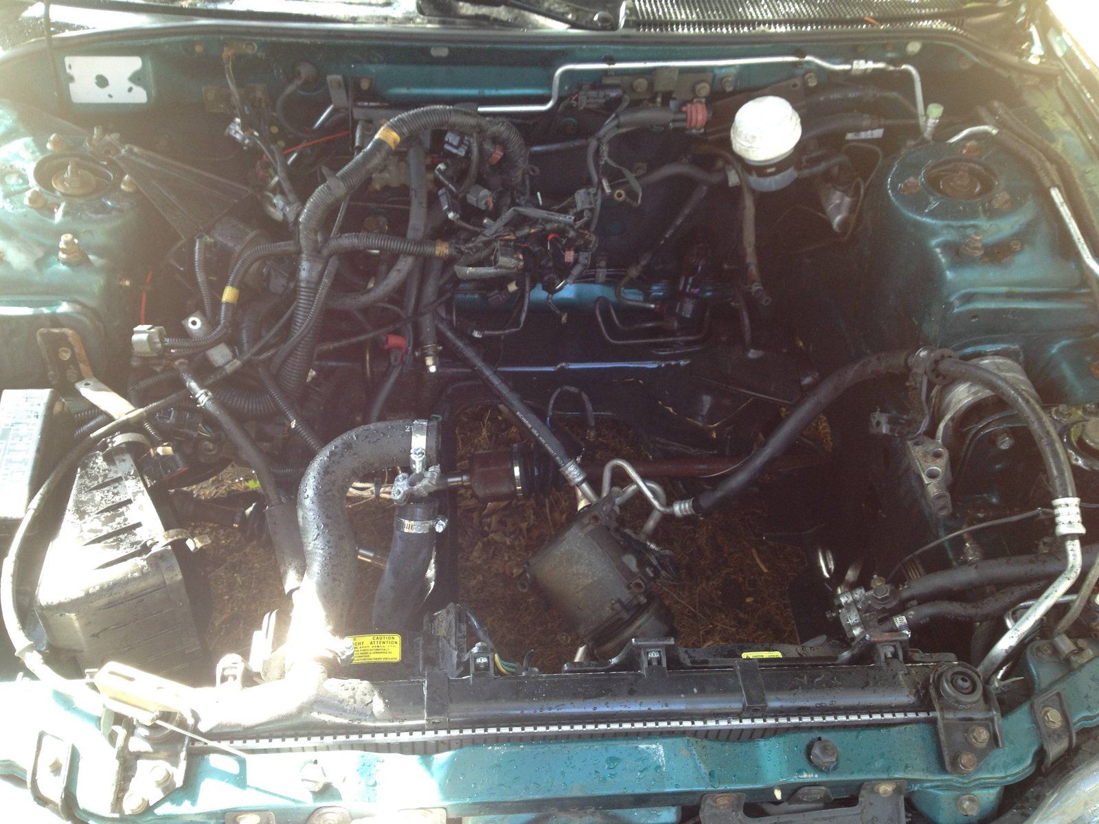

The bay was pretty clean, but we'll be doing a wire tuck and some other hose re-routing to clean it up.

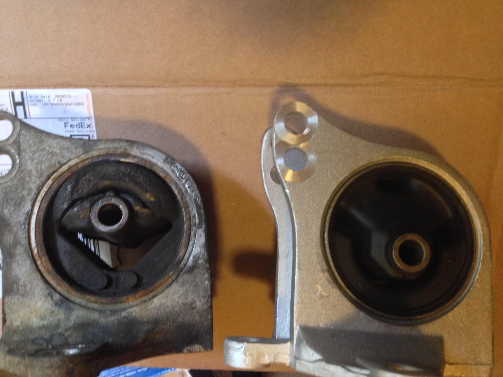

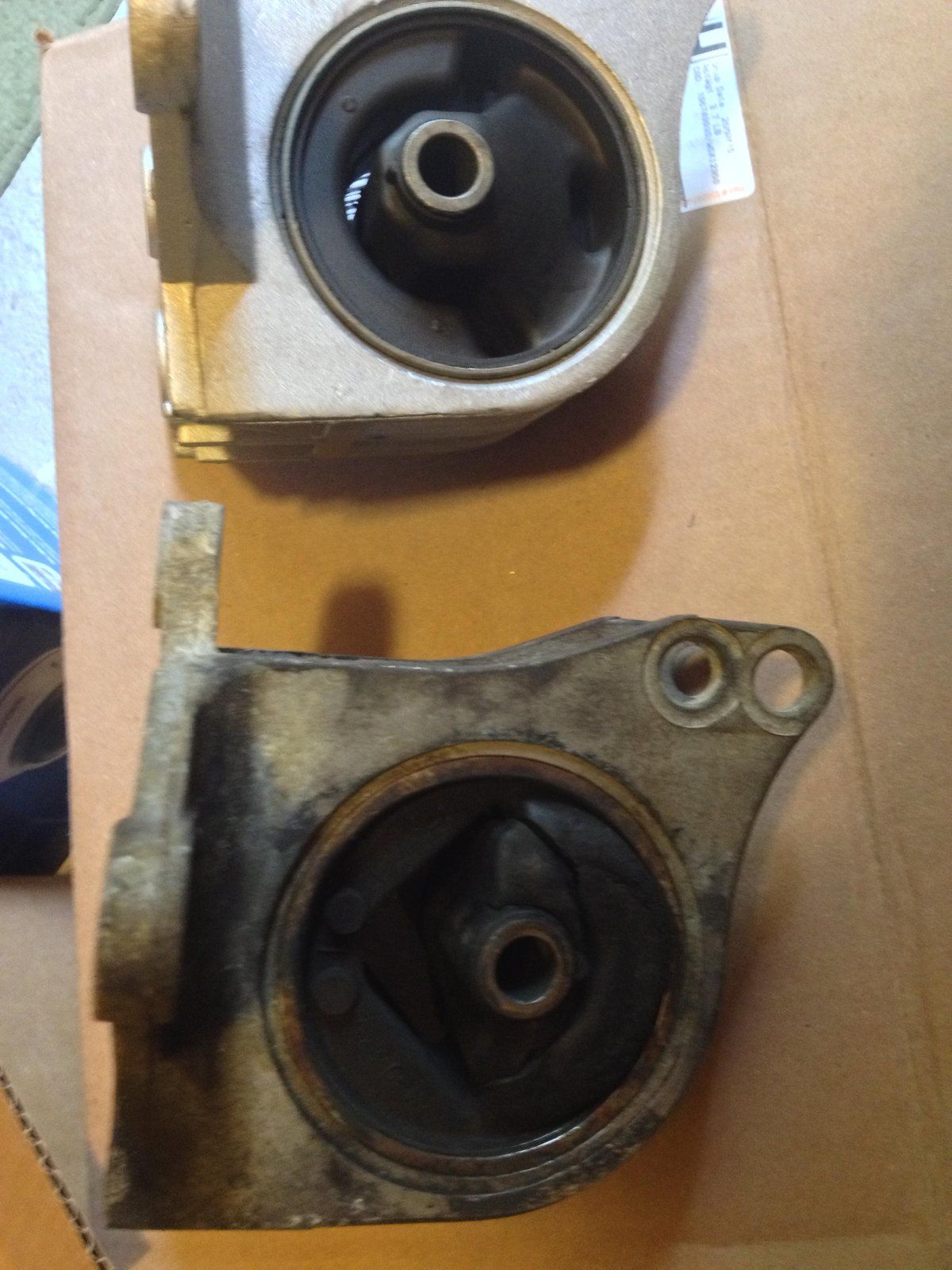

Every single motor mount was broken! These pics show the new vs. old.

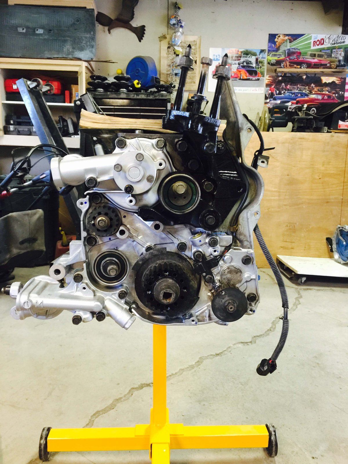

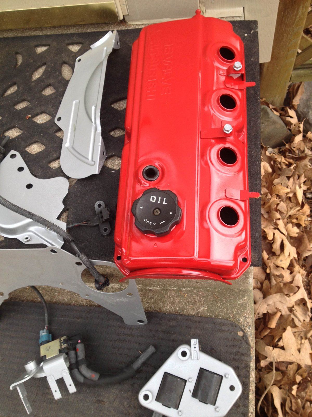

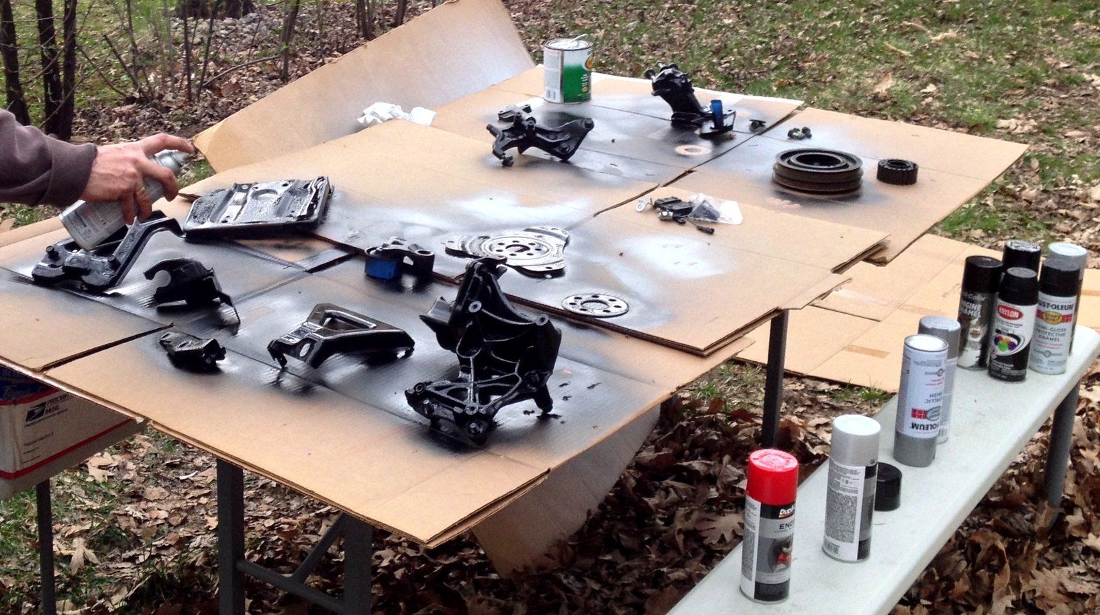

While the engine was at Aaron's shop, we took every single piece out and off of the engine. Every bolt, bracket and part was chemically de-rusted, cleaned and painted with high-temp rust preventative spray. Yes, powder coating would have been nice, but we opted to put the money into the engine and trans upgrades instead.
THe engine bay needs a little color. The red is a nod to the DSM family.

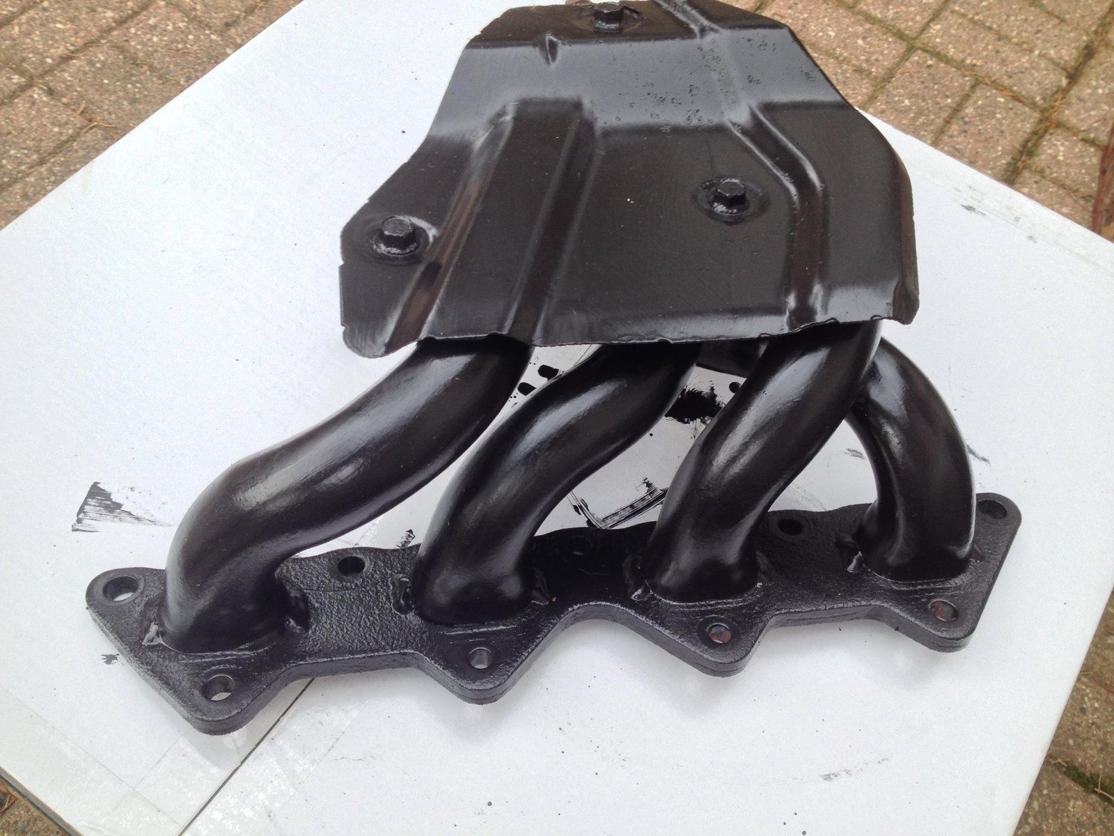

Header paint. I know they won't stay this way, but even cooked, it beats the rust color.

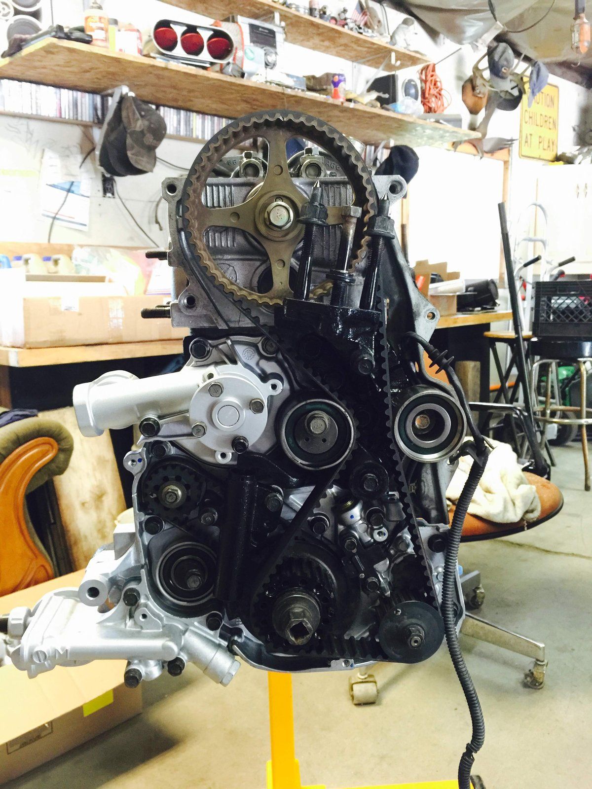

The engine is back and we're starting final assembly. All new components at the same time.

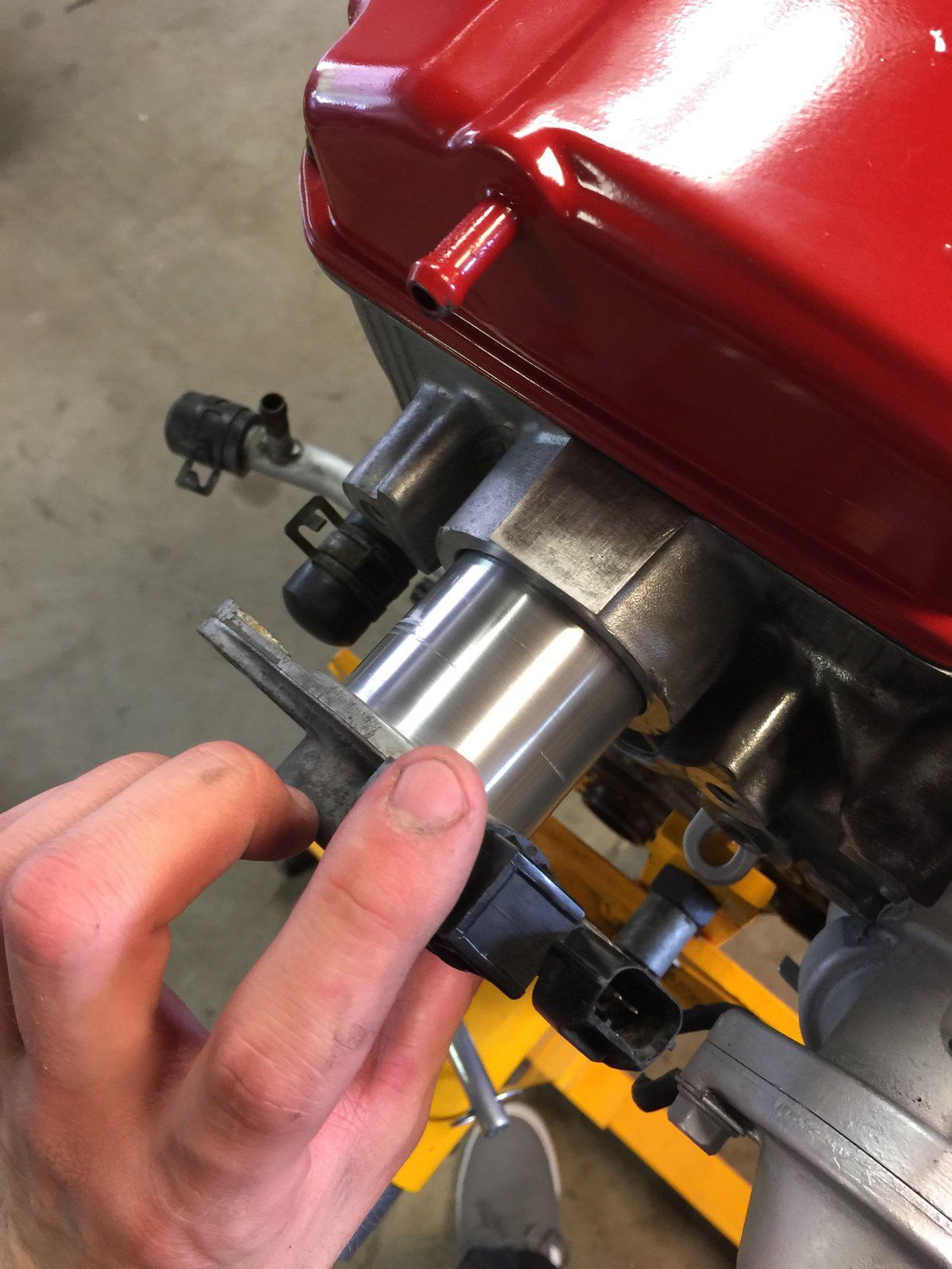

The cam angle sensor was tough to get in for some reason.
The engine is complete! Now it's time to tackle prepping the engine bay.

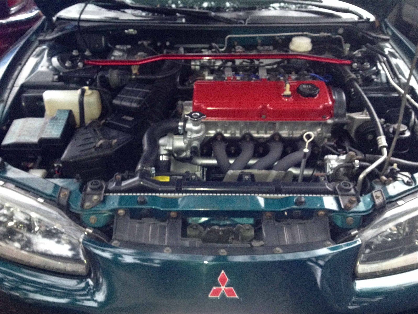

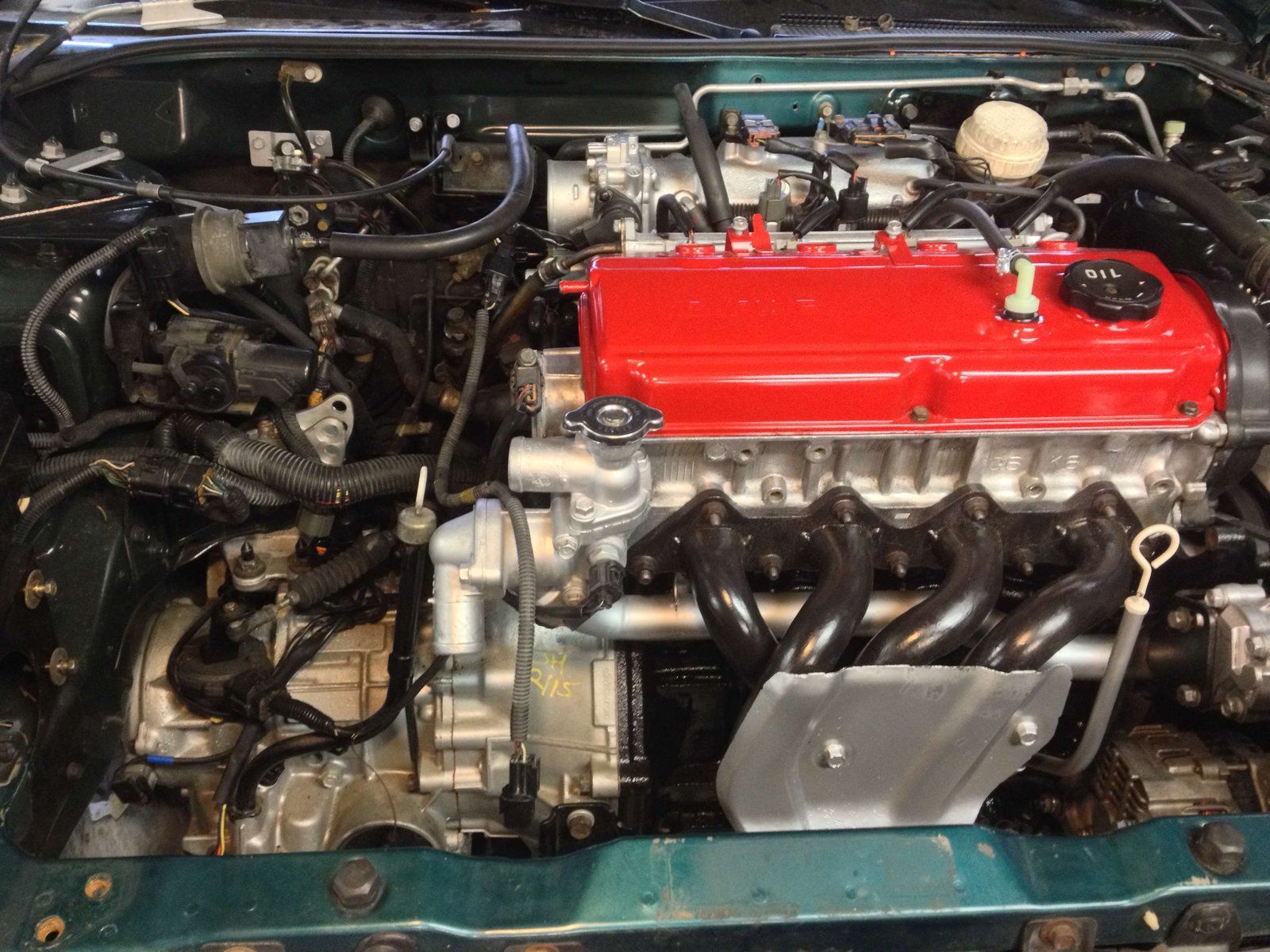

Engine and trans mounted. Trying to make sense of these endless wires and hoses.

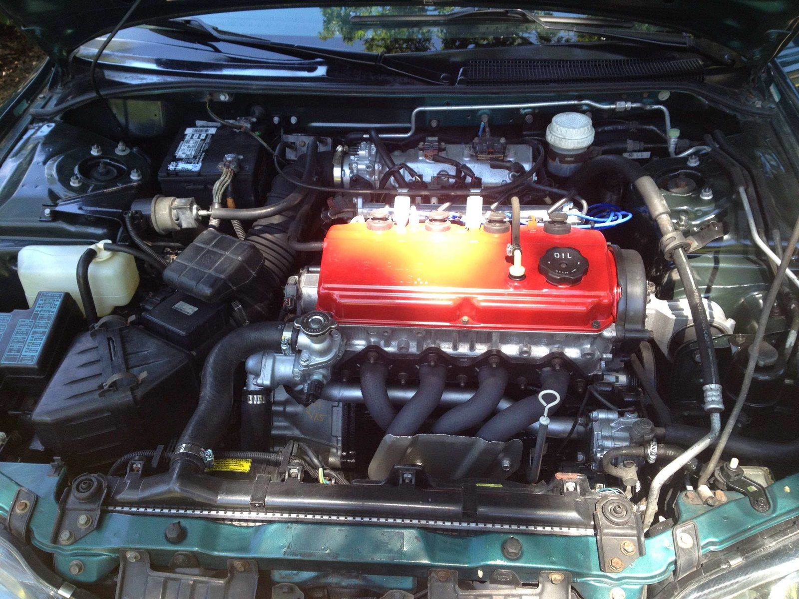

90% of the way there. The sun came out, so we backed it out and took some shots that show the refinishing of the engine bay.
To fully appreciate the final result, here's a before and after pic of the engine.
Before:
After:
We did some comparisons, and it turns out that the stock filter element actually flows more air than the cone style filters. So, we removed the restrictive air snorkle from the stock air filter box, and installed a 3" flexible tube to collect fresh air from the right hand bumper opening. The intake temp is nice and cool and the airflow gets a little help at speed. The hose attaches right to the round opening of the stock air filter box. Here you can see the intake end.
The engine runs beautifully and the trans shifts consistently, two things that couldn't always be said before the rebuild. The torque increase is noticeable right off the line. The upper end horsepower is improved which you notice because the RPM wants to keep climbing. EvoFlash logging gives you confidence that everything is running the way it's supposed to.
