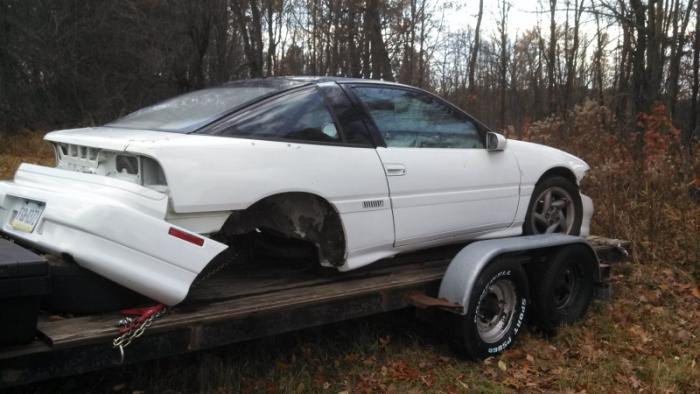

To put on this new fella
Why you ask? Because I got a steal on it with a 6 point chromoly rollbar already installed. And, because old blue isn't as pretty as 95talongirl's photo's portray. She has some pretty decent rot hiding under those side skirts, and a nice rust hole through the floor of the trunk, and another rust hole in the passenger rear fenderwell. I was seriously contemplating doing my best to fix those issues and have a rollbar setup installed in it, but then this came available.
This shell has very minimal rust. A few scratches, dents, and dings but overall it's in much better condition. A lot of the weight loss stuff has already been done although I'll be going over it thoroughly of course. It has a sunroof which is why I plan on swapping the roof skins.
The plans are staying the same in general, lighten this new shell up as much as possible, swap in everything from the blue car, and try like mad to go 10's on the 14b in an awd!
But, saying goodbye is going to be tough! And this isn't going to happen overnight. I plan on doing a lot of cleaning up on the shell before I start installing things. I also am looking at getting a few things (like a fuel cell) done before it's moving under it's own power. That means pulling from the car budget which is slow growing. Having it tore down this far means I can do it all the way I want it right from the get-go. It just means it probably won't be out for our tracks opening days.
But Shane, that rust is weight reduction. :sneaky: Now you'll need more power!
The new car does look very nice though, not going to lie! Looks like Brian's; but this one will actually move this year... er.. 2014 ;)
seen the pic on your FB pic.....You can still sale old blue. Stocker guys buy him all the time or dirty racer
Possibly, but if I do swap the roof skins I probably won't take the time to put the sunroof one onto the blue car.
Gotta love white! When do you plan to have it up and running?
White has been growing on me. I don't have an official plan on time yet. Part of my thought process is to do it all right from the get-go, which may mean taking more time so I can afford the new parts I want to add. My do or die date is smoking down the 1320 by at least the shootout!
I have some plans for extra weight loss. I truly believe it may come in lighter this year, even with the 6 point in the new shell. Power shouldn't be a problem either as Link V3 is on the way now! Plus I'll be trying to find new and exciting ways to increase power production elsewhere. And yes this car will move "this year" meaning 2014! :rocks:
This the start of an all out 14b drag build??
Well, that started several years ago with the blue car ha ha! I just add new pieces every year as the budget allows. But you could call this a little more extreme. I do not plan on putting this shell together with a stock fuel tank setup, so a 1 gal. fuel cell setup is on the shopping list. The car has a current lexan hatch window that I hope to swap to my carbon hatch. I want to do the side windows in lexan this year. And I'm going to get a little more extreme with the other weight loss stuff (dash, wiring, spot weld cutter). But, still no motor build planned so not really full-out yet. The plan/goal is that 10 second pass. How deep I try to get is going to be based on the roadblocks faced and motivation levels!
Sweet build whats funny is I saw your car in Jackson at a apartment complex, good job on the ecmlink help, I have full now and getting ready to get it tuned on sd here in town soon. Great work Ive been following you and this build for some time now, you've grown a lot, Props man, hope we can meet up sometime were not to far apart from each other.
