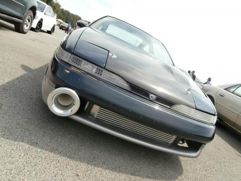

I also built myself a forward facing ram-air intake setup after doing a little test one with positive results. More info on that can be found here.

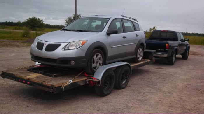

Last weekend I went up north and took my dad's trailer and turned it into a car hauler. Took alot of work, welding, cutting, etc. But, we turned it into a pretty decent car hauler including a truck style toolbox mounted on the front of it! Used my farther-in-laws truck he's trying to sell to haul our car home on the trailer so we didn't have to drive both cars.
The talon should look good up there. The trailer needs some paint but we'll get there this winter. A little POR-15 will go a long way.

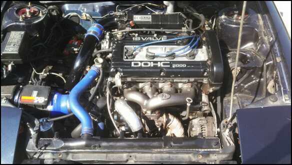

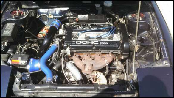

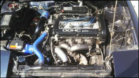

I've found some new motivation and it's time to get some work done. I wanted to add a second fan today but unfortunately I can't fit the second fan with my current LICP setup. So I put the new fan, which should be much better flowing then my old no name in. We'll see if it's enough to improve the cooling. If not I may be able to mount the old one as a pusher on the driver side.
I also mounted up the new FP Manifold a friend had sent to me to try out. I like the runner design better then the old 2g manifold, it definitely flows more with the larger runners, and it looks pretty nice in the engine bay too! I really like that the supplied gasket and the outlet are actually the same size as the ported inlet on my 7cm housing as the outlet and gasket on the 2g mani was smaller. Sorry for the crappy washed out cell pics.
Before
After

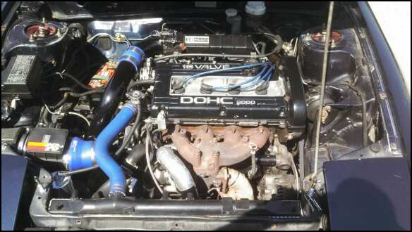

Before
After
To look at that and think it goes low 11s hehe.
The FP is so much nicer looking than the 2G. You gonna get it ceramic coated?? I just had my turbine housing and FP mani last week.
Well, it's not mine. At least not yet. If I do purchase one, or this one (owner may not end up needing/wanting it), I'll probably get it coated. Right now money is a little tight though.
Coating it and/or using the blanket can cause some premature cracking, that's the only downfall. I think this is more prevalent in daily driven cars.
Have you seen any FP manifolds actually crack? I was reading a post by FP and they basically said to go ahead and coat it, wrap it, blanket it, whatever it shouldn't crack. I know many other aftermarket cast manifolds were prone to cracking when coated or wrapped though.
I have seen one that cracked, but as Phil mentioned, it came off a DD car. It was on there for probably 30k miles or so when it was pulled off and found. The car was on a E3 16g and was just beat on day in and day out. I'm sure that didn't help it.
I found a thread with a couple examples of cracked ones, didn't seem to matter if they were coated or not. I think I remember something about a bad batch right around the time they were offering their coatings which they subsequently pulled. For how little I drive this car I think it'll be ok coated. I might talk directly to FP about their experiences before doing it though.
I haven't but have heard of cases. Not saying wrapping/coating doesn't help, my mani is coated, but, let's say I have a solid source that definitely votes against it as it does cause cracks on FP manis.
Might run a heatshield vs coating I called fp and was told it wasn't a good idea to coat them, if I do recall but I think Ill just grab a heatshield I saw a freelancer here and it looked good and was a good price in my mind.
