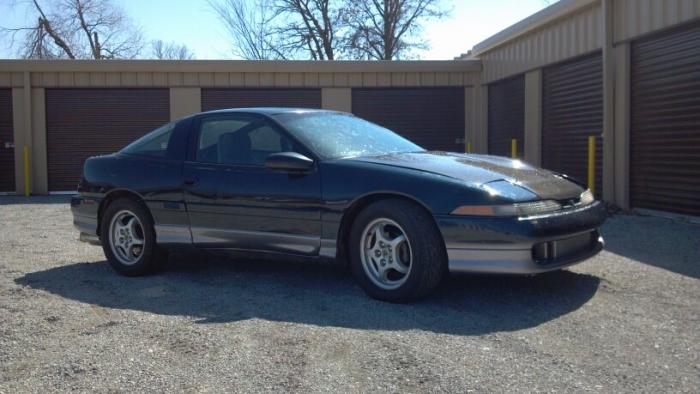

She's back under her own power! Took her for a quick trip to spray the dust off at the carwash. Alot of cleaning up to do still, alot of tacky stuff from the spoiler removal. Definitely not a fan of the appearance without the spoiler but this is all about weight now. Few issues after my wiring stripping, no tachometer and no blinkers. Need to retrace my stuff and see if I missed a ground or pulled a wrong wire or two. I was a little nervous about the four puck being grabby right off the bat but it seems to drive very similar to the street disc so far. So alot of little clean-up/finish-up things to get done but the motivation is high now that it runs again :thumb:

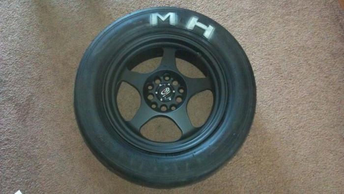

Rota Slipstreams 15x7 and M&H Racemaster Sicks 24.5x8.5x15 :sneaky:

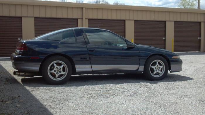

I've been getting other little things done on the car, removed some left-over sound deadening and some little brackets, probably 5-6 lbs total. Also made a door panel out of corrugated plastic for the drivers side, great borrowed idea from 9!'clipseDOHC. Unfortunately my local home depot didn't carry as large of sheets so it's not as clean as his, but it still covers all sharp metal edges. Hopefully the wheels/slicks will be arriving next week and with the swap back to E-85 and a couple runs to check the tune I should be ready for the track.

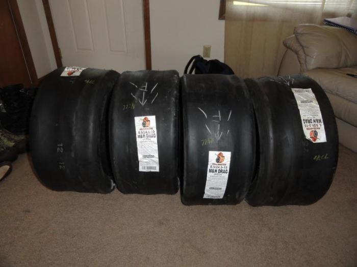

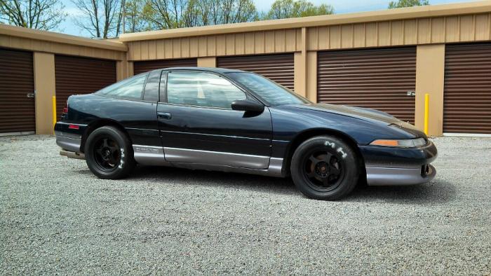

Slicks are mounted and ready to go! 27.5 lbs a piece according to the bathroom scale, close enough to make me happy :rocks: Actually a touch lighter then the borrowed combo from last year. I'm hoping for a track visit this coming week, we'll see how it shapes up. I still need to pick up some lug nuts for these, the hubcentric rings, and apparently the tire shop still has two of my center caps. I really hope they didn't do something stupid and lose them. My wife picked them up and it wasn't noticed they weren't there until I got home after the place closed. :ohdamn:
I think I'm in love! Could probably stand to be lowered more, but it'll do for now. Now it's time to hit the track! Hoping within a week or so if I can get a day with good weather.
