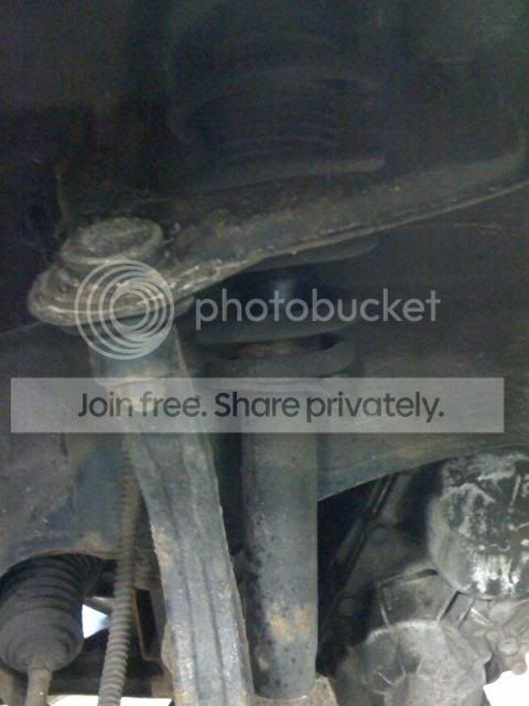

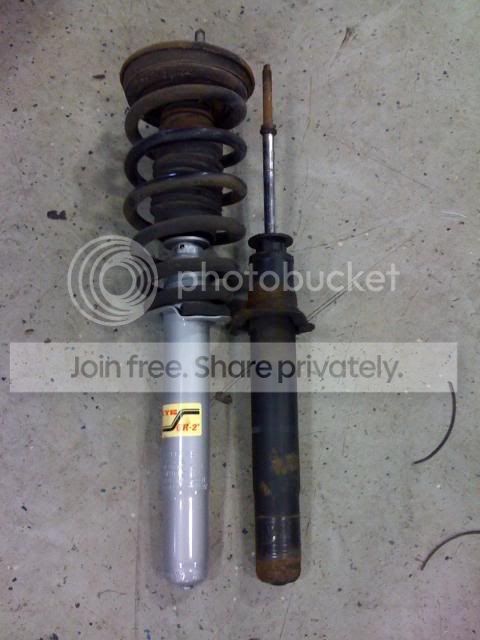

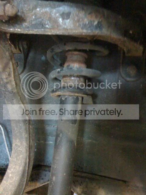

Here's the stock shocks:
Front:
Back:
Blown, rusty, leaking, take your pick.

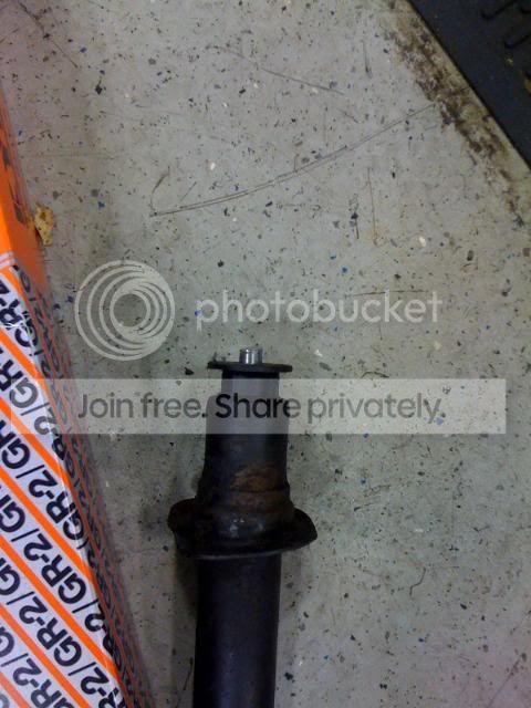

They came off without further issue, but then the fun began. You see, the collar at the top of the strut was fused on to the strut, making it impossible to get the strut and the spring apart.
The cutoff wheel made a reappearance, as well as the acetylene torch (for heating).
This was done to one of the front shocks, and BOTH of the rear ones.
The collar was then heating to glowing, and he used a vice and hammer to separate the parts.

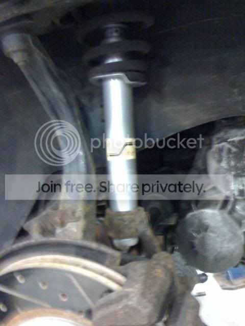

After THAT, putting things back together was easy.
We got evberything back together, and the car now actually sits higher than it did before. It feels firmer when driving in a straight line, but the body roll and dive under braking is a bit disconcerting! I know a there's a Koni/GC future out there, but I wanted to get back into shape for this season.

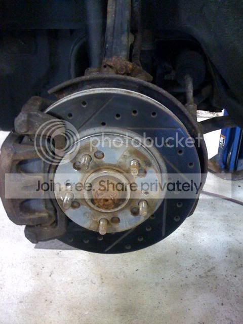

And here's a quick shot of my awesome eBay brakes:

.Here's the stock shocks:
Front:
Back:
