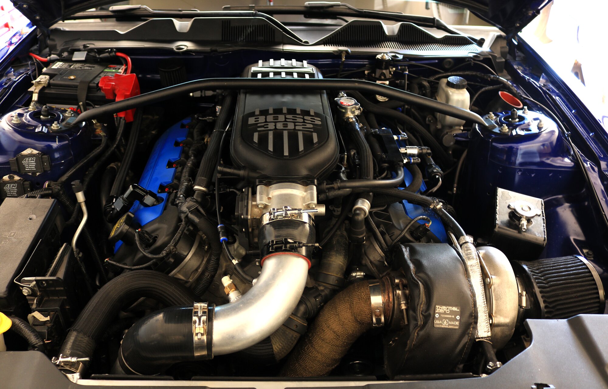

This build thread captures my efforts in building the ultimate fast (and practical) 100% street car with my 2014 Mustang GT, 6-speed manual.
diambo4life
20+ Year Contributor
1,934
983
Apr 18, 2002
Oklahoma
This is the Build Thread for My Street V8 Build.. Reply below.
In Progress:
Stock Gen 1 Coyote Block
10.5:1 C.R. Diamond Pistons
Callies H Beam Connecting Rods
TSS Billet Oil Pump Gears
MMR Billet crank sprocket
JPC turbo hot kit w/JBA Headers, also...full exhaust
A2W intercooler with 7gall ice tank in the trunk
76mm PTE turbo
PTE wastegates
Tial 50mm BOV
FIC 2150cc injectors
JPC fuel system -10AN/-8AN with Fore Innovations hat with triple pump setup
Aeromotive AFPR
AEM Infinity 8 standalone with P&P Harness
AEM CD7 dash with logger
Misc AEM sensors (fuel pressure, oil pressure, oil temperature, 3.5bar MAP, 3-Port BCS, Ethanol %)
BMR K member
BMR non adjustable A arms w/poly bushings
BMR radiator support with front sway bar delete
BOSS 302 intake manifold
SVE Aluminum Radiator
Summit Dual Fans
T56 Manual Trans (2.97 1st gear)
DSS Driveshaft
McLeod RXT 1200HD Twin Disc Clutch
McCleod Aluminum flywheel
Goals for this car: (all on pump E85)
  • 1000 WHP+
  • 1/4 Speed: 150mph+ on DOTs
  • 1/4 ET: 9s on DOTs
  • 60-130mph sprint: Mid 4s.
So I have started accumulating parts for my boost build. I have decided to tailor my build to be competitive in a street class type of drag and drive event. This car will 99% street driven and will retain OEM creature comforts. I don't intend to alter the interior in any drastic way.

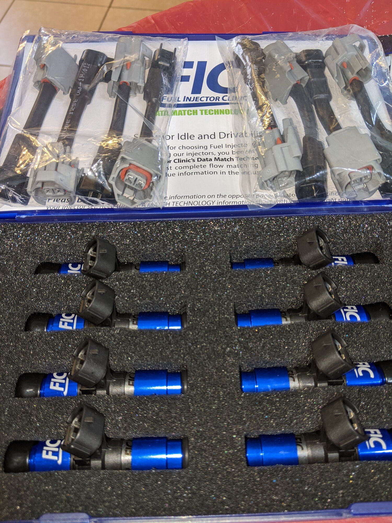

FIC 2150cc injectors.

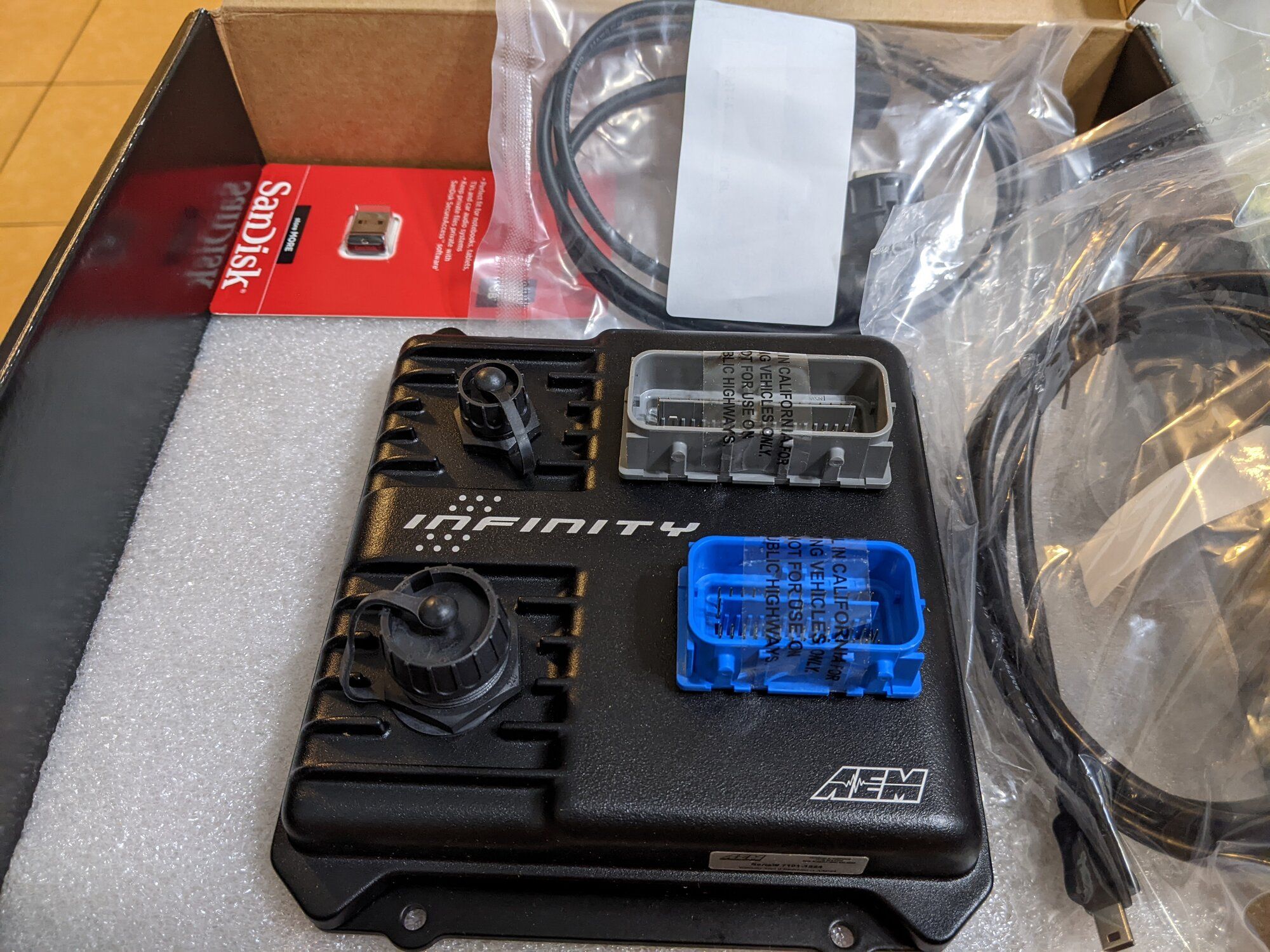

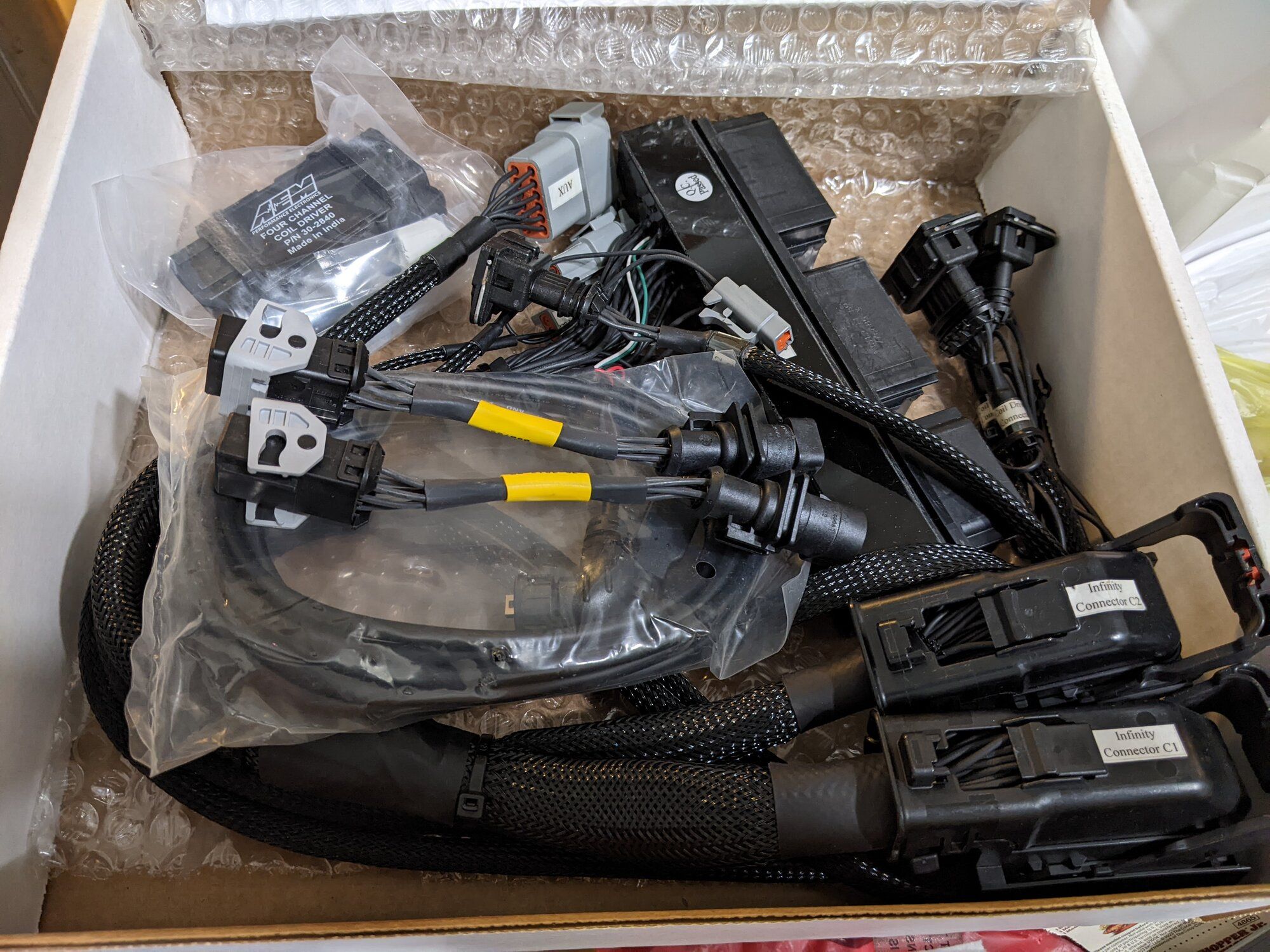

AEM Infinity 8 ECU with Coyote engine plug and play harness.

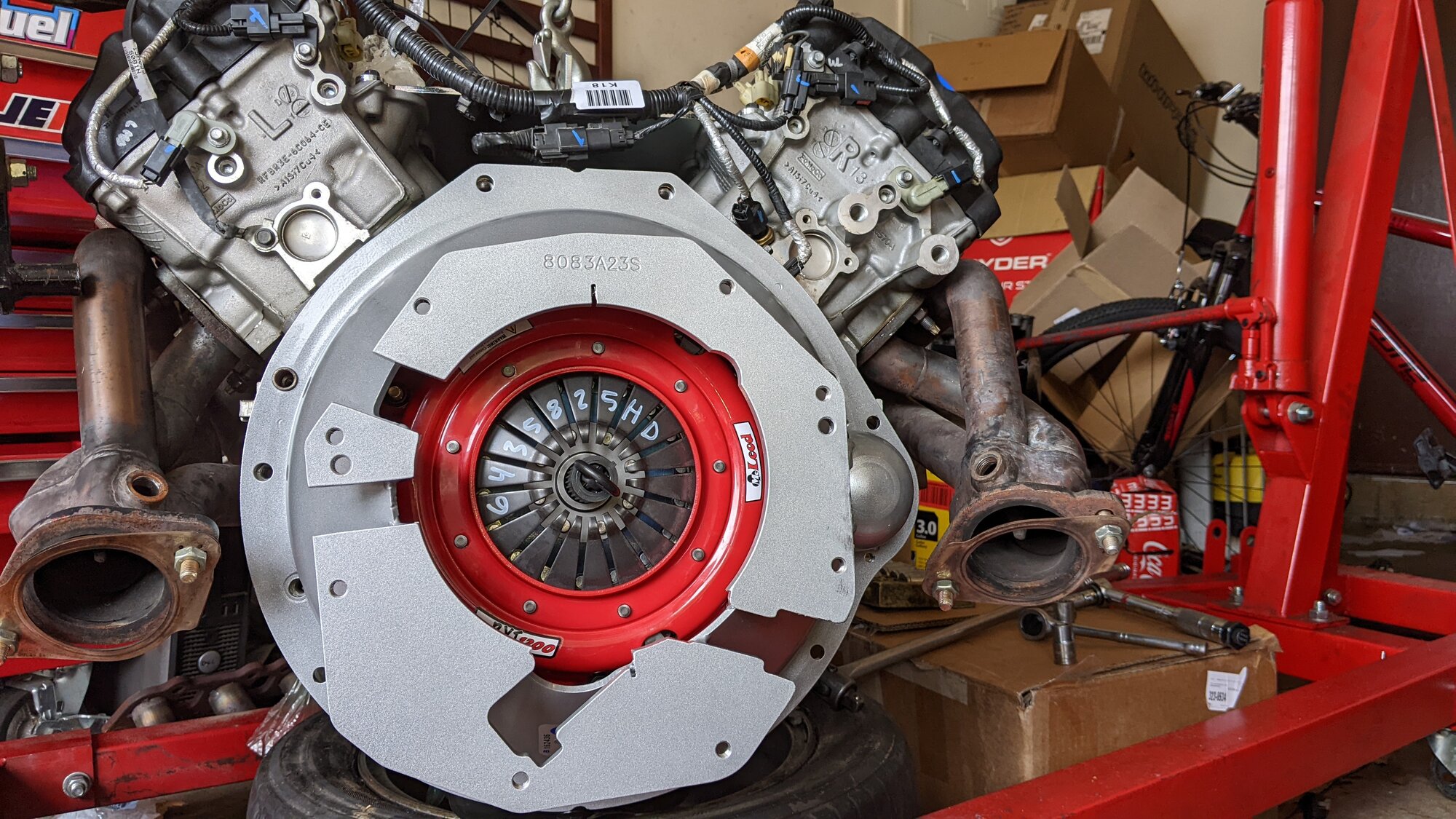

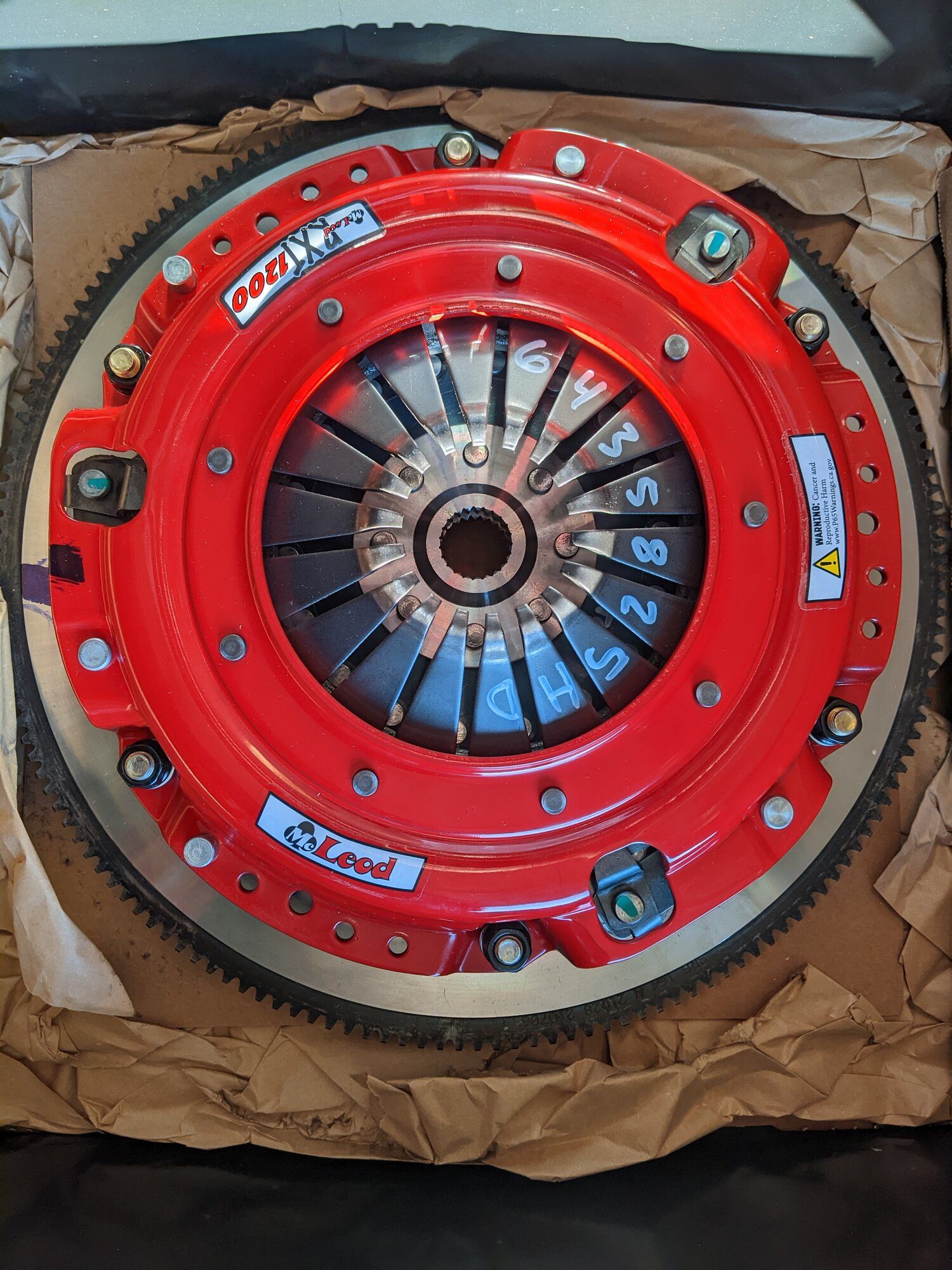

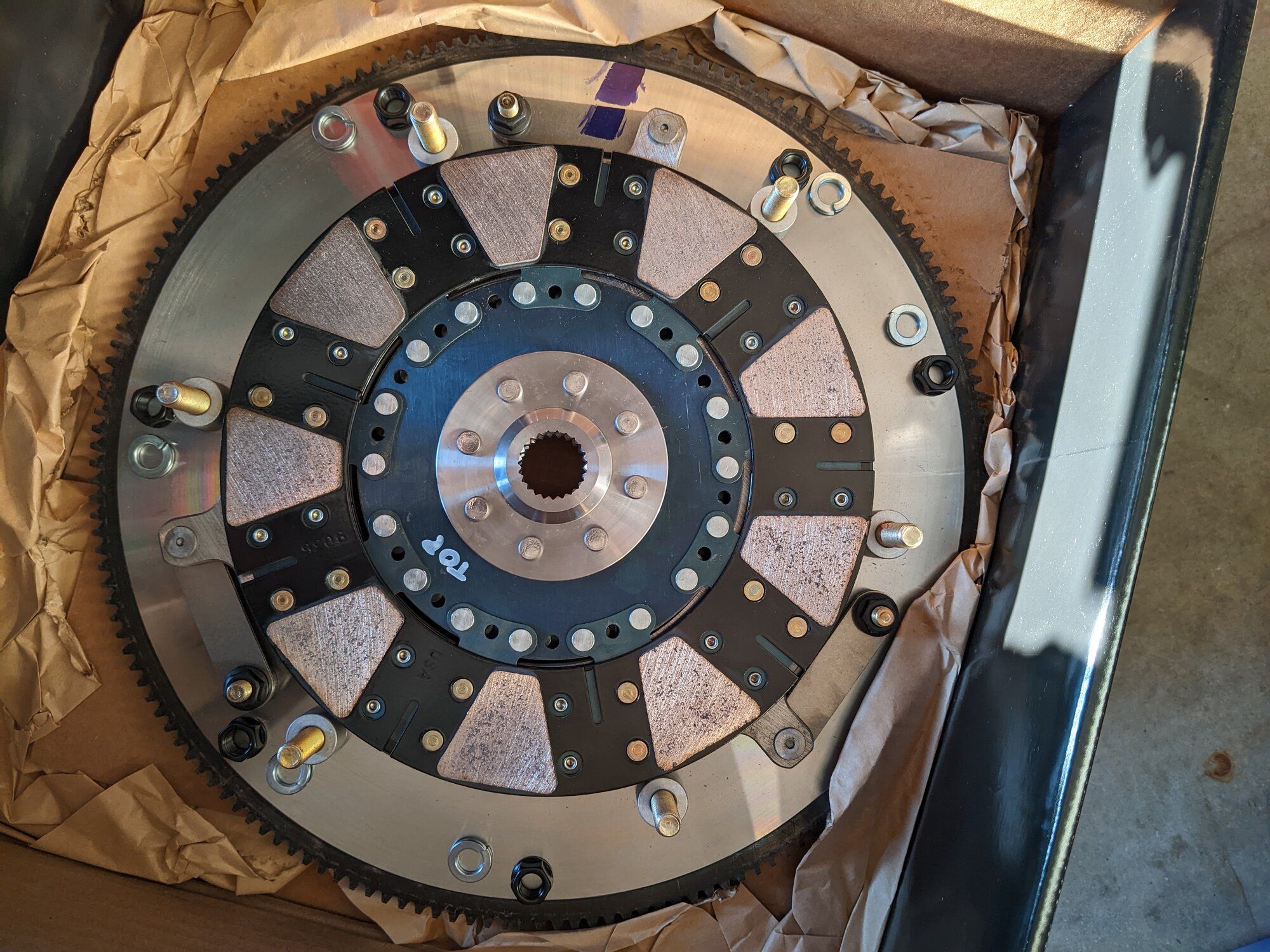

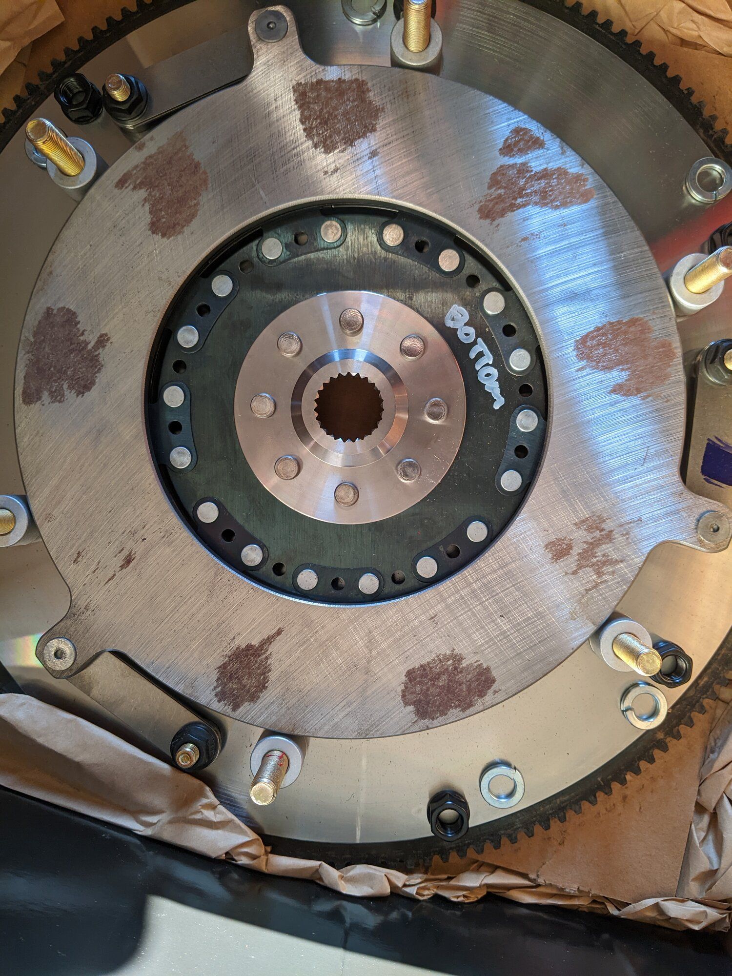

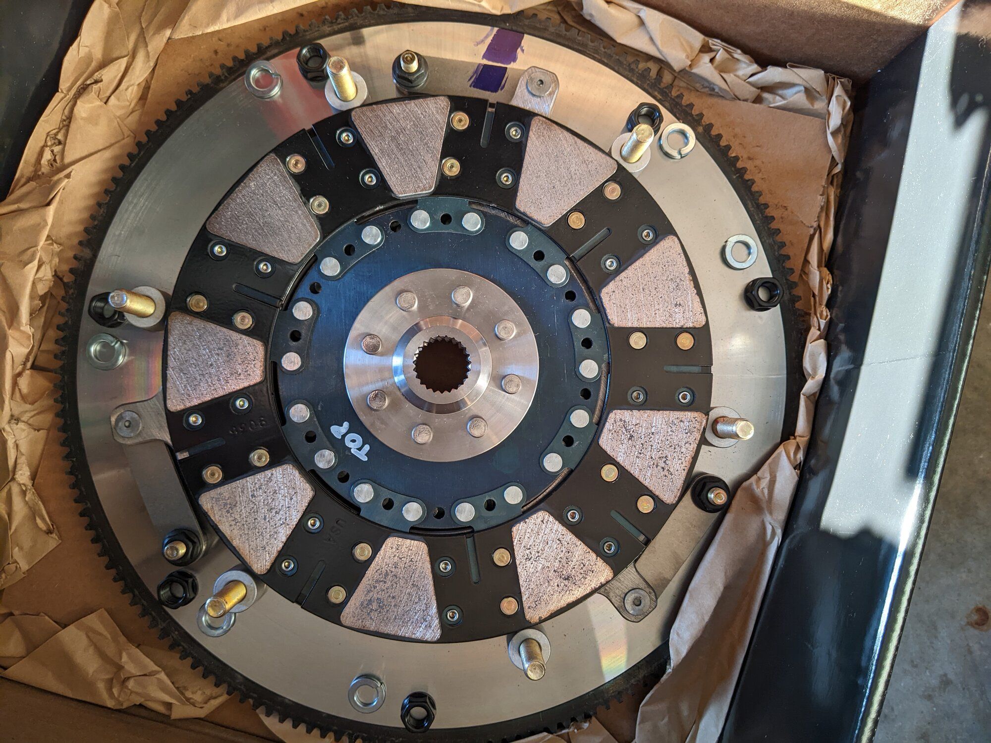

McCleod RXT1200HD twin disc (sent this to get rehubbed from 23 spline to 26 spline for the T56 trans - see below)

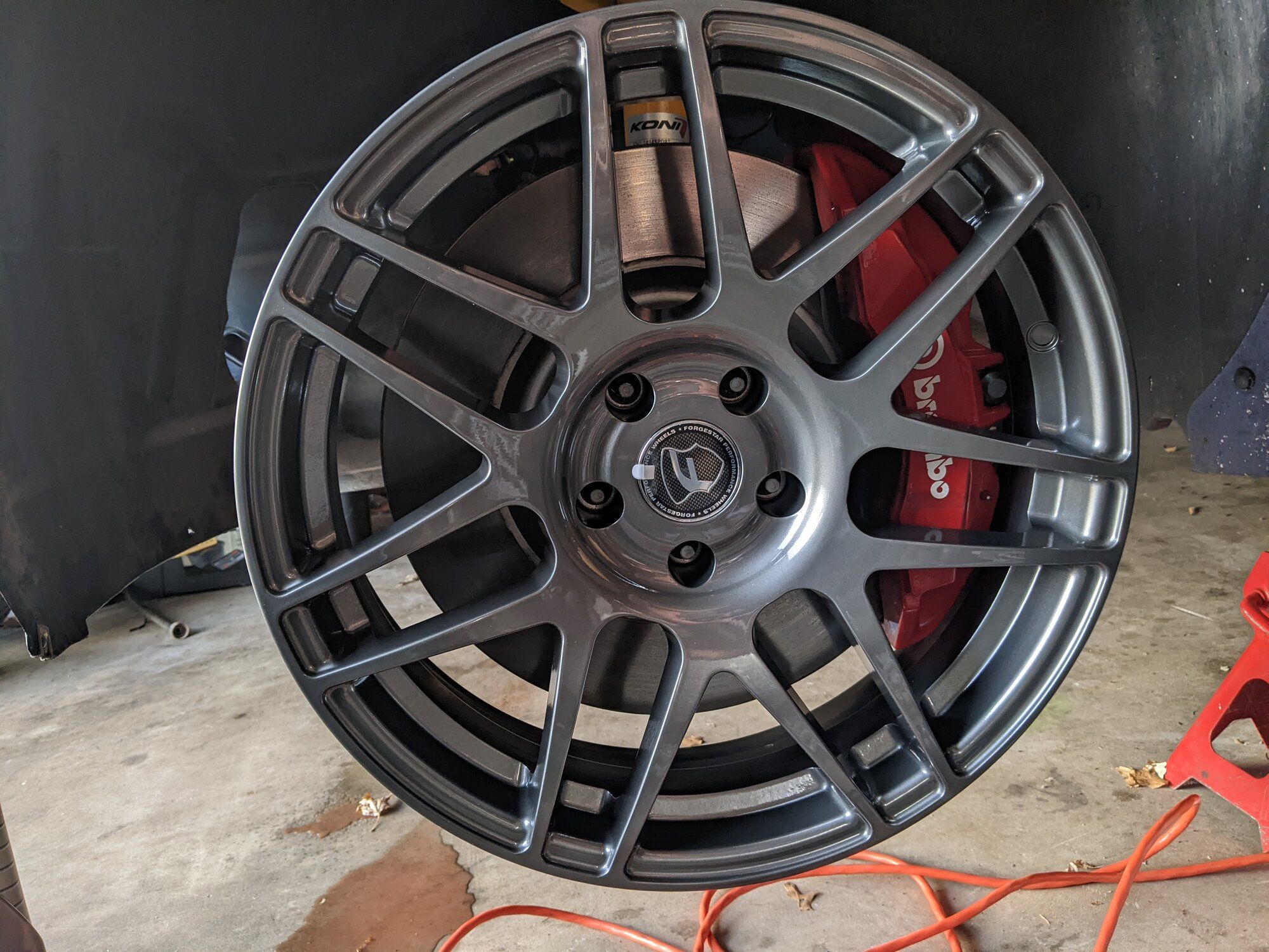

Skinny front runners 18x5 (Forgestar F14 to match my rears) - I opted to stick with 18s as this will go over my 6 pot brakes. This is a street car after all.

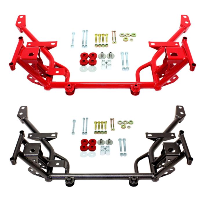

Tubular K-member from BMR Suspension

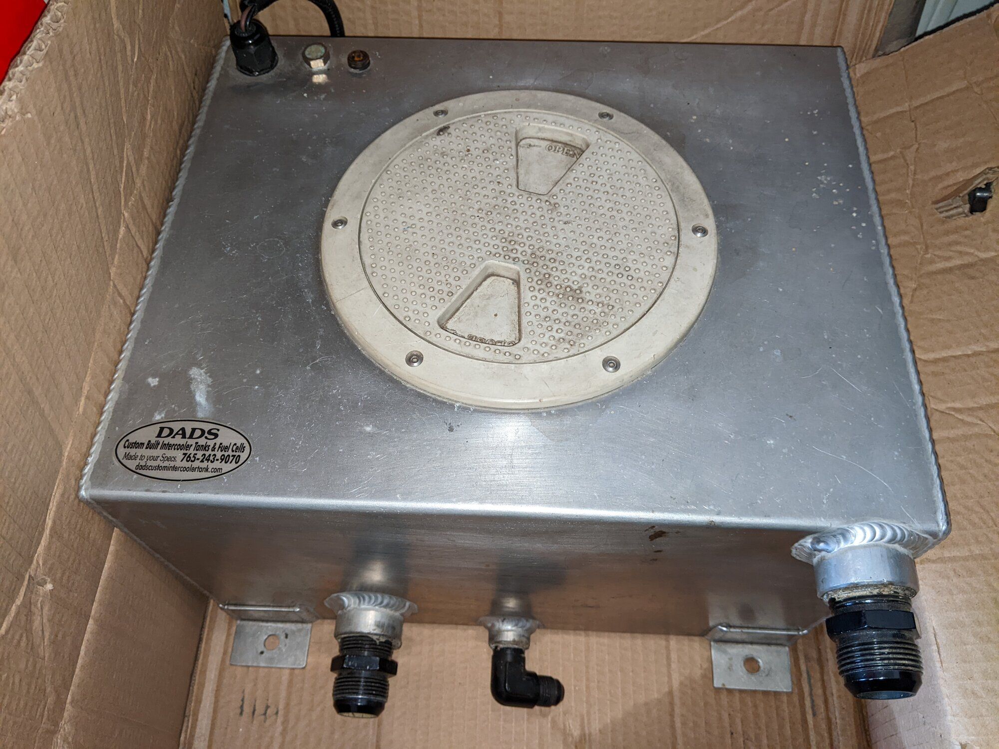

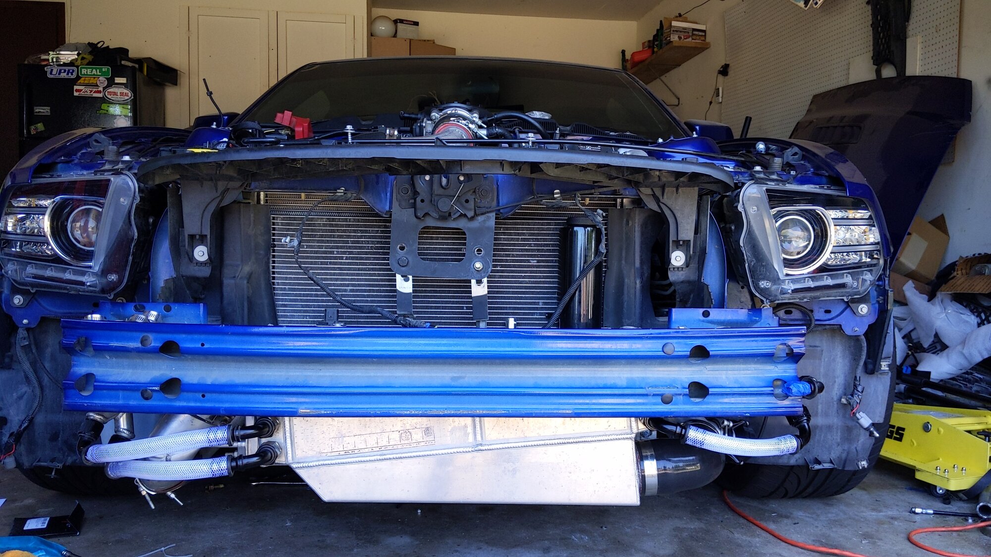

JPC A2W intercooler with 7 gallon ice tank.

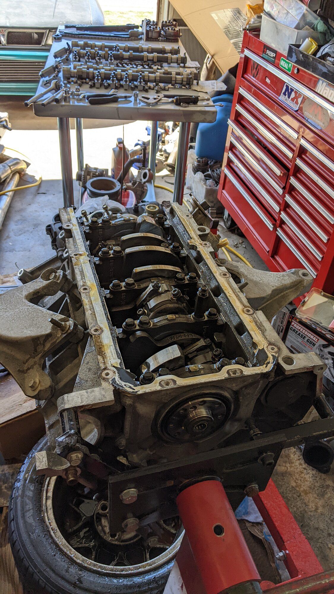

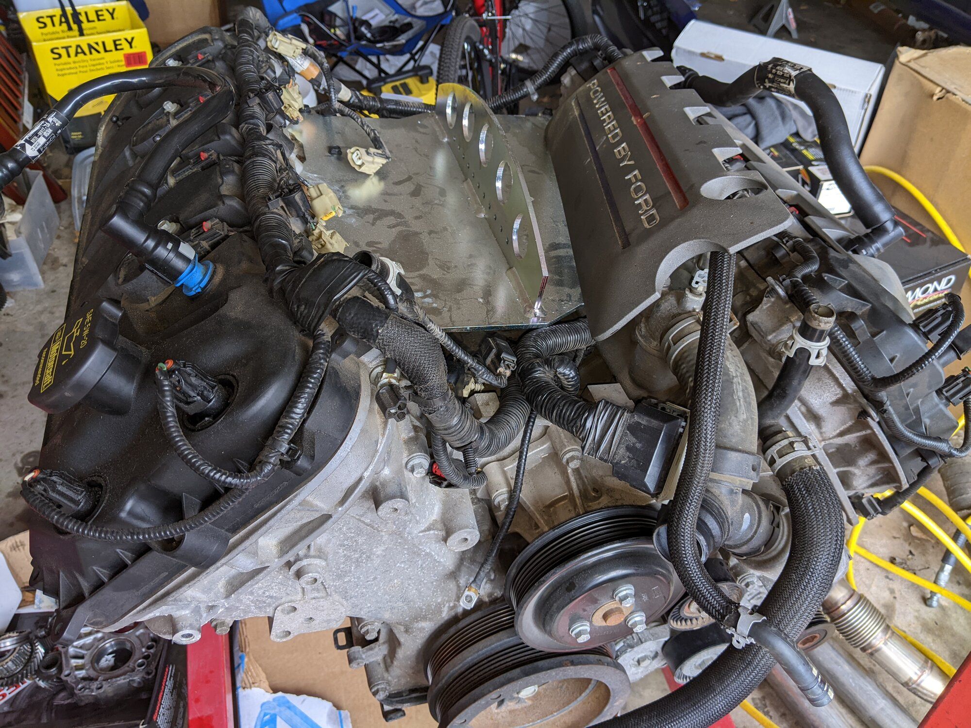

Currently the assembled long block is on the engine stand waiting for me to tear it down. This will be a "rod-piston" engine. I don't intend to sleeve the bottom end...yet. My buddy made 1066RWHP in a similar combo so it is doable.

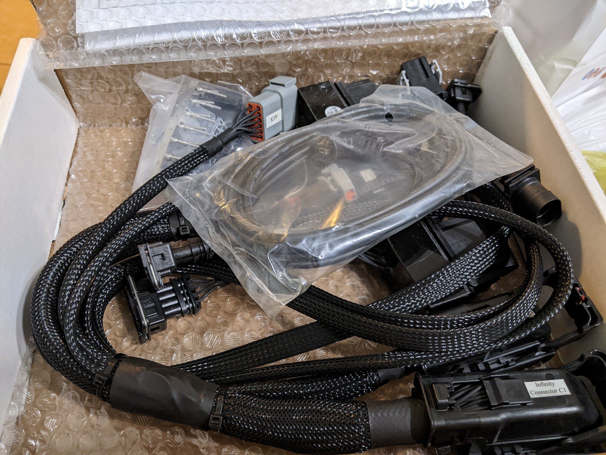

This is the plug and play harness. I really got a steal on this considering what you get. It even has the wideband LSU4.9 to LSU4.2 wideband O2 sensor adapters because Infinity can't read the stock Coyote 4.9 wideband sensors. It even includes the drivers to fire the stock coils.
McLeod Twin Disc 1200RXT: This is when I originally bought it for the stock MT82 trans which is a 23 splined input shaft. Sent it in to McLeod to be rehubbed for the 26 spline Magnum trans. I was given a 45 day timeframe but I was shocked to get a 2-3 day turn around. The discs are on their way back to me. At least it's one less thing to delay me on this build.

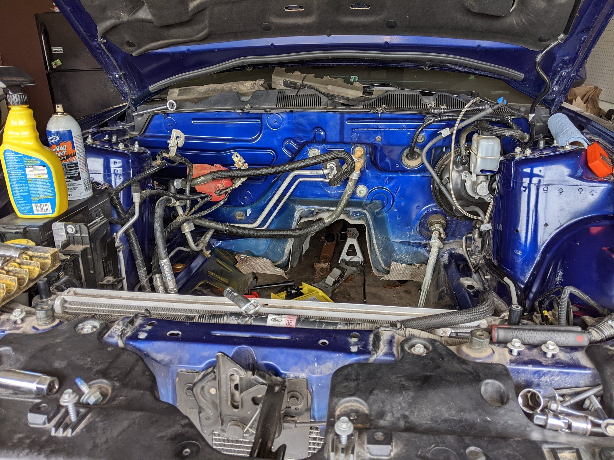

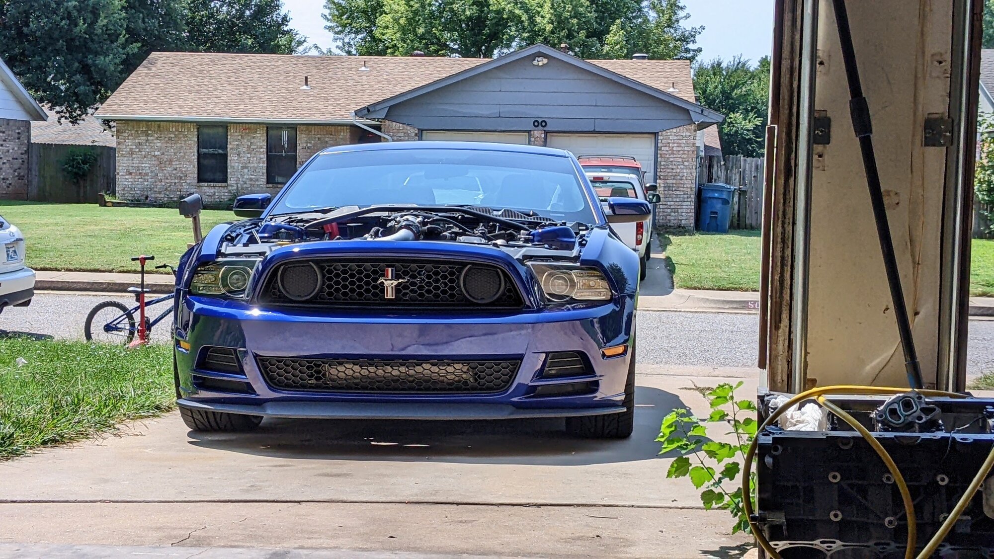

Current status. Cleaning up the engine bay....removed the dingy looking factory firewall mat. Engine currently on the stand.

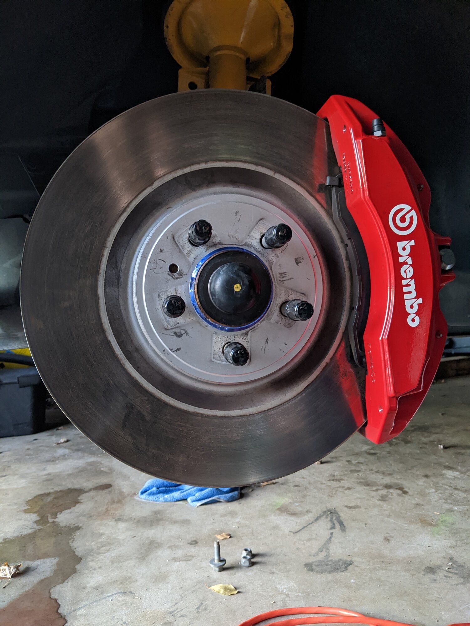

Yes...they are big brakes and they come stock on the Gen 2 PP (Performance Pack) Mustangs. Those are 15" rotors and 6 piston calipers. Funny is the 2020 GT500 brakes make these ones look small....if you have actually seen those.
BMR k member is in. It's the black hammertone seen below. 20 lb weight loss from stock. I kinda fubarred my ball joints during removal so I decided to just get the tubular A arms that have polys. I decided on the non adjustable ones that will retain stock geometry right out the box. They have taller ball joints and are also lighter than stock. Those come in tomorrow. More photos coming soon.

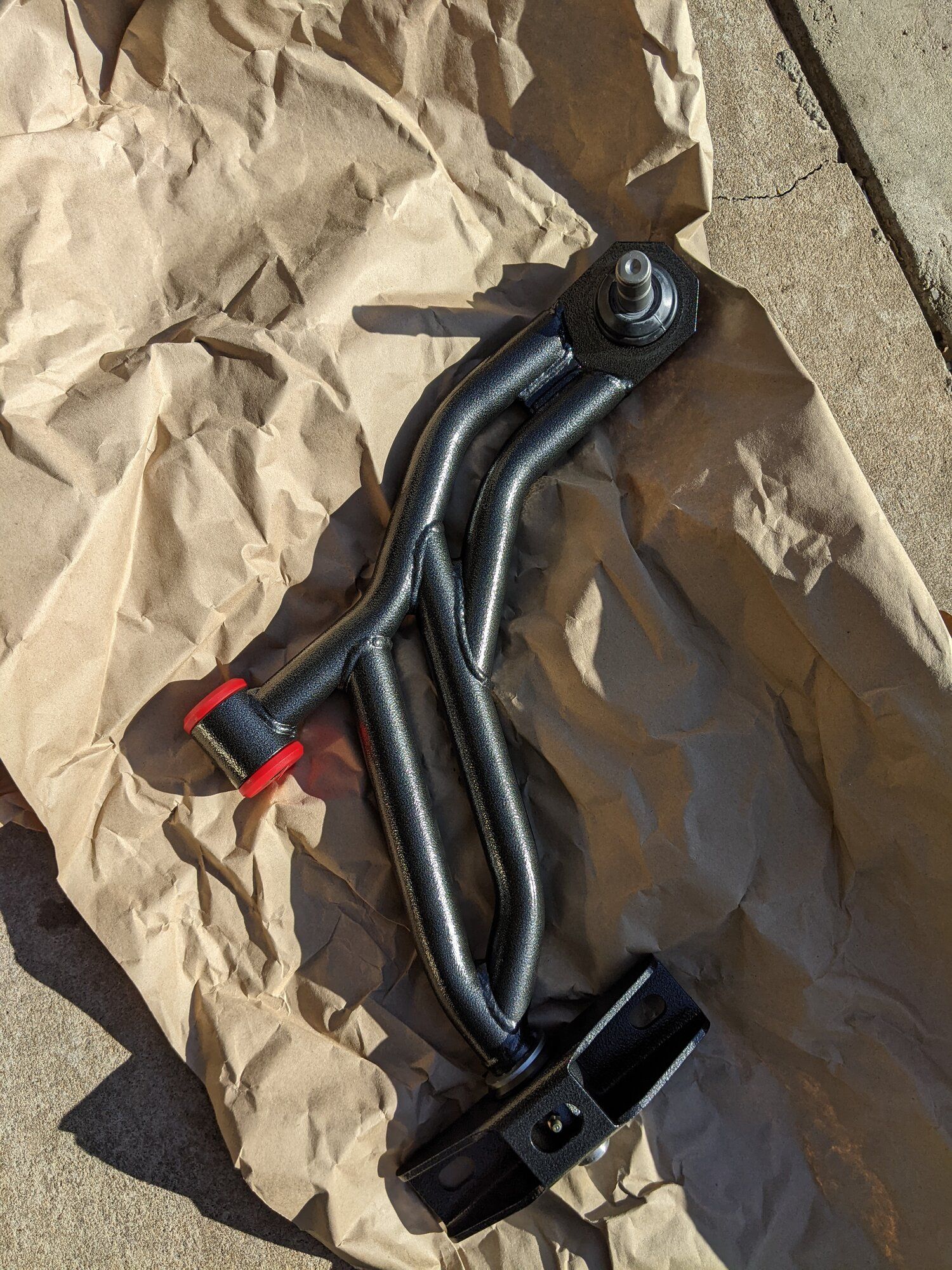

Tubular a arms are in and installed. These save 11lbs from the stock units too.

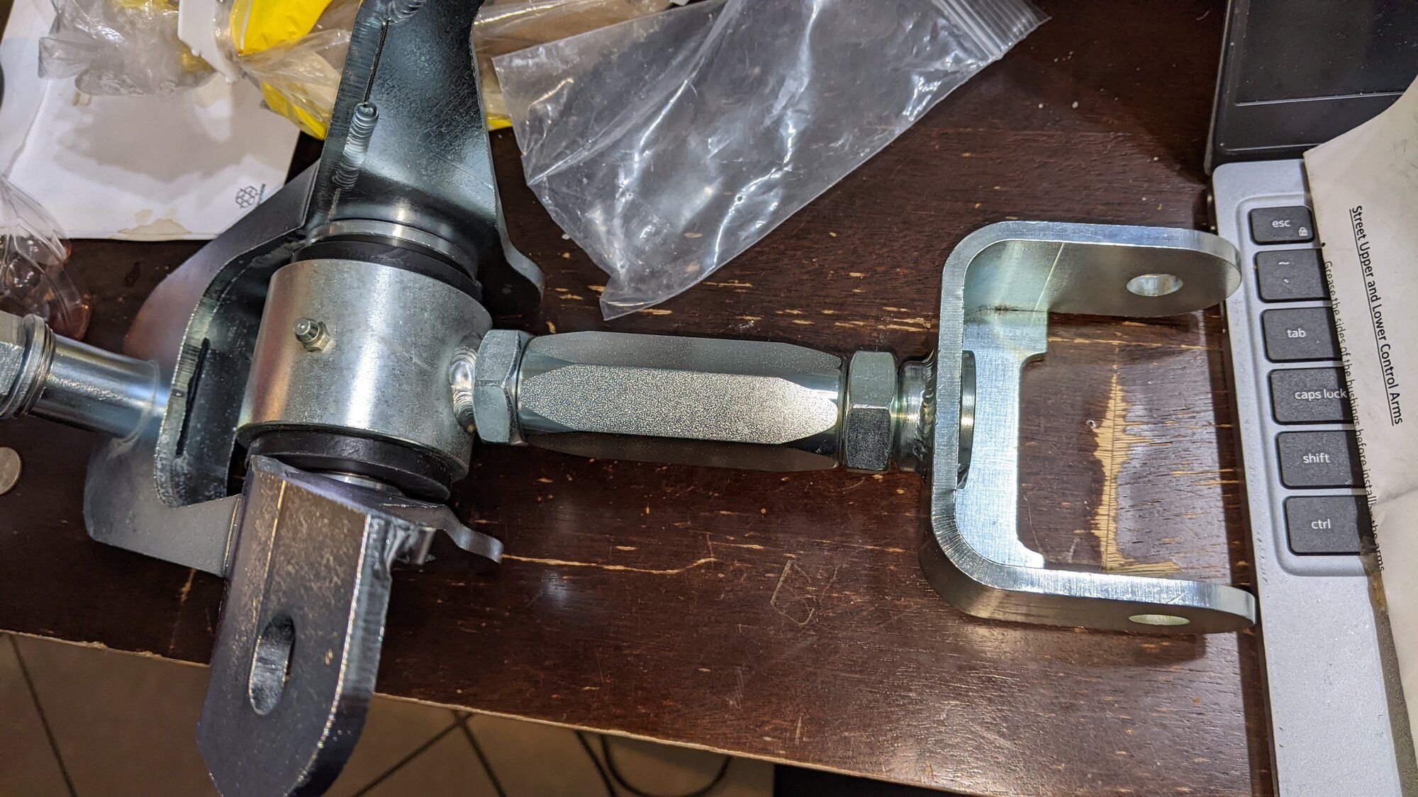

Ordered a UPR UCA (Upper Control Arm) for the car. These cars only have one. It supports the diff to the vehicle and dictates the pinion angle. My car is lowered so this UCA which is adjustable will help me correct this angle if it's off and it also comes with a poly bushing. It's obviously way more sturdier than the factory junk. This also helps stop wheel hopping on these cars. I had already done some other rear suspension mods and this is one of the few things that is still stock back there. Photos soon.
I also ordered two fittings that will enable me to run a catch can for the oil from the valve covers. A very cheap endeavor,
UPR UCA came in a few weeks ago. I haven't installed it yet. But here is a look. It's adjustable (the length) and has 2 settings for angle on the mounting bracket. The mount is poly...which is more street friendly than the other option.
