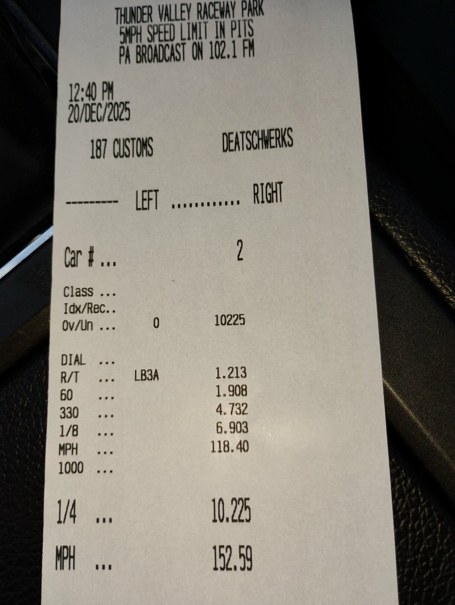

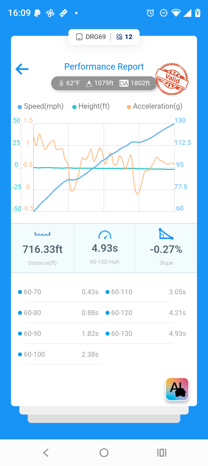

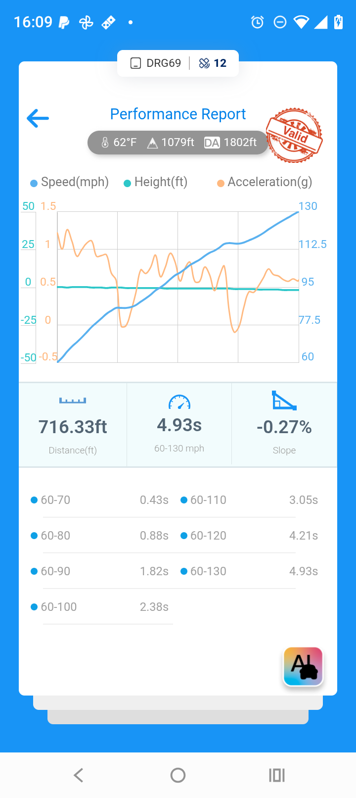

60-130 is not great because this was from a track pull so it has 2 shifts in there and I lifted on both like an idiot LOL. I have the 2.97 1st gear in my T56 so it needs a shift (3/4) before 130mph and that's the crappy shift too with this trans because of the ratio. I can do the 60-130 with one shift but I haven't attempted to do it yet on the kill tune. But all the math says it should be in the mid 4s area.
Yes the T4 and 3" exhaust are hindering power, but I will leave it as is until I upgrade the turbo, then I will do a 4" DP but even then, I may neck it down as I want to retain full exhaust so that may get tricky. It's working for now though. I feel the 75 turbine wheel is more hindering than the 3" DP. Boost was 20/21 tapering to 18/19 on the dyno. At the track I am only seeing that 20psi boost in 4th though so there's plenty to be gained in the first half of the track if its prepped and I can pour all the power in immediately after launch. Fun stuff.
4 sec 60-130 is f***in bonkers. Seriously. Especially in a manual!

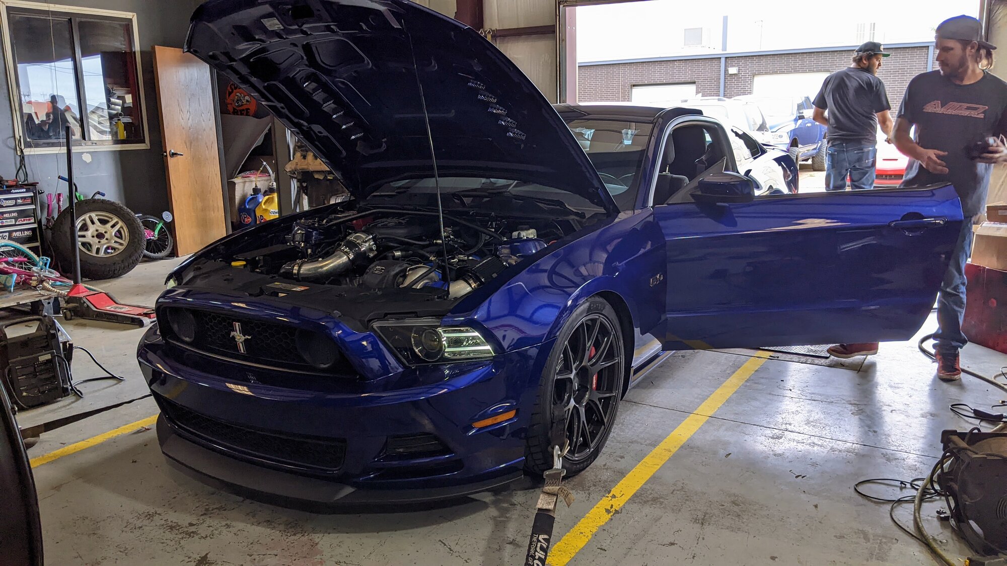

Had the car on the dyno today to dial in some changes I made. Dyno was not cooperating. I managed just 1 pull at 19psi and it made 1020whp with the $11 Amazon air filter in place. There is something I noted in the tune that I need to address, otherwise, it's ready for 2026. I just want one pass to say 9.xx on the slip and this car project is done! Oh...got off the dyno and drove it to work like a real STREET CAR does! :rocks::rocks::rocks::rocks::sneaky:

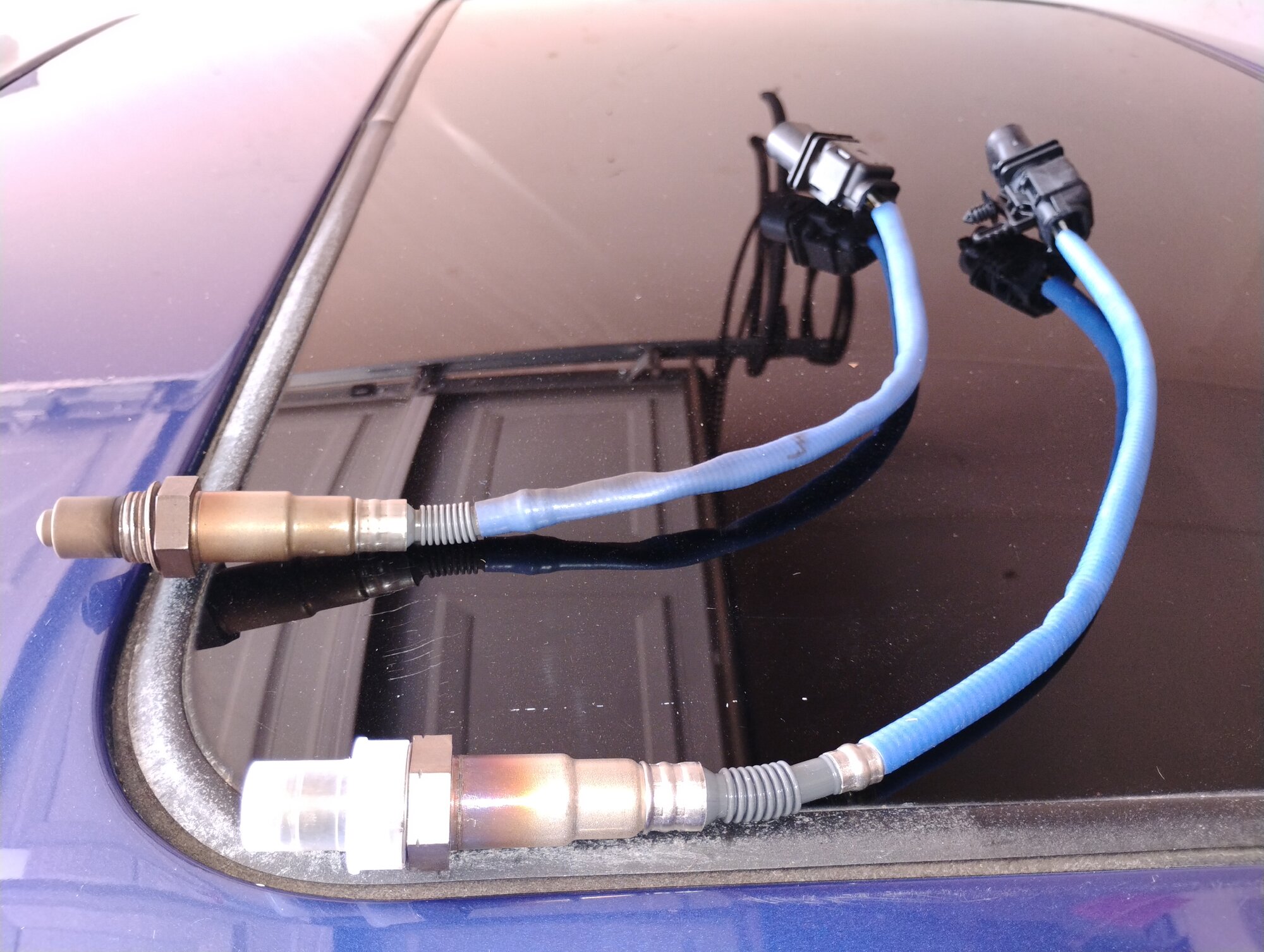

Did some work on this car this past week.

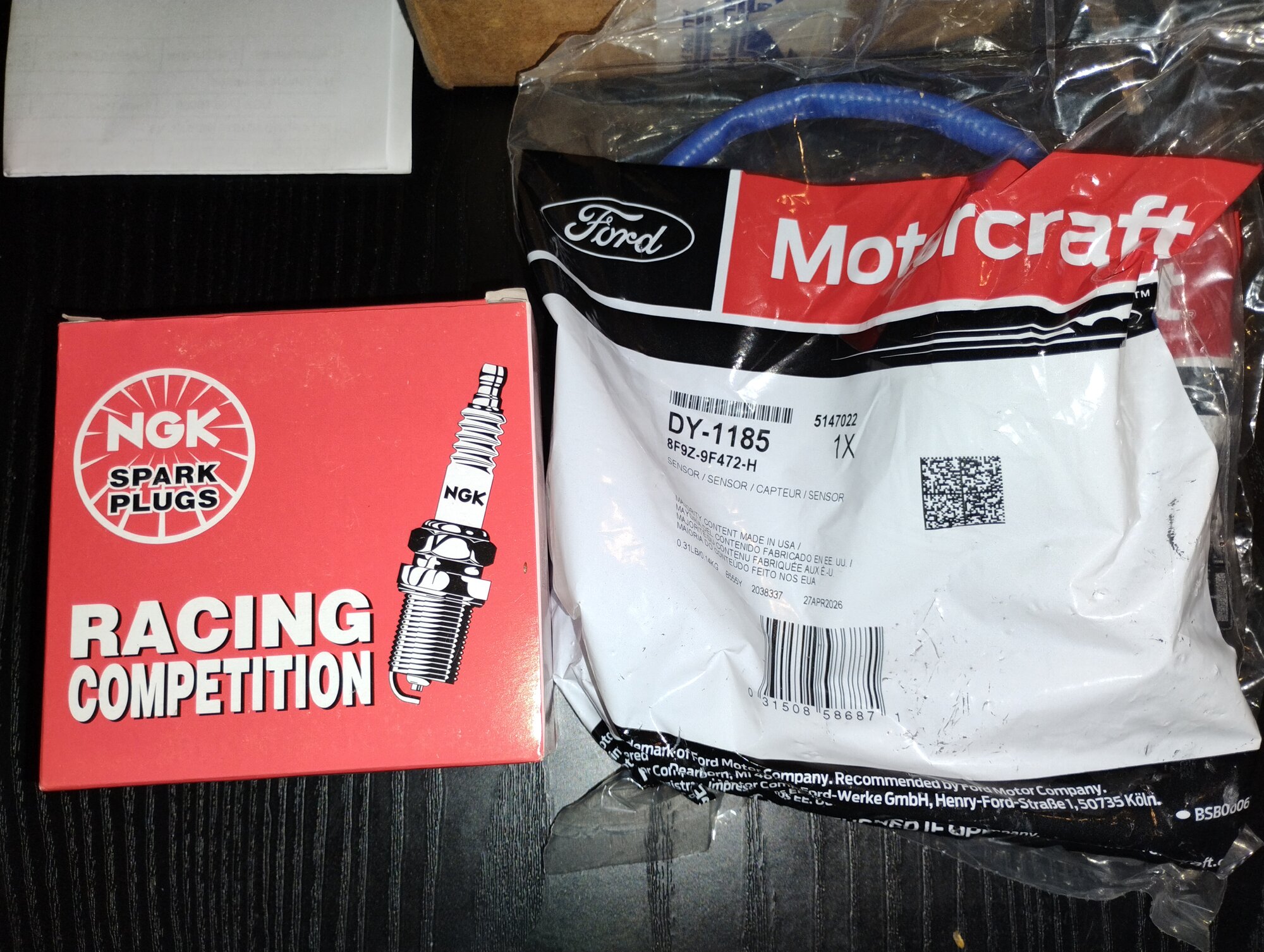

1. Replaced the front O2 sensors for this car which are wideband btw. Seems like the ones I had purchased last year were counterfeits. Beware buying O2s from Ebay and Amazon. (In the pic below you can see a real O2 sensor and a counterfeit. They literally look identical except for very small details.)
2. I bought a new set of plugs but those will not go in until much later, this year. I am trying to avoid a lot of street driving on them. Current plugs have no issues.

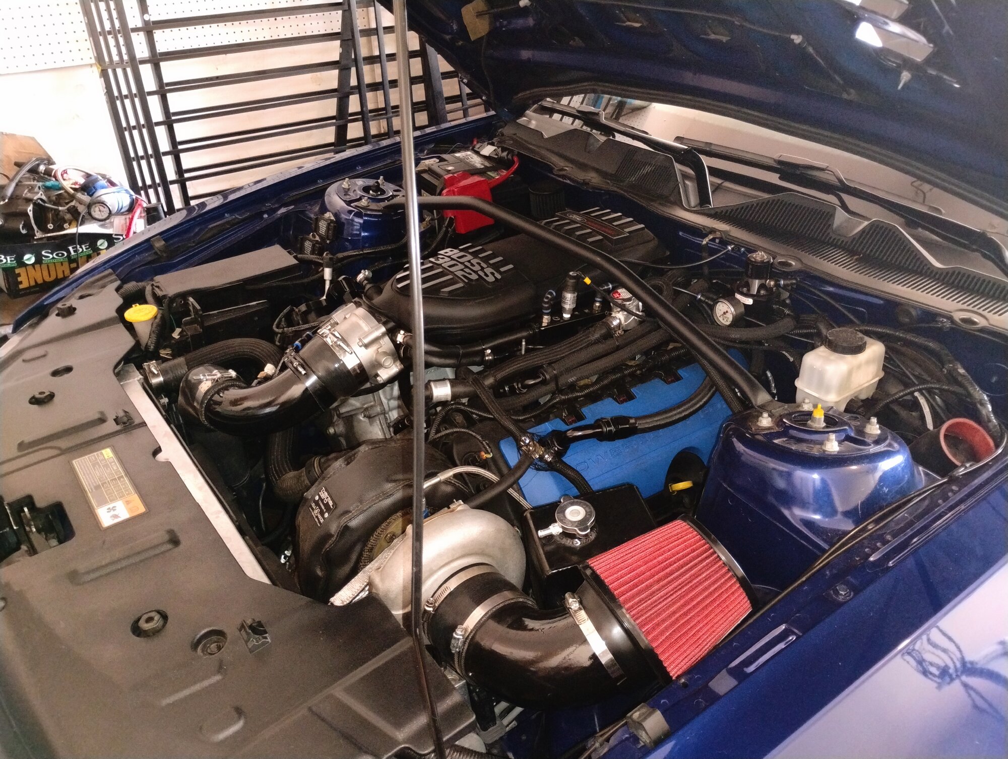

4. I modified my crankcase ventilation setup on this car. this car had been running 2 12AN sized breathers from each valve cover to a single can. After thinking about it some, I decided both hoses going into the same can has to be a restriction for a 5.0L V8 with boost. So, I have each breather hose going to it's own vented catchcan. I think this will help. The most boost this car has run sustained on a pull is 21-22psi and I have no crankcase issues because I gapped things really tight when I built the shortblock so this is just preventative when I eventually get a bigger turbo and push boost to 30psi. I will add some photos later.
