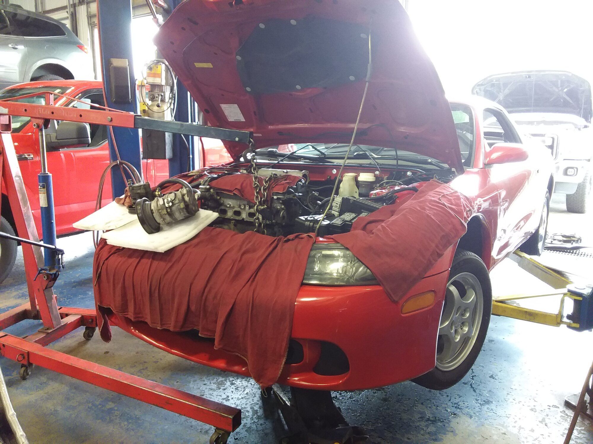

I was afraid this cucumber might be a dill and I would find myself in a pickle. 😄 But the shop sent me an update today, and it seems that the engine is super clean inside, which is a relief and very exciting to hear!
I can't wait to see it when it's all put back together!

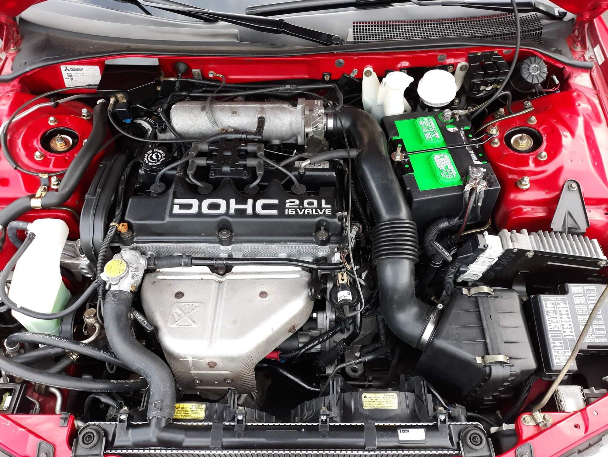

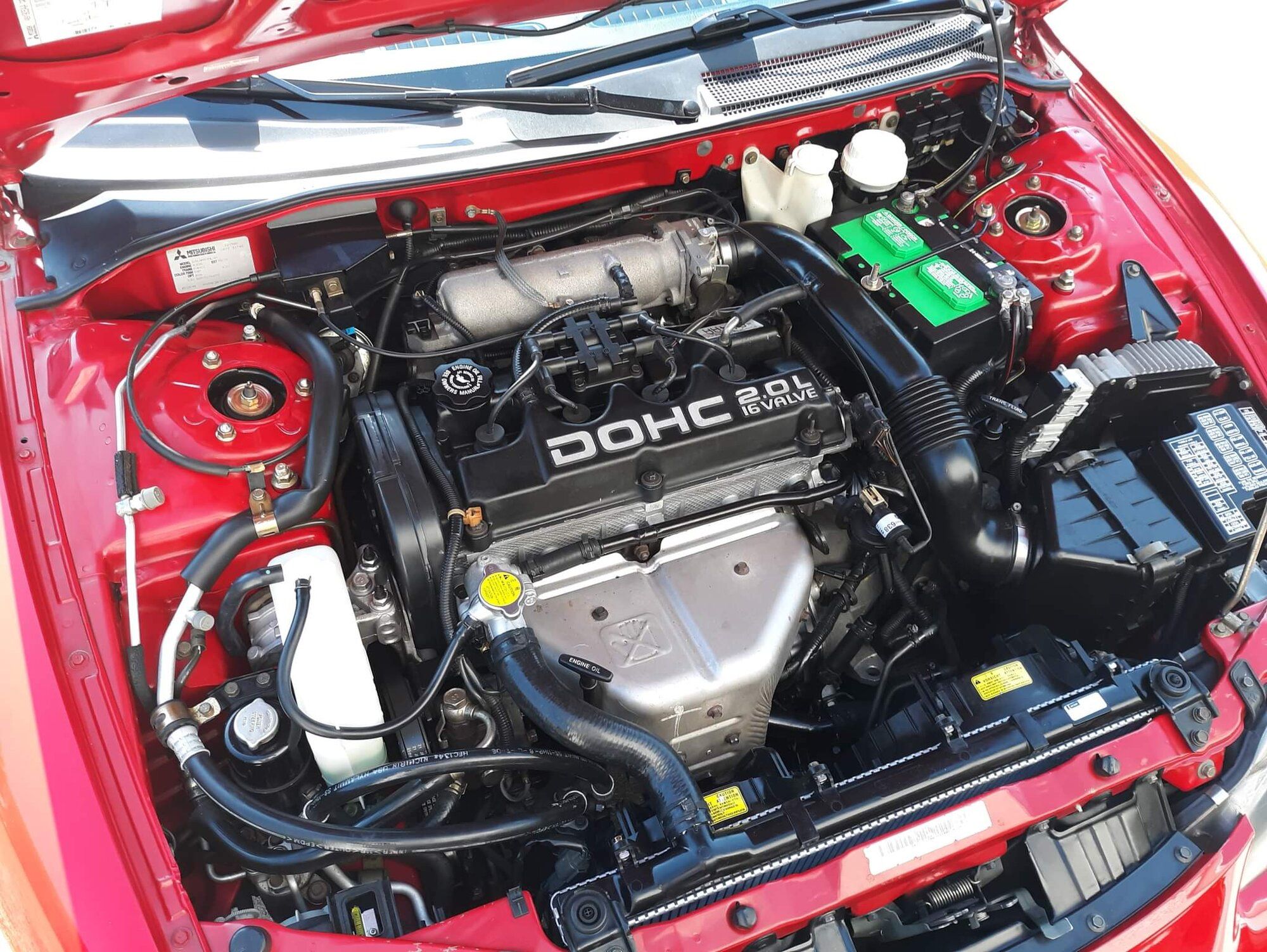

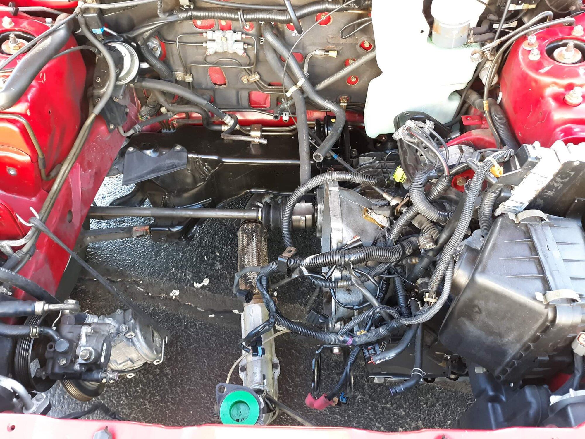

Waiting for a new exhaust manifold to arrive (mine was cracked). I am also going to replace the steering rack bellows since mine are in rough shape. Other than that, I think this round of maintenance is pretty much done.
It's cool to see the engine bay without an engine in it, and I'm pretty happy with how clean everything looks with roughly 97k miles on the car. 👍
Your firewall lining is in amazing shape. Usually on these cars it is peeling or has been removed.
Yeah, I was excited to see it intact! I got really lucky with this car. The firewall lining is like new and the hood liner is in great shape too. There's certainly a lot of work to be done, but the really rare parts seem to be intact and in great shape.
The trade-off though is that a lot of the foam and rubber pieces aren't in the best shape from spending nearly two decades in the hot, dry Arizona air. I'm working on it though. :)

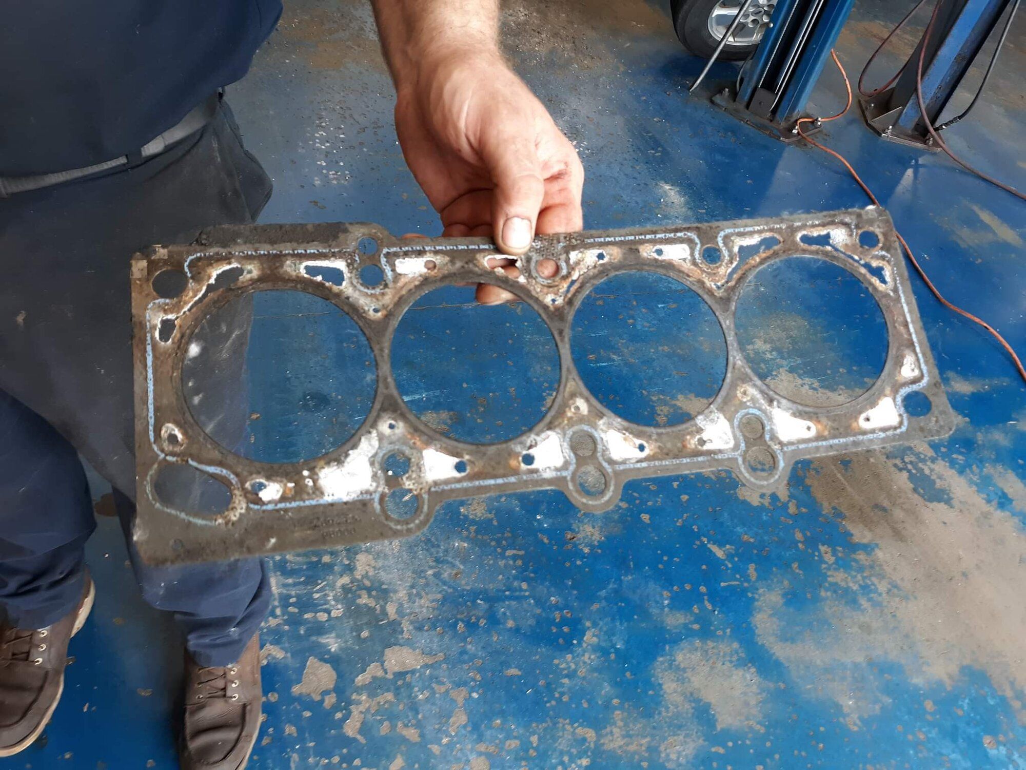

I picked up my Eclipse from the mechanic this evening and went for a drive. It was amazing, and well worth the wait. I didn't feel like it was going to stall, and it seemed very smooth. If I'm not mistaken, the car turned a few heads too. 😁

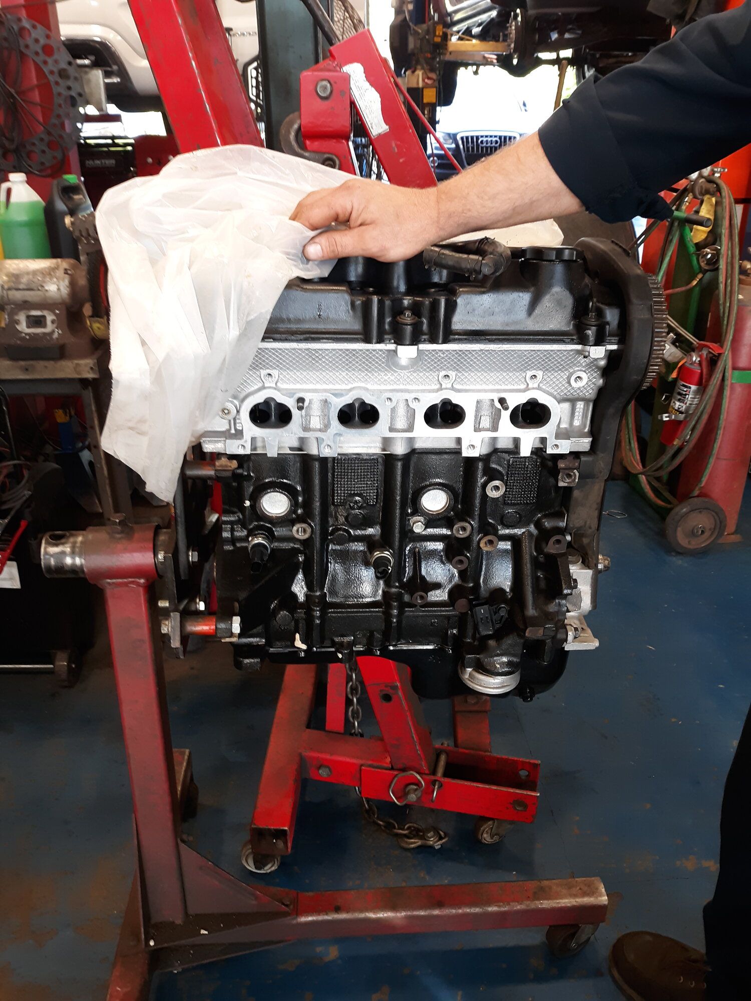

In short I had a ton of work done to it, and almost all of it was in the engine bay, with the most important repair being the head gasket. It's been leaking oil since I brought it home, and it turns out the gasket was the culprit.
I am surprised by this, because I thought, with the car being a 1999 model, that it would not have this problem, and that it would have an MLS head gasket. It did not. 🤔
It does now. I used a Mahle Engine Seal Kit to reseal the engine. No more oil leaks at the moment.
Along with the seal kit, I replaced the valve springs and keepers and most of the cooling system with new or refurbished parts. I also replaced the radiator, hoses, clamps and fan motor, the exhaust manifold, spark plugs, all of the belts, the timing components, all of the motor mounts and cushions, the transmission and fuel filters, inner tie-rod ends and steering rack bellows.

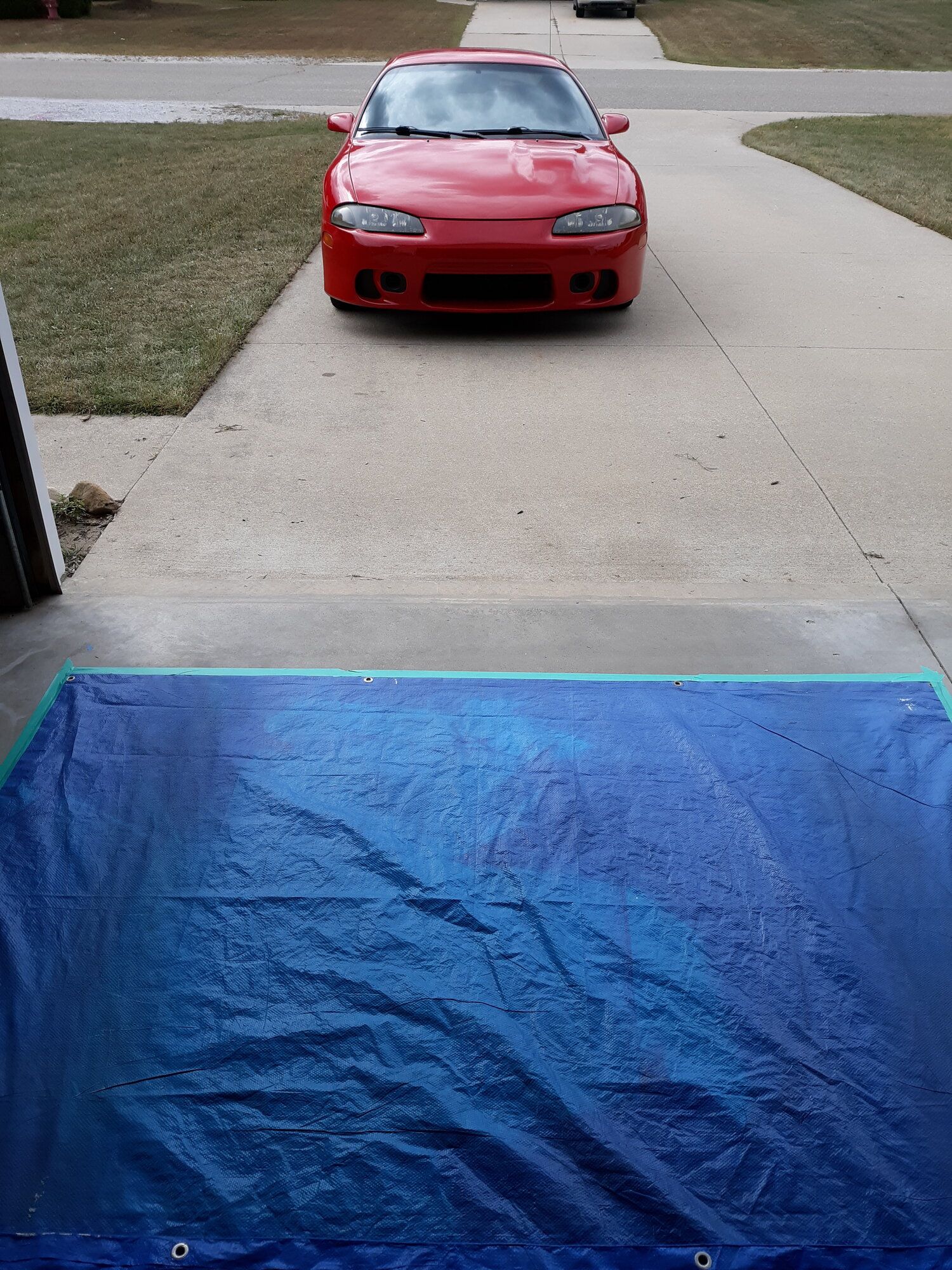

I lay tarps down in my garage to keep the undercarriage of my Eclipse as dry as I can.
I read where the temperature shifts in the Fall can cause the pavement to sweat in an uninsulated garage. Unfortunately I don't have the funds to insulate my garage and seal the floor at the moment, so I use tarps as an economical alternative.
I usually pull them up in the summer, clean the floor, and then lay them back out in the Fall... and as much as I don't want to admit it, winter is rapidly approaching.

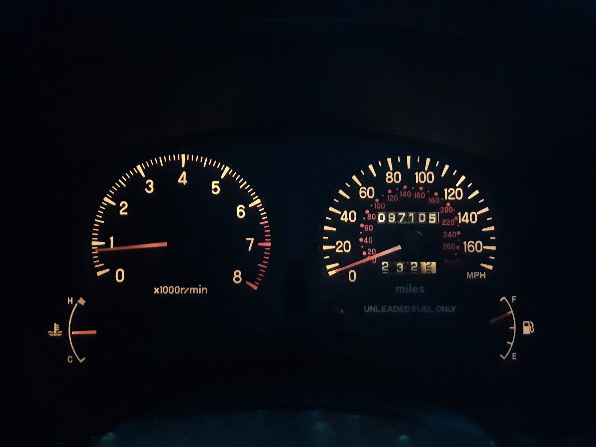

Not a whole lot happening with the car at the moment. It's in storage with 97,105 miles on it, so I added 232 miles to it this year, and 490 miles overall. This means I drove it nearly as much this year as I had the two previous years combined. Not going to lie, that felt really good. 😁

Here is a look back at the maintenance from this past spring:

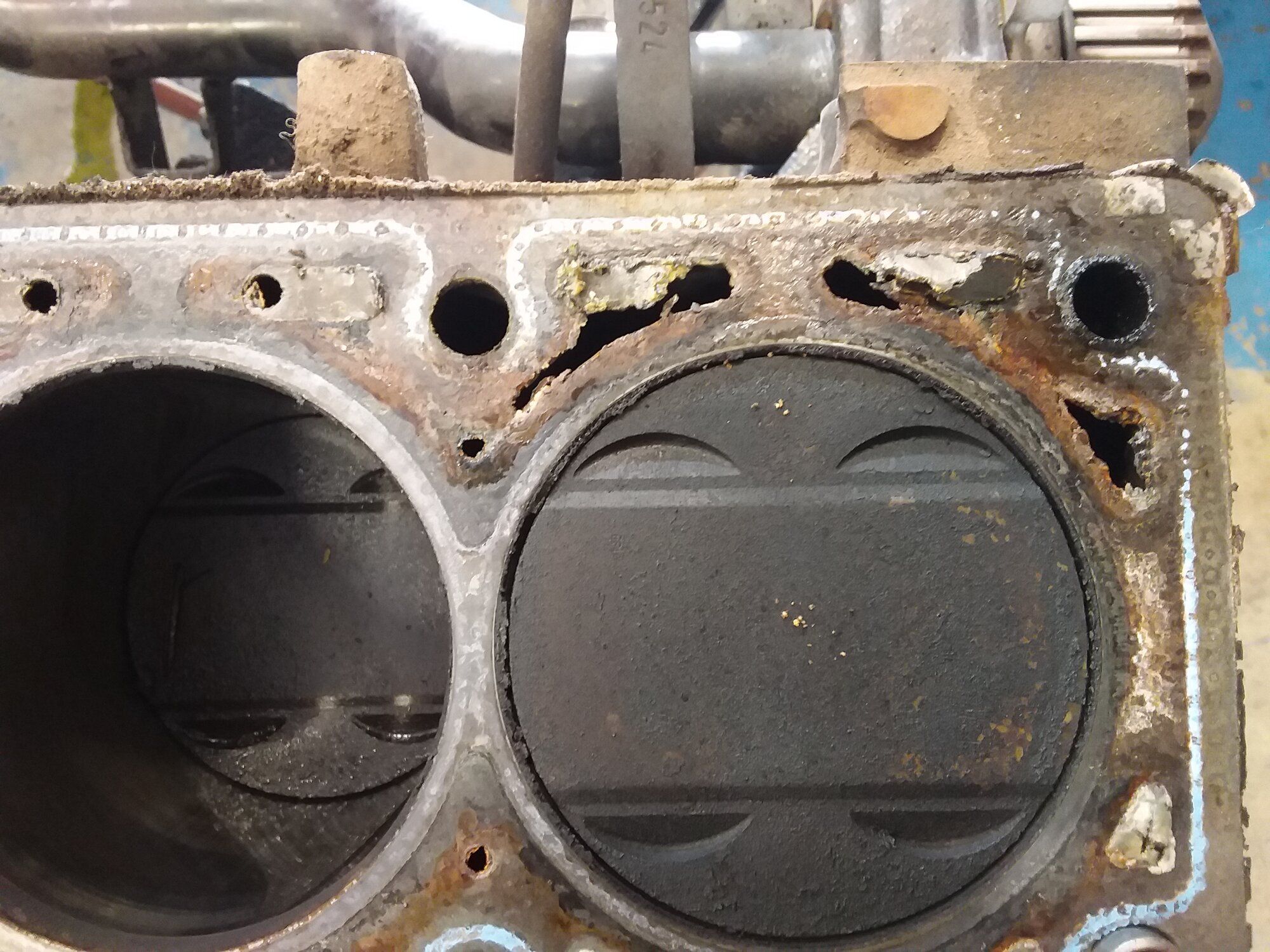

A bad head gasket with < 100k miles... 🤔🤷‍♂️

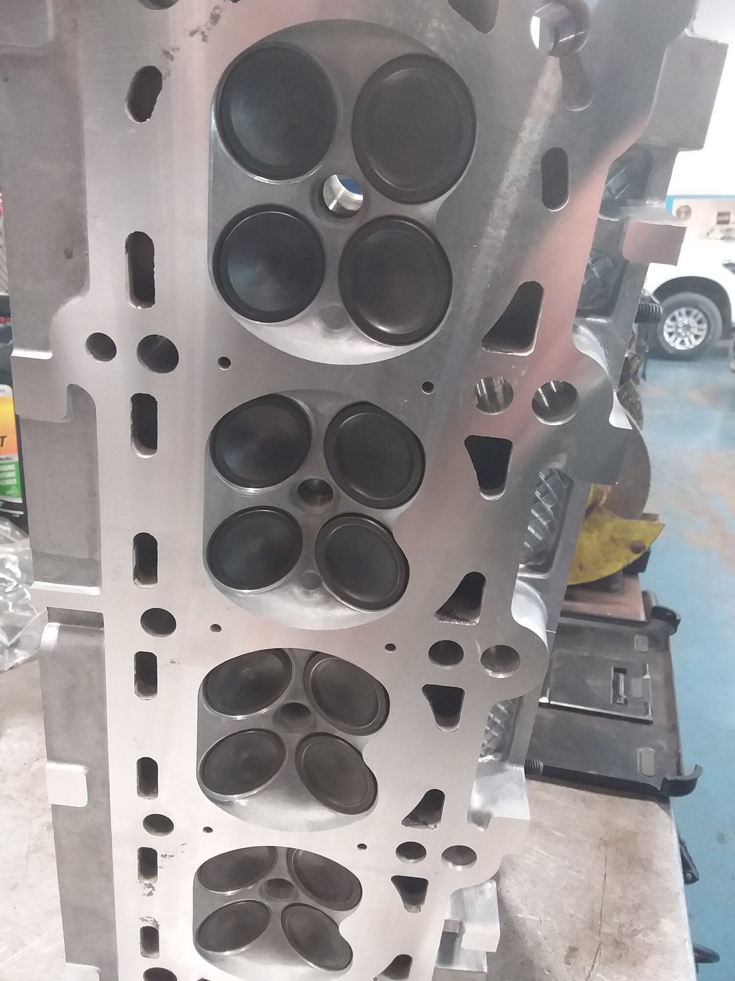

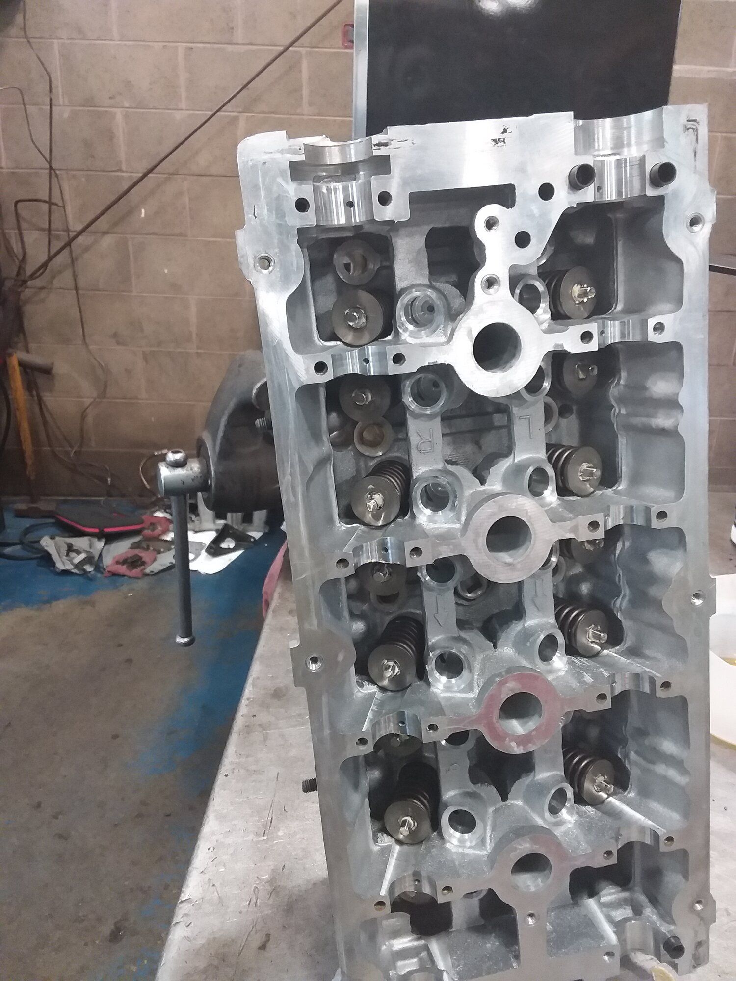

I had the shop replace the valve stem seals, springs, and keepers. No regrets there.
I didn't replace the valves or anything, I just thought this was a cool picture. 😁

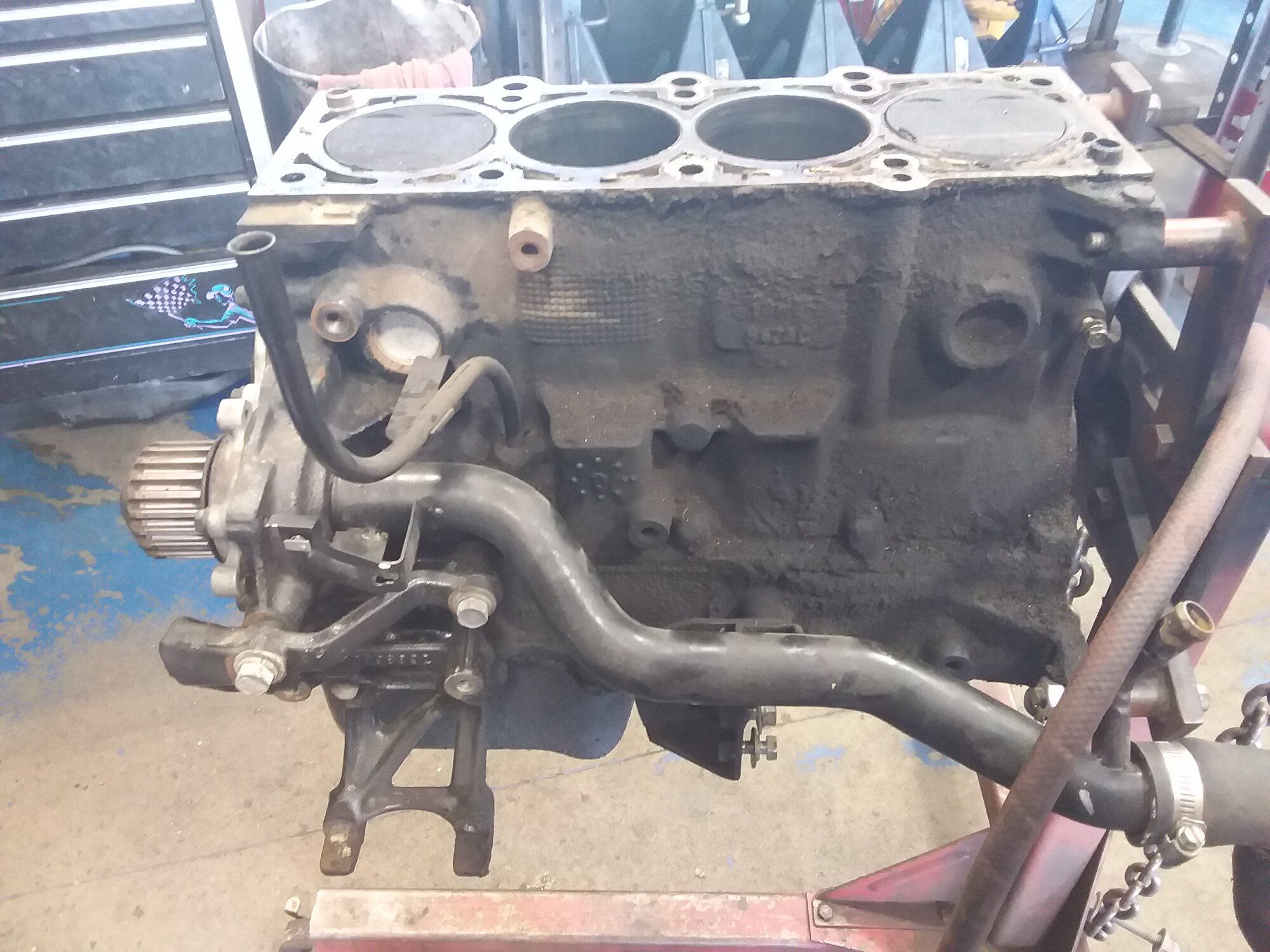

The block before it was cleaned up. I didn't have the money for it this year, but someday I want to revisit this to see if I can eliminate the annoying piston slap this engine has.
That would be a good excuse to pull the engine again and respray the bay (and the rest of the car) Northstar White... 😁 I've been thinking a lot about that lately. 🤔
Piston slap with less than 100k miles? The only reasons I could figure that are if the car was ran low on oil or if the blown headgasket allowed enough coolant to severly dilute the oil. I once re-used OEM pistons and wrist pins with 180k miles on them and they had no issues. Definitely not recommending that, but yours should have lasted longer. Anyway, nice work so far and I'm looking out for next year!
Thanks @vanilla gorilla. I appreciate the comment :)
Thanks @BLACK'98DSM. Yeah I am not really sure what caused it. If I was a betting man though, I would put money on it having been run while it was low on oil. The bad head gasket caused oil to leak out of the head, and I feel like the previous owner was not passionate about maintenance. 😆
On one hand its disappointing, but on the other hand, I'd be lying if I said I didn't love it. 😊 This has been an awesome learning experience. And besides that, the car is so clean, it really would have been a shame not to save it.
I haven't decided what I'm going to do with the block yet. I don't know if it makes more sense to bore it out and sleeve it, or just use larger pistons. Or maybe it's better to just try to find another block?
