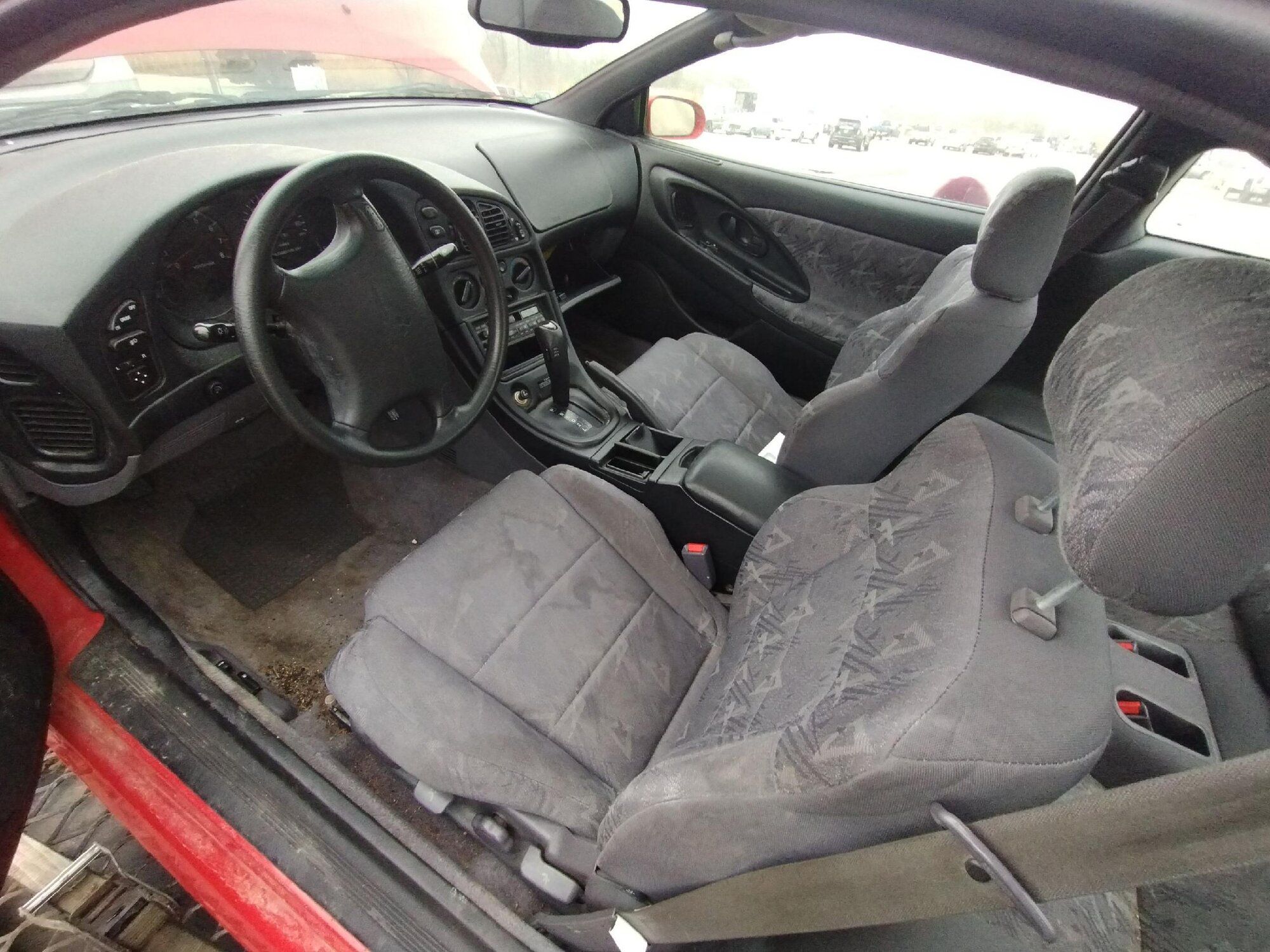

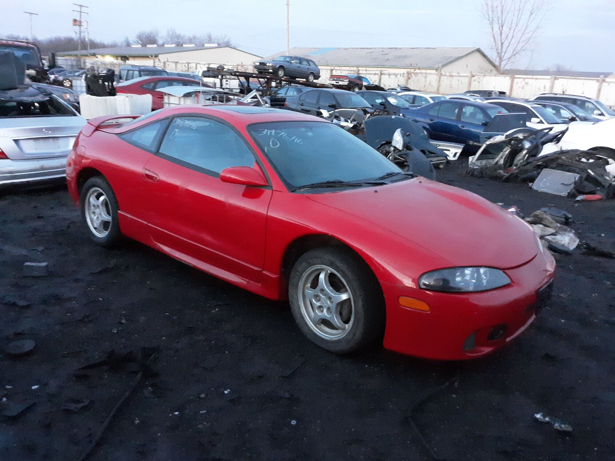

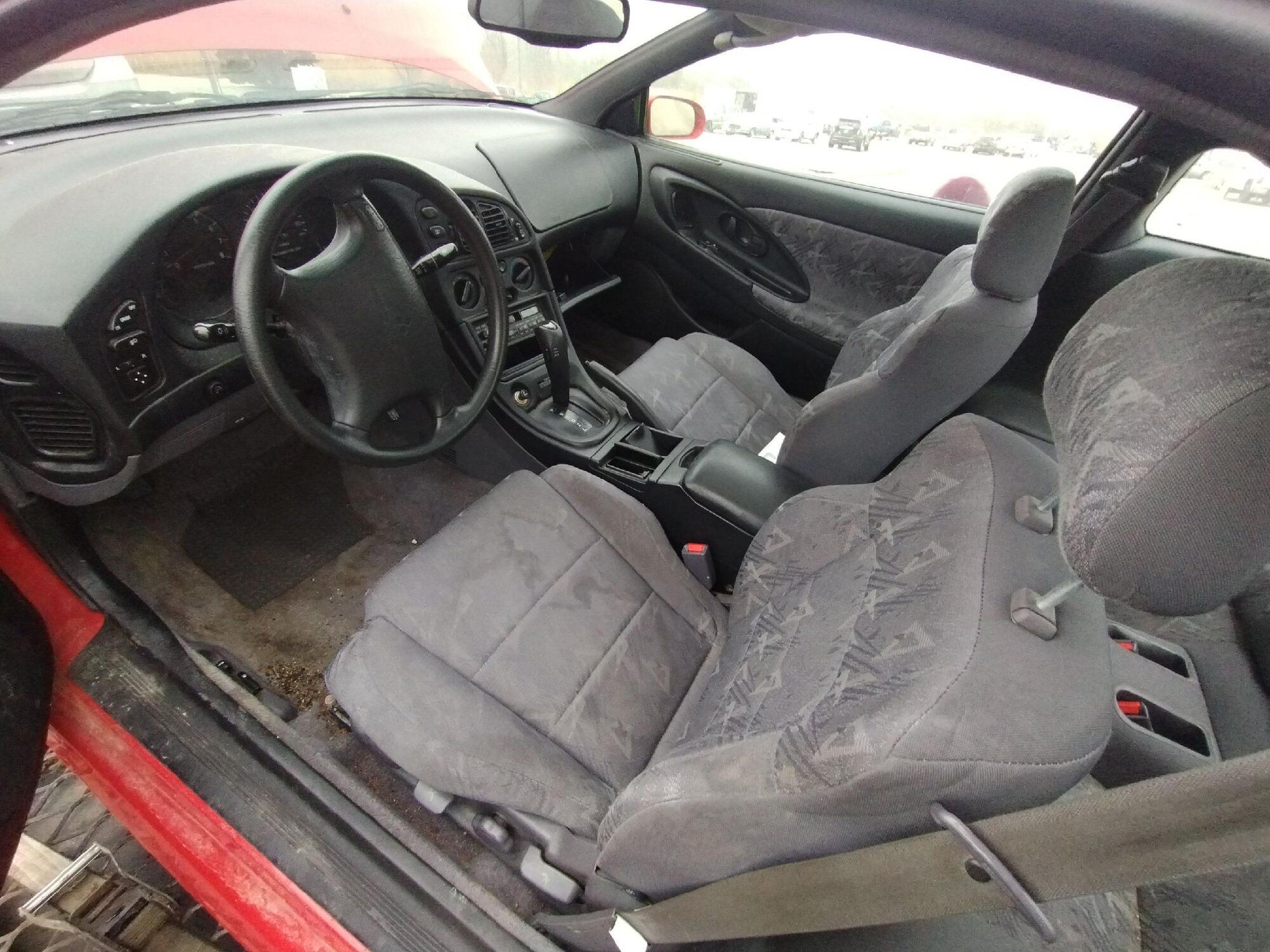

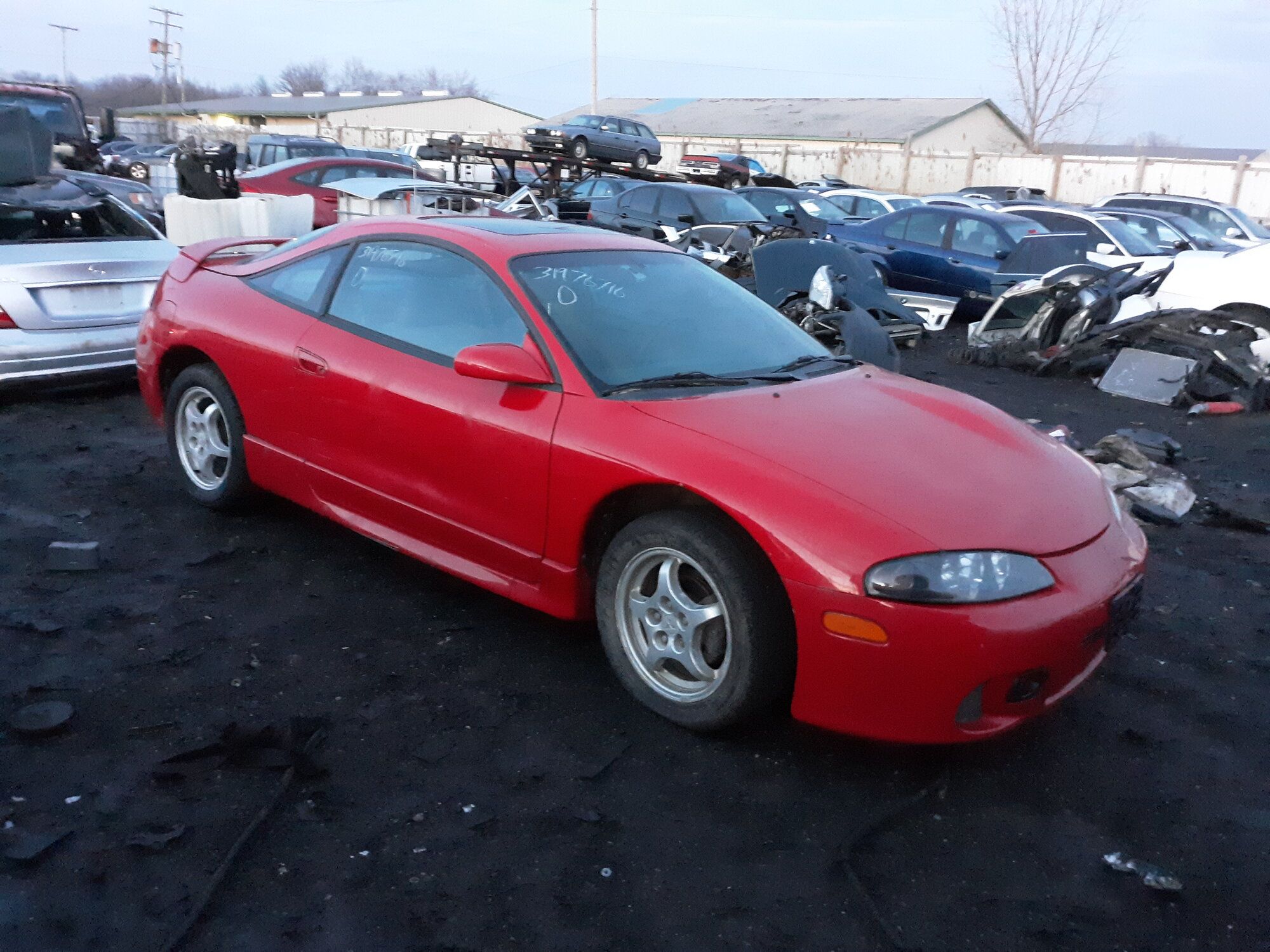

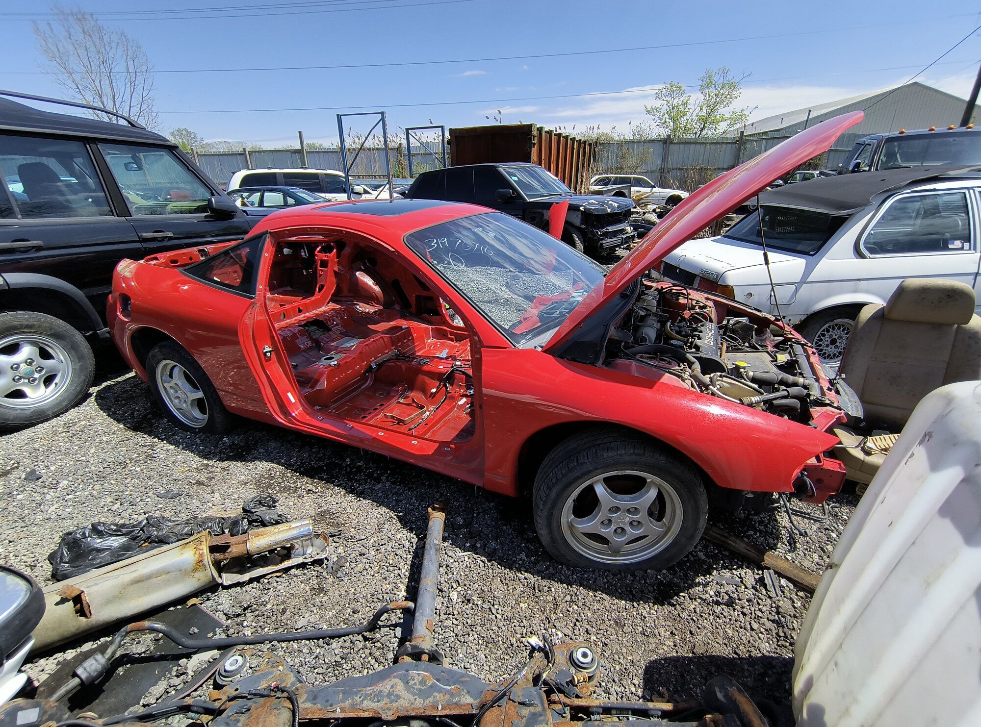

My favorite auto recycler just got this 1998 Eclipse GS in!
The car is beautiful in person, with a bunch of amazing parts, but being from the north, it does have rust.
The doors and hatch are actually in great shape though, and the interior is amazing!
I've been looking for a car like this for a long time. Needless to say I'll be spending some money on this one. 😄

Oof it hurts to see such a clean body taken off the road. I’d have a hard time not just buying the whole thing to save it

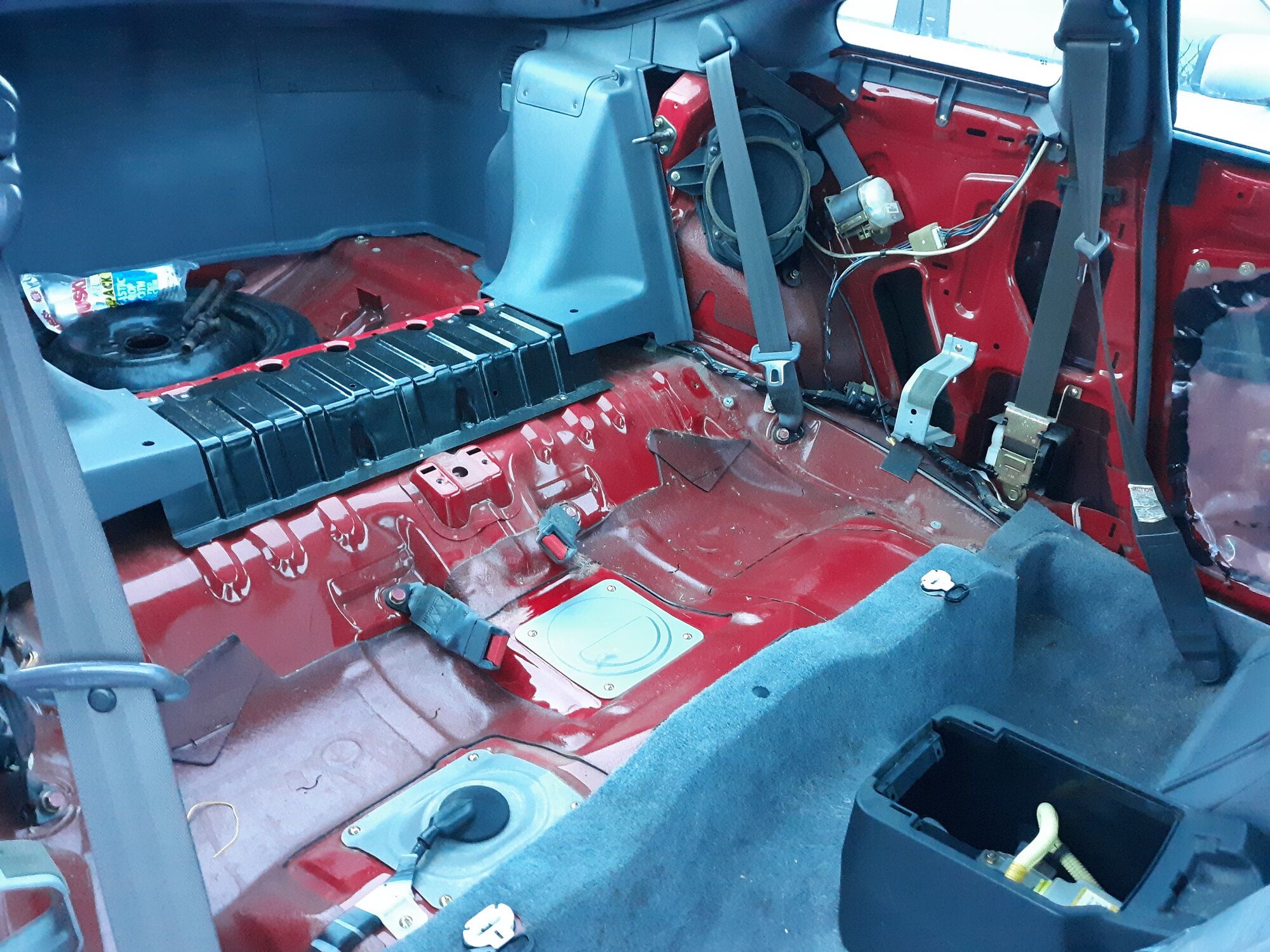

I started pulling parts off that GS this weekend.

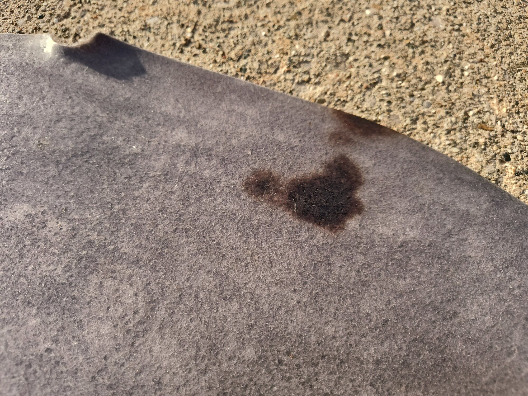

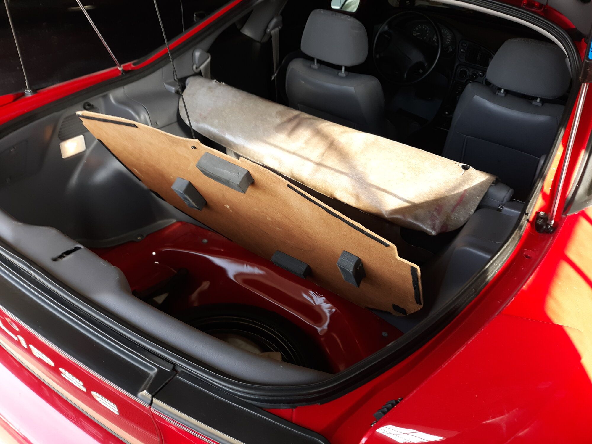

My first pick was the spare tire cover because a previous owner spilled something on my original one.
I realize this isn't typically visible, but I love little details like this. 😉

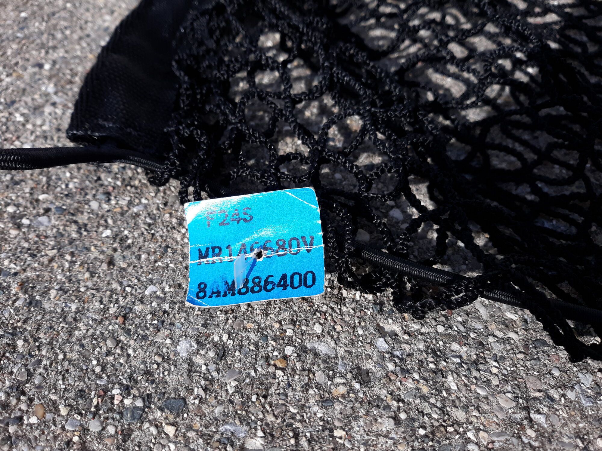

Speaking of little details, the GS had a cargo net with a little blue tag on it. I believe it's an original manufacturing tag?
I've never seen one before. That went into my trunk today too. 😄

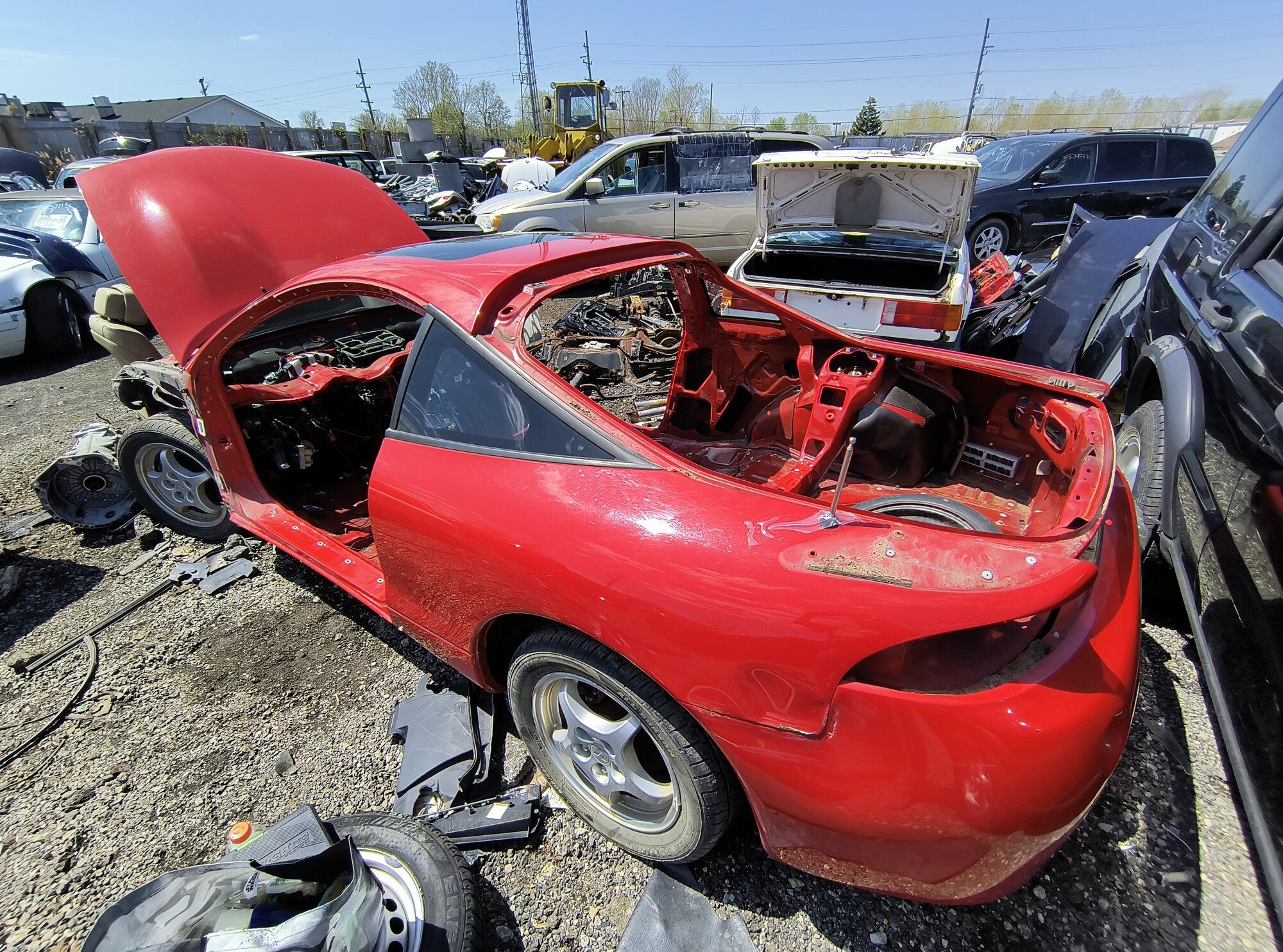

Slowly but surely I'm disassembling the GS. 😁
I worked out a deal with the auto recycler and paid for the whole car... or rather, I purchased all of the parts on it, and I have some time to get them before it gets recycled.
I'm working against the weather and short winter days, but it's coming along.

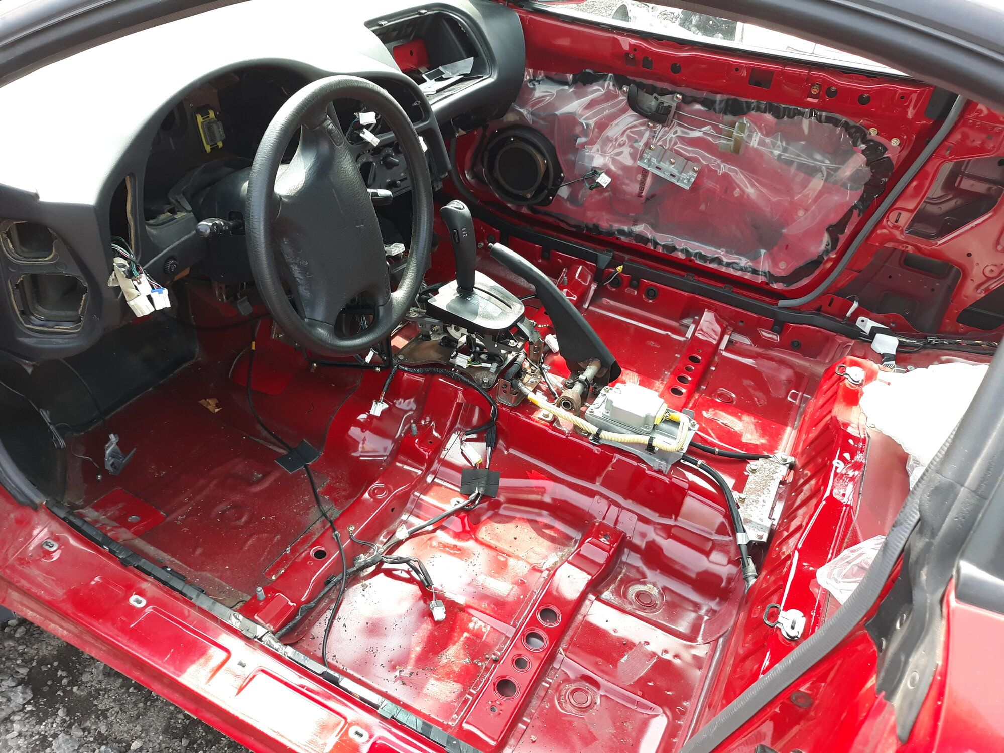

I'm gutting it from the inside out, and in the end, if all goes well, it should just be a hollow shell of red paint, and rust getting crushed. 👍
The weather has been unseasonably warm, and I'm not letting it go to waste. 😊
I was able to get the seats out today!
I've been looking for these seats (2GB GS gray cloth) for a very long time. I can hardly wait to get them installed. :)

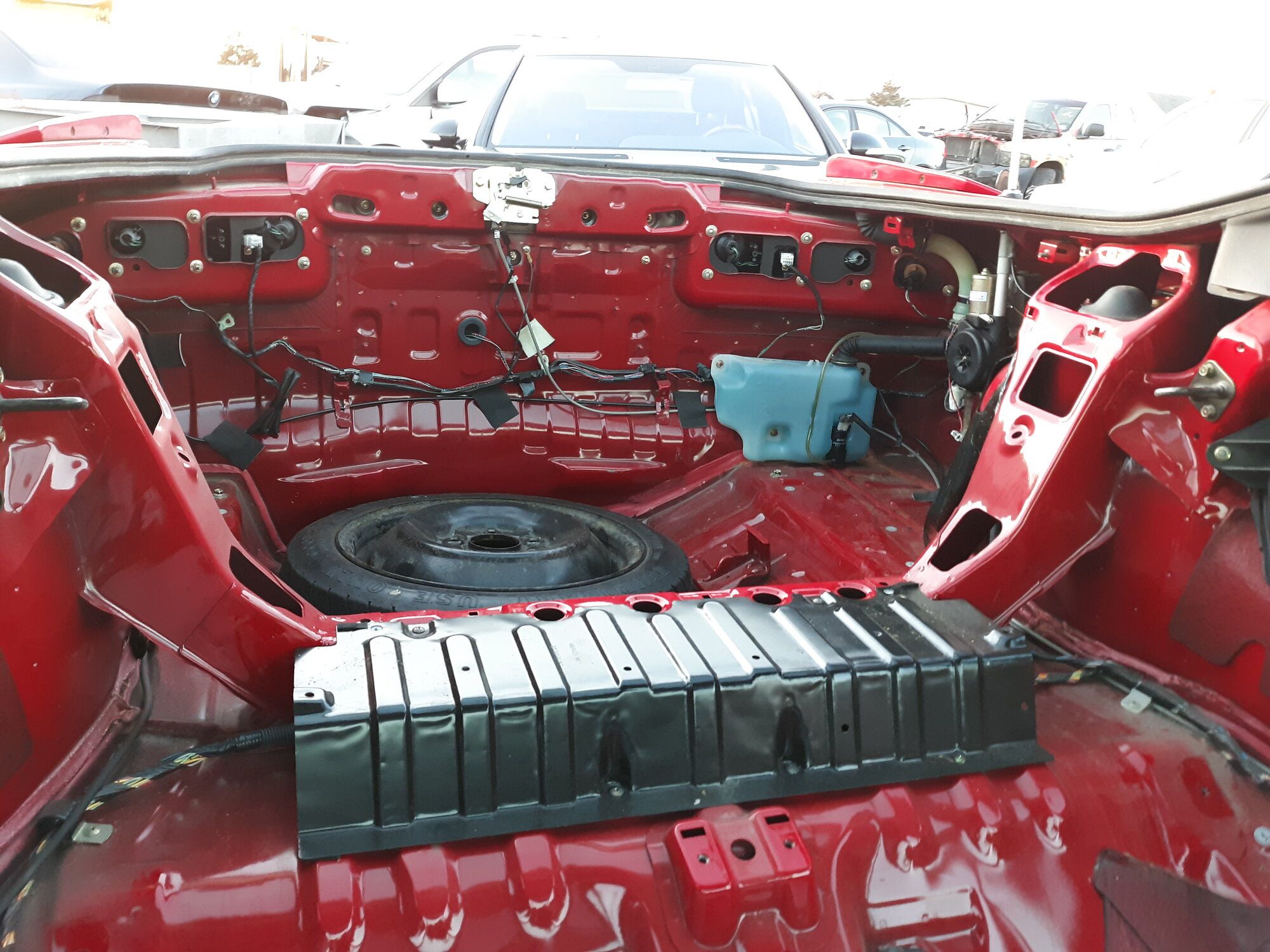

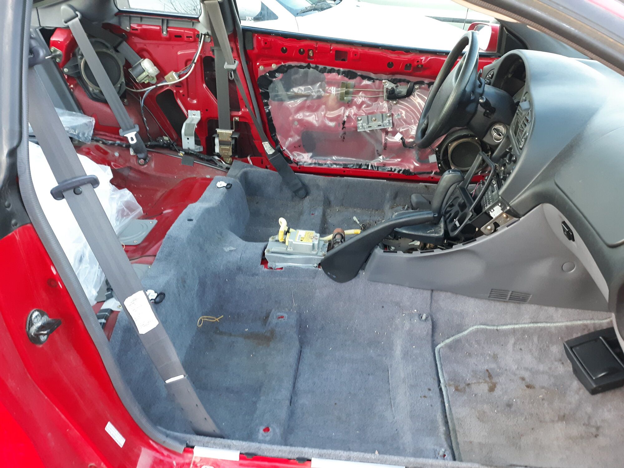

The temperature was over 50 degrees today, and the forecast for tomorrow is snow, so I pulled all of the trunk trim after work tonight. No broken tabs or mounts! :)
I still have a lot to do before I pull the hatch and the doors. I want to completely gut it before that happens since whatever is left behind will be exposed to the elements.
I am being really careful with this. I actually cover the interior with a plastic sheet when I'm done for the day in case the moonroof or any of the seals have a leak. I'm working to save as much as I possibly can. 😁
My next big opportunity is to document how the main harness and hatch plumbing are routed and installed. I just need to pull a few more things before I can get a really good look. I can hardly wait!

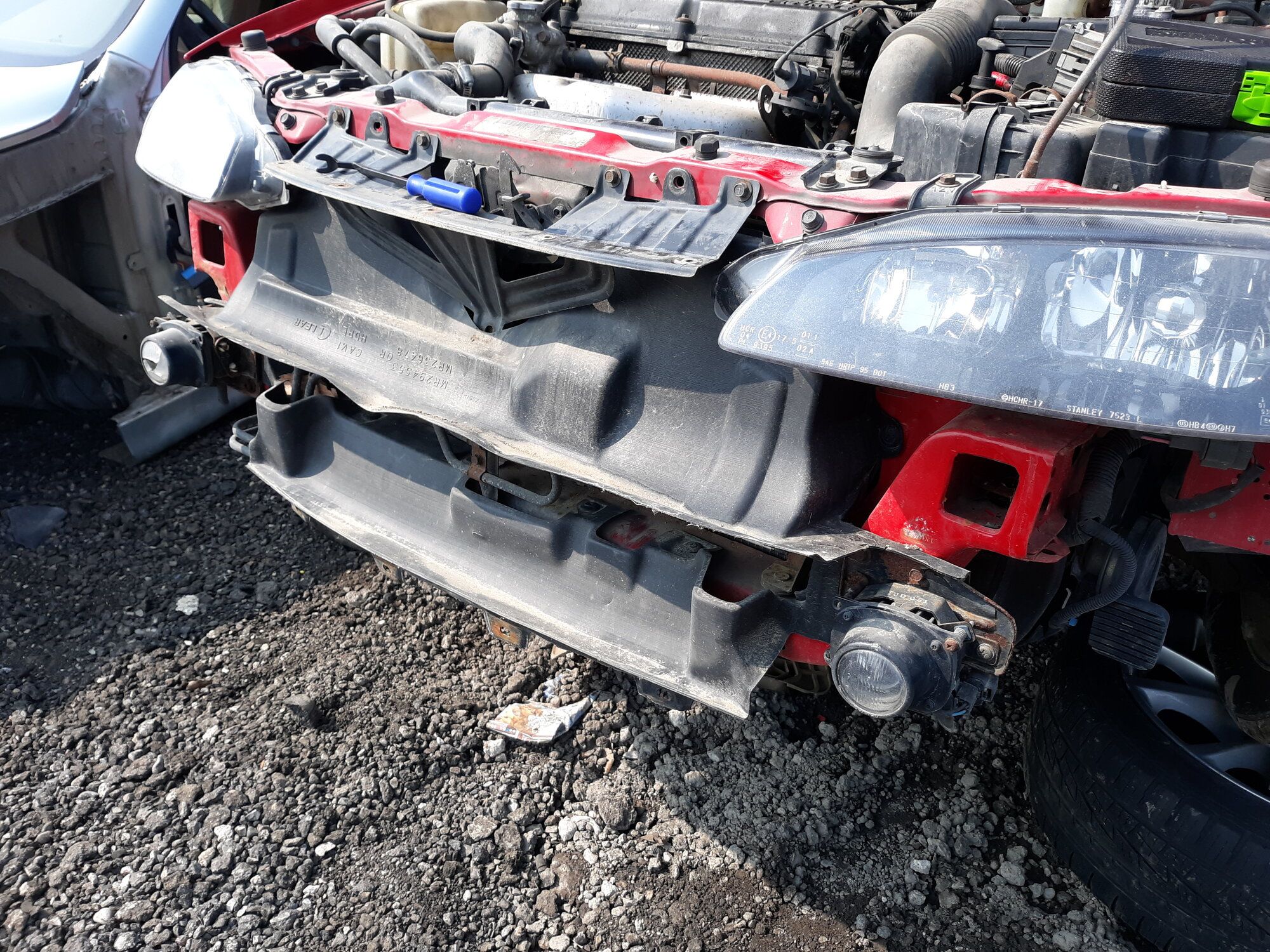

It probably sounds strange but I'm really excited about the plastic duct behind the front bumper. I've been trying to find one off a GS for a very long time now, but they always seem to be damaged in some way. This one is in near-perfect condition, and I'm friggin geeked about it!
This is one of those more subtle differences between the RS and GS. The GS duct has holes pierced for the fog lights. The RS one does not.
Yeah, it's probably pedantic, but I really love those little details. 😁

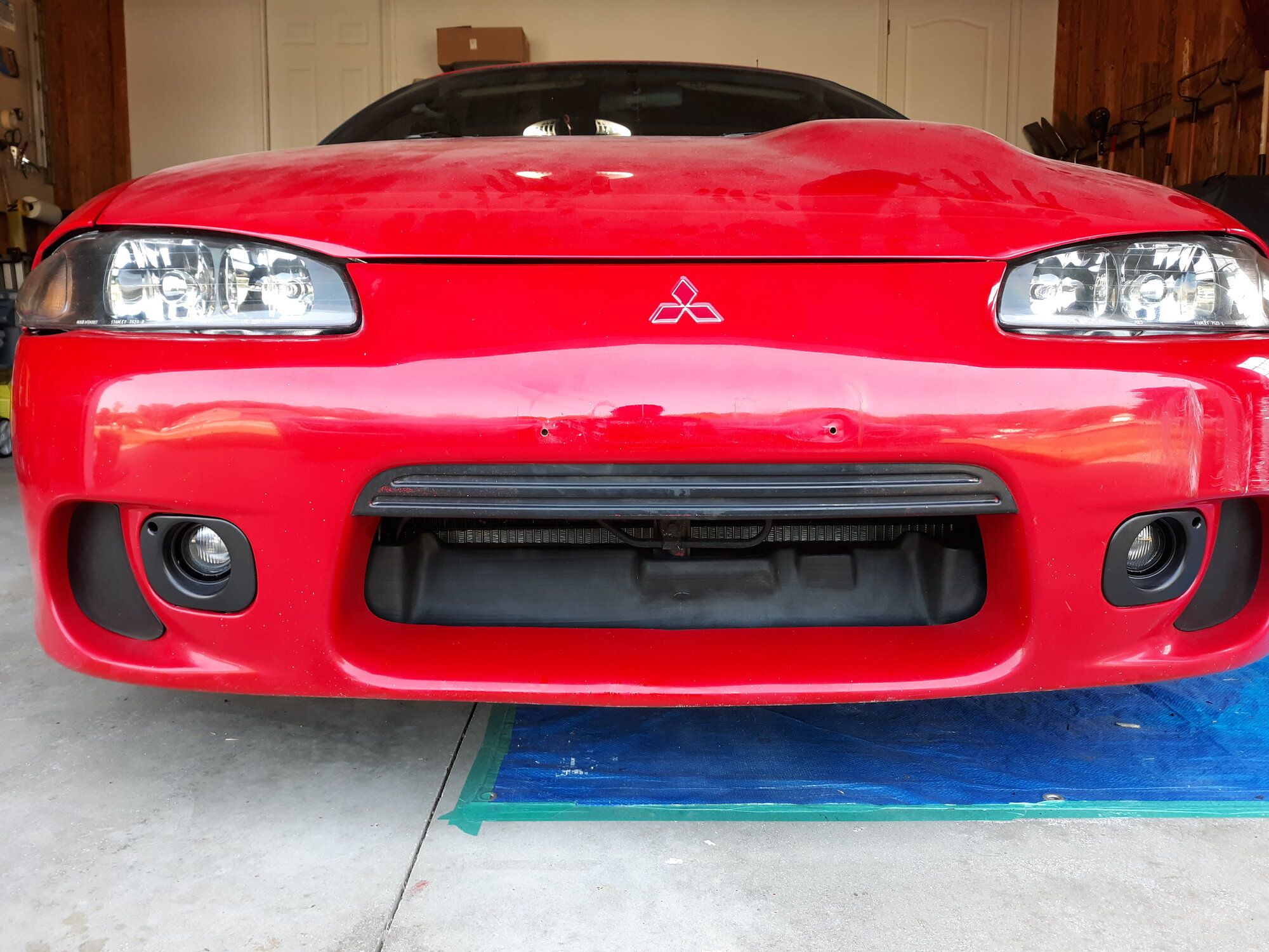

On that note, the parts car had an OEM front bumper on it AND that duct I'm still unreasonably excited about. So I thought, "hey, why not take an hour, and install those?" Afterall, Fort Gratiot cruise weekend is coming up this weekend, and I've been wanting to replace the headlights and a broken fender liner anyway. Might as well get it all done. Easy-peas-y, right?
12 hours later...
It needs to be repainted (like the rest of the car), but I love it. It looks so much better with the Mitsubishi emblem, in my opinion.
We had a heck of a time with it though.
Long story short, the car was missing some bolts and we had to fix a bent slot because, as best I can tell, the previous owner went John Cena on it rather than to try to reseat the bumper bracket when they missed the slot. That was fun. 😆
It was a lot of work but it's all fixed, and all the fasteners are in their place. Thankfully I had spares. 😅

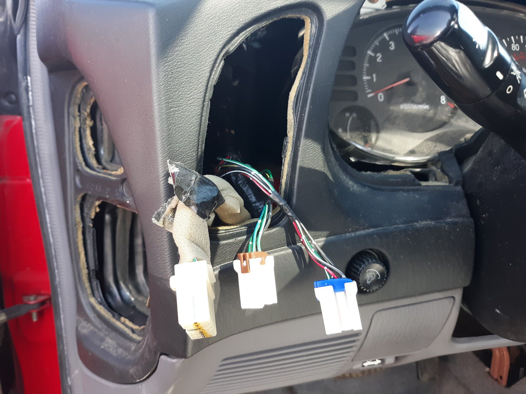

I'm really excited about the doors because that will allow me to get the power side mirrors up and running sooner rather than later (plus it gets rid of about 50% of the dents on my car! 😆).
Getting the fog lights and rear hatch wiper working will take more time because it's a lot more extensive wiring job. I'm still thinking about the best way to handle that.

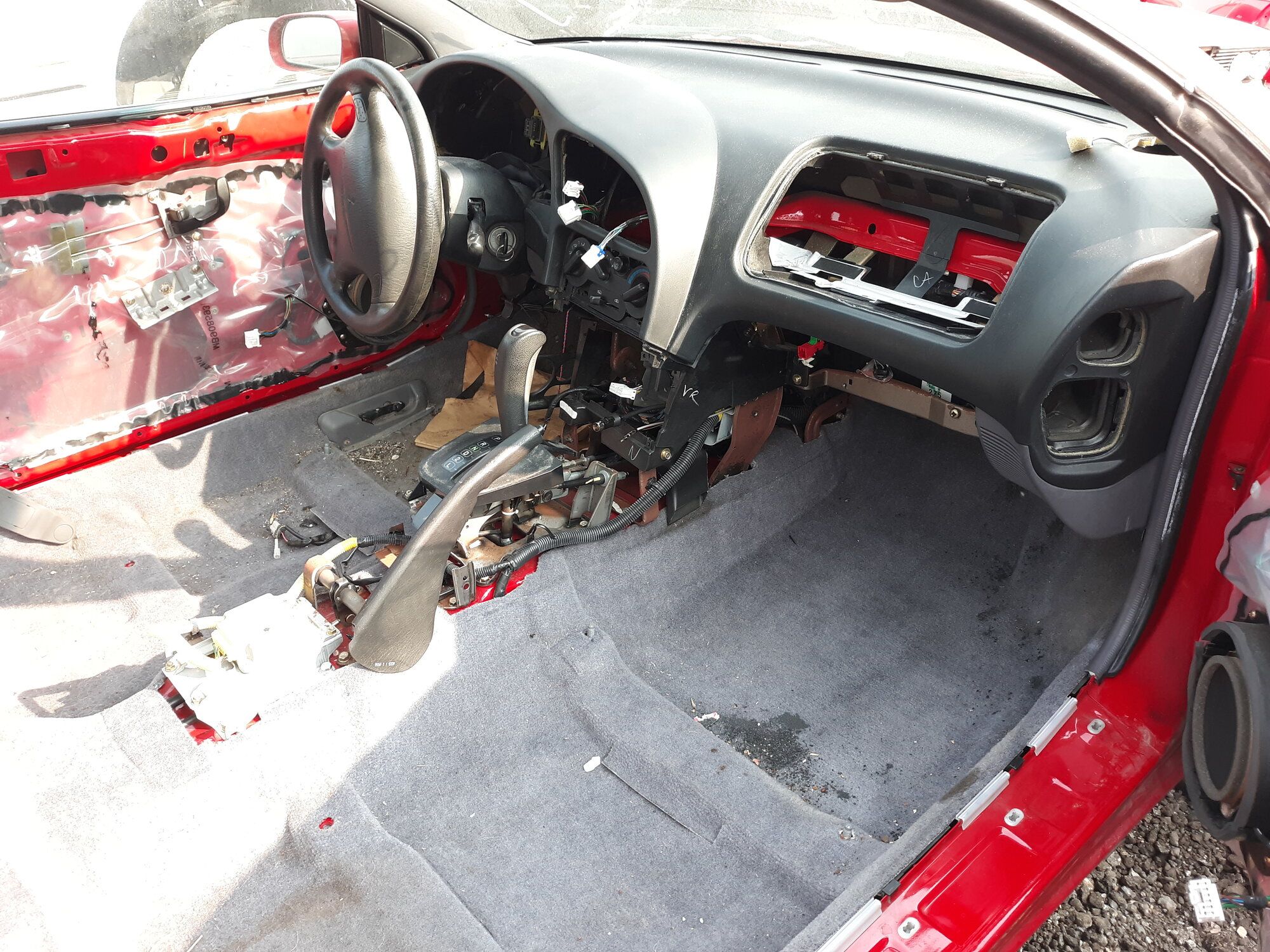

I have a few more things to tear out of the interior before I pull the hatch and doors and start cutting sheet metal. With the main harness out, I will have no trouble pulling the rear washer tubing out of the trunk. That's my next target. 👍

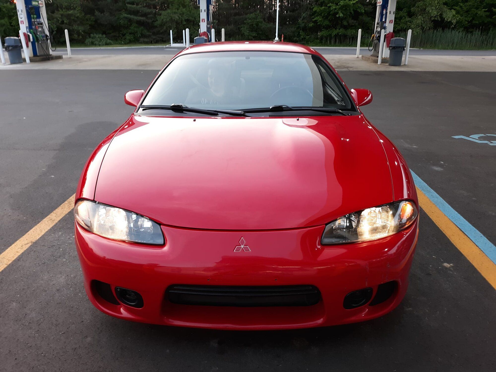

Oh yeah, and I finally cobbled together a good set of OEM headlights. That was a long quest, LOL. The lenses are pretty clear on both, but they could use a polish. Anybody have any tips for a treatment that lasts?
Congratulations on your progress. Use 2K Clear 2-part spray epoxy on the headlights once they are sanded/buffed clear.

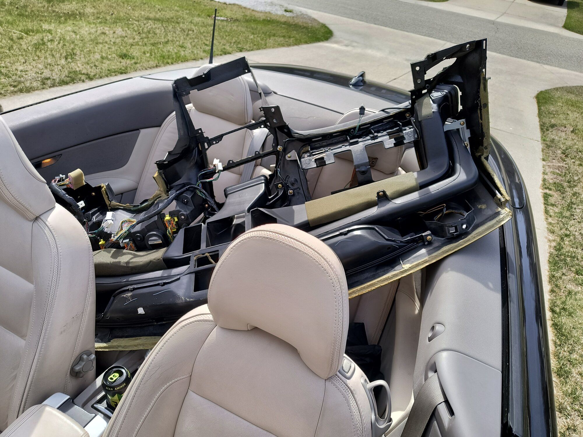

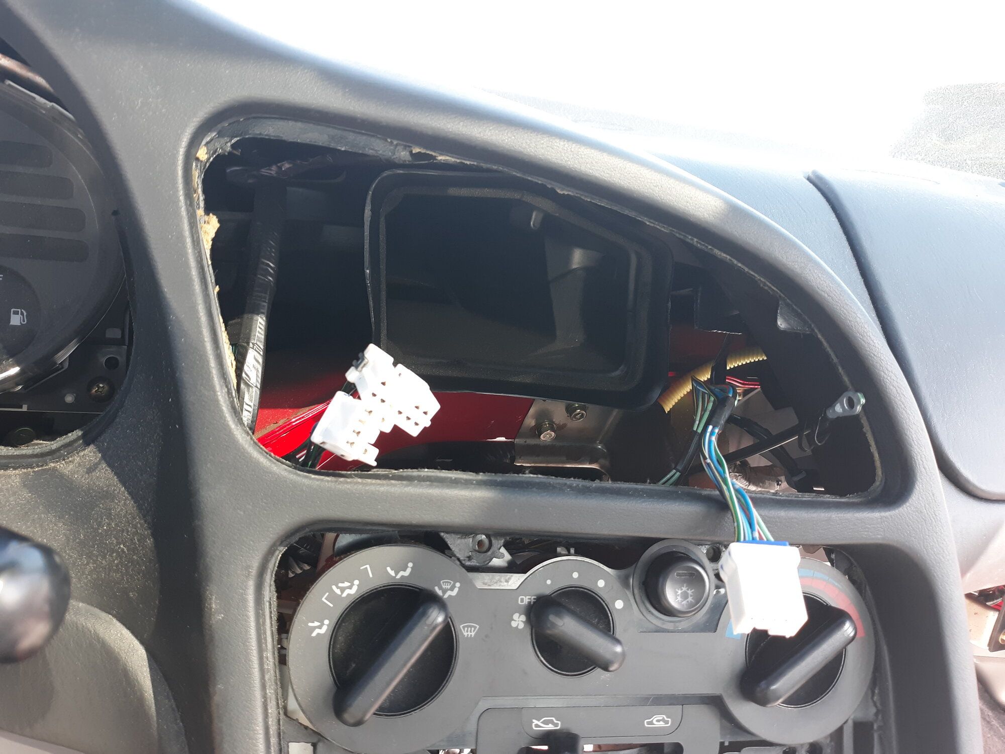

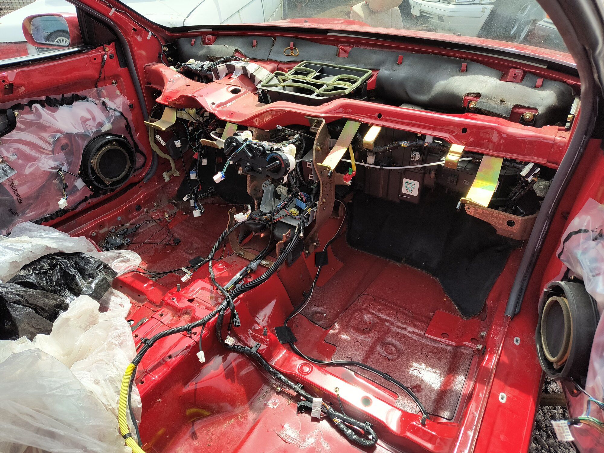

Other than that, I'm back to tearing apart the GS I bought last year. I pulled the dashboard today, so there isn't a whole lot left to take out of the interior, which is good. I'm anxious to pull the hatch and doors soon. The weather and sun aren't doing them any favors, and these are key components for my build.
Fun fact, you can fit a 2G Eclipse dashboard in a 2011 Volvo C70 with the top down... Sort of. 😆
When you don't have a truck, you find ways to make it work. 🤷‍♂️ 😁

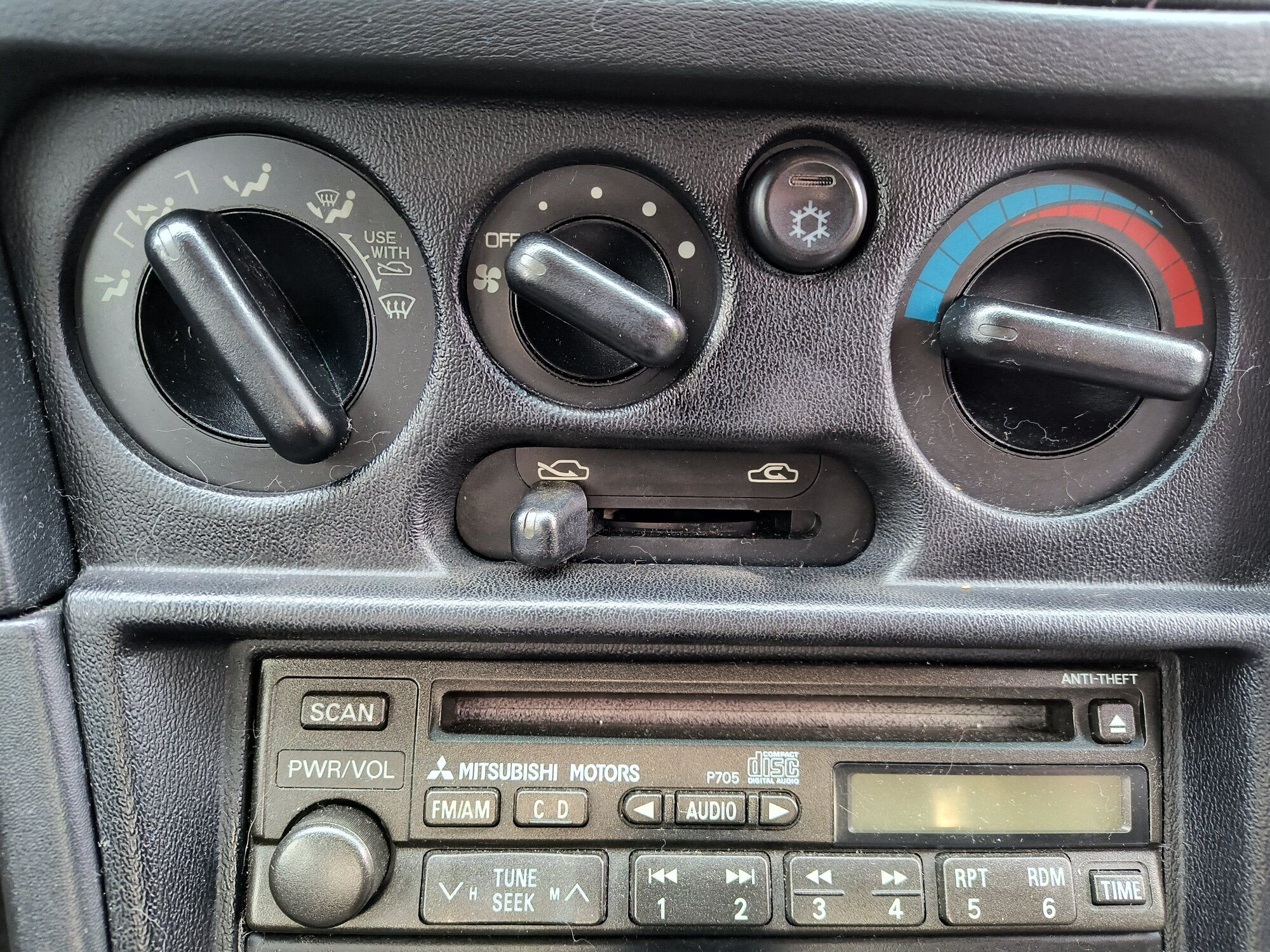

Finally got around to fixing the air vent lever on my HVAC controls. It wouldn't go all the way to the left.
I reseated the cable behind the glovebox and now the vents fully open and close. Pretty easy fix for something that has been bugging me since I bought the car. 😆

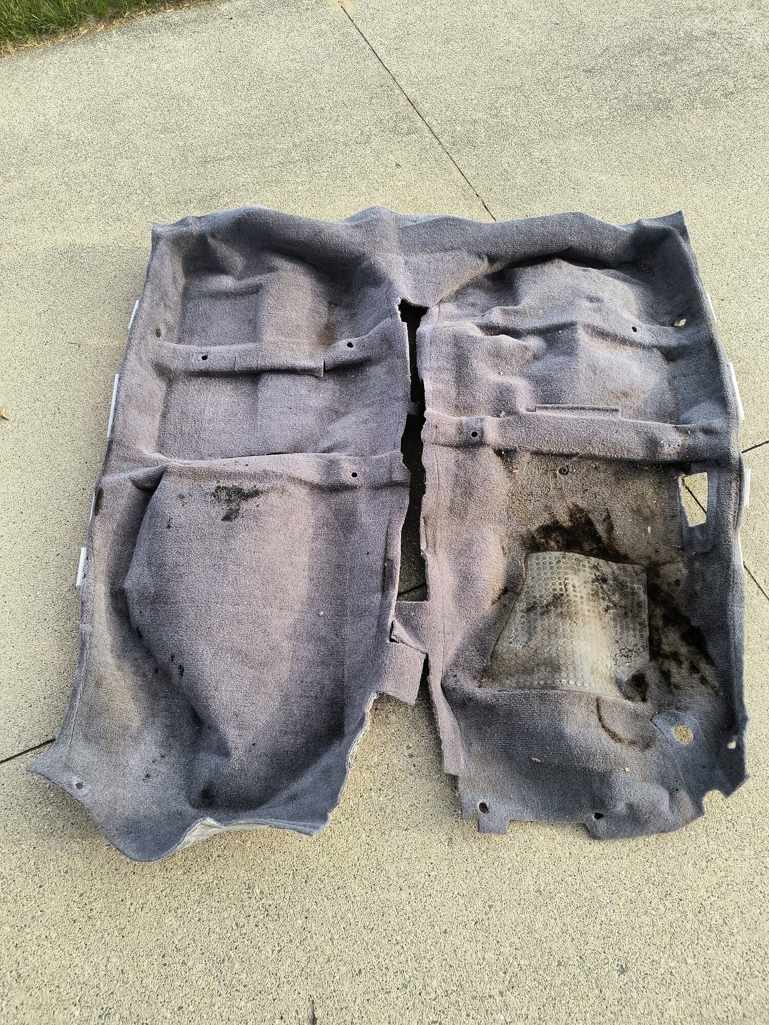

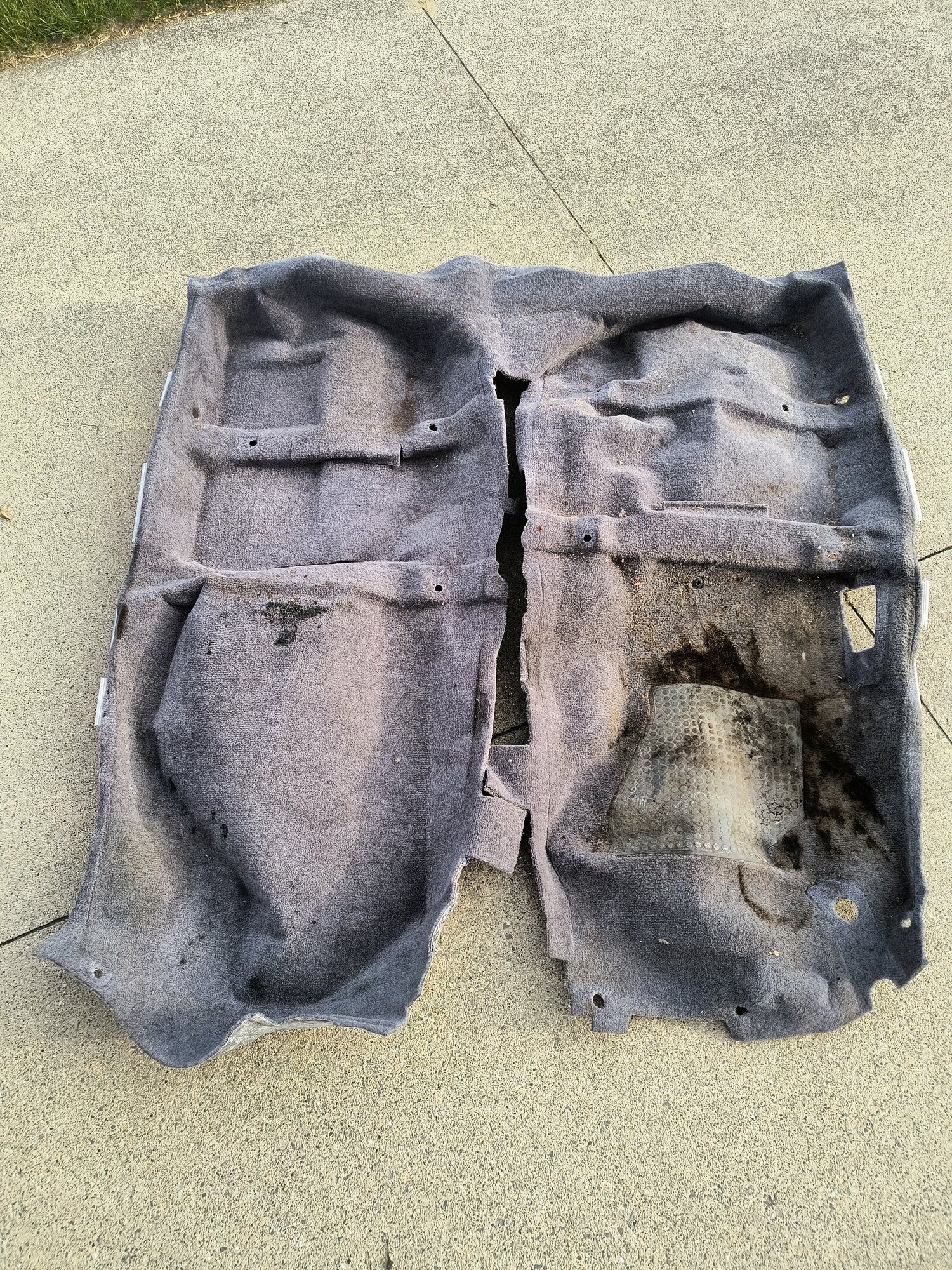

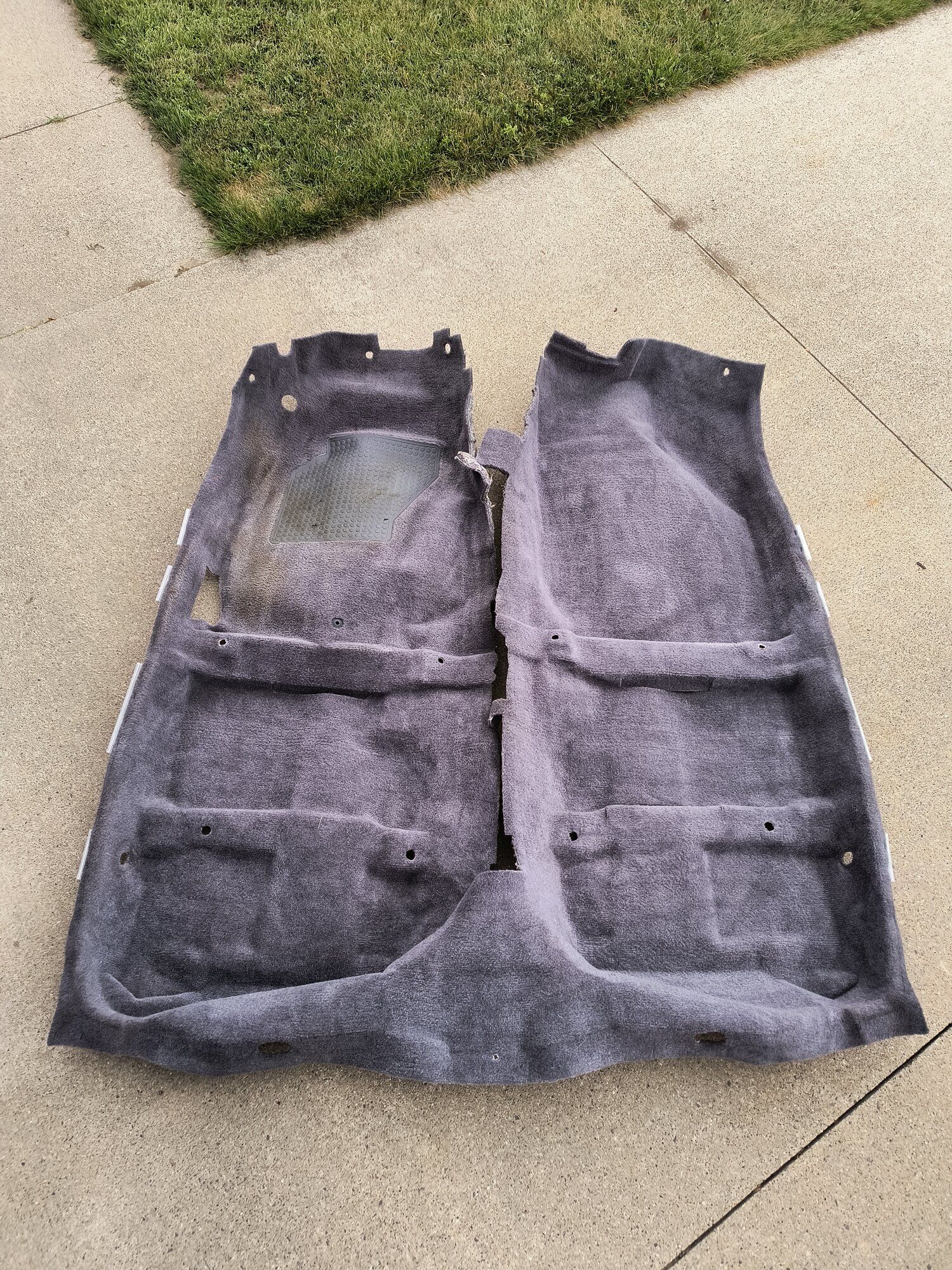

Try as I might, I haven't been able to find a mint trunk carpet, so I decided to try to clean the one I picked out of my parts car. It's kind of sad because that carpet was ALMOST mint, but unfortunately a little bit of oil dripped onto it and it bled through to the backside. While the backing will never come clean, I'm hoping the visible surface can at least be restored.
I dropped it off at a local professional detailer along the carpet out of the GS, and that nice set of OEM headlights I cobbled together a few months back. They seemed pretty confident that everything would clean up nice. I'm excited to see how it all turns out, which should be tomorrow.
The carpet is especially exciting because, even though the GS it came from was a '98, it still had the old-style floor mat hook, whereas the carpet in my '99 has the newer style hook. I don't know why, but they made the redesigned hook too big to fit the dealership-upgrade floor mats. Weird right? 🤷‍♂️

Try as I might, I haven't been able to find a mint trunk carpet, so I decided to try to clean the one I picked out of my parts car. It's kind of sad because that carpet was ALMOST mint, but unfortunately a little bit if oil dripped onto it and it bled through to the backside. While the backing will never come clean, I'm hoping the visible surface can at least be restored.

Well, the carpet isn't perfect but it's very much improved! I felt like they did a great job considering how nasty it was when it went in. 😆
I'm planning to take a crack at that lingering stain soon. I bought some Meguiars carpet cleaner that I'm itching to try out. It's just been crazy hot... And I've been busy... And lazy... And yeah, definitely waiting for milder temperatures. 😆

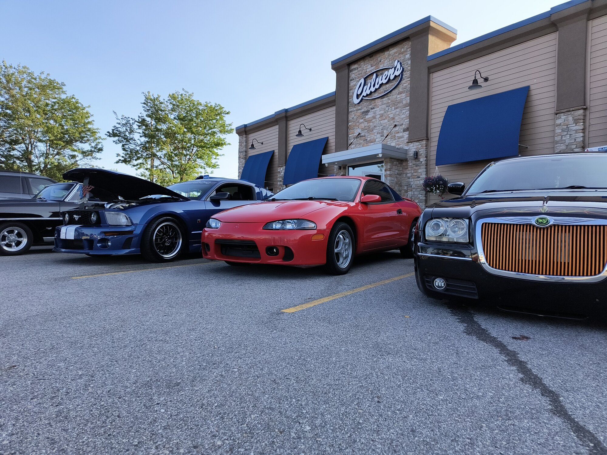

In the meantime I took the car back to the weekly Culver's car show tonight and actually met the owner of the other Eclipse I usually park next to. He seems like a great dude, but then, I find most Eclipse owners tend to be pretty cool people. 😉 Needless to say I pointed him to this website to support his build.
Tonight's show was special, as it was supporting a local charity. It was fun popping the hood amongst a sea of muscle cars and classics. I normally don't do it because I don't like to brag about the piston slapping 140-ponies under my hood, but no sense being modest amongst car enthusiasts, I suppose. 😆

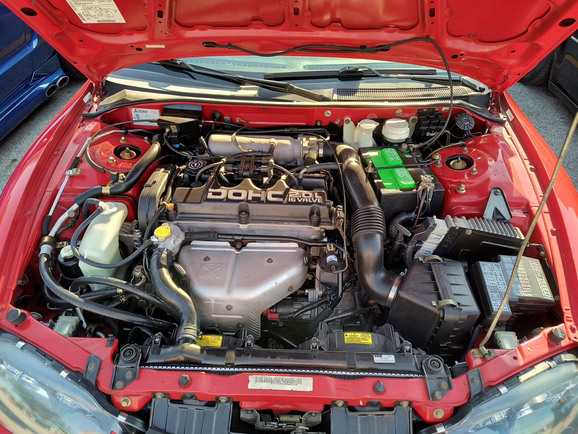

I know this sounds weird, because the 420A really is not a great engine, but man, I have grown to love this stupid thing. It has a nice look to it, it's not terrible to maintain, and I love how it sounds when accelerating. For relaxing summer cruises with my wife and son, it's perfect.
