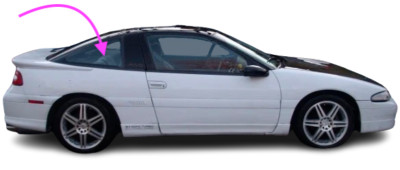

I’m putting this here because it’s the top search result for “ rear quarter glass”
The following vendor has new glass for the 1 and 2Gs
Best Auto Glass
Looks like only passenger side is available for the 2g. Good looking out though.
They quoted the other side for 370 not listed
