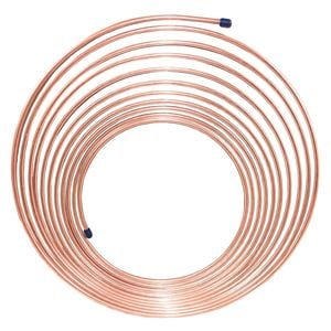

Hey guys looking for replacement options for rear brake lines. Iv found full brake line kits for 300-500$ but really only need the rears. Not sure if i could get just the rear two?

25' coil of NiCopp line and a double flare tool. That stuff is so easy to work with and I did both my Red and my Blue car that way. You'll have about 1' left over, if that and it will clip into the old brake line holders.
OR
Save the fittings and use them on the new line. Hardest part is fishing it up to the proportioning valve, as I am sure you know.
Bobby @EC17PSE has some good brackets if you can't save yours, but somehow, I was able to save my brackets to reuse. Now they weren't perfect but still just a cleanup and they were much better. It's an option Vic :thumb:
I was able to run all of the lines back thru, NiCopp is a nice line to adjust to most things by tubing bender or finess by hand, gently.

I’m pretty sure that’s who i ordered the clips from. Looks like great products.
Also i emailed a company called “classic tube” they had full brake line kits for 1g AWD they also have the fuel feed and return lines. They agreed to make me just the two rears lines for 100$ per line. So 200$ for pre-bent lines sounds good to me! Figured I’d share for anyone looking for rear lines.
