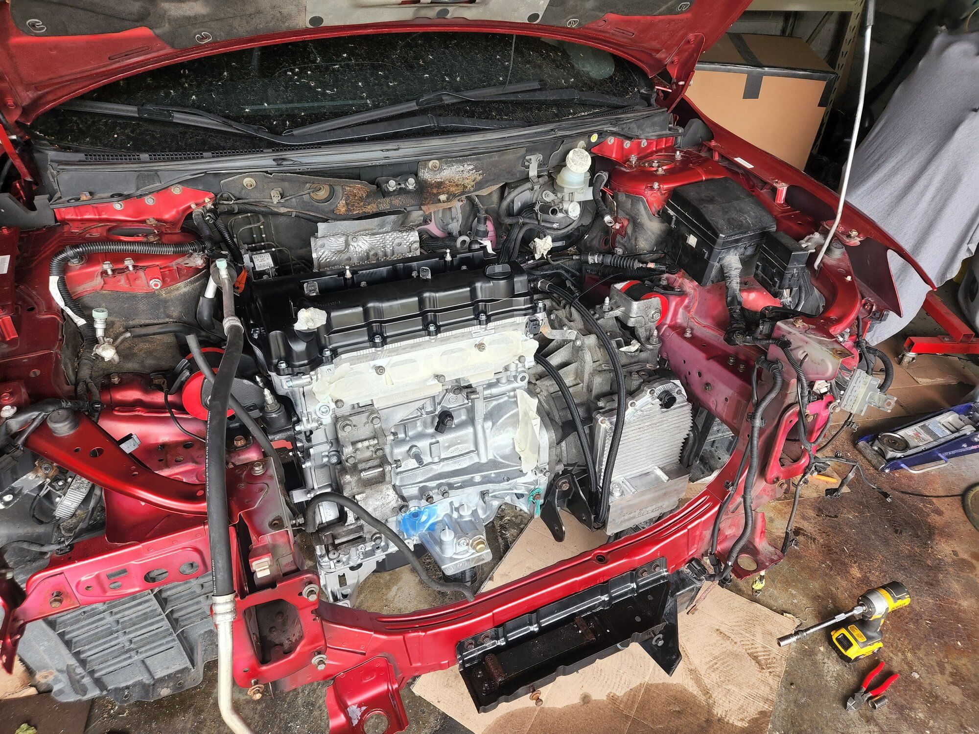

New longblock fired up easy and had no drama or leaks. Knock on wood. First 12 miles on the road went well, feels a bit harsher with the new control arm bushings and motor mounts. New turbo feels good, like stock.

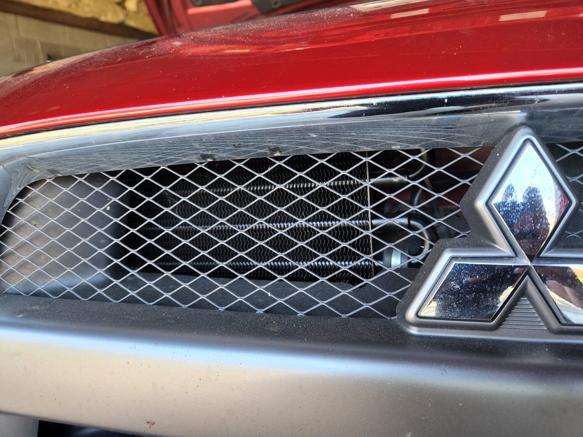

Universal heat exchanger applied to power steering circuit
Tucked nicely into grill

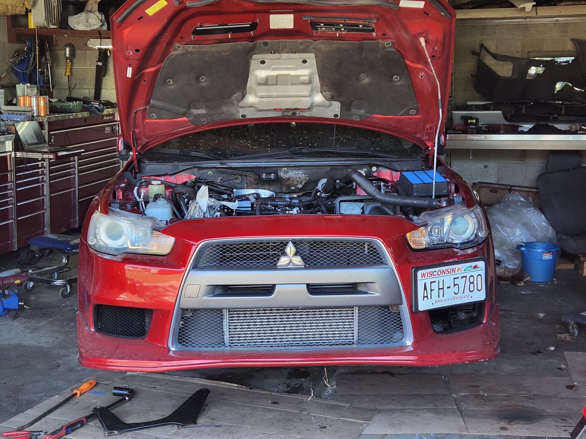

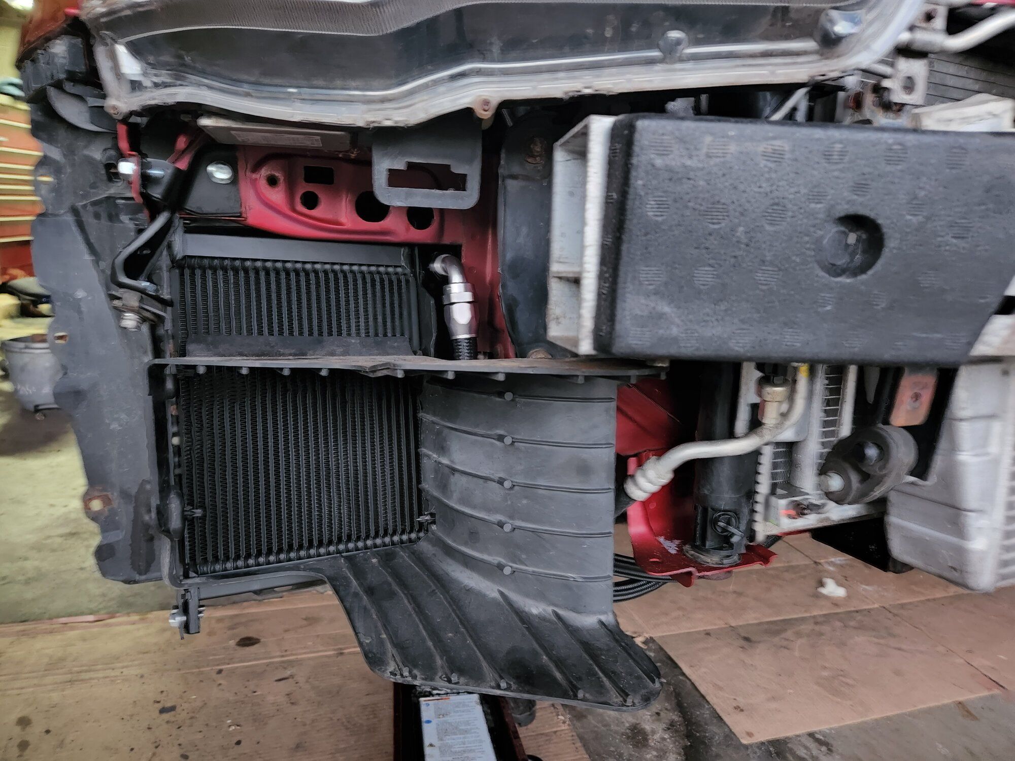

The power steering cooler looks natural at a distance. The bumper no longer has the stock foglights installed. I used JDM EVO X RS mesh grilles and bezels to keep a factory-ish look without having the foglights in the way of air going over the oil cooler (passenger side) and trans cooler (driver's side).

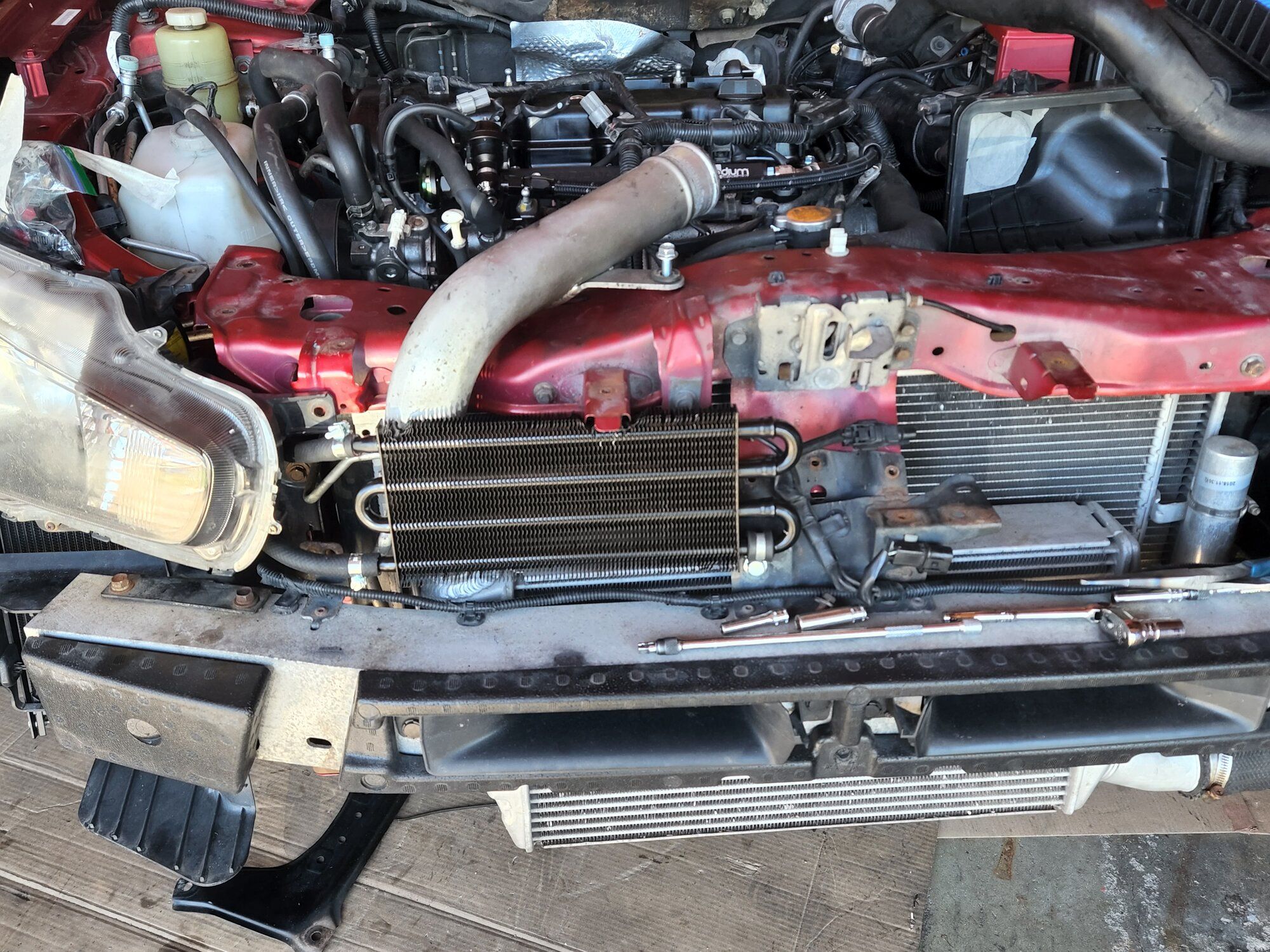

New MAP V2 oil cooler kit, uses stock air dam to move air from foglight opening thru heat exchanger.

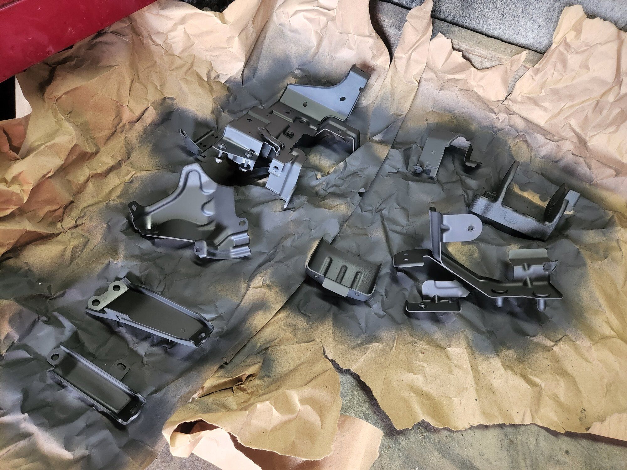

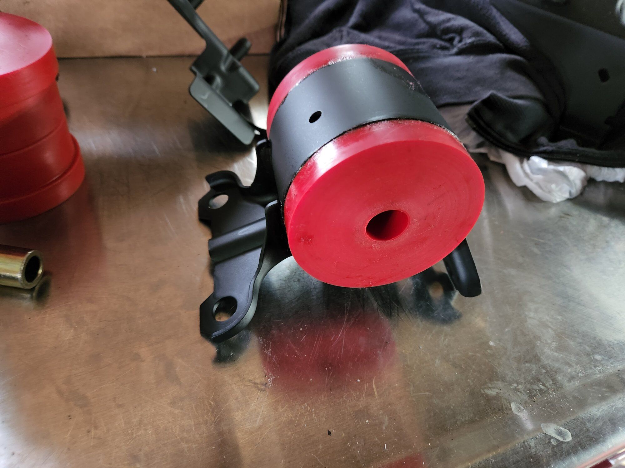

Reworked motor mounts, blasted, painted, poly bushings installed.

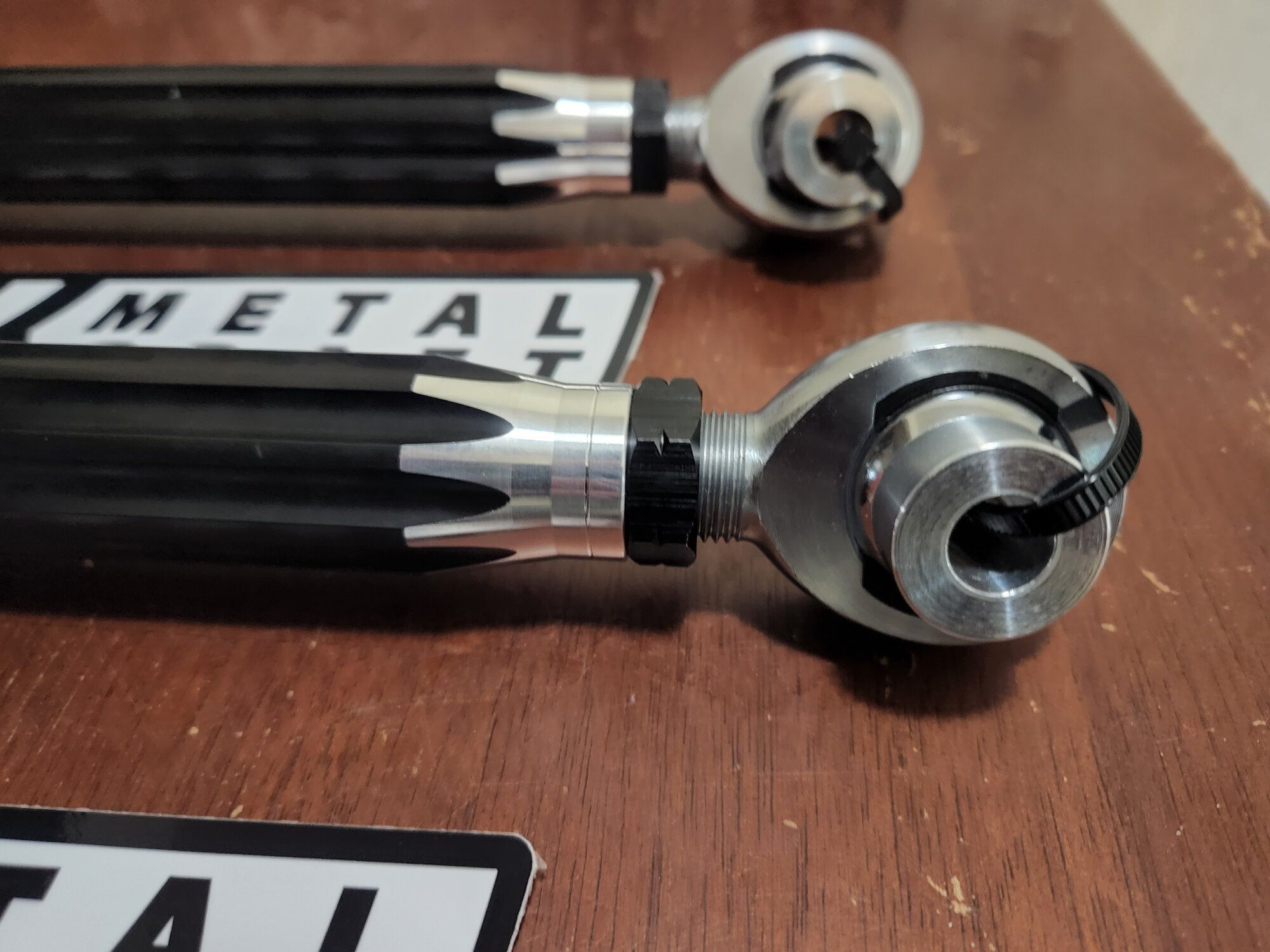

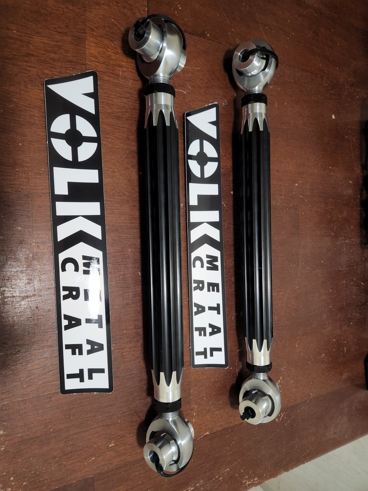

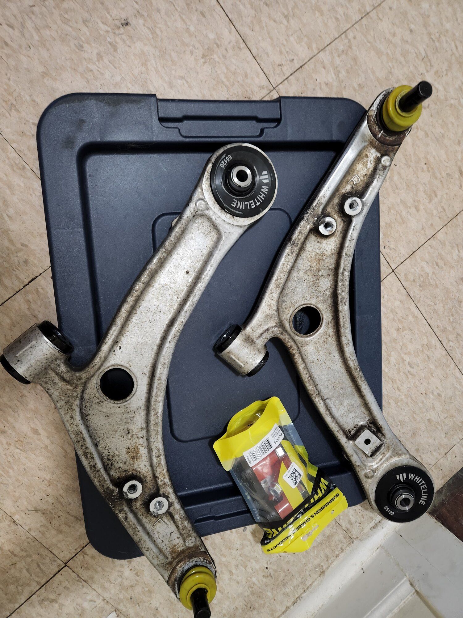

New roll center correction ball joints, caster bushings with spherical joints and poly control arm bushings (also adjustable links for the front sway bar.

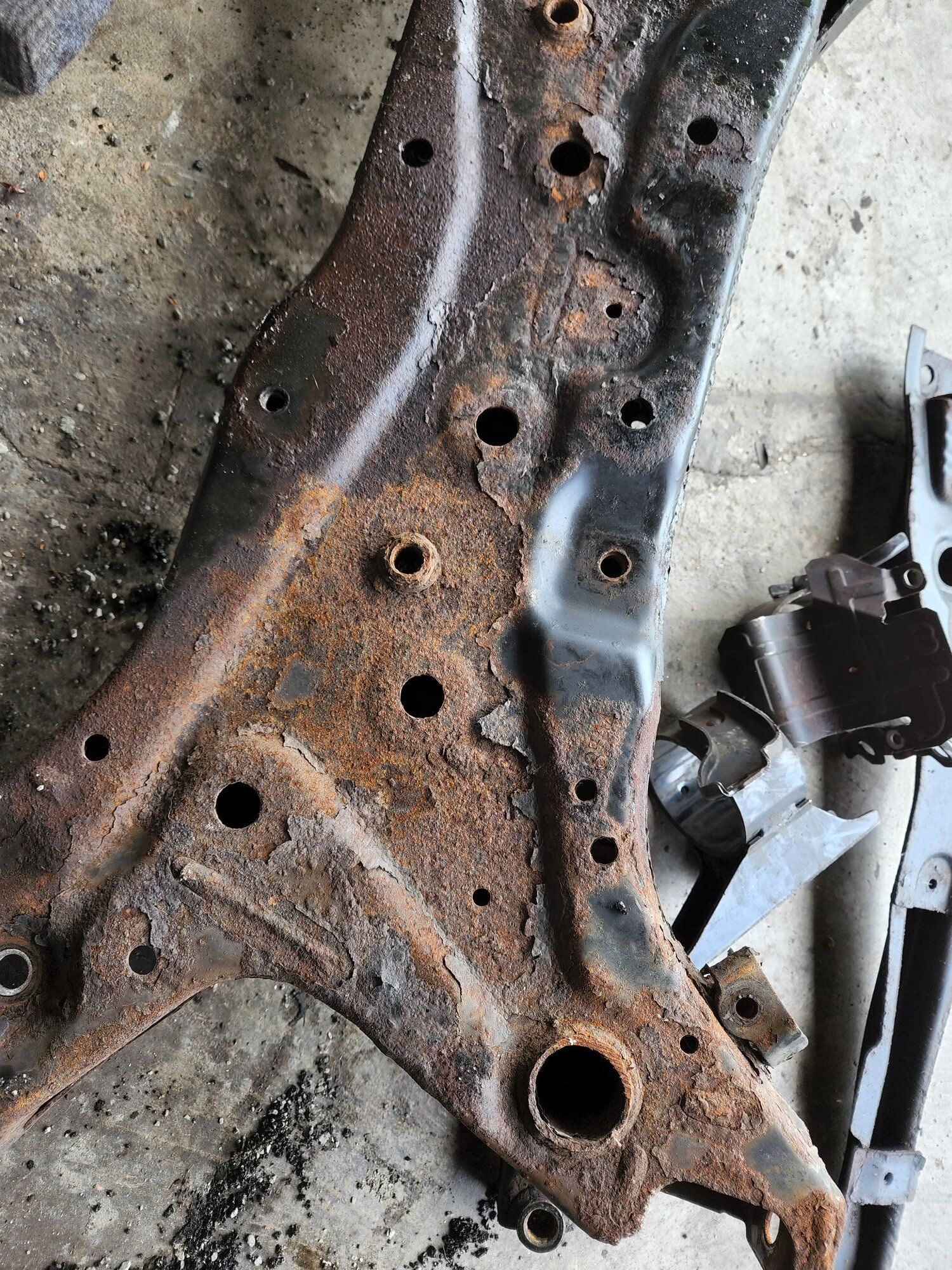

Old crusty subframe with 212k miles

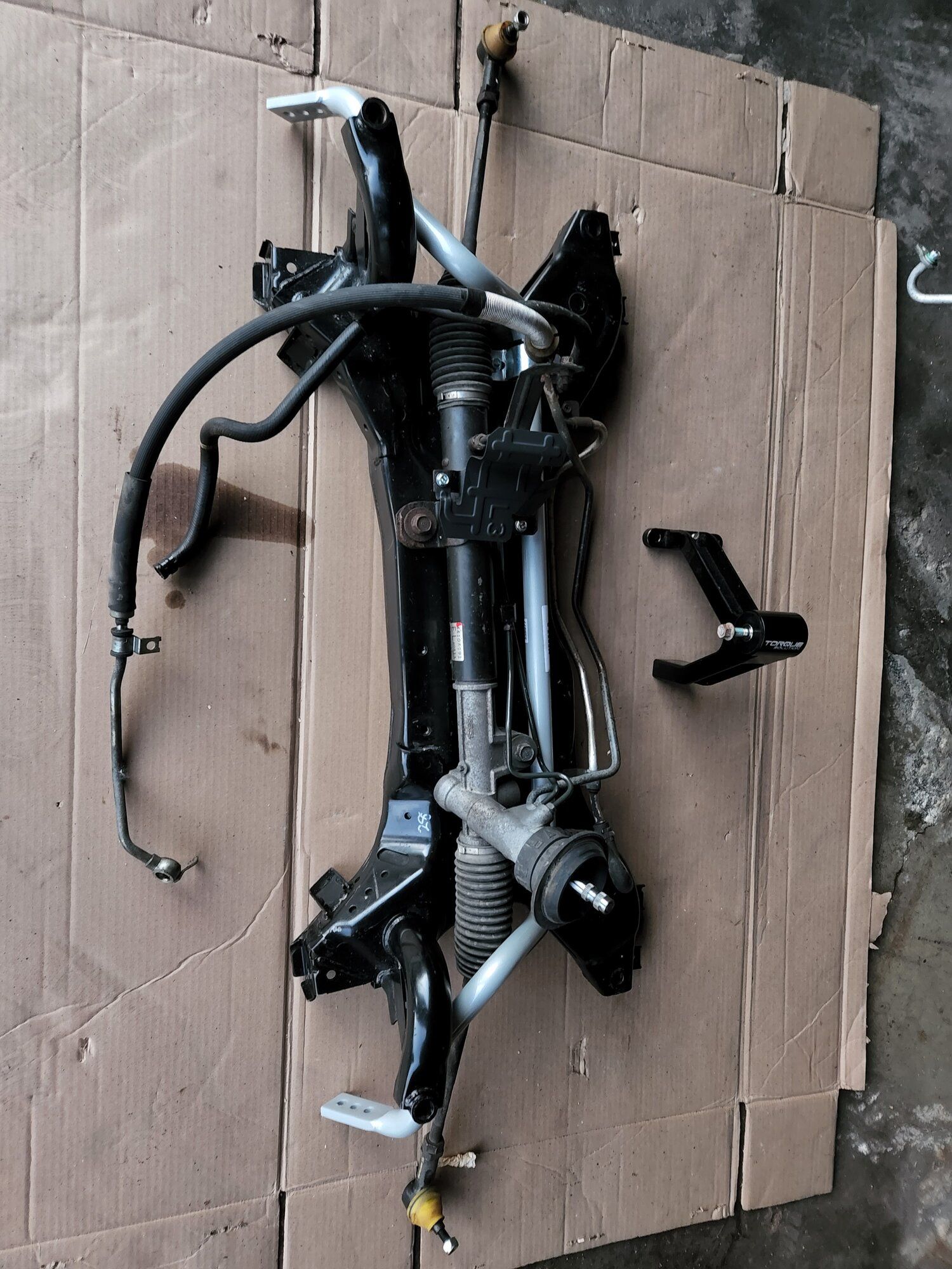

New (used) replacement subframe getting assembled with new motor mounts and whiteline sway bar.
