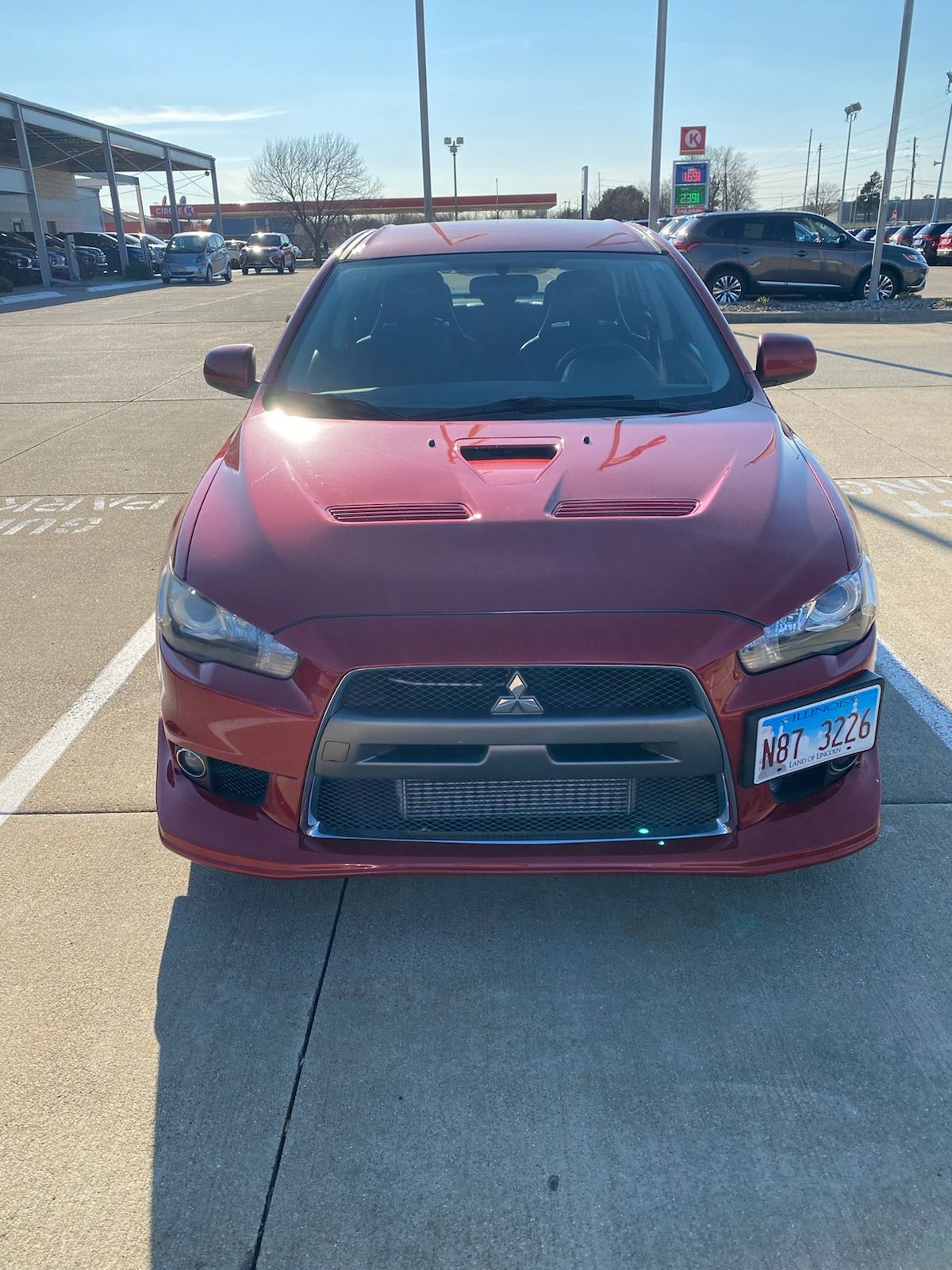

rabenne's EVO X MR
Just a daily driver
SAWEEEEET Will !!!!! :sneaky:
Love the model, love the color.....jealous but super happy for you.
I think I deserve one too, but man, the property taxes in KS are OUTRAGOUS on stuff so I can't do one.
Marty :thumb::thumb:
thanks buddy! I have been secretly wanting and Evo since 2003... I didn't really get to choose the specifics on this purchase, but that's okay, because I STOLE IT!
that said, I love the color too - and I am not even bothered by the lack of a clutch pedal - so far.
You'll learn to LOVE it if you do any mods my friend, I know. I was surprised to see it was an auto myself.
Yea I have already come to love it... no missed/slow shifts, no clunks or grinds. Even my TMZ trans just doesnt shift like it should after 7k. I enjoy manuals because they are very connected to the driver. This thing there is never a worry of missing a shift, or money shifting. It's a trade off but I AM IN LOVE with this thing for my daily.
When my 40 is LIT and it progresses thru the gears, it is a totally different feeling then bangin gears, and I'm an old guy that always had 4 speed muscle cars. I don't want to give up either so I have both like you.
Glad you are enjoying it......droool....:p
:thumb:

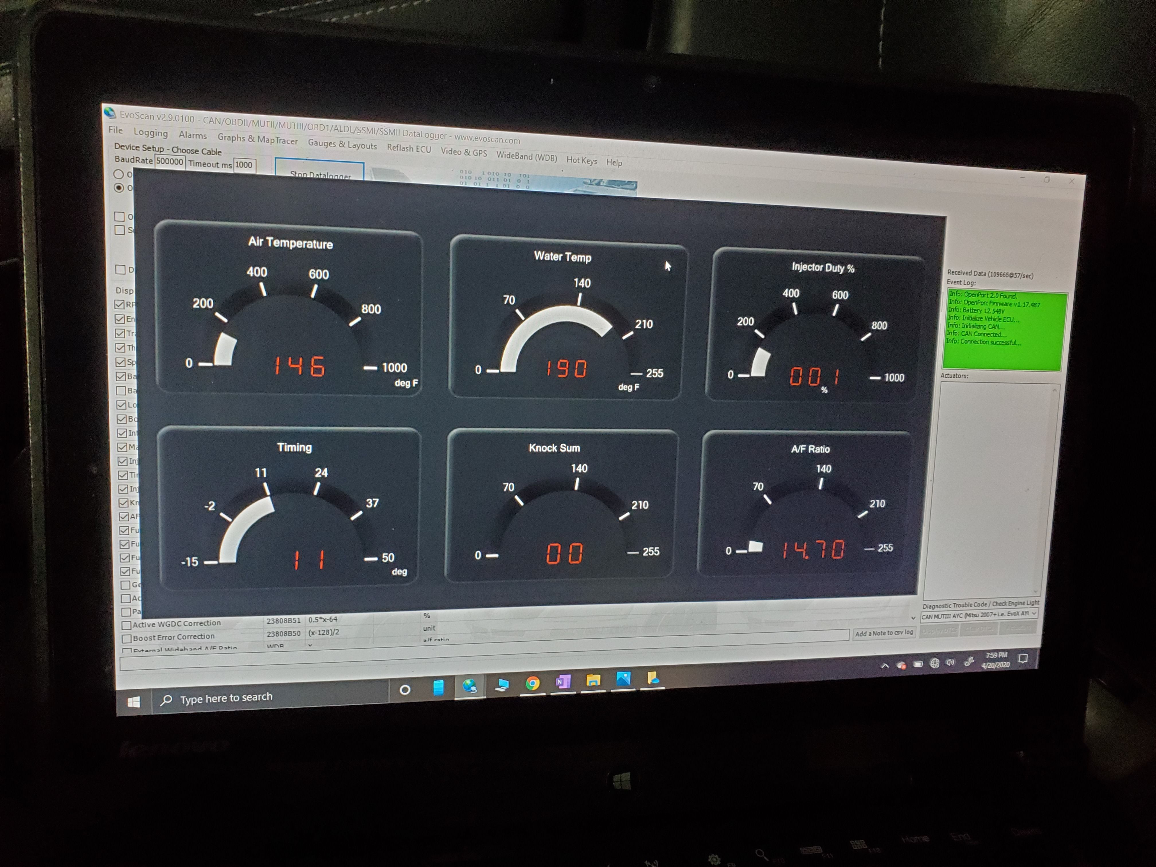

Well, today I got the Tactrix cable out and started playing around with MUT-3, mitsu's scan tool software. I wasnt able to attain the correct (paid) driver, so I started to see what else was out there. I stumbled across a program called ETACS decoder. It is a paid software that has a lot of the MUT-3 functionality, but in a sort-of "pay per use" way.
I purchased 5 "credits" for $7.xx via paypal. Once the credits showed up, my balance updated in the application. I used my first credit on a coding change to tell the EVO X ecu that the car came without a TPMS system.... I did this because I have two sets of wheels, and not 3 good sensors between them. I am working on figuring out which sensors are duarable and affordable enough to use as OE replacements. Once I purcharse them, I can go back and use another credit on turning the system back on.
Its amazing how powerful this ecu is. The fact that a simple line of code could be all that's necessary to disable factory systems you dont like is awesome! There are a boatload of options for things you can change, like automatic timers for the dome lights, and even changing stability control system settings to match a car from a different market (say EUDM). The ECU is so universal, that for every feature that is relevant on the evo, there is at least one more that isnt. It shows me that they are setting these systems up incredibly well these days.
It will be much harder to diagnose this car, with its 750+ page chassis electrical diagram, and CAN only access to the computers, but between ETACS decoder, EvoScan, ECUFlash, and PassThru CAN, I think I will be able to communicate with all the modules if nothing else.

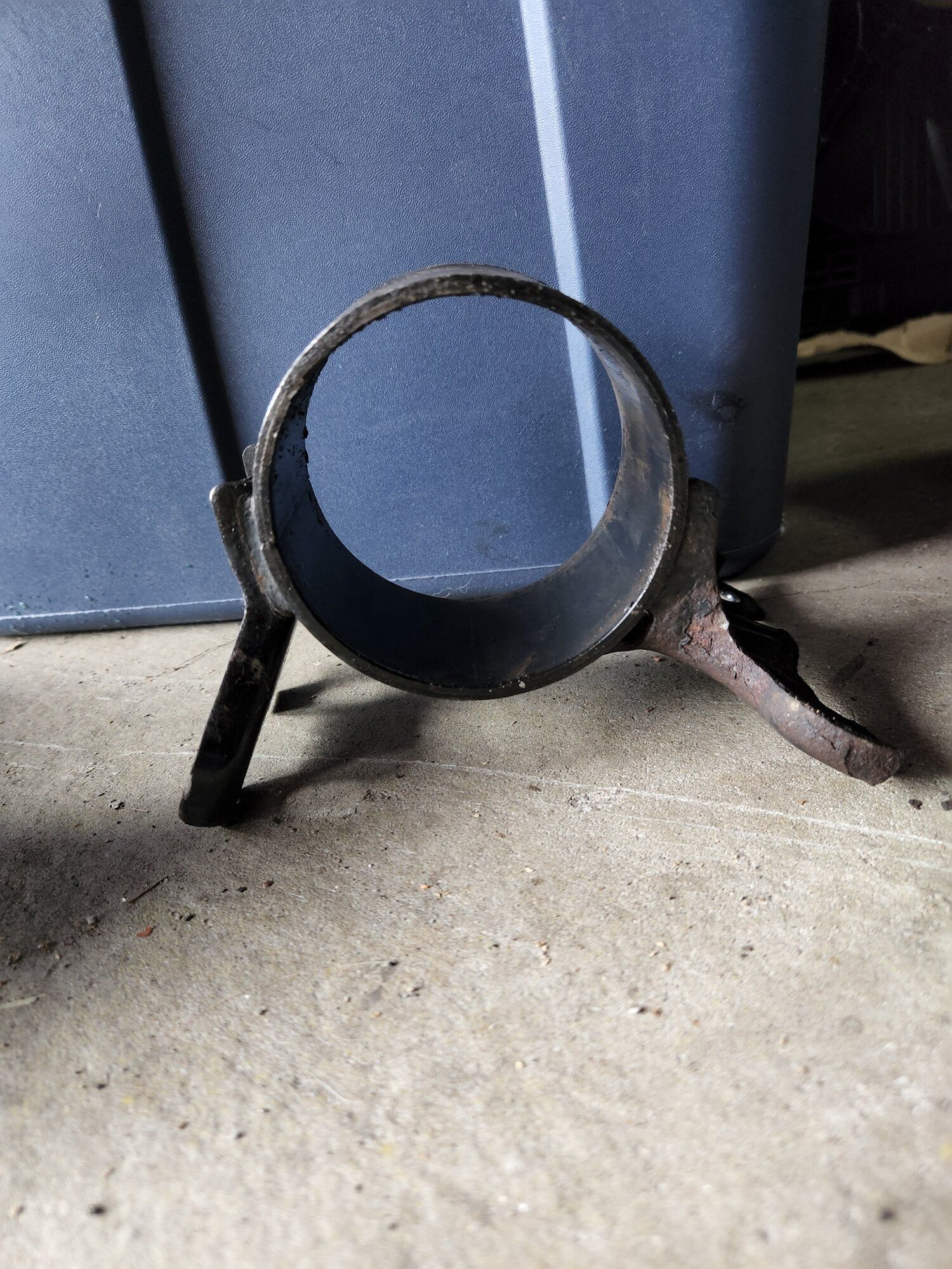

Well, this car had a pretty damn rusty exhaust. How rusty was it, you ask? So rusty that I took a very aggressive turn, and both hangers between the downpipe and muffler broke clean off, and allowed the weight of the exhaust to break the mid-pipe into two pieces! WOW
So needless to say I had a pretty large exhaust leak, and the midpipe dragged as I pulled it into my driveway. Bummer.

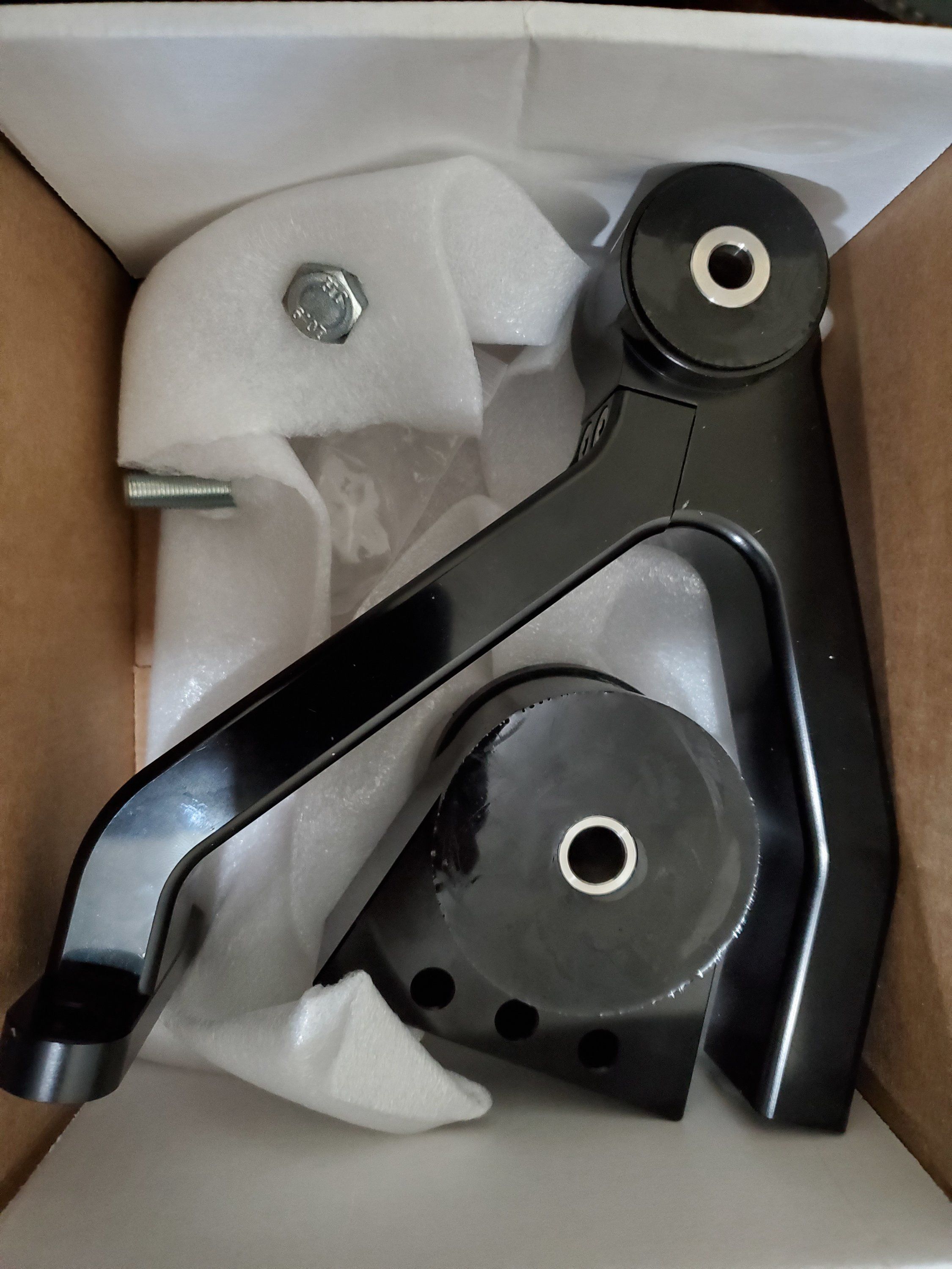

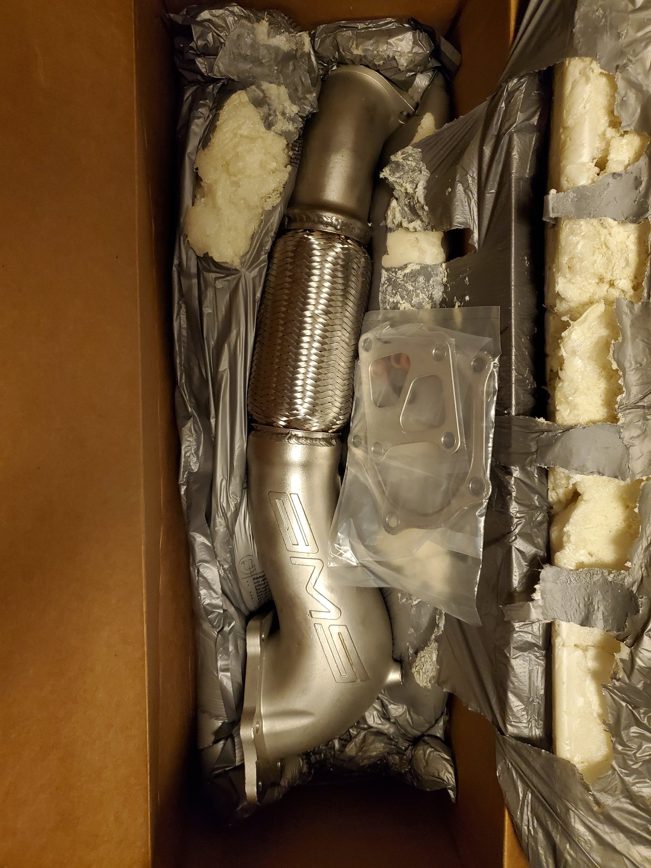

Decided the stock downpipe just wouldn't suit. So I ordered the AMS widemouth downpipe. I figured the engine moving relative to the chassis was probably contributing to the stresses that ended up breaking the stock midpipe, so I ordered Torque Solutions poly roll stop mounts and Prothane side, engine and trans, mounts.
I also started picking up a few things for refinishing the rear subframe. I started with Whiteline differential bushings, but I will dig deeper and be sure to have everything I need before I drop it. I hate having downtime waiting for parts. Finally, I ordered some stainless 3" downpipe gaskets from RTM. They look to be quite reusable, but I still question how well they will actually seal. I saw good reviews and they are fairly cheap, so I'll give them a shot.

Got the Torque Solutions front roll stop on, but the rear will take a bit of work. Apparently I have to drop the steering column, so I will have to align it when I am done. Luckily we have a portable John Bean alignment setup at work because we bought John Bean a while back!!
The poly mount did everything one would expect it to... It vibrates quite a bit, with just one mount. The shifts feel a bit harsher in S-Sport mode (just feeling more of the harshness that was already there?). The engine feels more secure when going over bumps and on hard turns. I absolutely love it, as it reminds me of the DSM a bit more now. Can't wait to toss on the downpipe and the other mount on this weekend!

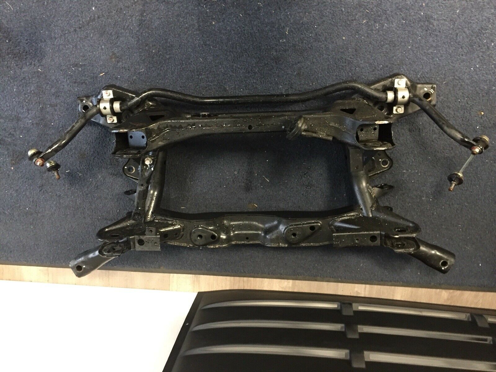

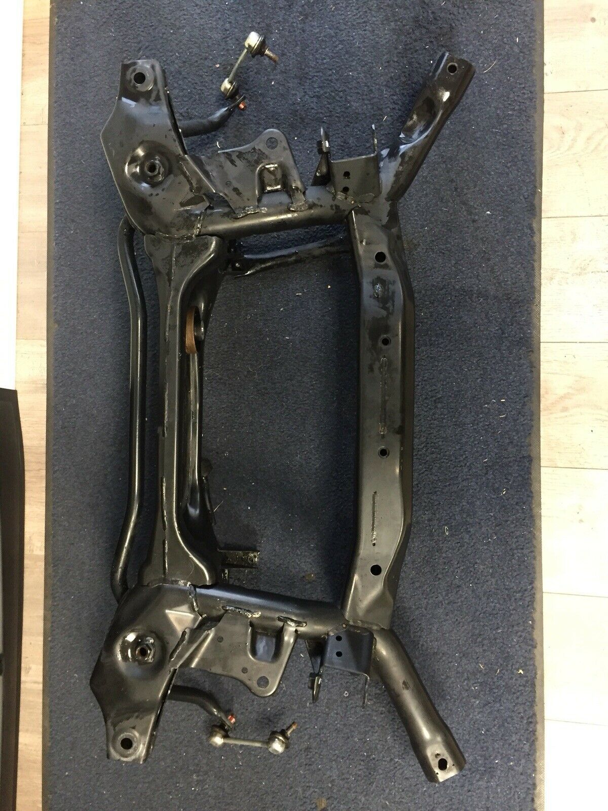

As I mentioned, I hate downtime, and afraid of the turnaround on blast and powder for the subframes, I decided to pick up a spare rear subframe from ebay. It has 22k miles on it out in Washington state. The photos show virtually no rust, and it is a much much better piece to start with than my rusty subframe. It was $160 shipped, so its probably cheaper than blasting and powder as well...

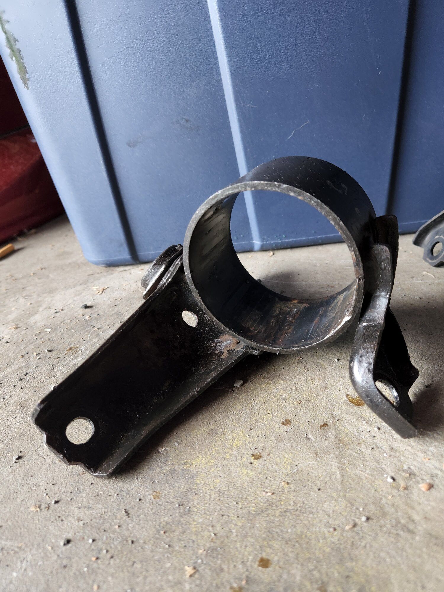

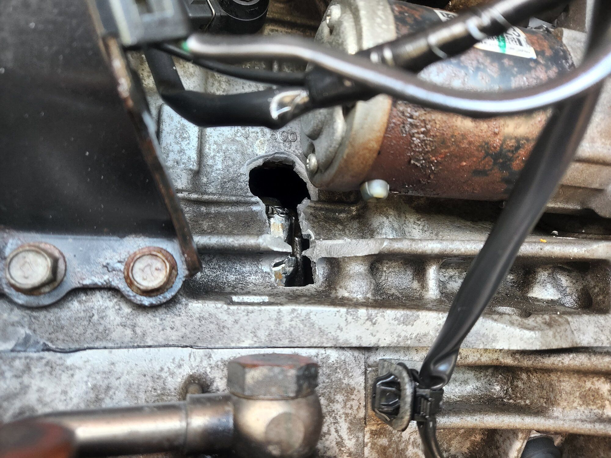

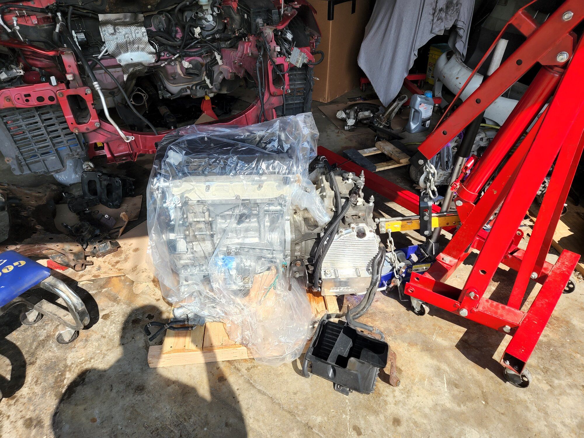

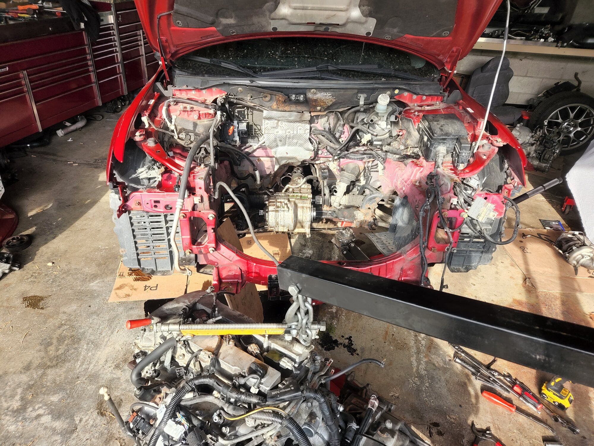

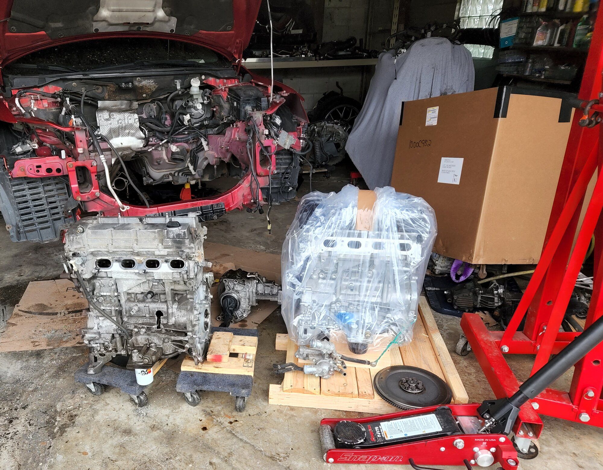

Out with the old, in with the new mitsu longblock

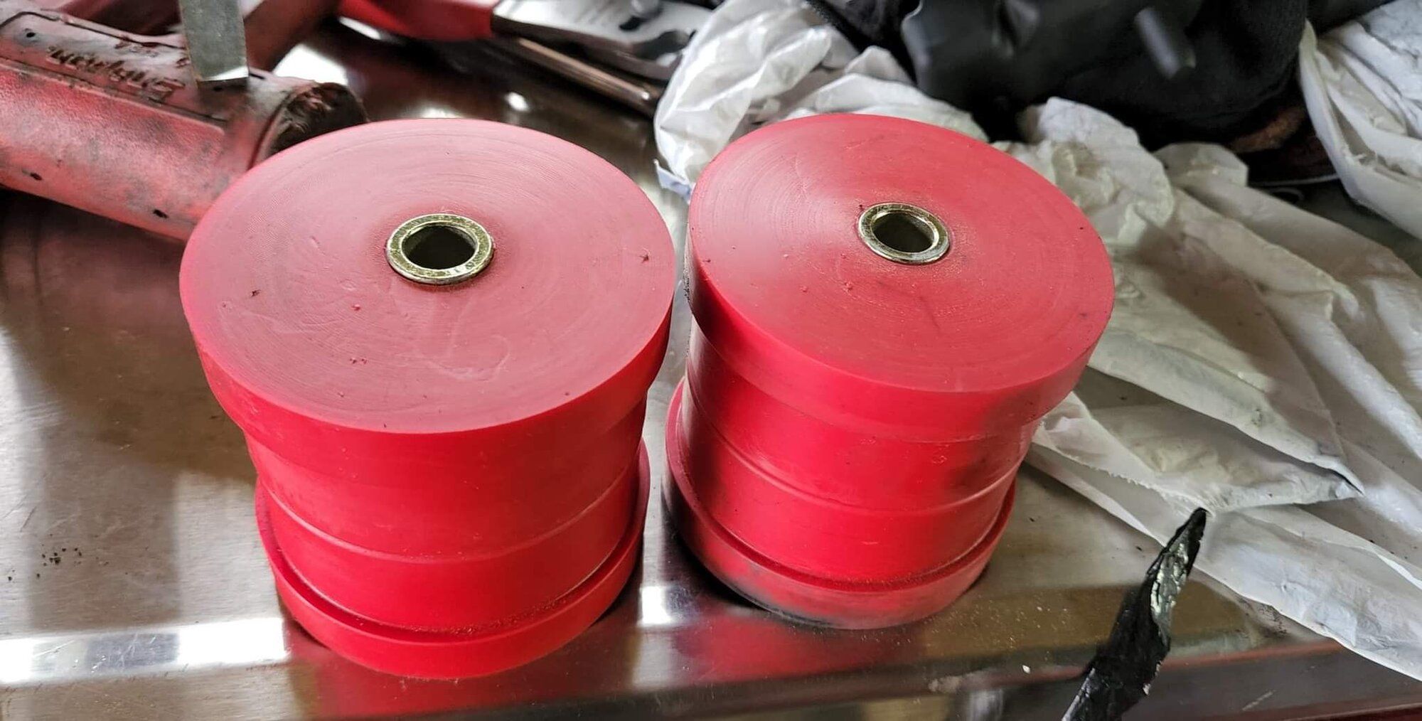

Motor mounts with stock bushings removed
I'll take all the NVH please

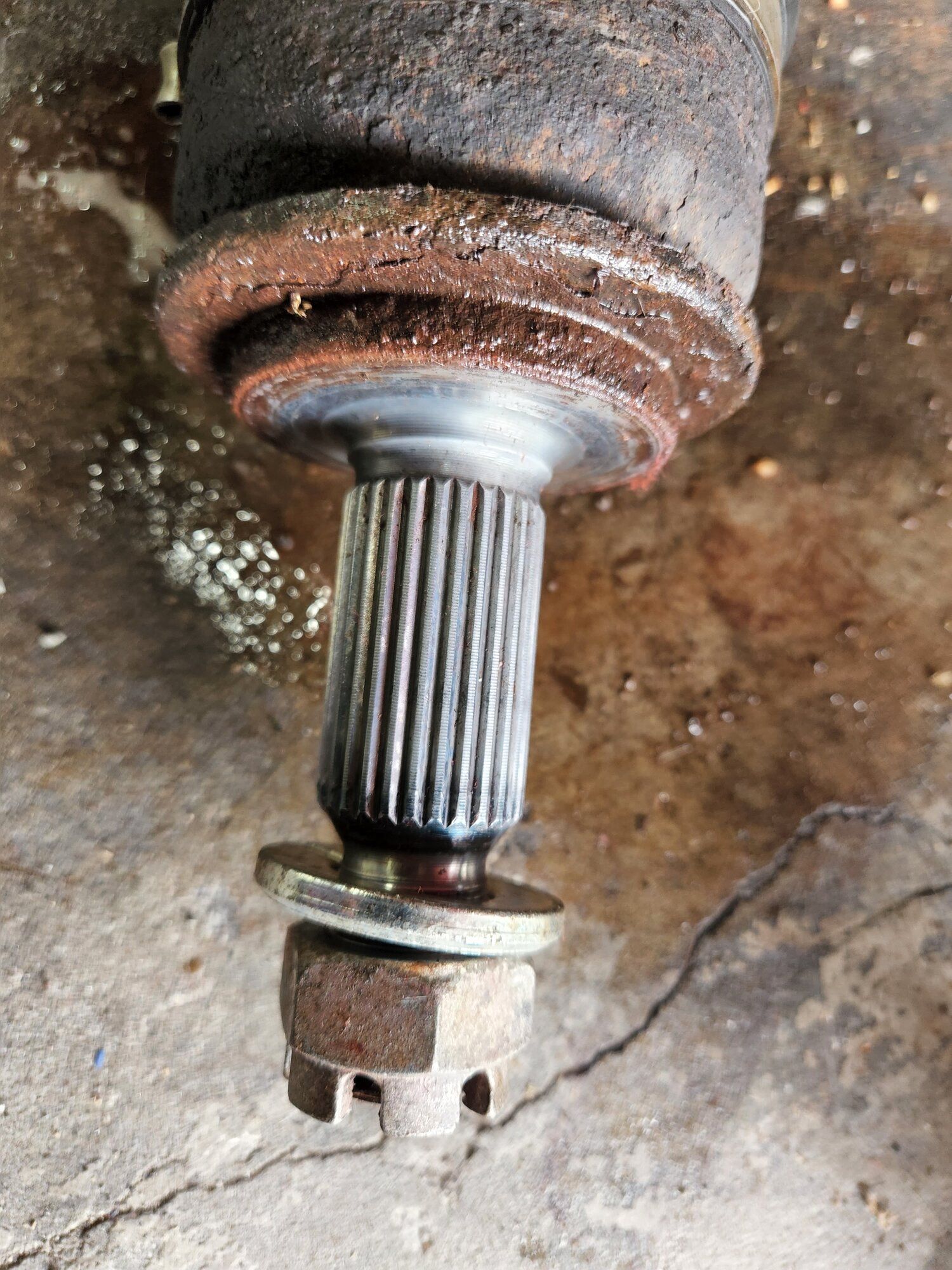

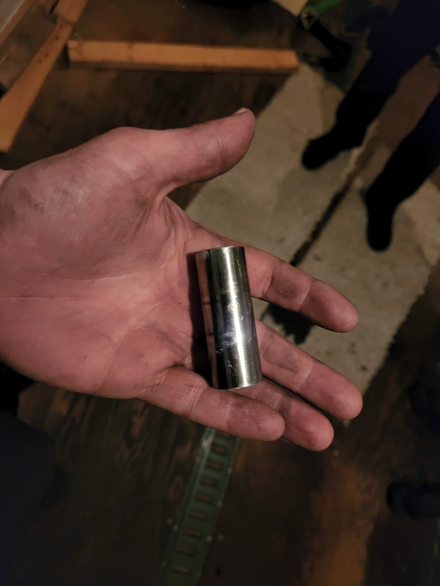

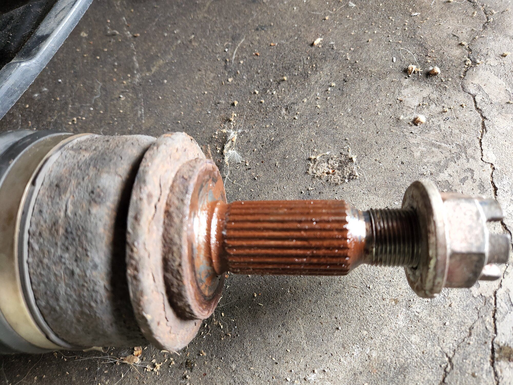

Splines before and after "evaporust" - wow
Transmission bolted to the new motor, lets go!
