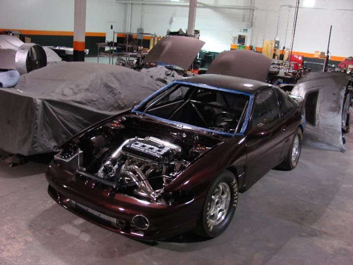

Yeah, you're going to have a hard time getting down anywhere near 2000#'s. Brent Rau ended up around 2150 on his AWD car I believe and he had WAY less material in that car than you have in the pics. Just saying, there's a lot to remove when you have a full cage.
I'm still removing a lot, hopefully I can remove another 100-200 lbs of material. 2,000 lbs is just a goal not a set number. All I do know is that I've taken out 3 truck loads of stuff and replaced a lot of heavy stuff with some lightweight parts. I'll have a final weight of the complete chassis minus the motor/trans/turbo pretty soon. The chromoly cage only added 90 lbs so about as much as my power driver's seat.

Quick update: Thanks to Eeeeky (Aeryk) I am now 2 months ahead of schedule. Just picked up a custom tubular forward facing manifold, tubular front end, 4 inch intercooler, wastegate, intercooler piping, and some AN fuel lines from him, thanks again Aeryk.
And what I chopped off a few hours ago:
I would like to do a tubular front end on my car as well, but I think it would be quite difficult for me as I do not have a pipe bender. Did you buy that front end tube pre-fabbed? Are you going to add a front roll stop to it?
I bought it from a local who made it. You don't need a pipe bender just some straight pipe and a few 45 degree pieces. I'm going to do a custom bar with roll stop next weekend.
Now u just need a nice turbo to hang off there ;)
S375 is next on my list of things to get, hopefully it's not too big for underneath the headlight.
