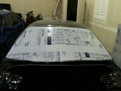

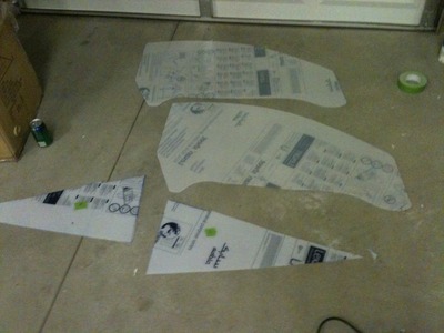

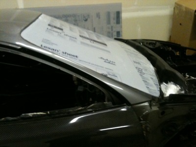

Finished cutting out the Lexan, so far I have heat formed the windshield, the other windows will be done this week:

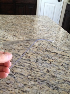

Just a sample of how much the Lexan can curve:

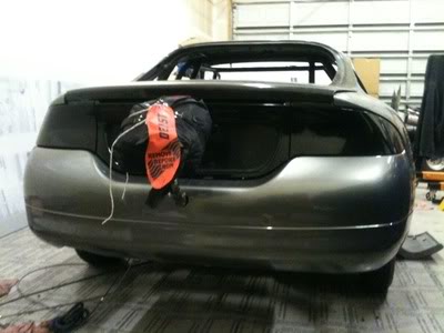

Got the tail lights and rear bumper installed:
Rear Quarter Windows are finished as well, they are solid gloss black:
no they are just flat sheets but I'm clamping them to the factory glass and heating the windows with a heat gun to shape the pieces.
Your'e going to need a few heat guns, by the time you heat up one area and go to the next it will have cooled down already.
He's going to need an oven... Good luck heating the poly glass with a heat gun, you going to melt yourself before you shape the poly glass...
Exactly, small pieces can be done with a heat gun but large curves like the drivers/passenger window require a large oven and vacuum/compressed air to push it down.
