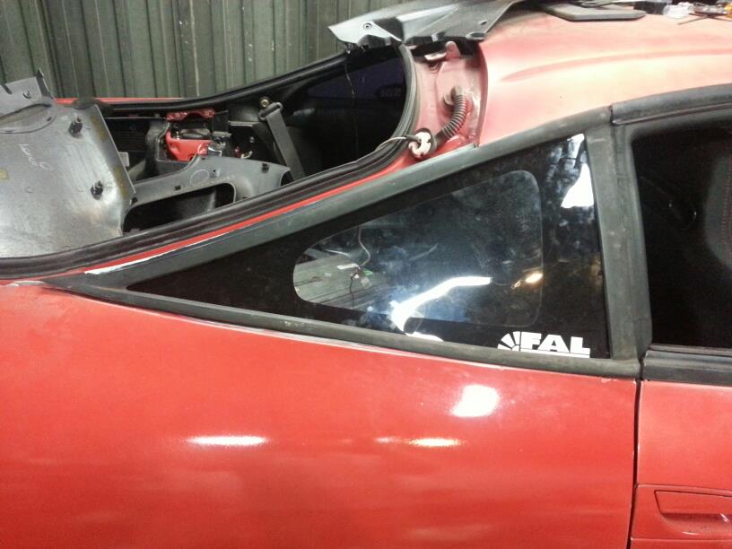

My FAL molded speedglass
These windows are molded to original factory size and shape, and install identical to original glass and feature 2" black borders just like the OEM glass...
Looks good!^ Is it regular Lexan or is it the coated Lexan with the Margard MR10 coating?
They are not Lexan, Lexan is a brand of polycarbonate plastic. FAL speedglass are more durable and resistent to scratches than Lexan...

Actually FAL doesnt use the word speedglass on their product, just molded windows.
Anyone have more info on this?
Check his other posts, they made an order for 10 people and it was a special order. If you want some you'll have to wait until they do another batch or buy from someone like me.
