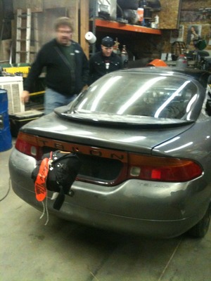

Bought a 1995 eagle talon tsi as a shell for $1,000 back in July 2012. The build will consist of the following:
-Aluminum rod 7 bolt 2.0l 4g63
-English Racing built automatic
-Precision converter
-GT4202R
-150 shot nitrous
-Aluminum Driveshaft
-CF Doors/hatch/fenders/hood
-Lexan Windows
-2200 CC injectors
-Weight removal bringing the car down to 2,000lbs
-Dual Bosch 044 fuel pumps, fuel cell
I soon got to work on it:

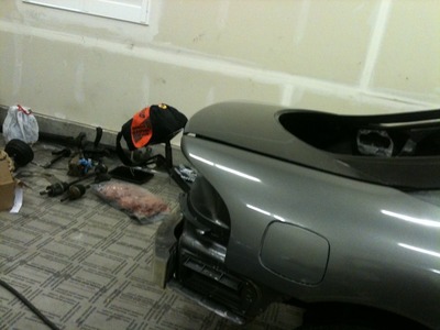

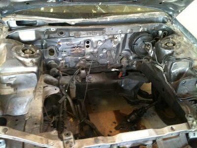

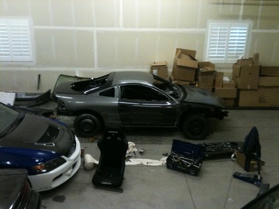

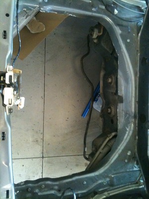

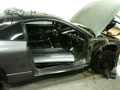

Stripped the engine bay:

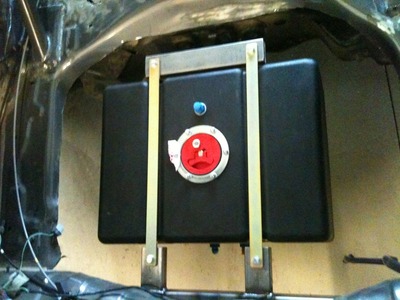

Made room for the fuel cell:

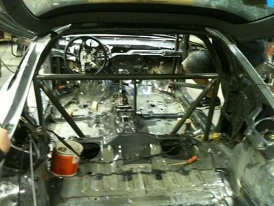

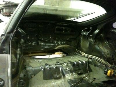

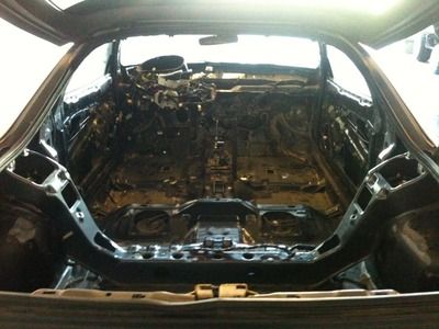

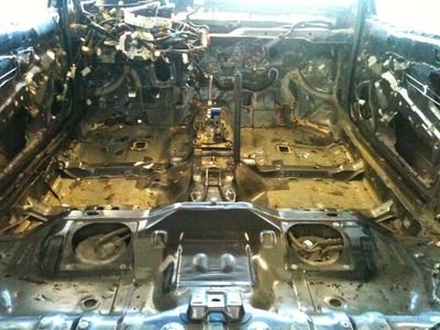

Cut out most the interior metal that I won't be needing:

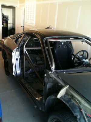

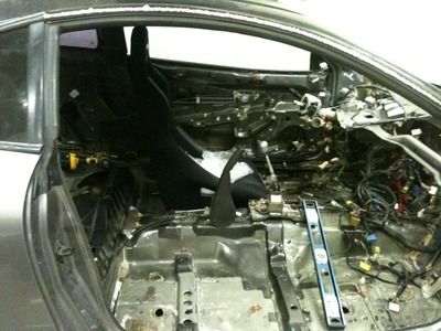

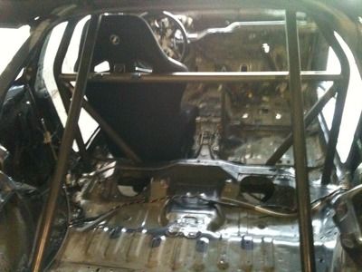

Got the seat mounted:

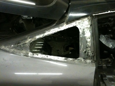

Took out the windshield:
Removed the rest of the windows:

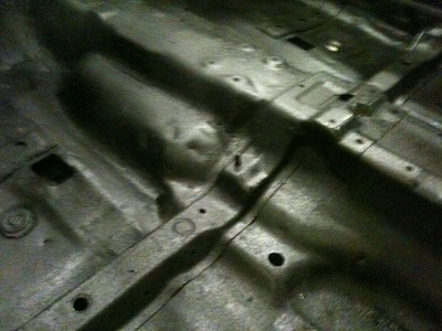

Removed all the sound deadening and most the seam glue:

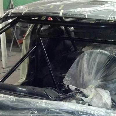

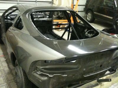

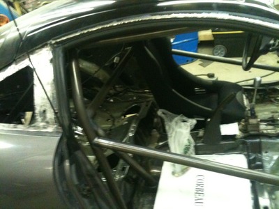

10 Point NHRA Chromoly Cage Install with parachute mount and fuel cell

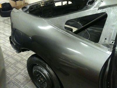

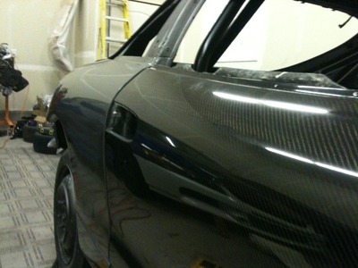

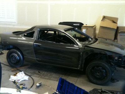

Got it painted Nissan R35 GTR Gun Metallic (paint code KAD):
Installed my carbon doors and hatch (preliminary fitting, all hardware is not attached yet)
Roll cage got painted as well:

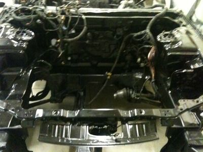

Engine Bay got sprayed gloss black:

I will be installing a tubular rear subframe, chromoly front end and some other things to help get the weight down. I'm not participating in any class that limits my weight so I'm taking every piece of metal out that doesn't serve a major purpose. So far I've filled up the bed of my buddies F150 4 times with stuff I've taken out.

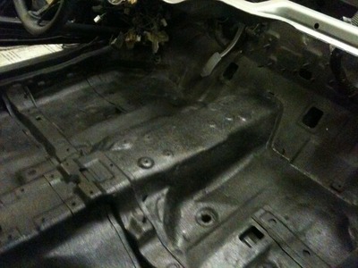

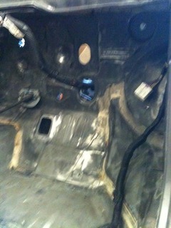

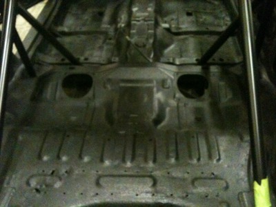

The floor is now complete besides some carbon covers that will go where the gas tank was and spare tire. This is 3M bedliner with 2 coats of clear. This stuff is great because it hides all the imperfections in the floor and the seam glue that was left over:

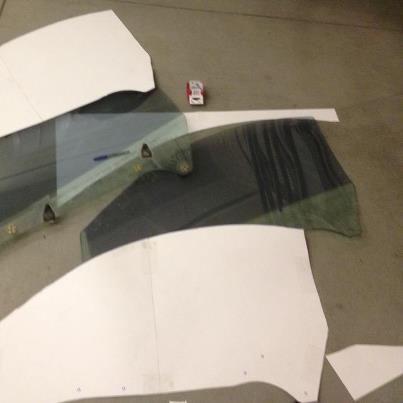

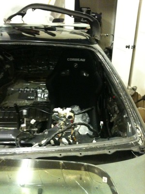

Got all the templates made for the lexan windows:
I will be saving these templates to make a whole kit for the 2g's in the near future.
