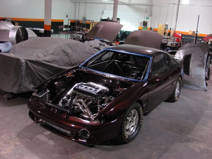

Haven't been able to work on it much because of work but will be finishing the manifold, tubular front end, wastegate dumps, tubular cross member, new roll stops and a few other things this weekend and next. I'm hoping to have it up and running before the end of march.
Small Update: Picked up a GT4202R locally and got it installed on a spare longblock to see how the fitment is. Also took my car over to my friends house so he can modify a few things on the manifold, install a swing out on the roll cage, weld up the holes in the firewall, modify the tubular front end, make a tubular cross member, custom roll stops, and intercooler piping.

Quick update: The tubular front end has been modified so that my 4 inch downpipe and twin wastegate dumptubes can exit straight out the side of the bumper. Also had the front cross member made which bolts to the stock location. The roll stop is being replaced by a solid plate that mounts to the transmission. Supports are also going to be welded to support the radiator, intercooler and front bumper.
This front end can be replicated for anybody interested.

Thanks! I will have some more updates this weekend with the finished front end, my new radiator setup and my new manifold.
