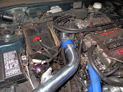

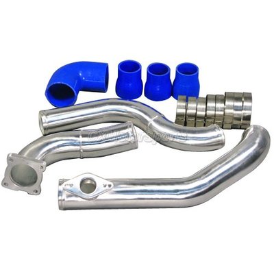

CX Racing has a kit. It isn't terrible but fitment is less than ideal. At least for me. But there really aren't many options for sidemount piping these days.

I have that kit and it was kind of tricky to mount up but it does fit and does work. I put it on my 92 before I went crazy on her. I will put it on my 90 GSX soon, as I have an IAT bung in the TB elbow and want to convert my last car over to SD like my other 2 are.

No that is the 1g version, CX racings 2g version is here:
It is made for a stock T28 turbo. If you are running a TD05 (14b), they have a different listing for it.

No. The 1G style BOV has a flange that you can see on that kit. 2G's were plastic and had about a 1" beaded lip instead of a flange.
Honestly, not what you want to use at much over stock boost.
I was actually wondering about the “CX Racing” 1g pipe kit just recently. I’m tossing the idea around of ditching my fmic in my old age and switching to an Alamo/Dejon style side mount or Supra side mount (if I can even find any of those) and considered that kit utilizing the stock j pipe if I do come across what I’m looking for. Glad to see it does indeed work out as I’ve seen the cheap Chinese 2g kit used but this is the first hands on I’ve seen of their 1g kit aside from their mock up pictures from 12 years ago. Seems to be a copy of the Dejon and Buschur stuff and what not offered in the late 90s and into the 2000s but being it’s country of origin I didn’t want to make assumptions. The only downfall is I see it’s like $240 shipped now at the lowest I’ve seen it, when I originally looked at it 8-9 years ago when I was considering using the stock intercooler it was literally $120-$130 shipped, so that kinda sucks, but at the same time I’d have more than that into aluminum pipe and the correct couplers to make it (plus welding it) so I guess it isn’t really a loss. Either way good to know it at least fits.
