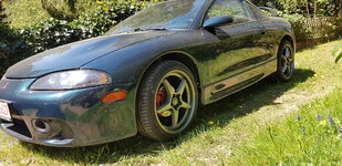

Ok so i have a 97 eclipse gst and occasionally coming to a stop it sounds like driver side is popping or clunking almost like a engine mount all mounts have been changed and checked they all are good.next i do need my suspension done for sure but this is my first dsm and so im learning as i go,my question is,besides the ball joints or cv axles what could be causing this strange clunking noise any and all information or suggestions to what it could be would be helpful? Also just included a picture of my car.
