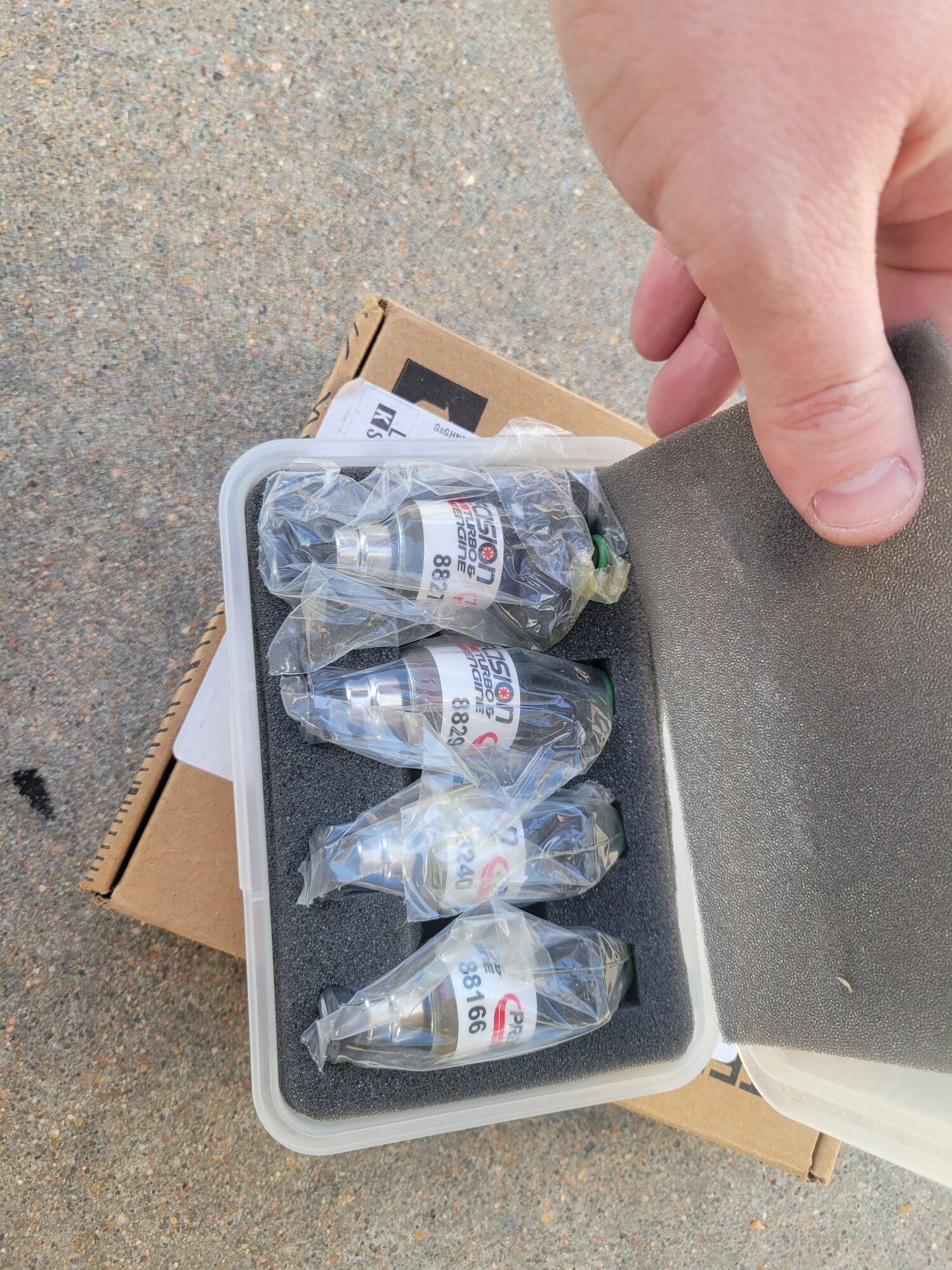

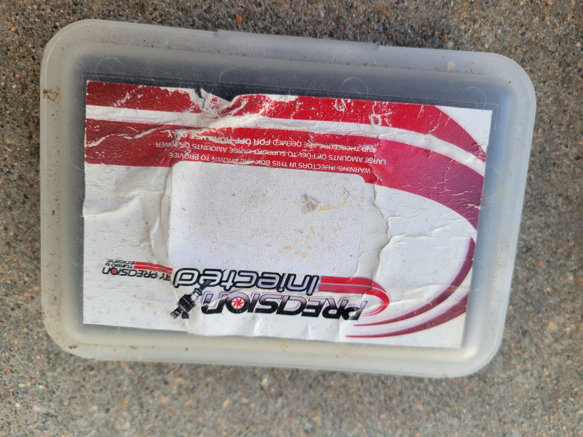

Here are pics of them and it's pulling up dephini low resistance but...
I will take these to work with me and have then tested with a multimeter to figure out if they are high or low to make sure.
The removal is pretty easy, but when you put the new injectors back in it's not real easy to get everything lined up - all the injectors going straight into all 4 holes nicely so that the seals don't get banged up. You have to be careful with that and it's hard to even see it all at once. And you have to have the correct seals for the injectors.
Your bigger injectors that you have, I don't know if they take the same type of electrical plug. Sometimes they don't. That is something you should get all figured out before you even start to take anything apart. On my car, when I put in 850cc FIC injectors, they used the stock connectors so I didn't have to change that. And I ordered them with seals so I had them. And I smeared the rubber seals with Molykote 111 Compound which is that silicone compound (kind of like a grease) that I use on just about any rubber thing that I put together, and on my thermostat housing gasket and bolts, and in a few other places. I think most people just smear the rubber seals with motor oil.
If it turns out that the injectors need a different type of electrical plug, I'm pretty sure you will be able to buy the right plugs that are already made up with pigtails (wires several inches long) which makes it easier. That's what they did on my car at ER when they put in 1650cc FIC injectors, they cut the old connectors off the harness and crimped on new connectors that had pigtails.

The 1,000 injectors I have were never once installed so..
With that being said will they be good to plug & play or do I need to send them out to get tested & cleaned with it being 5+ years of them sitting?

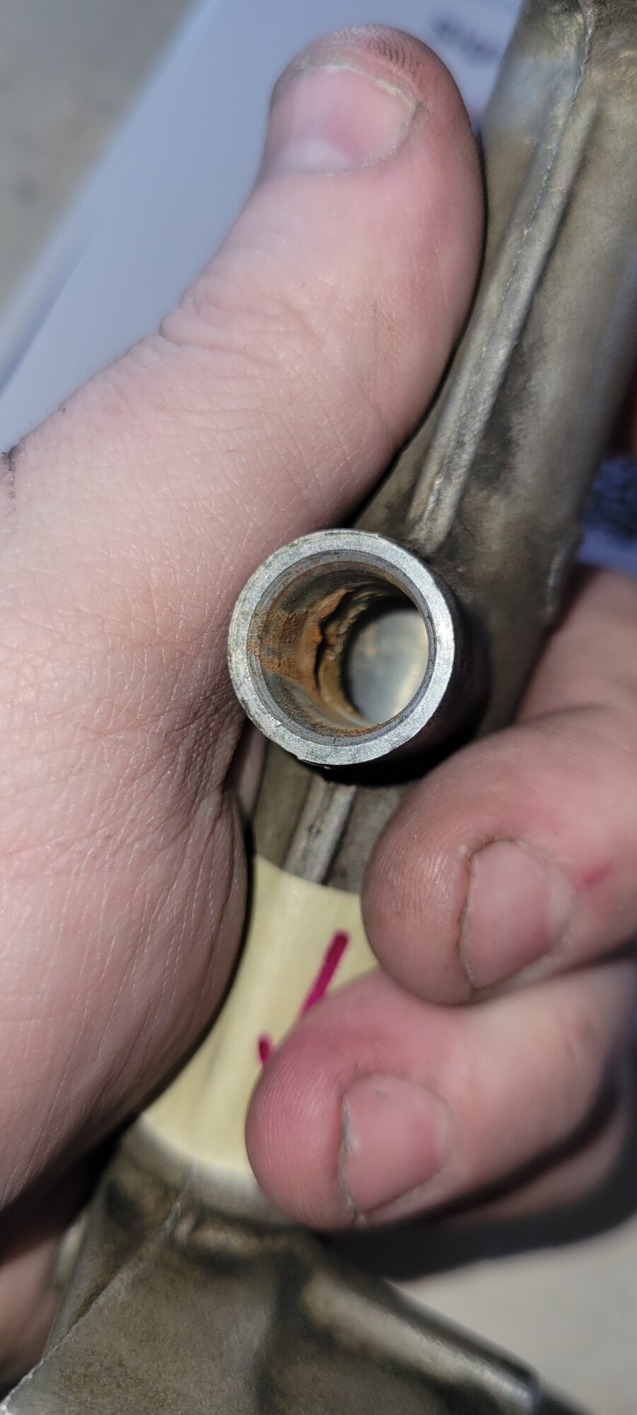

Yes, I have switched out the fuel filter twice. This is what the fuel rail looked like when I pulled injector 2 out. So when I send the injectors in will clean the fuel rail out.

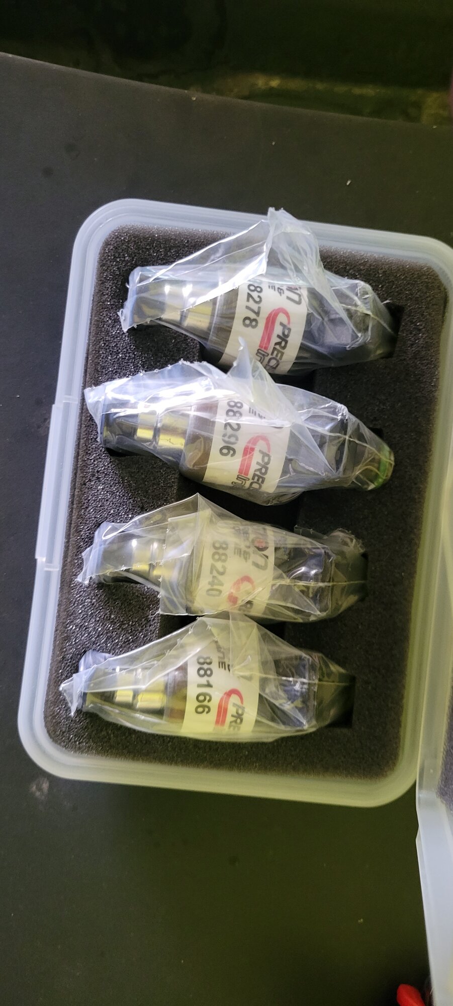

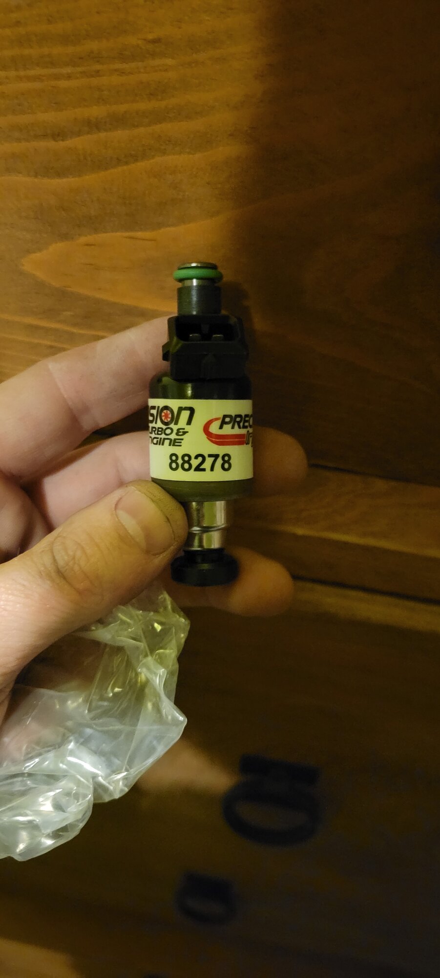

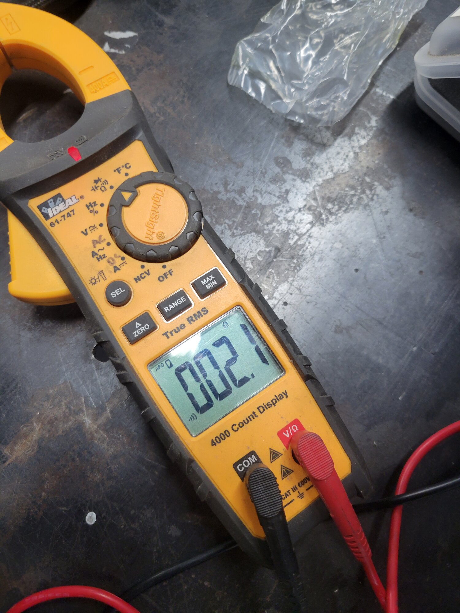

The 1,000 cc I have are low impedance which below is a pic of them on a multimeter.

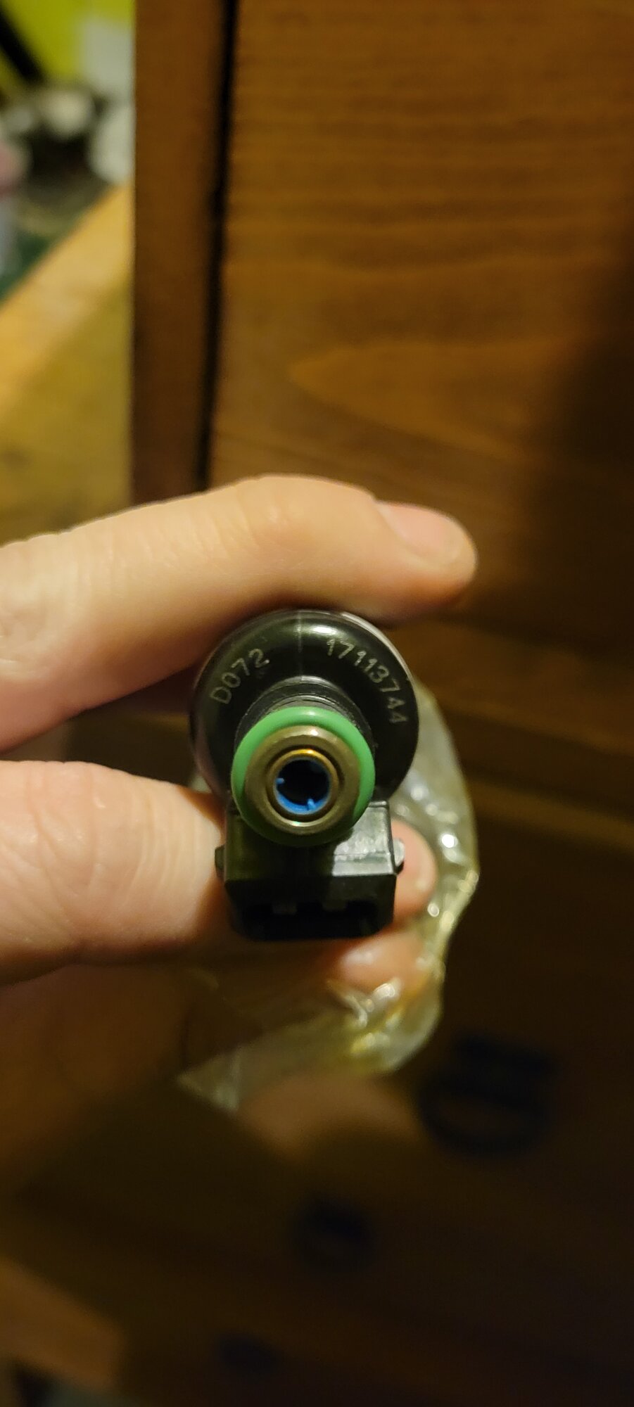

From my research the black tops are better then the blue tops right. Which set should I send in? Which color top would be best ?
The blue tops have 1 spray pattern where the black have 2 on the bottom of injector
Yeah 2.1 ohms is about right for low impedance.
Oh I didn't even know about the black top injectors. So I don't know. I would probably go with the set that seems to be in the best condition, worth saving. The 450's I sent you might not even need cleaning. Usually the guys that are getting their injectors cleaned about every other year are running E85. Or they are trying to use injectors that were sitting with gas in the rail in an unused car for 10 years or something like that. So I really don't know, I mean if money is short. I don't know how expensive a cleaning you have in mind. Darn shipping is getting expensive, and USPS isn't what it used to be. I'll never send a package by USPS again. The 1000's you have are apparently ready to use as is. I still have the FIC 850cc low impedance injectors that English Racing took out of my car in 2016. Those were only in my car for a couple thousand miles and never had E85 or anything beyond 92 octane E10. Those would be worth cleaning (and new seals) to re-use and there again they probably don't even need cleaning. But with 850cc the potential to make a lot of power is there so you have to be more fastidious about all this kind of stuff. With 450cc and stock fuel pump and stock fuel pressure, you'll be near stock power no matter what else you do. So the potential for damage is less, especially since your knock sensor works and you are logging it.

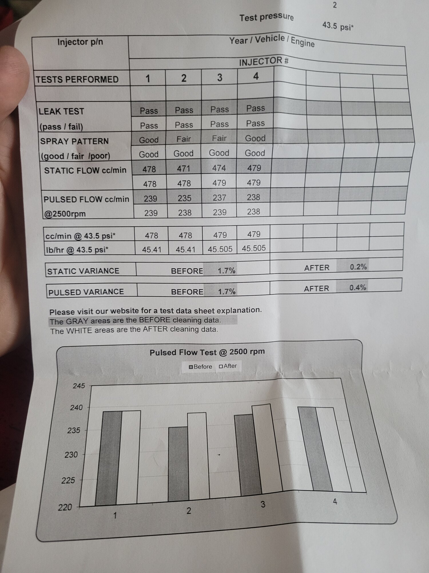

Glad you have that local place where you could get injectors cleaned and flow measured. Looks like it's probably a good place.
Taking the fuel injectors to get cleaned and flow tested sat and will be picking then up Monday or Tuesday.

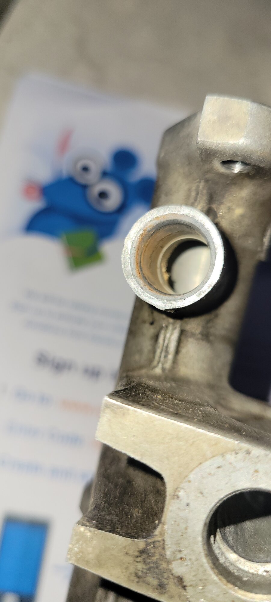

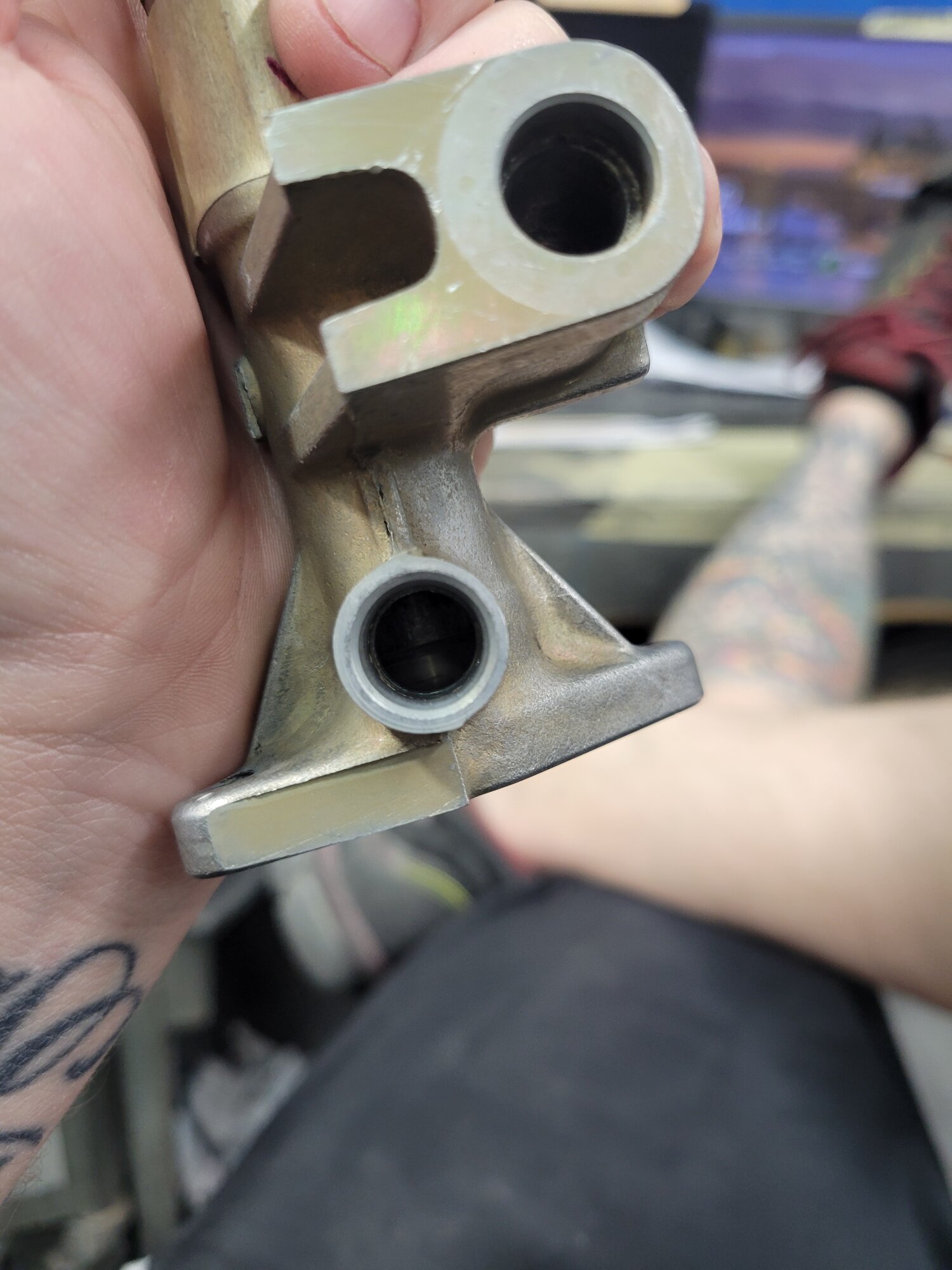

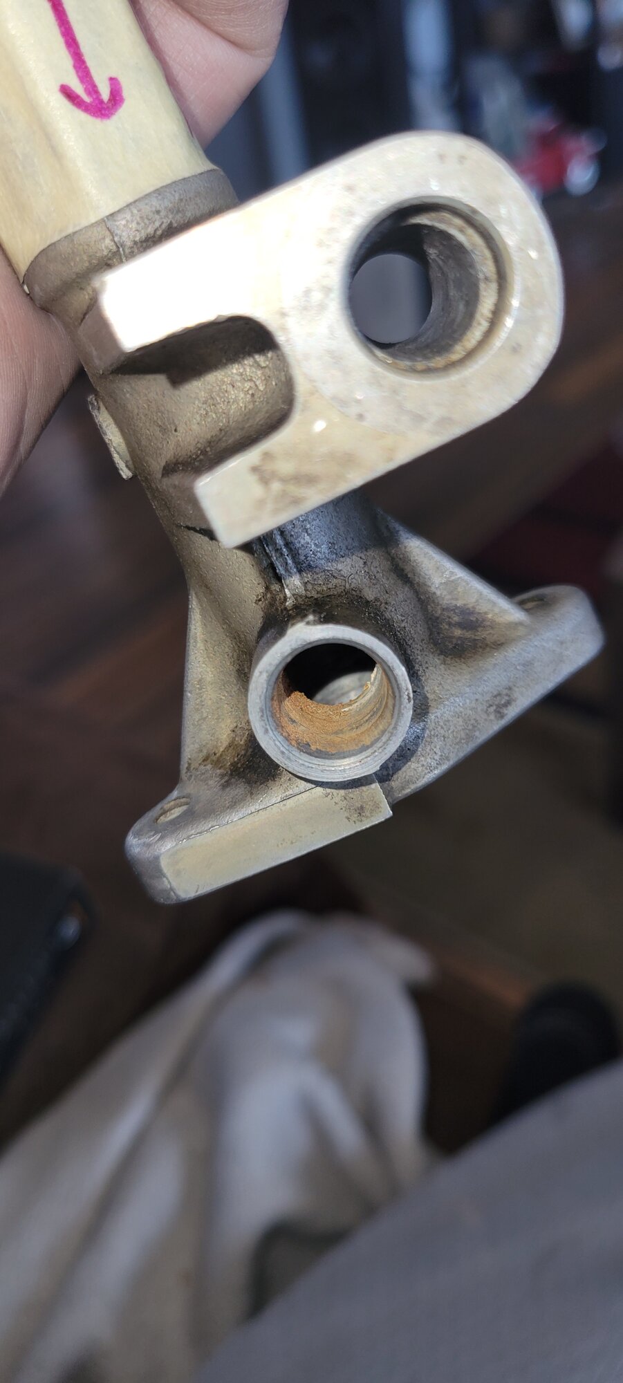

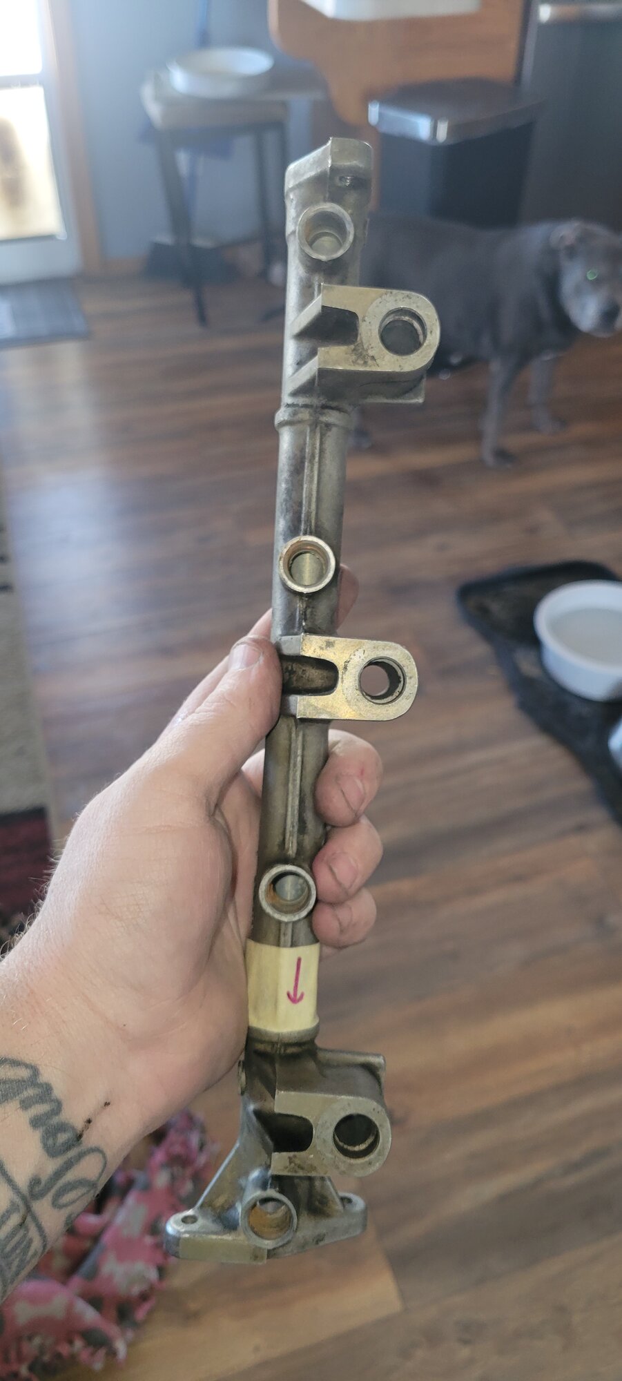

I am taking the fuel rail into work tomorow to clean in our tanks.

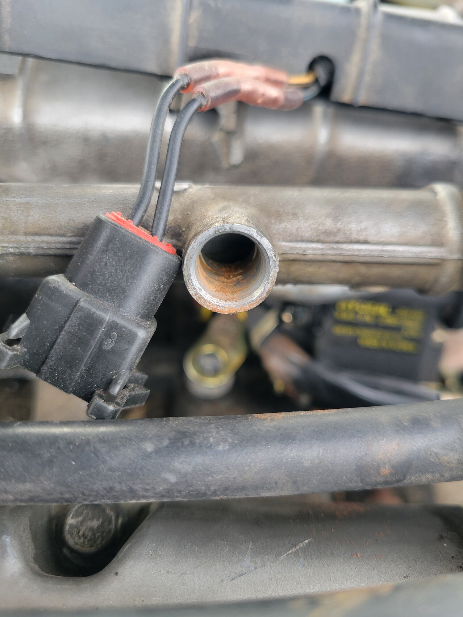

Here is pics of the rail. The worst was on the driver side and passenger wasn't as bad.
Oh wow. Well, glad you got that thing out of there.

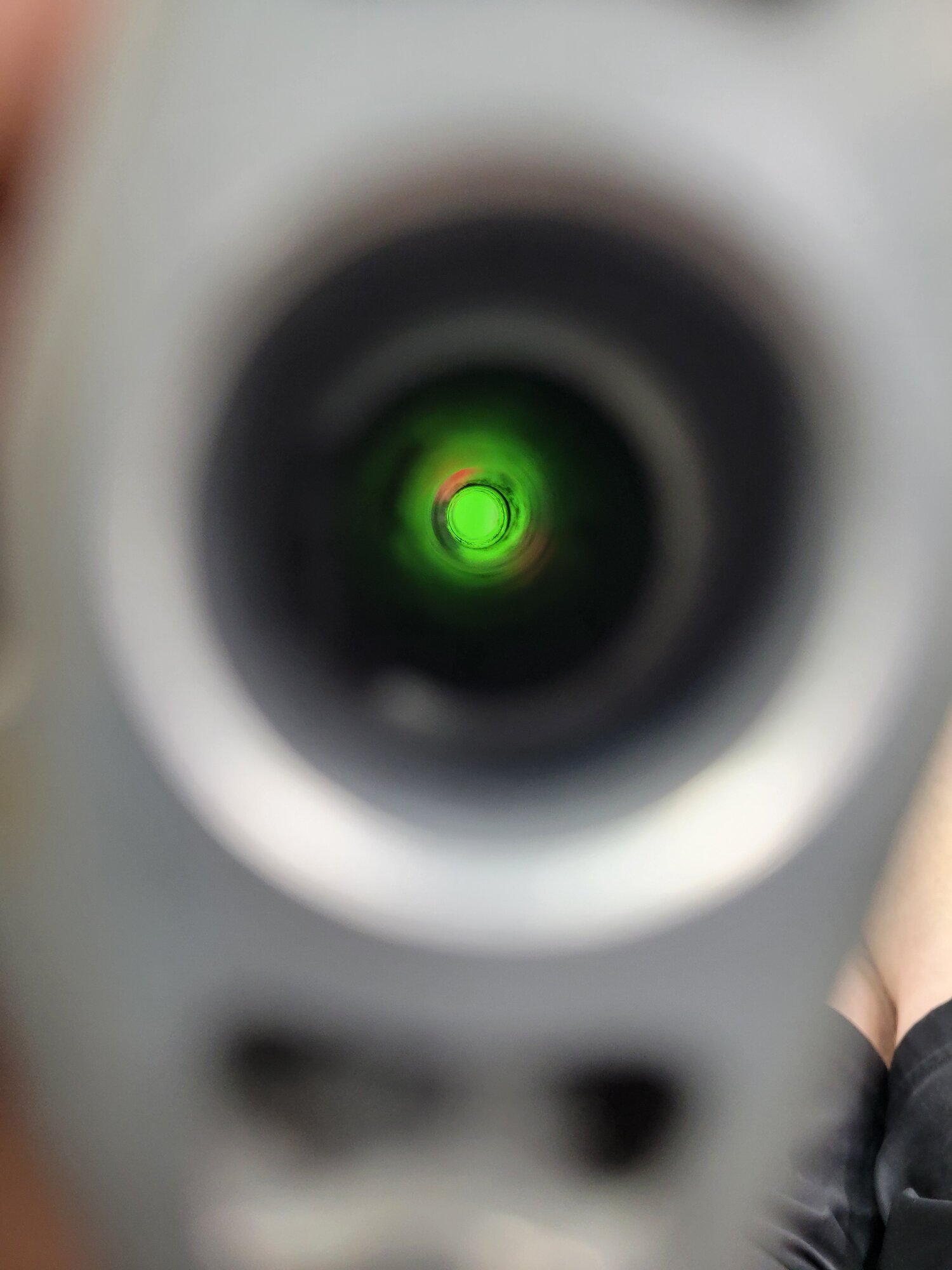

I am using the blue tops because the black ones that were originally in talon when looking down the injector you could see rust all in there so the blue tops you sent is by far the better choice LOL.

I used our chemical tank to help break down and clear everything out, then once I soaked it for about 30 seconds I got a wire wheel brush and scrubed the inside and put it back in the tank for another 30 seconds then pulled it out and rinsed it out thoroughly to make sure I got all the solution out of rail.
I am excited to get them and the rail back in then drive it. On my first drive i will do a log and was there anything i should do or adjust before the log? Should i put the injector size to 475cc instead of 450 or just keep it as it? Should i keep the timing and min and max tables that we changed or switch those back to stock if their is no more knock being detected?

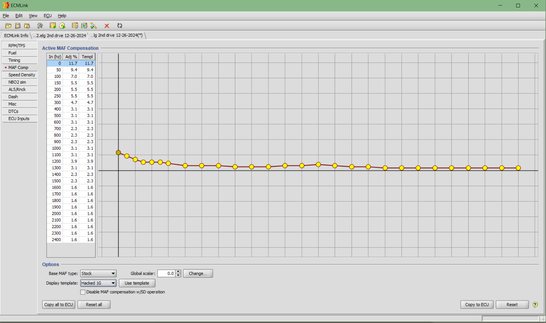

MAFComp I think should be changed, because it's goofy with the -10.2 in the Global Scalar blank. That whole page should go back to a sensible starting point. I think you should change it back to 0.0 Global Scalar, Hacked 1g MAF, Use Template, and unchecked box for disable maf comp w SD.
That's just the most basic hacked 1g MAF setup. We might not need to make it richer than that now that the injectors and rail are cleaned up, or we might need to, but we can tell in a hurry by looking at the Fuel Trims in a log that has some driving in it.
So the MAFComp page, I would change it back to this:
MAF Comp to start from - Hacked 1g, Use template, 0.0 global scalar, uncheck disable maf comp ...PNG
