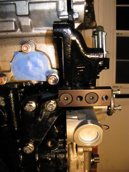

Installed power steering bracket and Jay Racing spacer. I'm not entirely happy that the 3rd mounting bolt for the other p/s bracket can't be utilized with the spacer installed, so I'm still trying to figure out a solution for that.

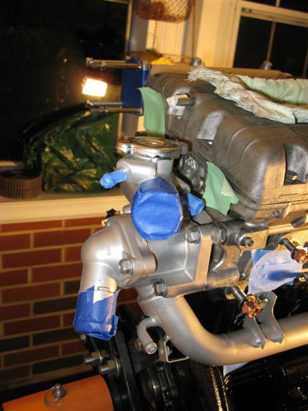

Already had the thermostat housing all assembled. Permatex thread sealant on the sensors. Gray RTV on the 2 flanges that need it. Make sure the jiggle valve on the thermostat points straight up. Thermostat, radiator cap, and all coolant lines are new.

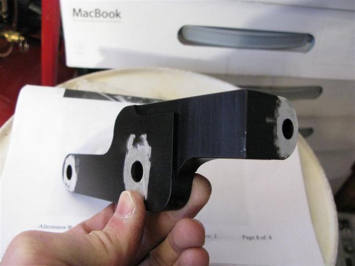

Per the directions on the Jay Racing alternator relocation kit I ground down the anodizing on the main piece that bolts to the block so the alternator gets a good ground. I also sanded the paint off the block at those points. A dab of dielectric grease was used to insure a good ground.
Pretty simple to install, just follow the directions. I wanted a new bolt for the alternator mount, but the hardware store didn't have any really long metric ones, so I had to use a standard bolt and nut. No big deal.
Note that the Jay Racing bracket acts as a spacer for the halfshaft now. I had to get a 95-96 halfshaft bracket for it to work. For a 97-99 halfshaft to work on there, there would have to be another hole tapped in the bracket between the 2 bolts.

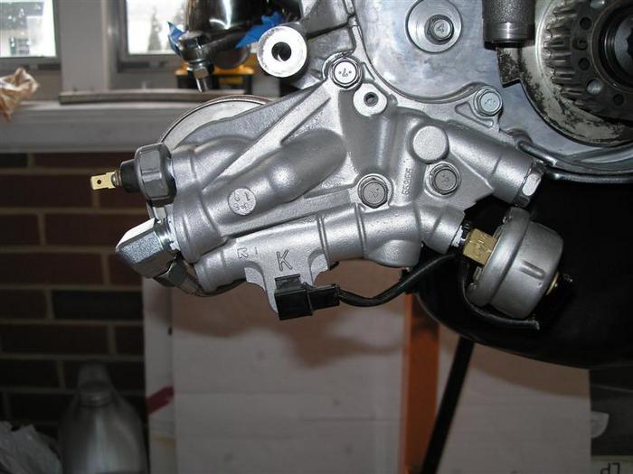

I would show the "knock sensor installation" picture, but mine is oozing out the back :notgood: Gotta get a new one...

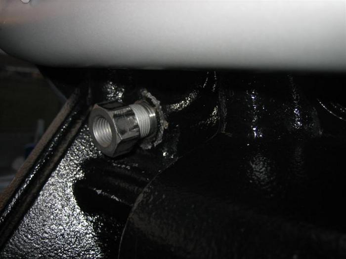

Then I hit a major halt. I went to install this water line to the block and I noticed it didn't sit far in enough. Somehow I must have backed the fitting out of the block when I removed the banjo bolt. I compared to my friends block to verify mine was too far out. No biggy, just tighten the fitting, right? No go, that thing just didn't want to budge. So I removed the fitting and cleaned the threads but it still wouldn't go in, even with my impact wrench. I finally determined the threads were damaged. No problem, I'll just tap the hole, right? It took me awhile to figure out the threads are 3/8" bspt and a whole day to figure out that 3 machine shops and 3 mechanics I know don't have that tap or know where to find it. Finally, I took another 3/8 bspt fitting I had from the oil filter housing, held it vertical, and used my angle grinder to cut 2 grooves down the threads, kind of like a tap would have. I ran that through the hole a few times and then I could get the fitting in far enough. I used some thread sealant on that too. Installed the water line with new banjo bolt and crush washers.

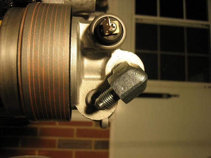

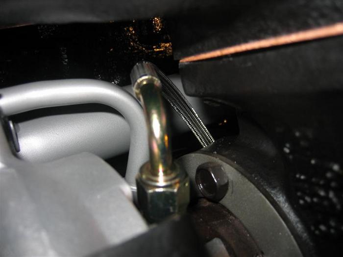

I bolted my turbo on temporarily to mock-up the oil feed line. I determined I can run the line next to the block for a cleaner look and it reaches the filter housing ok. I installed the fitting in the filter housing for it with thread sealant, making sure to clock it properly for the line. NONE of the other connections on the oil feed line use thread sealant.
I tightened the feed line on the turbo with it off the car, then installed the turbo. Copper spray gasket and reused oem sealing ring. Nickel anti-seize on the turbo bolts.
I ended up double zip-tying the feed line to the hard water line to the oil cooler in 2 places. This keeps the line from rubbing on anything or touching exhaust components.

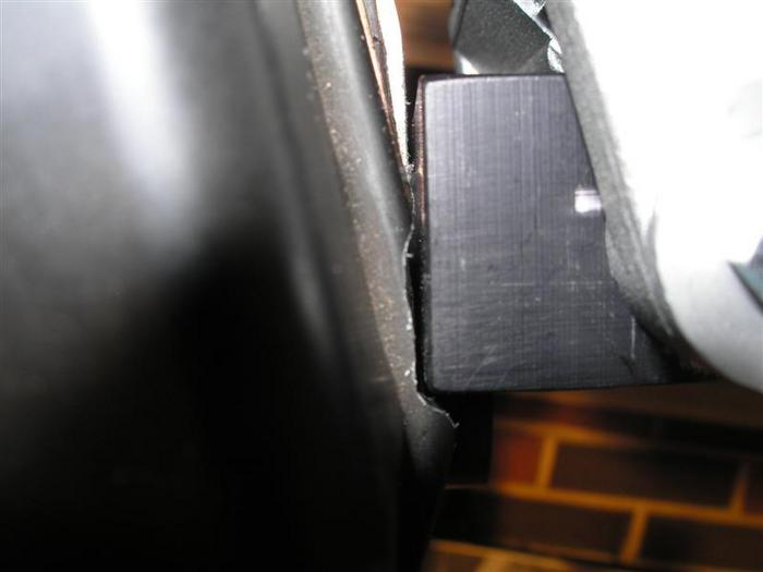

I decided to put the timing belt covers on quickly to check for any problems. The Jay Racing bracket was interfering slightly with the lower timing belt cover so I quickly trimmed that with a knife.

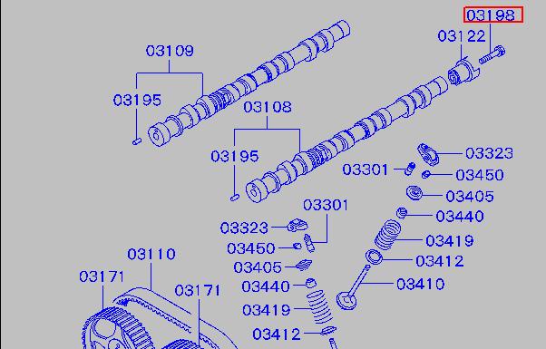

I'm looking for this one. Washer assembled, 8 x 4_
I found one thats 8x40, lockwasher, grade 7 in my "unknown" bag, but there's another in there just like it. Anybody have more info on this bolt?
