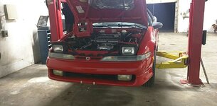

So figured I'd give a quick update I've taken the advice everyone offered me and dumped most of the egay stuff and am just enjoying the car stock until I save up to do it right. Well that was until about a week ago when my head started puking oil. So I figured I'd take this as a great opportunity to get acquainted with the 4g63 since I've never worked in this engine platform before. Pics to follow
Trans Out
How I organize me things
Exhaust and trans on the floor
Act 2600 going in way overkill but im prepping for the future
Flywheel
Act 2600 bolted on
Old gunky head off looks like my valve seals were pretty bad
Head on my toolbox
Pretty clean for 146K
Everything organized for the head
All new valves!
Cleaned up well
Head back from the machine shop. Super clean!
Cleaning up the cams and caps
All clean!
Dirty dirty valves
Exhaust valves were pitted to hell
Nice clean cam gears
CAS all mouted up with T-Stat
