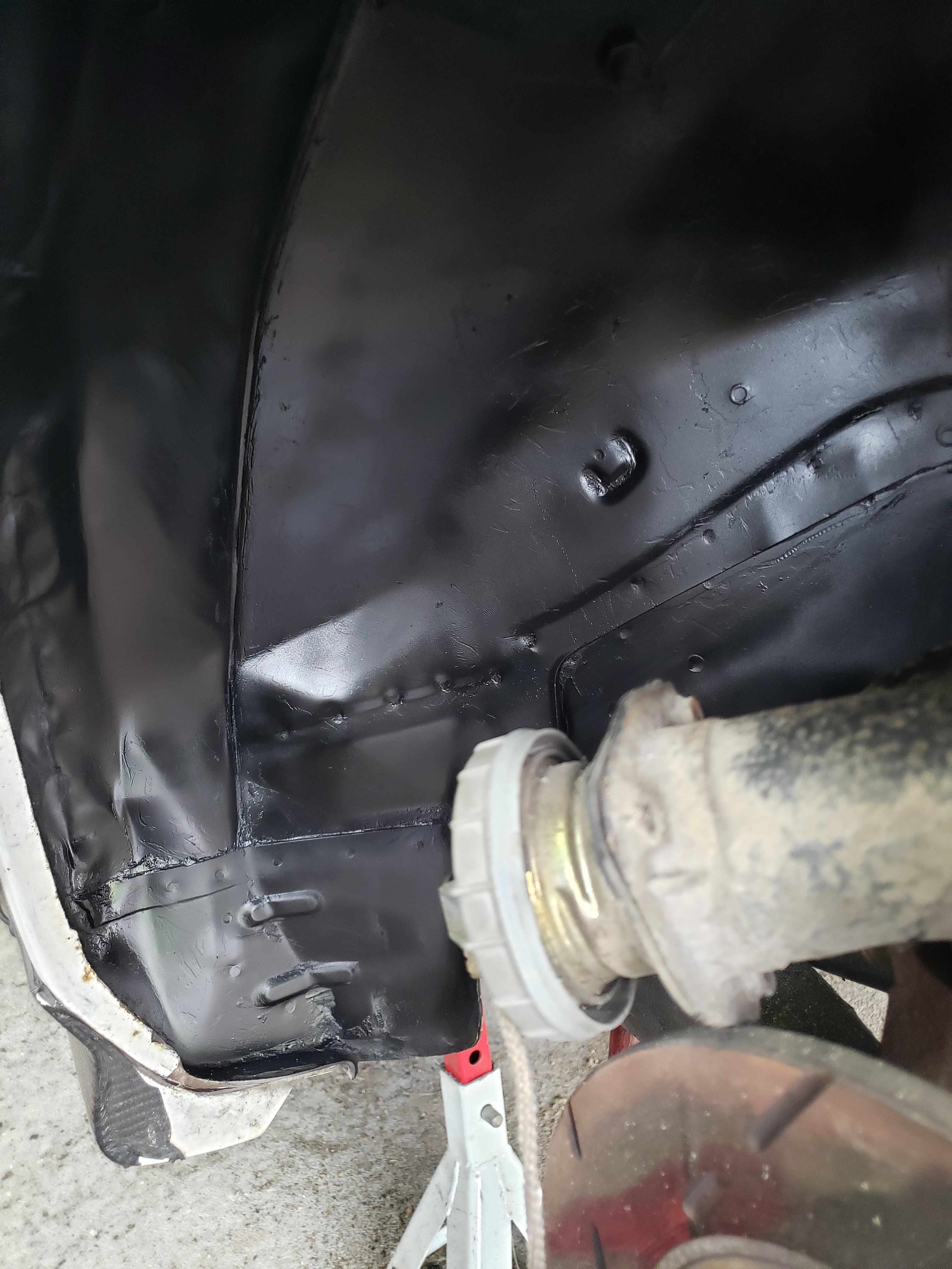

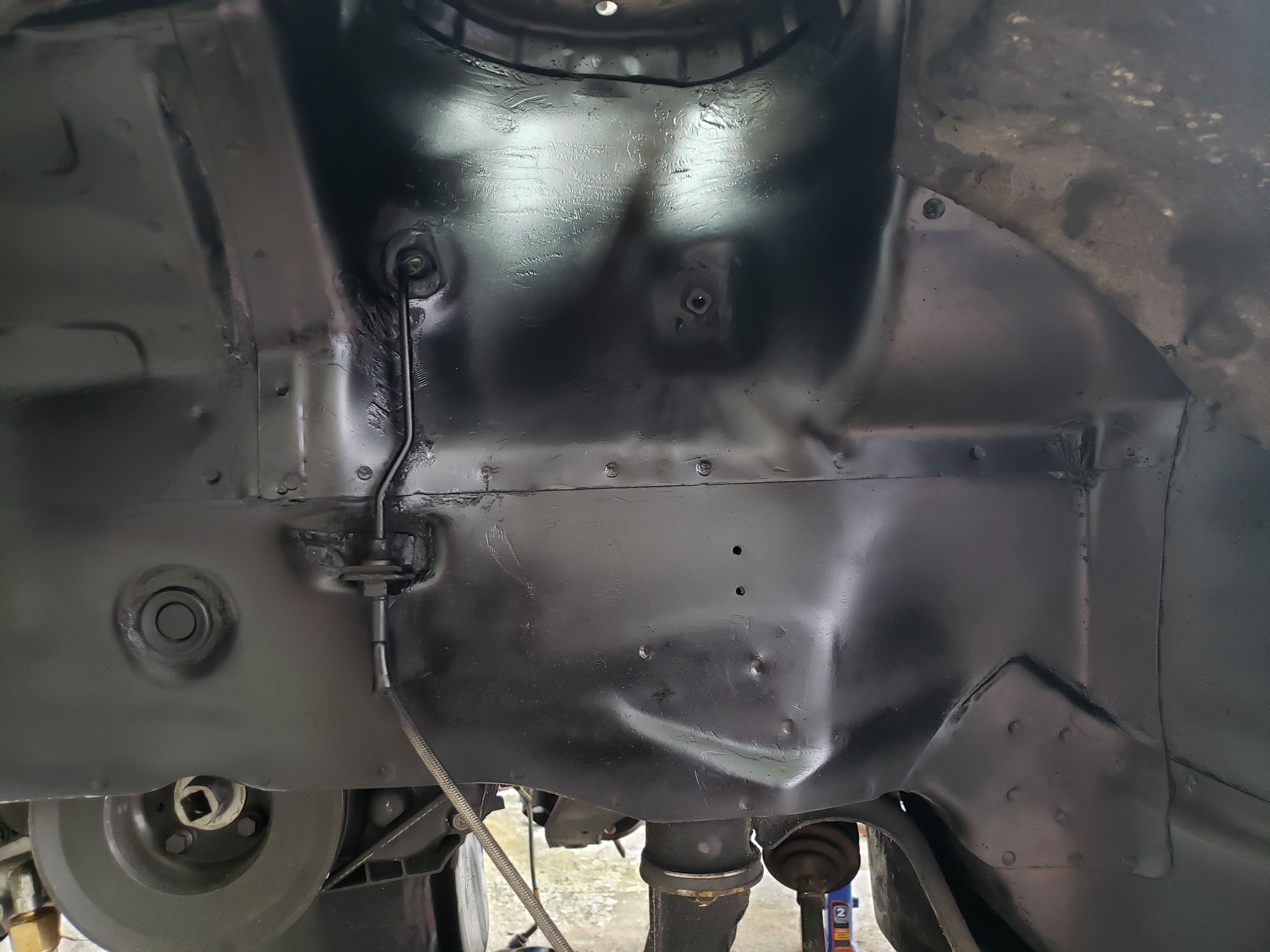

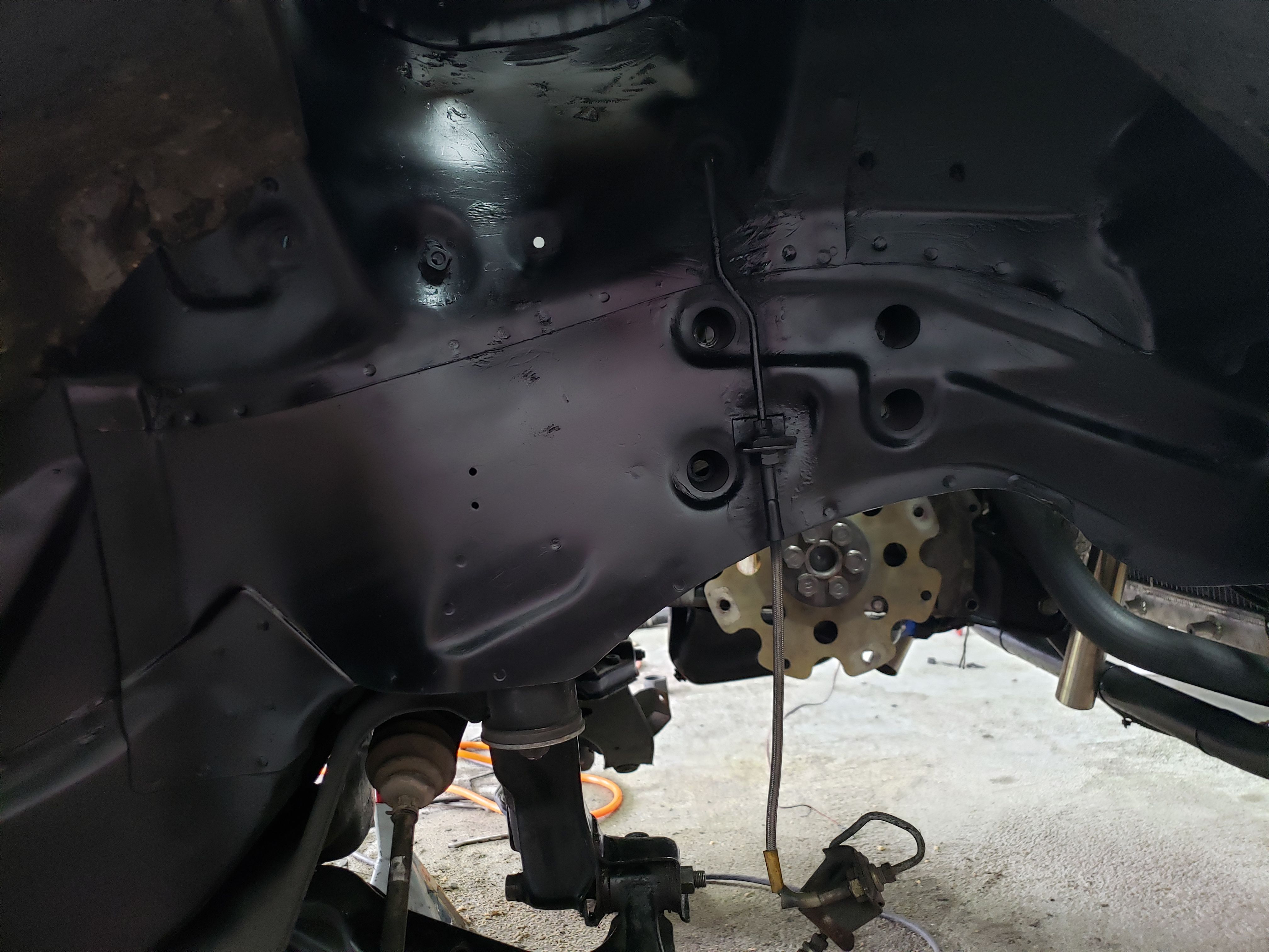

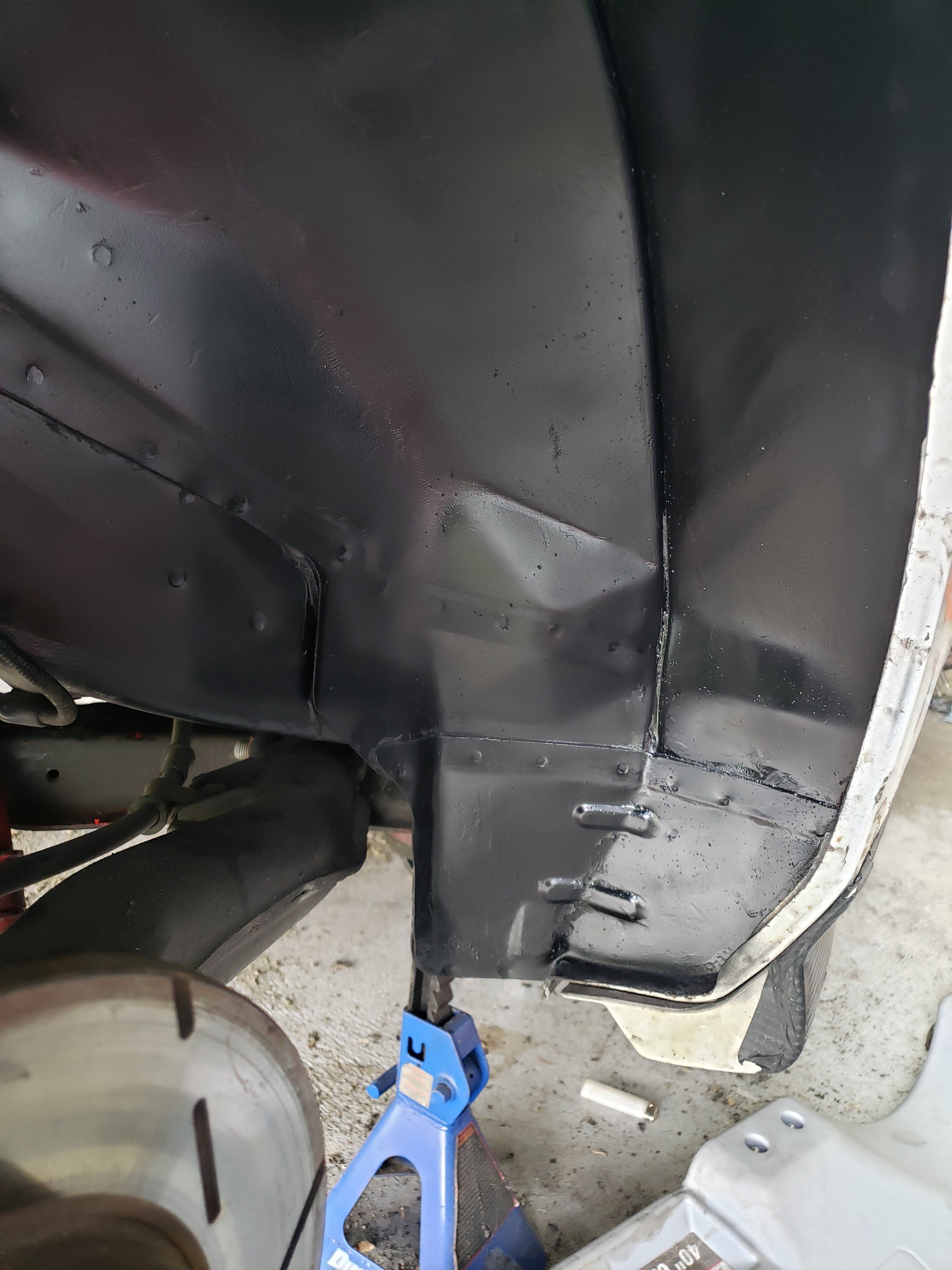

I got all 4 fender wells done and painted matte black. I'm pleased with how it turned out so far. I still have to finish the under carriage. I would never do this again or recommend doing this until you are on the very last desperation of removing weight. The time and labor it takes to remove this is just ridiculous I may have 10lbs total I'm just not sure.

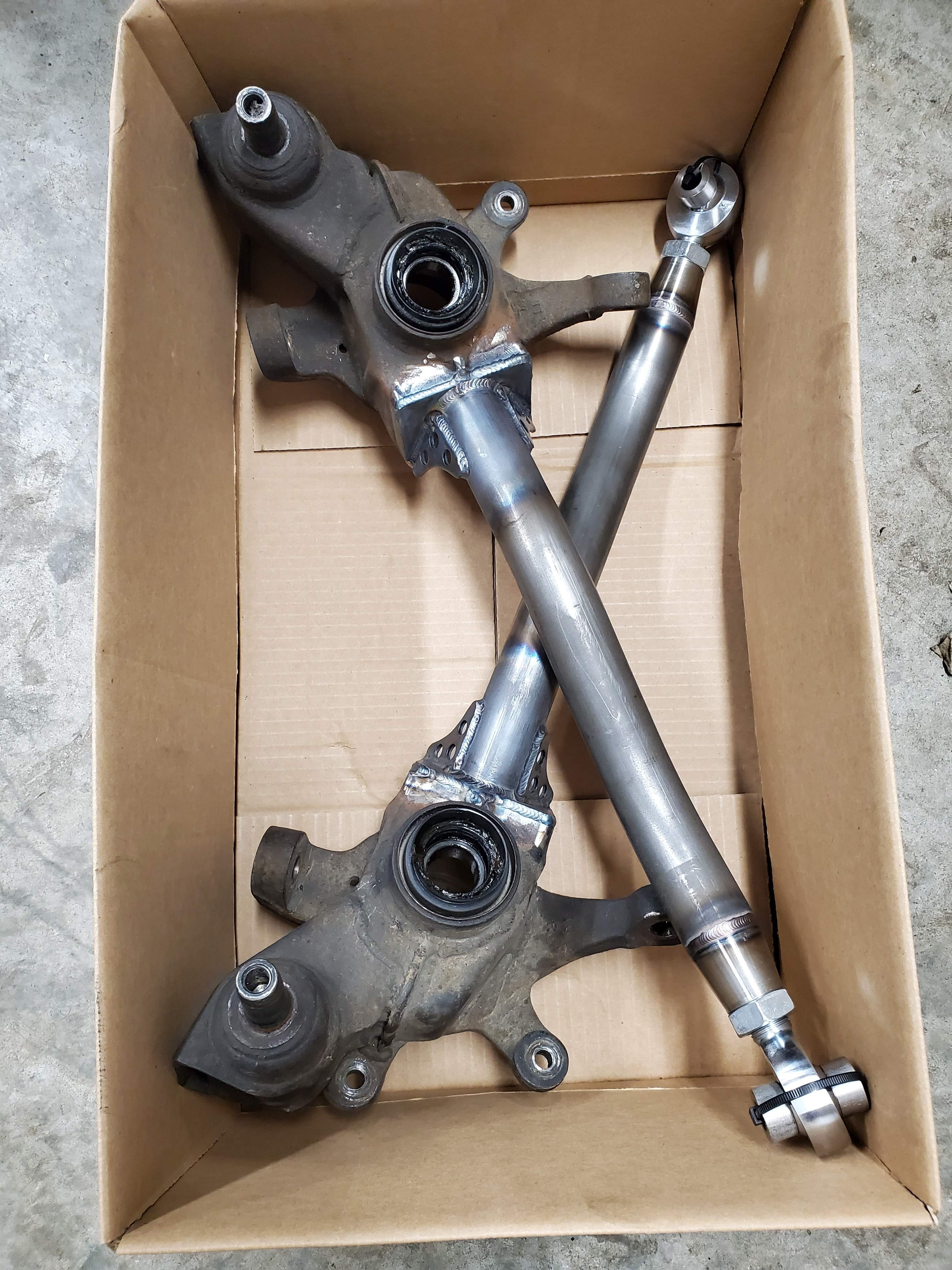

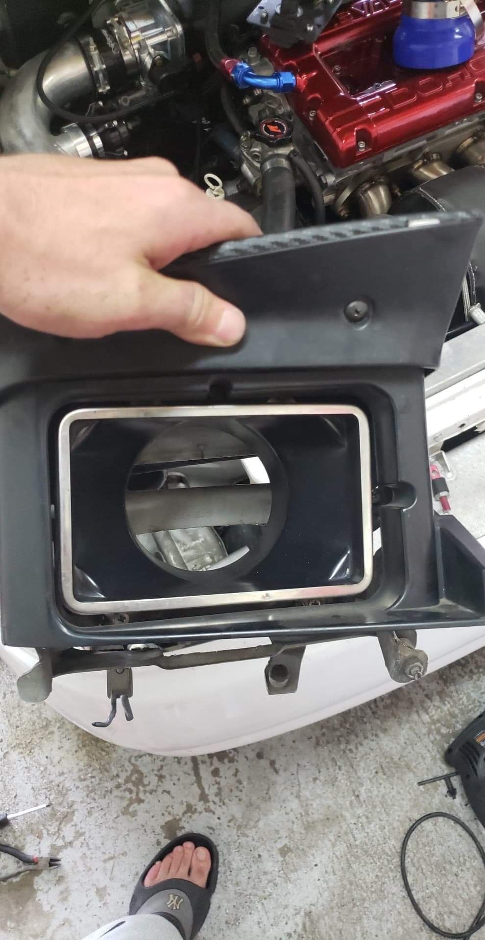

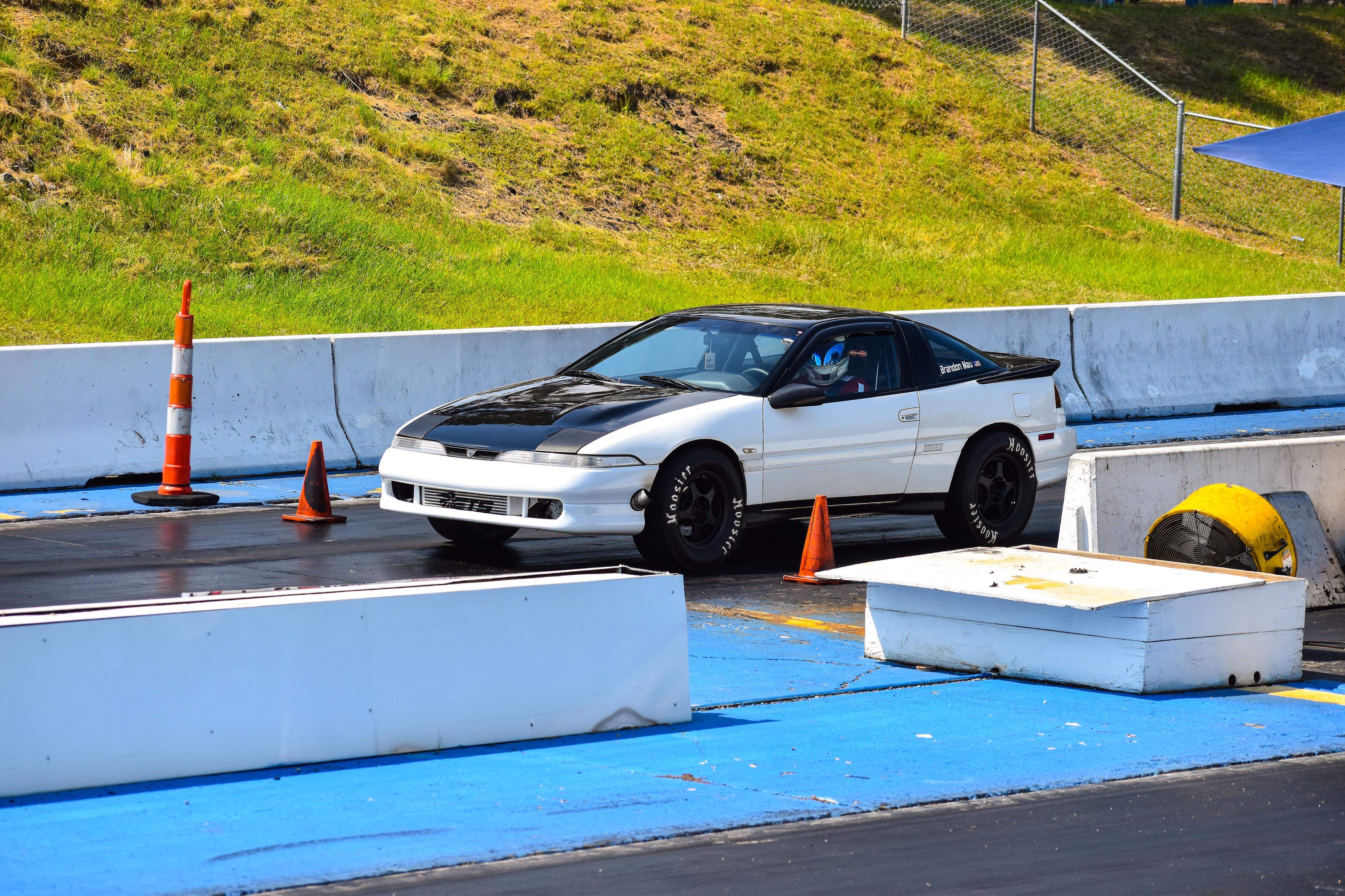

I've been so busy I haven't had much time to post anything. Been to the track a few more times backing up those 9's consistently. Last outting I ran consistent 1.43s with crap track prep. I seen Volk Metal Craft was looking for a test subject on a modified rear trailing arm. I sent him the email and I ended up being picked as a tester. Shaves 10lbs and I will be able to take the wheel spacers off when I have the slicks on so win win. I also made my own ram air intake. I haven't had a chance to test it yet because I need my trailing arms back but for $38 in materials if it gains anything I look at it as a win. The past 3 months I have reached out to EVERYONE to get a front subframe built but no one was willing. I finally found someone and I picked it up last week. Once I get it on the car, aligned do some street driving and make some 140mph passes to make sure it's good I'll announce more on it. My 9.53 or faster is within reach and I plan on getting my goal very soon.

I hit all the big names first but no one wanted to make any. I did see one guy I think down in Florida working on a design/testing. I told this fabricator what I wanted and the cars purpose is mainly straight line drags with the occasional sunday cruise. I think alot of people expect these tubular subframes to be super light and more rigid than a factory one. In reality majority are built for one purpose weight reduction and as long as it holds strong i.e doesn't flex for my 1/4 mile passes then to me it's a well built piece for my application. I took the sway bars off a few months back, north and south bars have been off for like 5 years now definitely have no intent on doing any road course stuff.
