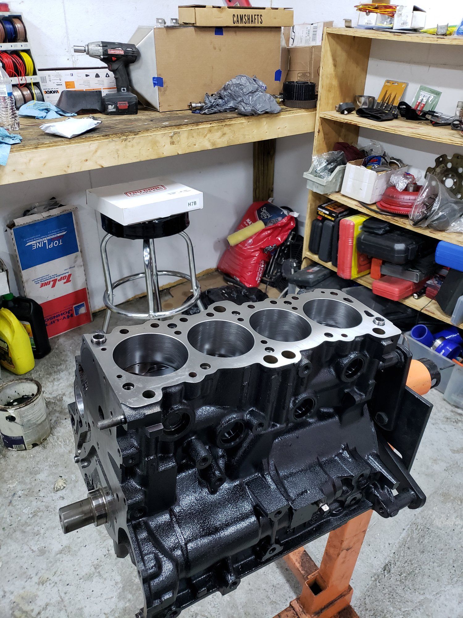

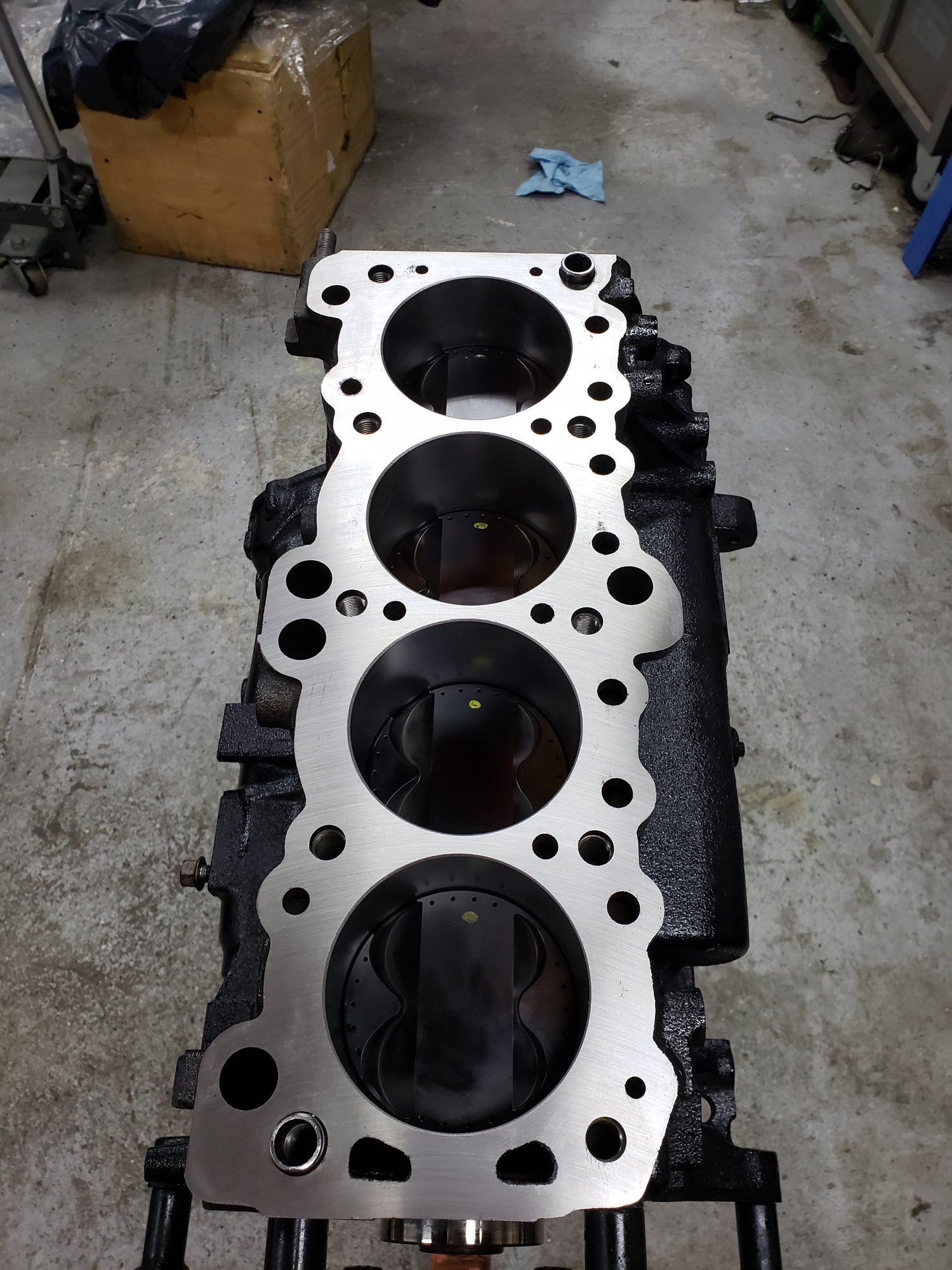

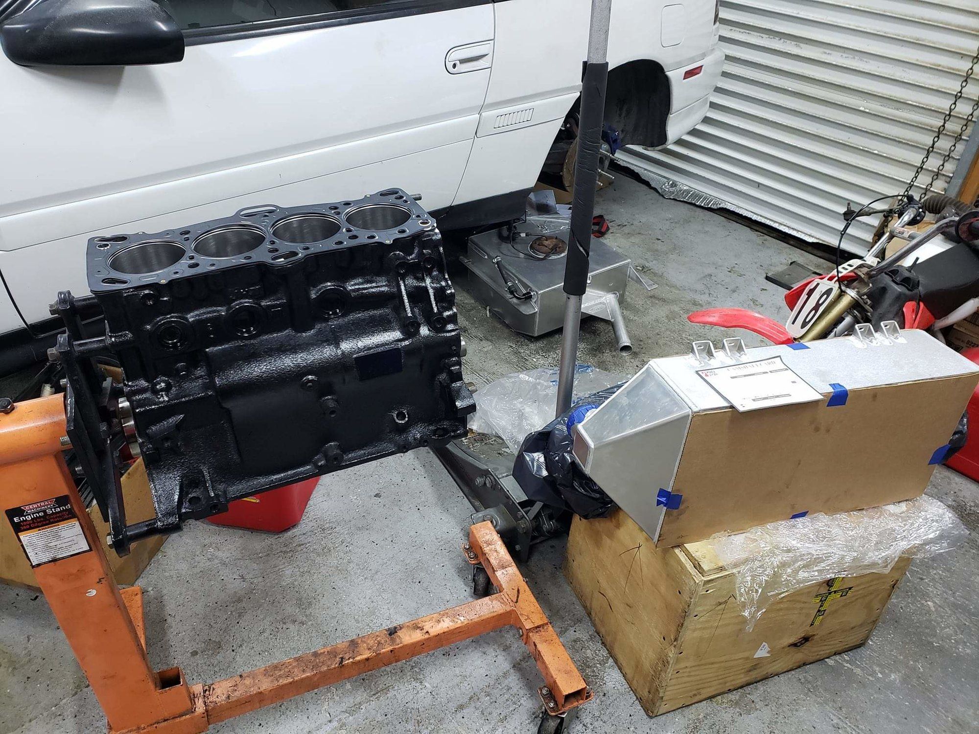

This has been a long 9 months since the last block had a detrimental failure. I bought a used shortblock but that ended up being junk after I tore it down with very little passes on it due to poor quality control. So I took another step back and just went with top of the line work done right by none other than Curt Brown once again. This assembly is a Turbo Tuff and Shearer Spec Wiseco custom pistons which are vastly different than the standard off the shelf wiseco extreme duties. I will post pictures of the actual short block later but damn does it feel good to finally have this knowing I don't have to second guess the machine work performed.

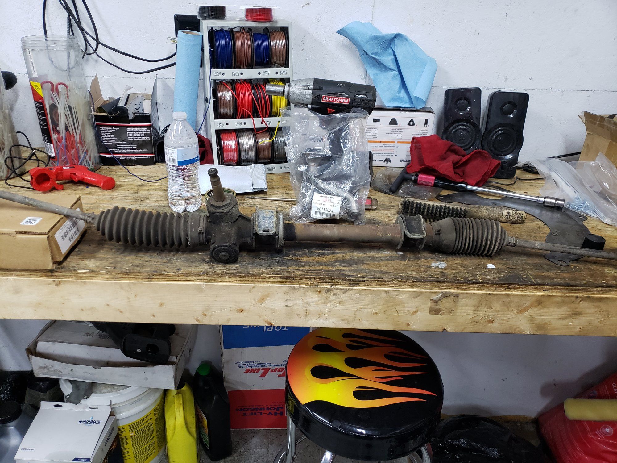

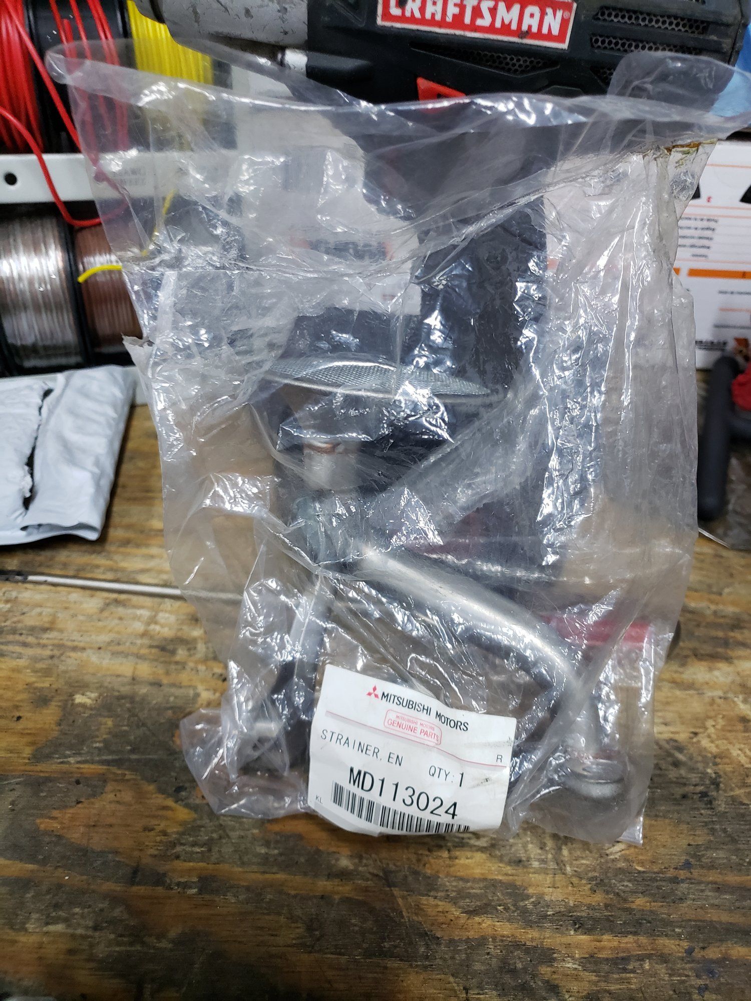

Finally had some time to pull the block from packaging and slap it on the engine stand. I am shooting to have this assembled by Friday. I got my hands on a brand new OEM 6 bolt oil pickup which are discontinued. My friend said come check this out and bam manual rack that I've been talking about for over 2 years. Ya he got my ass when I was vulnerable LOL but it has good bushings and the correct brackets.

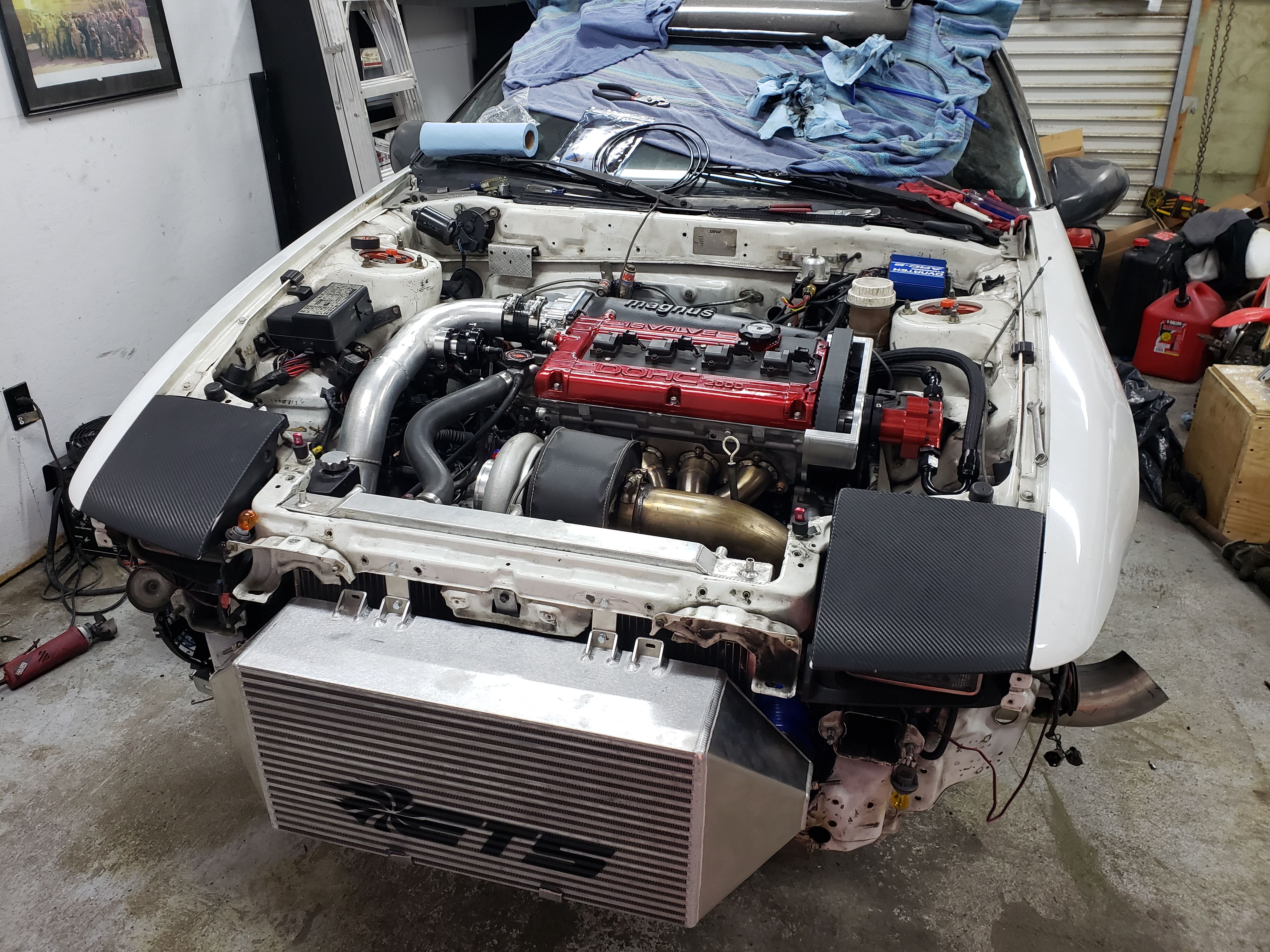

I also took a shot of the shortblock next to the ETS 6" intercooler this thing is huge. I'm not gonna lie I definitely overdid it for sure.

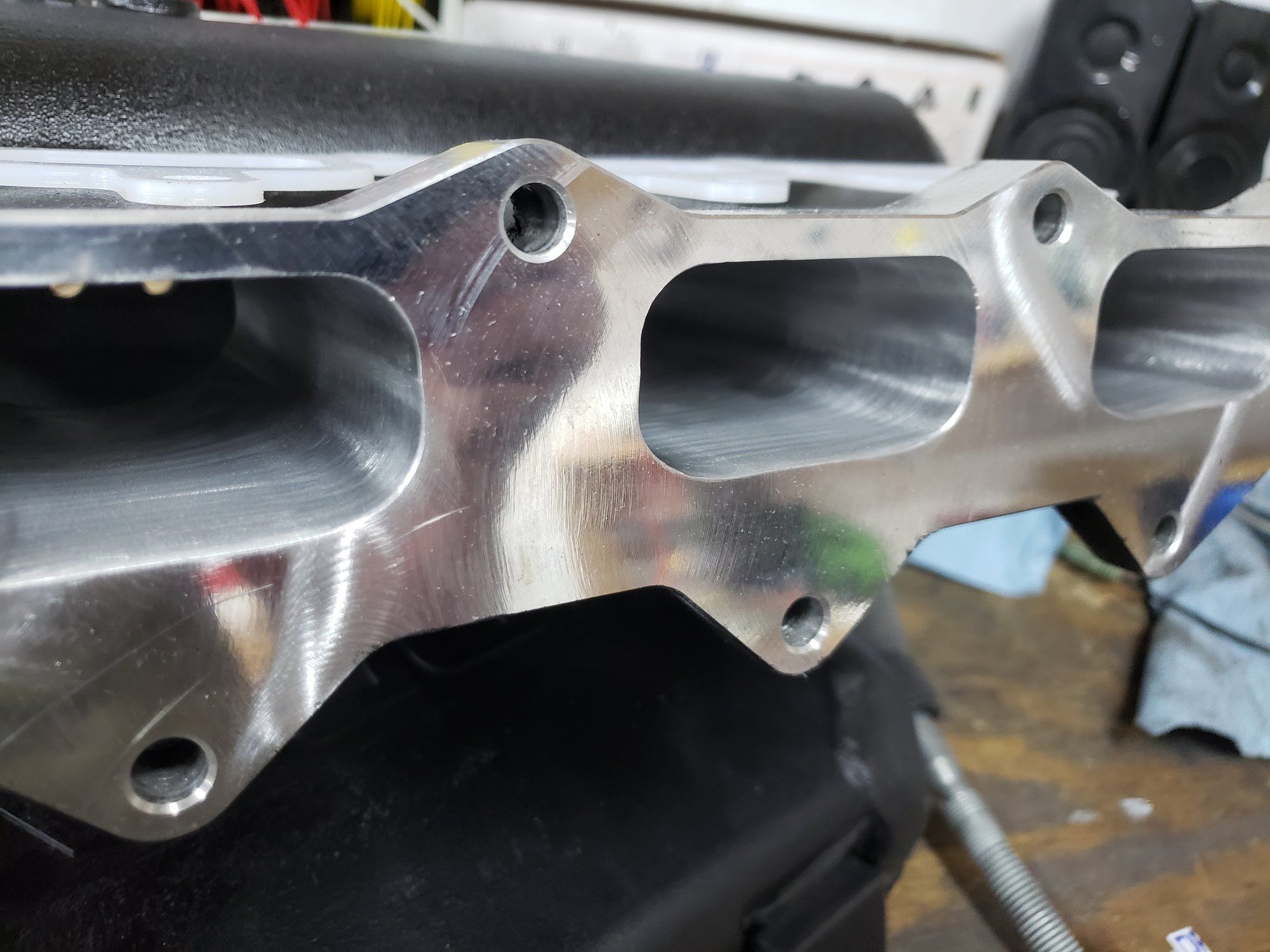

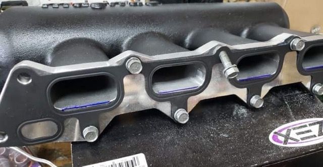

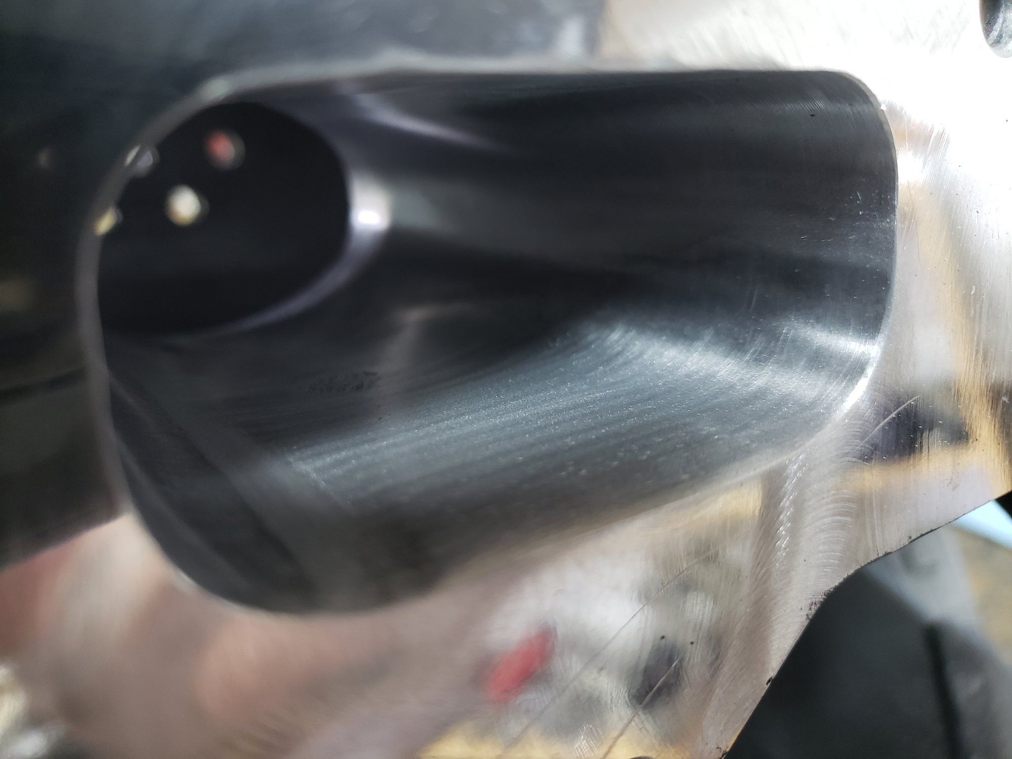

I didn't care for the small casting flaws in the runners so I took some time to clean them up. Then I gasket matched the port to match the head port work. Neccessary no but I will squeeze every single bit of efficiency I can out of this.

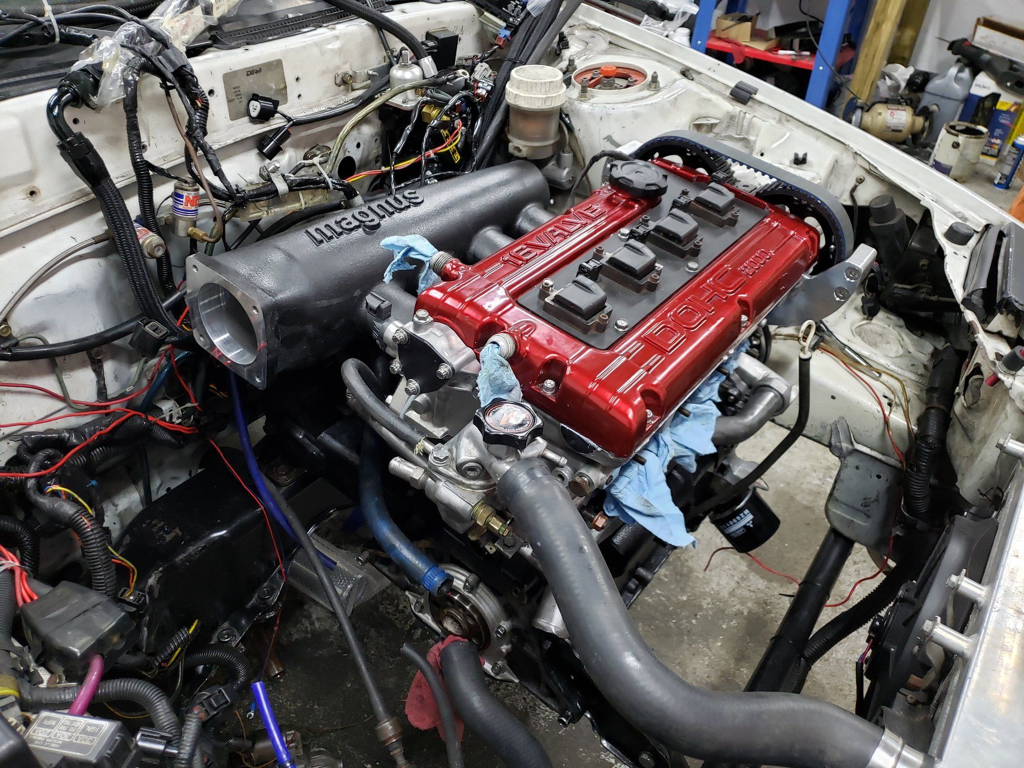

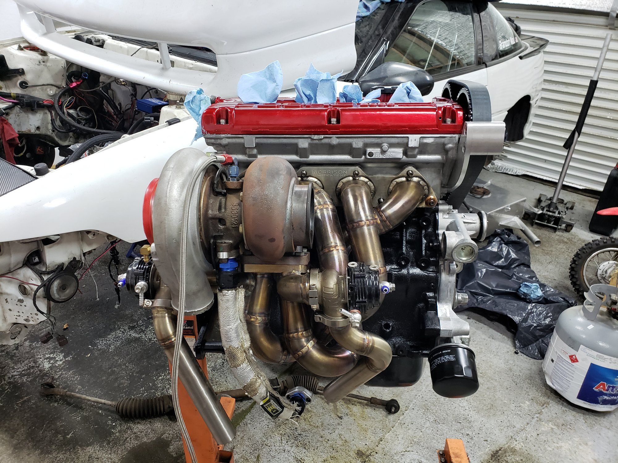

After the port work I decided it was time to drop the longblock in. Now this is such a relief FINALLY! I call this March madness. Don't mind the earnest of wires I plan on addressing that later.

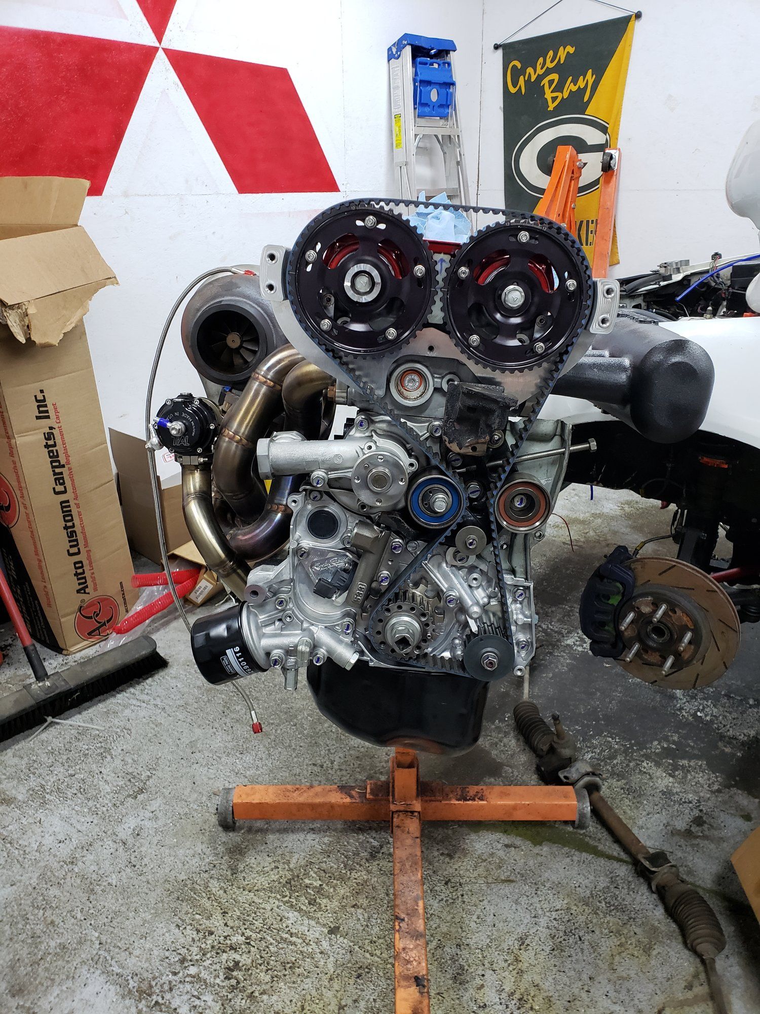

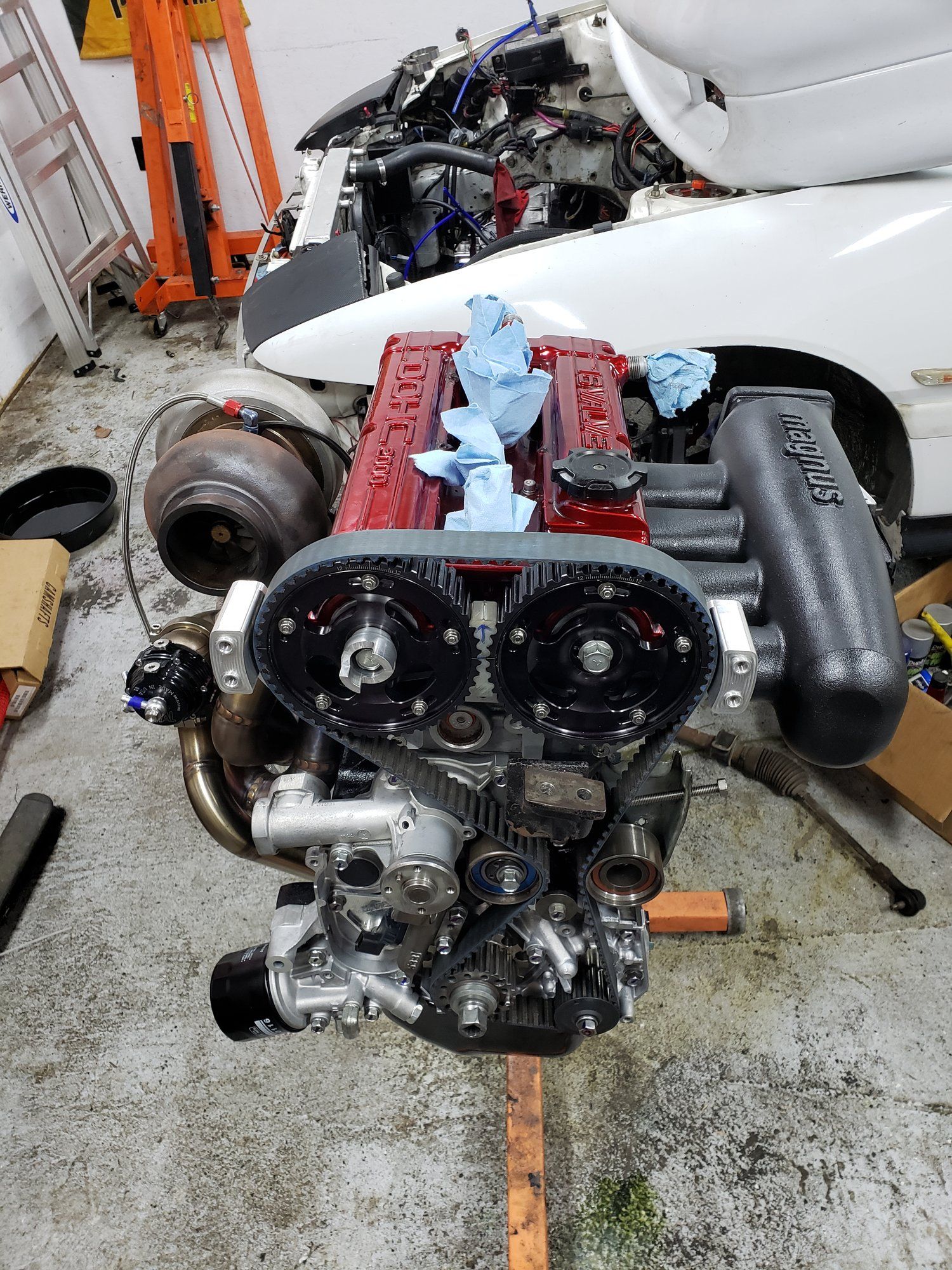

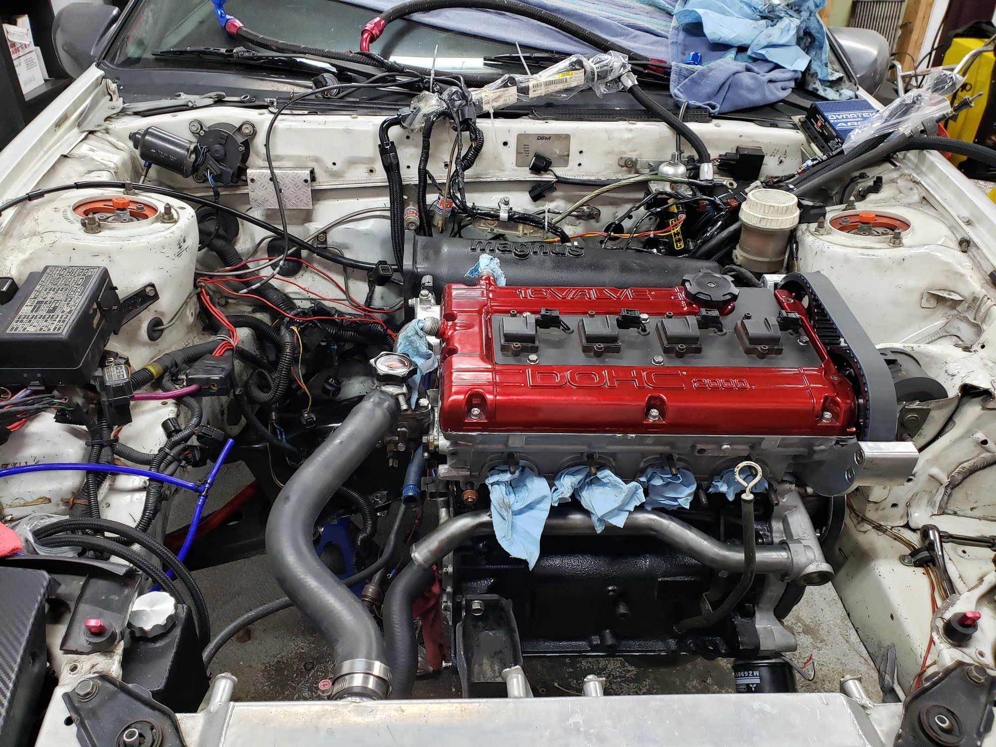

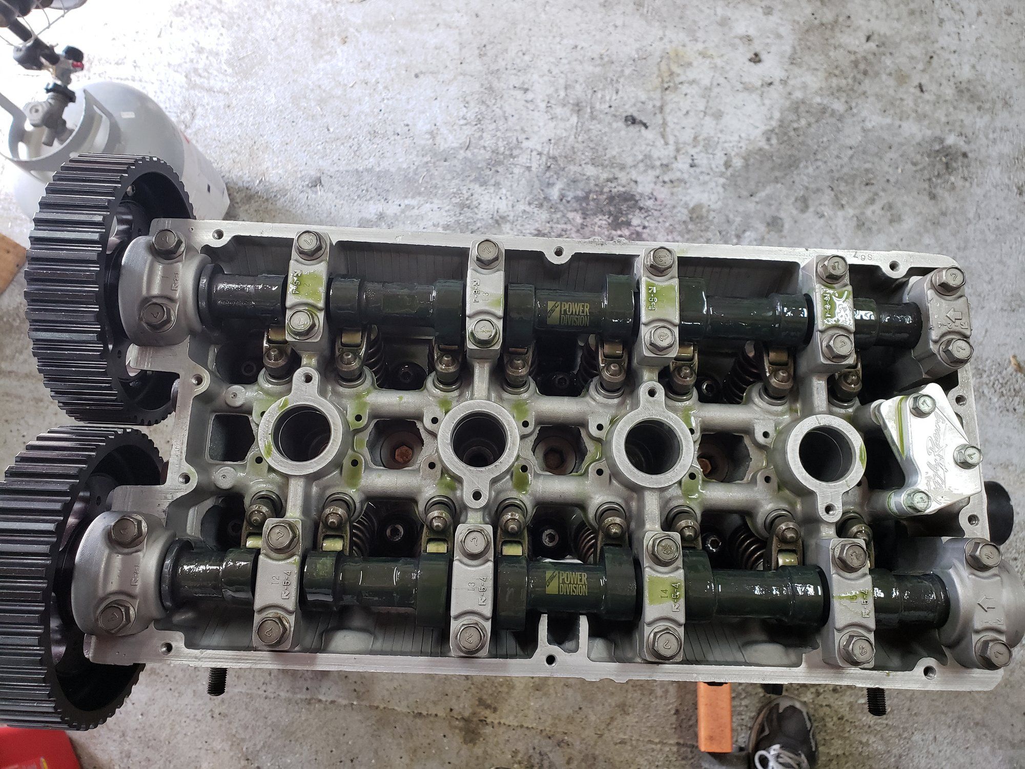

Been slowly chipping away at it. Just need to install the new wideband, axles, fluids and it will be ready for its first start. I need to cut down my upper intercooler pipe about 1". The intercooler needed some new supports on the bottom since it weighs 58lbs and of course is 2 inches thicker. I tucked it as tight as possible. Once I get it running and tuned to the new intake manifold and cams plans are to address the wiring in the bay and just enjoy the car on the street.
Got it up and running. Took it for the seat rings drive and it felt great. Many were saying the Magnus intake manifold and s3's were gonna kill my low end and driveability well I didn't even notice I had high lift cams in it from a take off or hills ect. I don't know if it's the twin scroll setup paired with the consolidated manifold or what but this thing just wants to RIP I can feel it. Now that the biggest obstacle is out of the way it's time to dial in the tune, get a full exhaust on the car in 3.5" flavor and clean up the wiring. I'm happy I can finally drive and enjoy the car after 10 months. I'm not even thinking about racing right now just enjoying the car.
