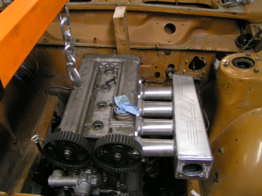

That's a pretty nice looking intake manifold. I really like my JMF RWD manifold. Too bad I can't use it. :cry: I don't have enough room with my shock towers to clear it. It also sticks out too far for me to run intercooler piping. If you, or anyone wants pics of this manifold, I can post them here. It's a superior design to the Magnus unit that people complain about. Apparently people running high boost are breaking the welds on the Magnus units. The JMF unit has fewer welds and are much thicker looking welds than the Magnus or other units.
Thanks for the input imtall77... I REALLY don't want to start comparing manifolds in this thread.
I'm sorry if I gave the wrong idea by posting the few pics of the Magnus one. The ONLY thing I was trying to do there, was to show the "reshaping" of the runner at the head flange. I was not trying to start a discussion about, one reason or another, about why someones is better or worse. :thumb:
Just out of curiosity though... Why cant you use that one???
:dsm:Jake Hanhardt:dsm:
The JMF unit is just too big for my car. I ran into clearance issues with it and my brake master cylinder and also intercooler piping. I have a pic on photbucket of the master cylinder clearance. It's about enough to fit a business card. And with an NA throttle body, I have about 1.5" from the TB to the radiator inlet. I'm working on another design that should make life much simpler. I'll reveal my secrets when I get it back from the welder. :cool:
I wasn't trying to say who had a better intake manifold. I was just trying to point out the differences in each design, so that you don't make the same mistakes. If you have the time and skill, why not make your own. I think you have things handled. I was just trying to give some perspective on what might work.
