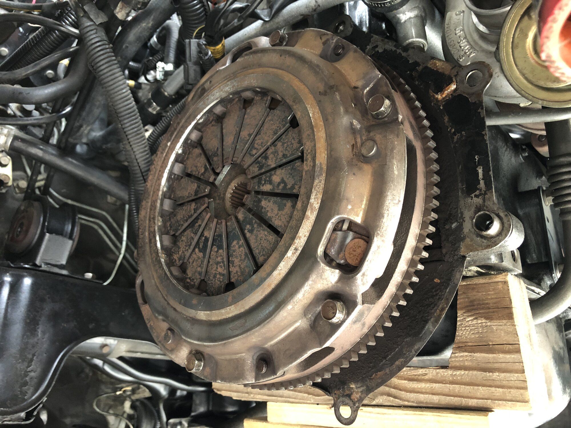

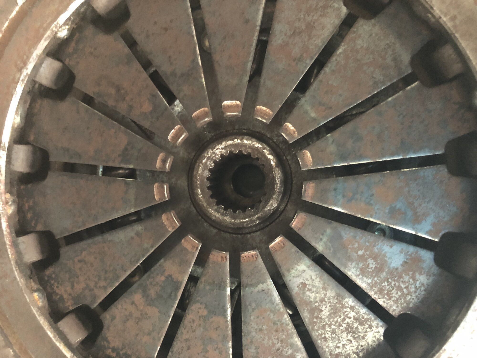

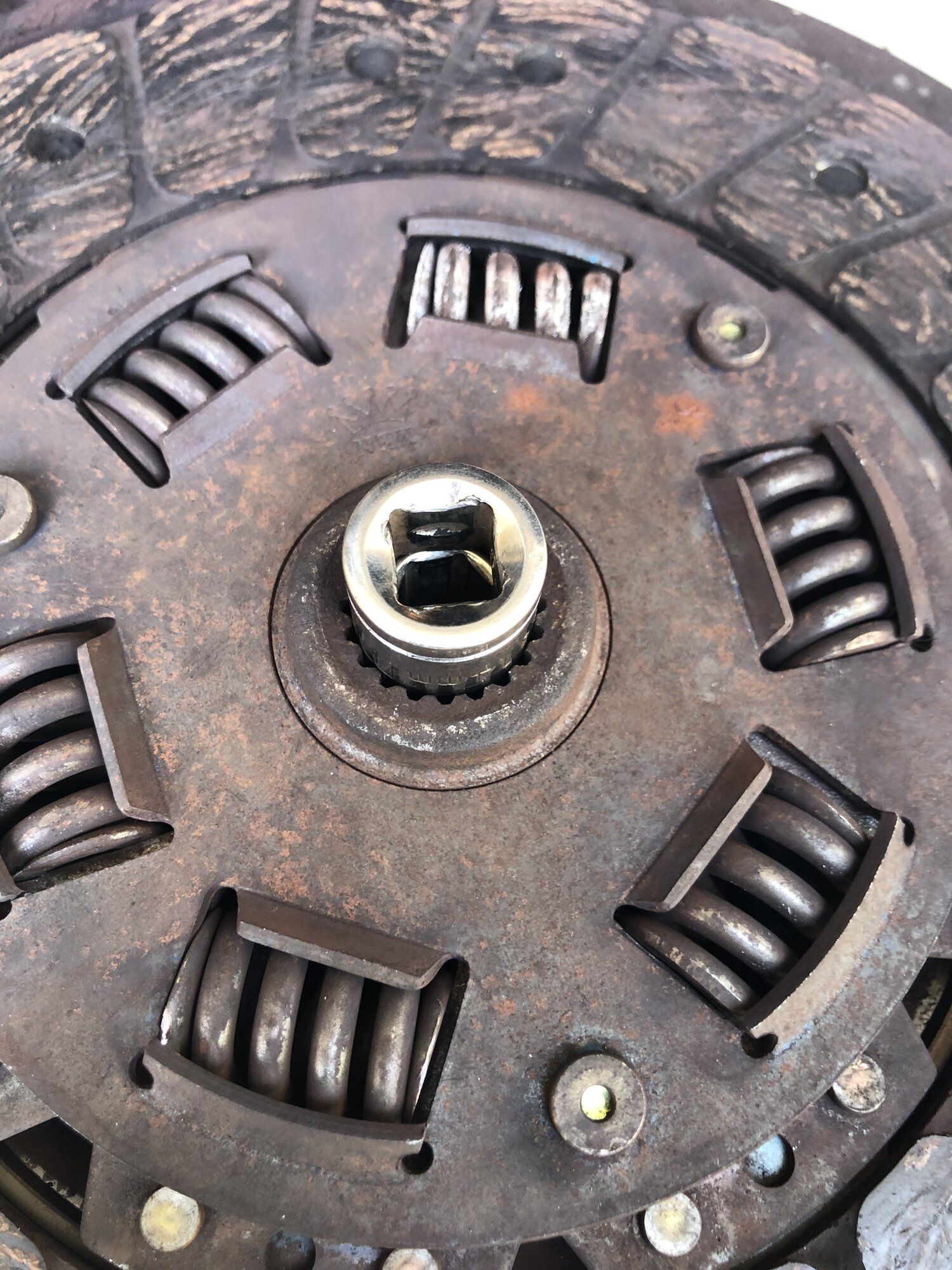

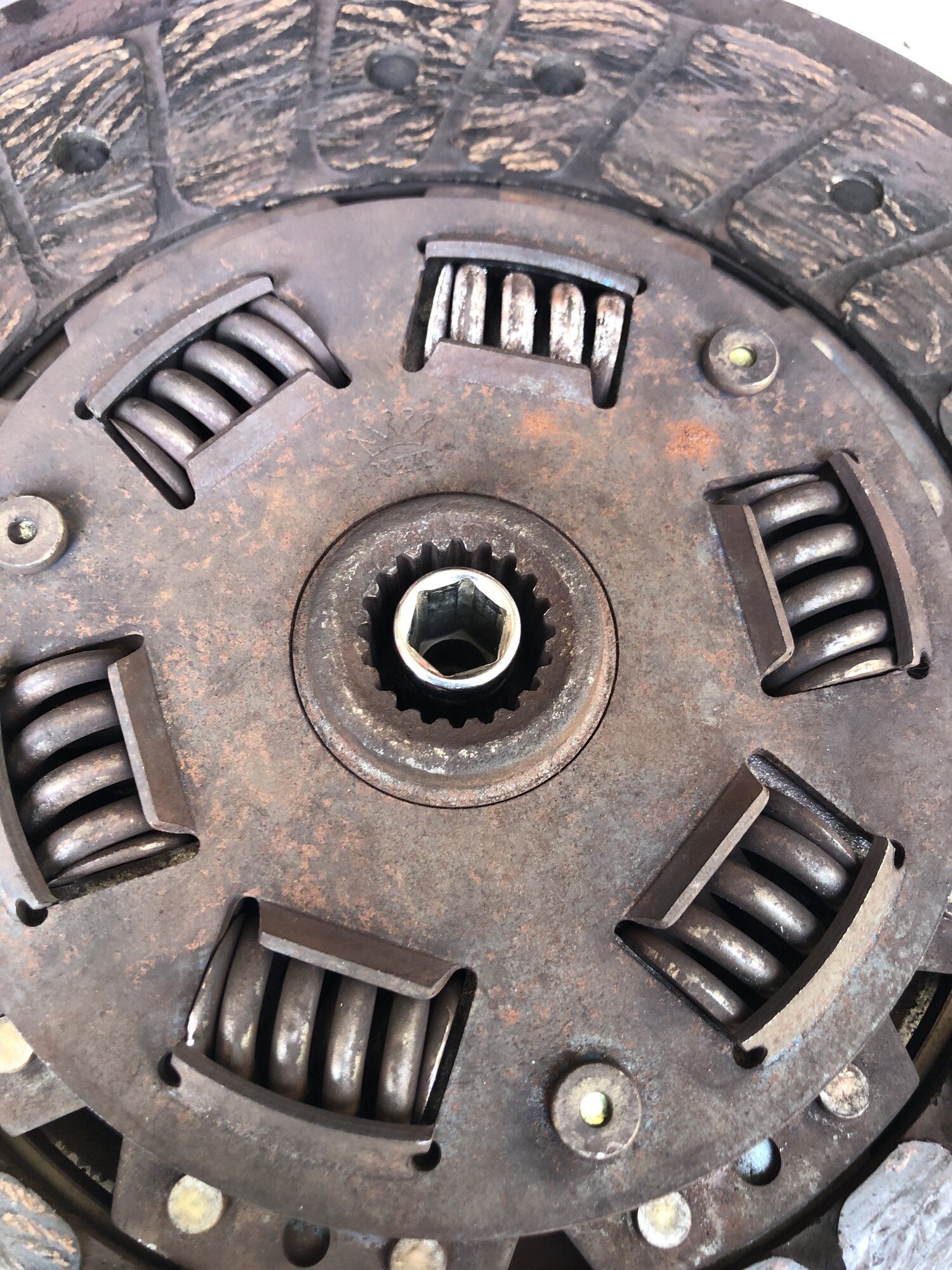

Old gen ACT clutch
Oh yeah, thanks for those pics. The sharp notches at the outer corners of the spring windows are really bad for stress concentration. Then they fatigue. The windows should have rounded corners or overlapped, or something besides what that is. Do you remember what year that disc was new?

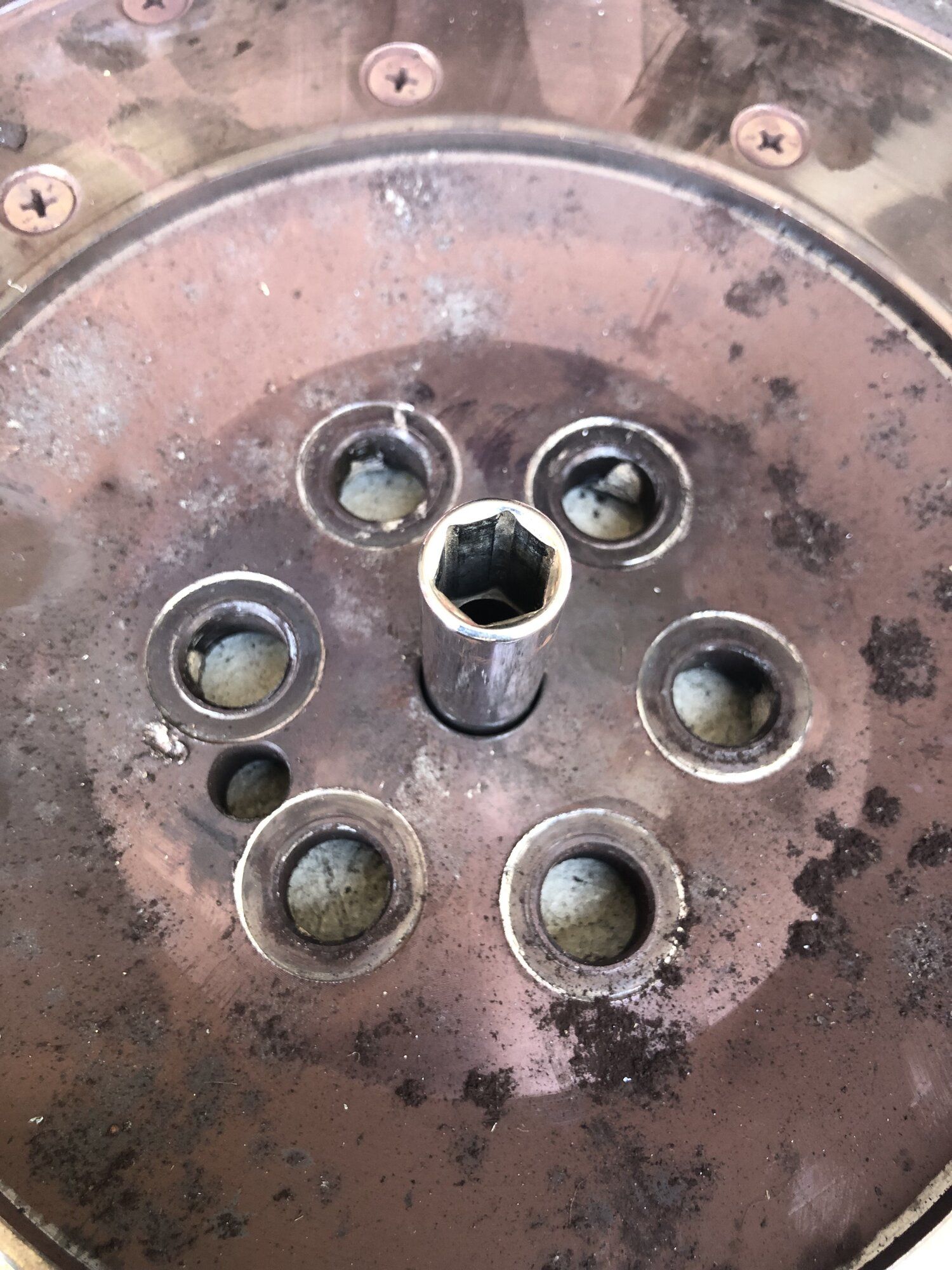

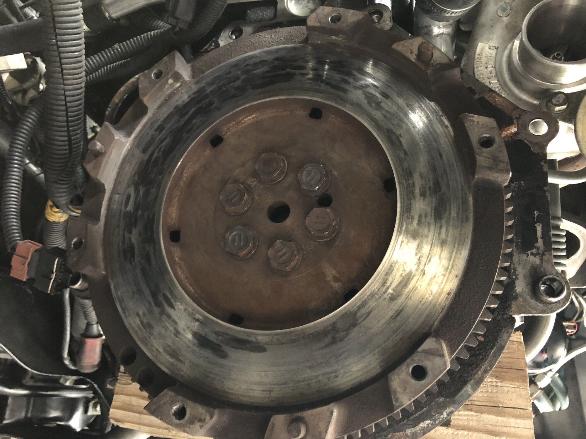

Fidanza flywheel:

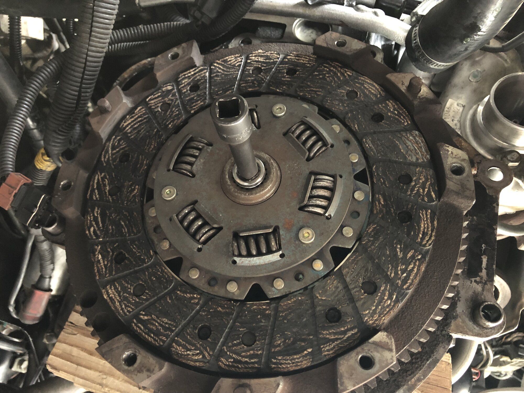

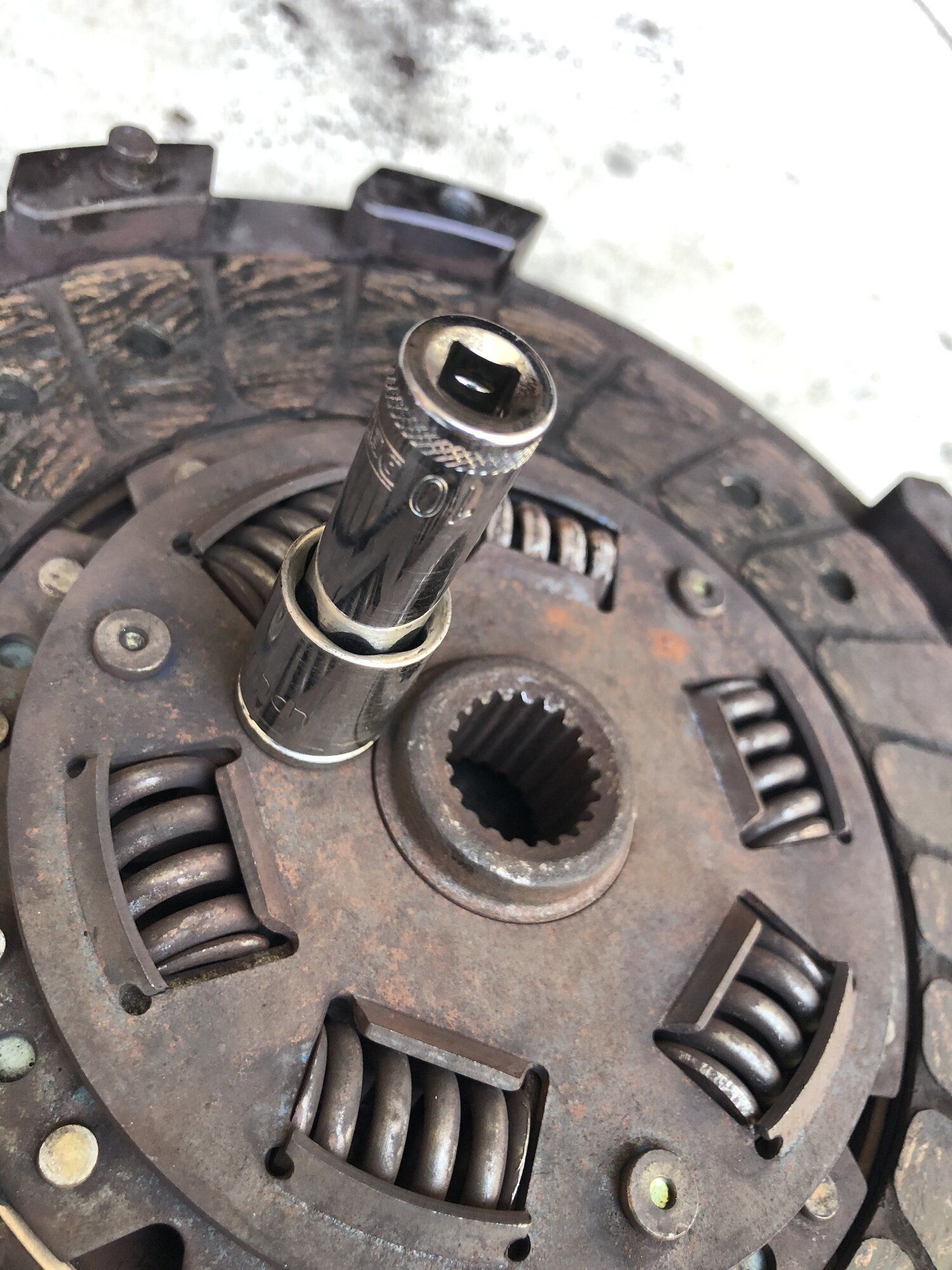

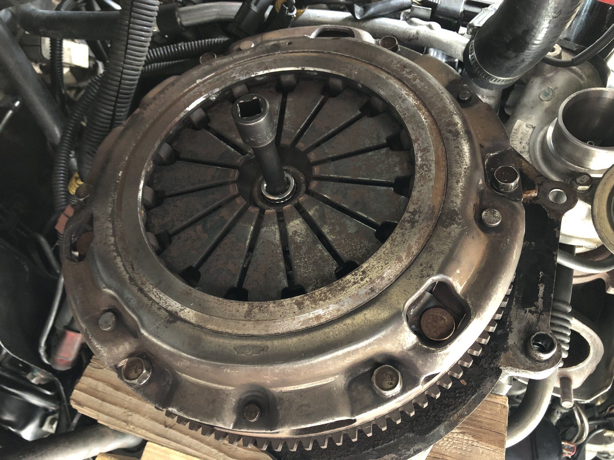

A fingernail can find the edge of the warn friction surface, but it is perfectly smooth otherwise. I don’t know if it is still in spec. Now I’ll see if there are parts to be had for it.
Also, for comparison- x-clutch (i think) on the left and old ACT on the right. Notice, the corners of the spring holders on the x clutch are drilled circles. I won’t use either of these designs, and probably no point in hanging on to them.
