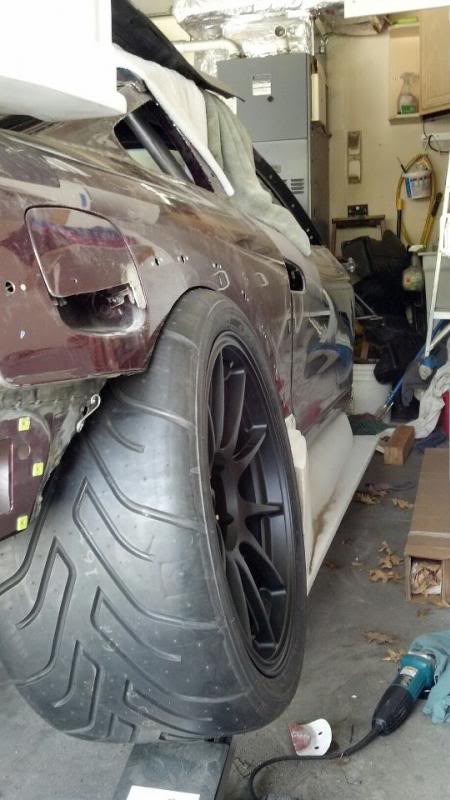

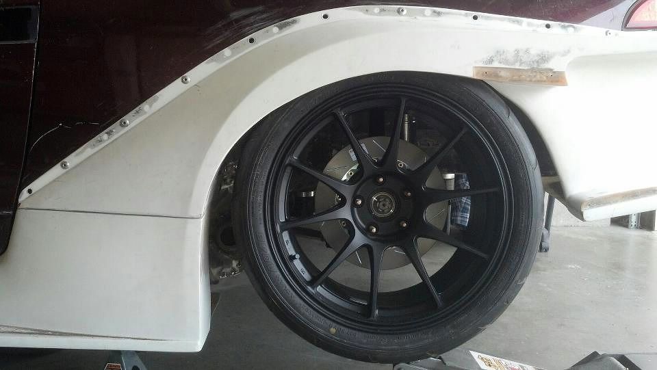

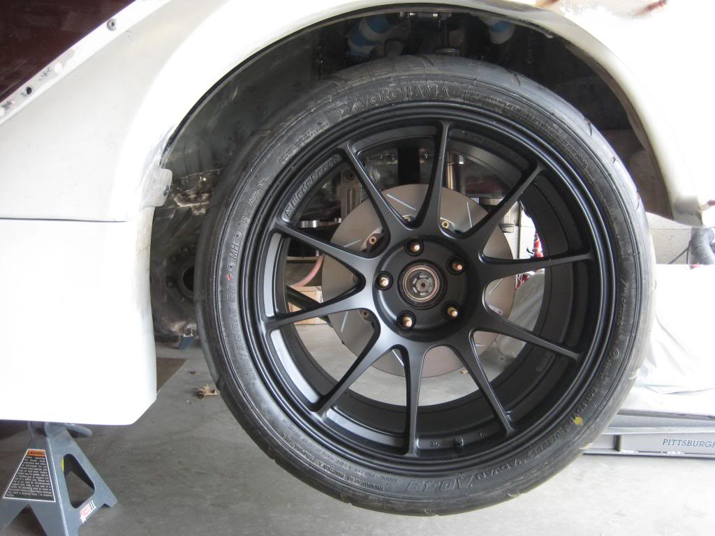

Good thing I'm not in public or I wouldn't be able to stand up for a while. Those are dead sexy.
How is the rest of the car coming along? Any idea when you'll get it onto a track?

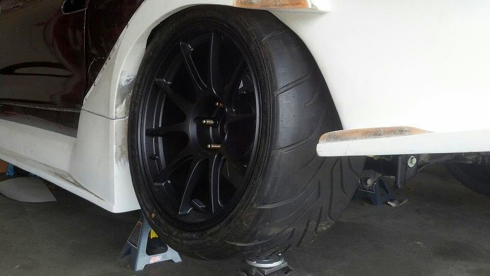

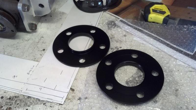

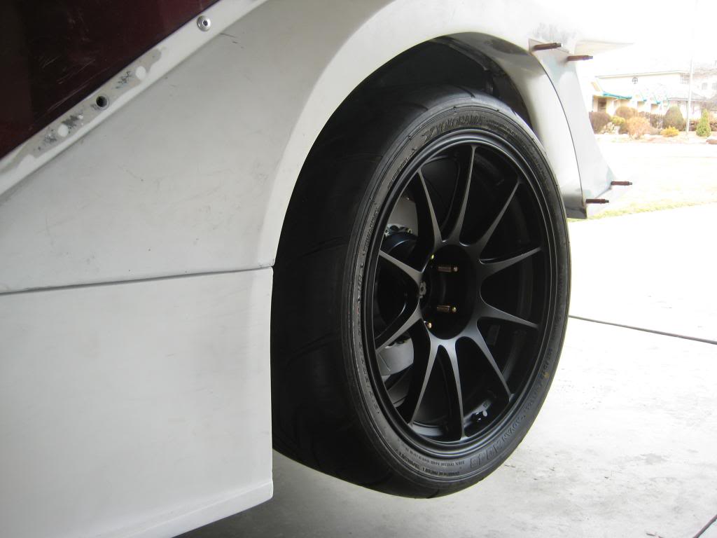

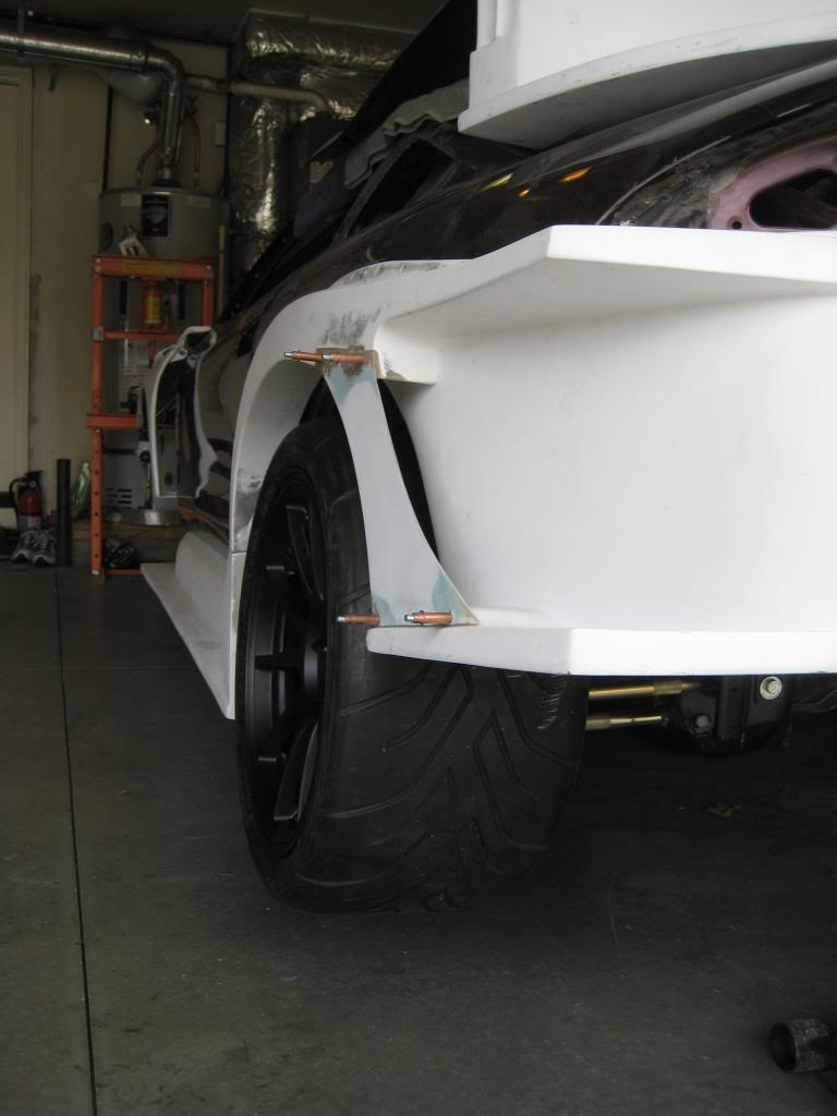

What wheels are those and how big spacers? I need me some wides and those look awesome
There will not be any spacer. Custom front knuckles are going to be built for up front. the rears should be fine. I think anyway. I'll find out this weekend or early next week.
The wheels are Wedsports TC105N 18x10.5 +12

That's a lot of rubber Kevin and it looks great! What's the build plans for whats going under the hood to get those things turning, same 3065 setup?
I briefly remember Andrew blowing up P/S racks running that much tire, do you have something in the works so the same doesn't happen to you?

Turbo will be something like a FP HTA GT3582R or an Borg 8374EFR turbo . 2.3 or 2.4 with fairly high compression. That the plan right now anyway.
On the rack I have most of that figured out thanks to Andrew.

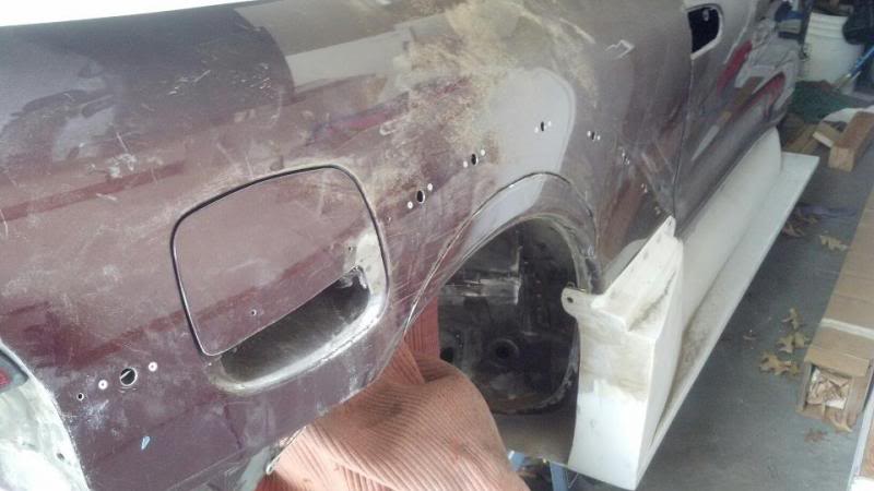

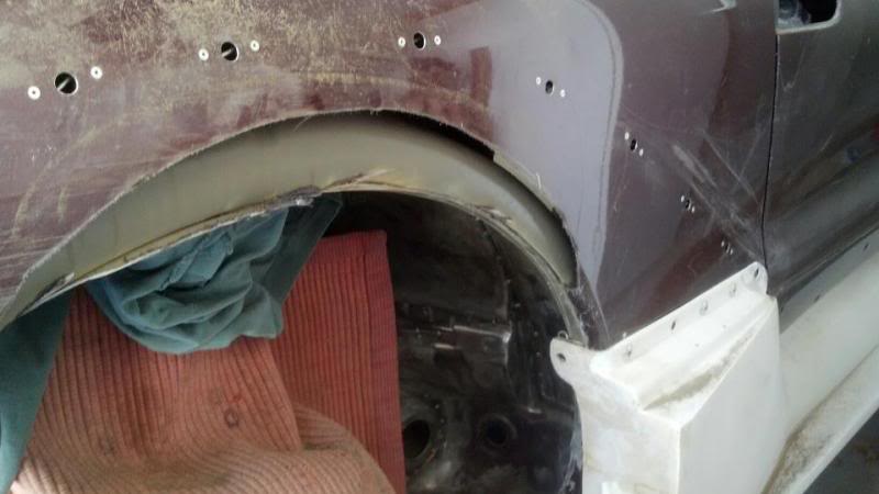

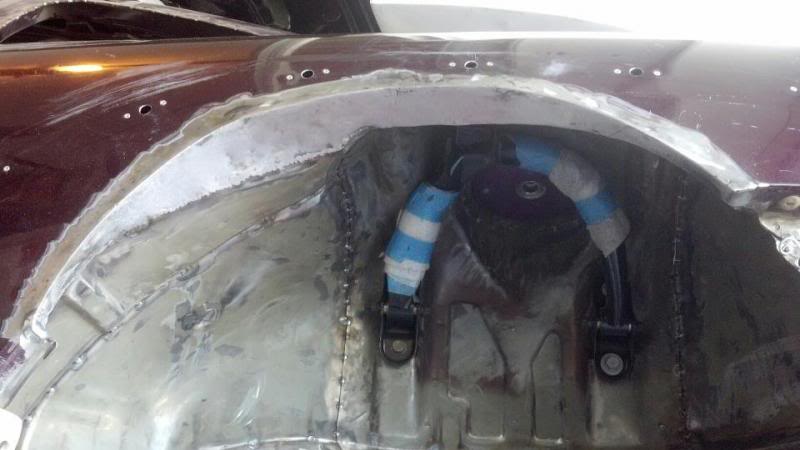

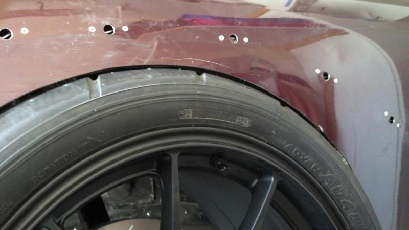

So the easiest way to do this is to first scribe your initial cut line. The fastest and easiest way is to just place your hand on the edge of the tire on center at your desired distance. Then slowly roll the tire both direction slowly. This will give you a perfect copy of the tires arc right on the fender. Then I just used my angle grinder with a thin cut off wheel and cut along the line. For touch up and final shaping I used a flapper disc. Now it is time to order some metal and pull out the welder.
