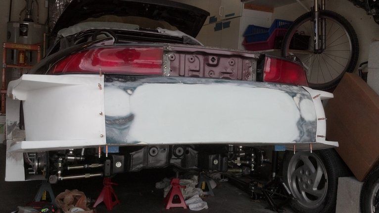

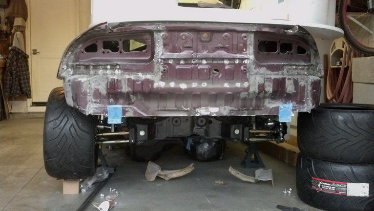

Kevin, I saw you posting about rear diffuser ideas so I PS'd this one quick. Once you get a photo from a few feet further away and the existing Eclipse bumper bolted back on there I could do a lot cleaner PS, this is just an idea though.

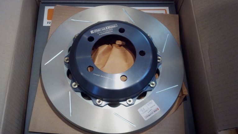

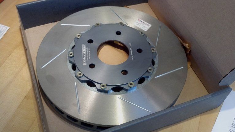

New toys came in . Girodisc floating rotors for front and rear.
I bought the rotors from Modern Automotive Performance (maperformance) and I must say the not only did they have the best price but their service was top notch. It always is awesome to run into a vendors that delivers! Big thanks to Nate at maperformance for all his help!

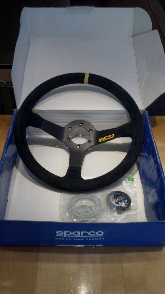

Picked up a Turbosmart hypergate 45 and a Sparco steering wheel up off evolutionm. Those should be here next week.

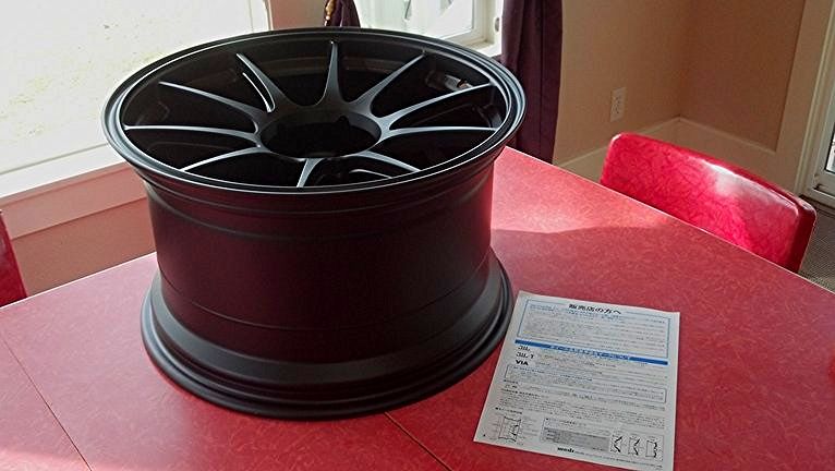

New rims should be here at the end of the month/early next.

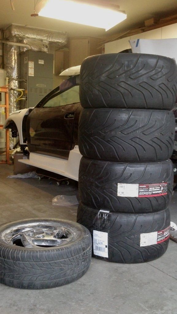

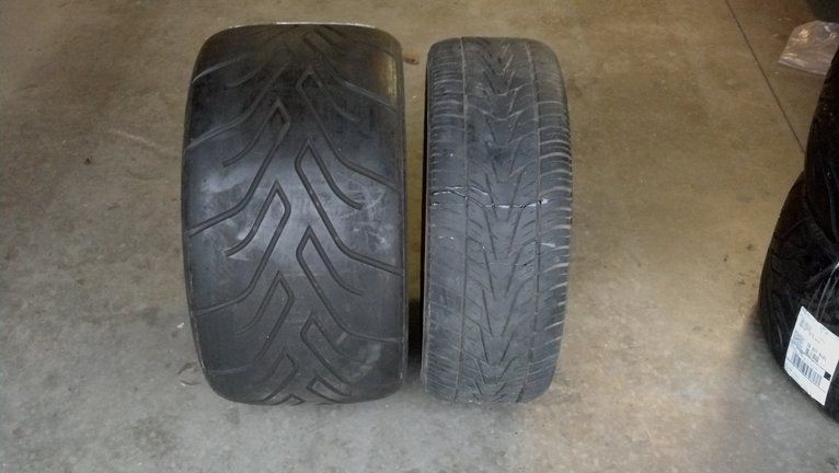

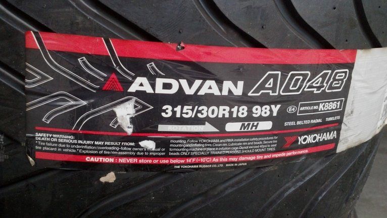

I decided to go big and put 315 30 18's on all 4 corners for tires. Big thanks to John Fruend for razzing me. It gave me the nudge that was need. I think I found a line on a set of new Advan 048. Should know more soon.
Sweet! I was really starting to wonder when you said you were going with a 285.

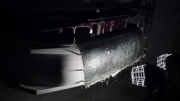

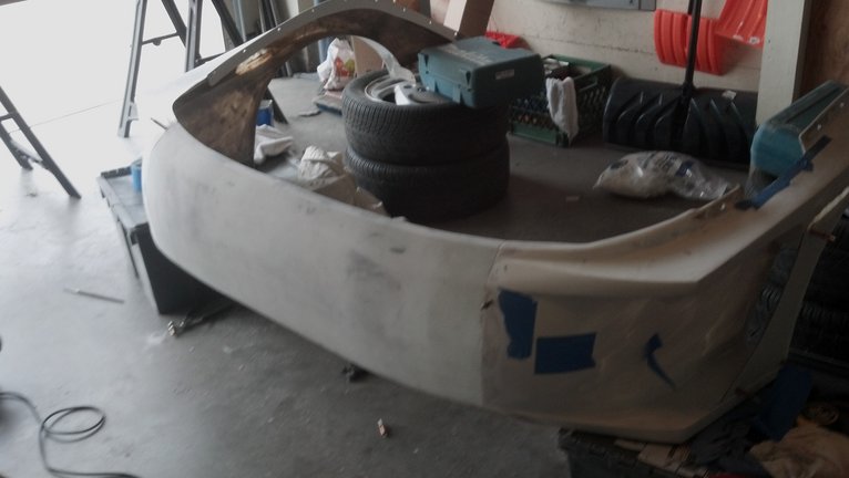

Little more work on the vanity project. Hope to lay some new glass in the next few weeks. I have been to busy building braces for people to get work done on my own car.
Big thanks to Zack for his help today. This would have been so hard to lay by myself. 1000 watt halogen = cure even if it is cold out.

i almost asked what tires those were cause i was looking through the pictures so quick from excitement, but then i noticed you took a picture of the tag ;)

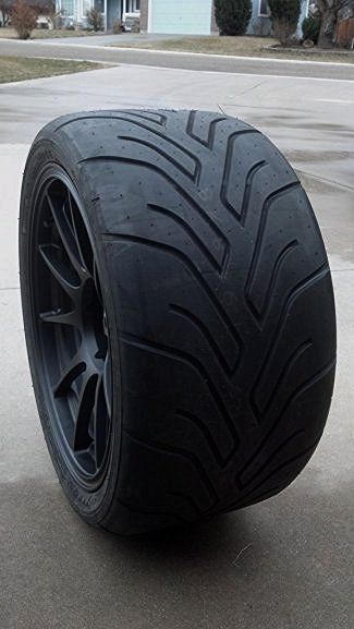

Awesome man, thanxs for saring the pics of the wheels.. 315 hehe I wil stay with just 225
on my DriftEVO .

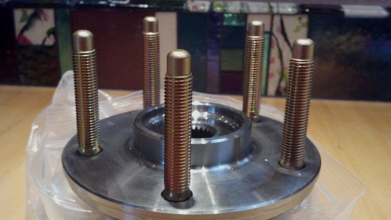

Hubs back from CBR. Curt Brown is an awesome guy to work with. Fast, friendly, responsive and a total badass all around through my entire purchase. Highly recommend if you ever need a part or service he provides to use him. You will be happy!!!!
http://curtbrownracing.com/index.html
Happy hubs with ARP studs and ceramic wheel bearings installed.
