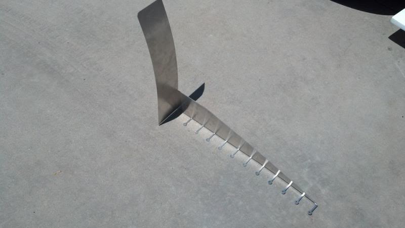

$65, that's it? I may have to do that just to have spares.
What's with the reproduction of the front wheel well vent aesthetic thingies? Did your fiberglass pieces break? Or are you just making some spares? It's not a bad idea to make some spares because man have I flexed mine a ton jacking the car up on lifts. It's a pain in the ass to get the car on a lift with how high the chassis is relative to the sideskirts, and often things compress and shift slightly just enough or the lift will raise/lower unevenly resulting in slight compression of the sideskirt, and those vent thingies (I have no word for them since they're just for looks) always bow out in those situations. Worried one day one will crack :)
Mine where all different lengths and i actually did crack on messing with itl so i decided som nice ones made out of metal would be nice. They are all the same sizes now. I can weld nuts on to them or something else to make removal a snap. and I'm pretty sure they are lighter in the alumium form. Best part was my friend ran them as a 3am shift special for me since the fab shop gave me a retarded bid that was tring to exploit the whole custom thing. I hate that thpe of bull shit.
yeah only 65 bucks. i will say for the best finish on the bolts you want to have them super super clean. mine where all media blasted prior to having them plated.

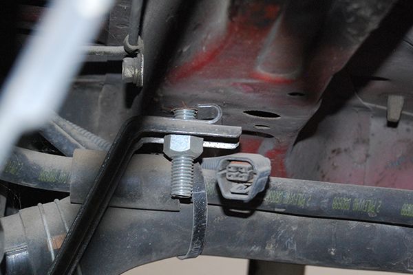

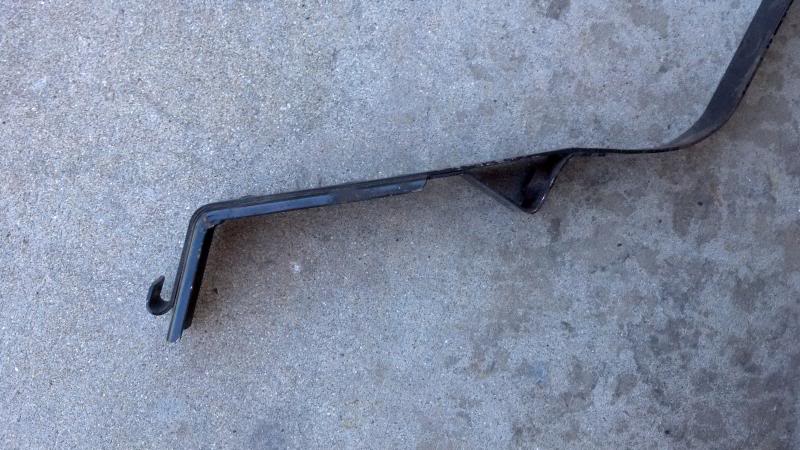

When you get the subframe dropped can you get me a few good pics of the fuel tank strap mounting points. The straps have "hooks" on them where they bolt to the frame under the rear cross member. I have been wondering about what if anything they hook on too.
Said hook thing.
Looks like the "hook" seats up against the back of the bolt and allows some gap between the chassis and the strap.

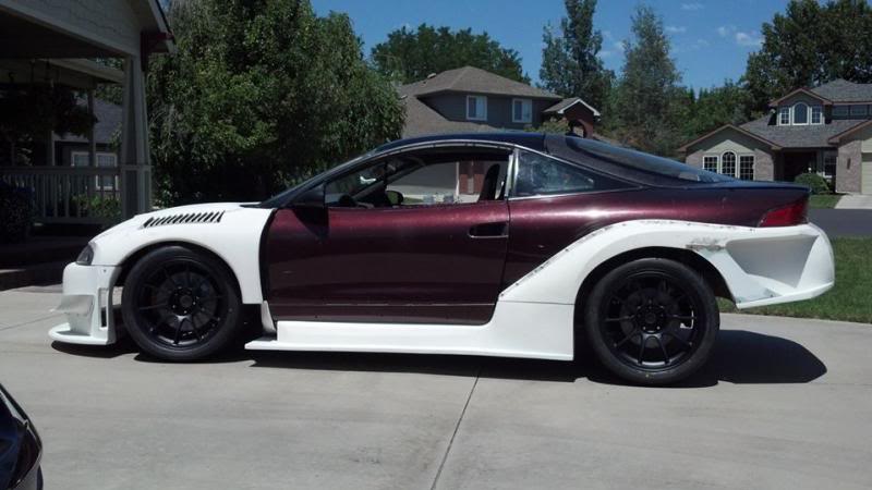

So I'm moving from Idaho all the way down to Texas . To do this I did a decent push to get the car all mocked up and ready for it voyage in a trailer. Here is what I have done.

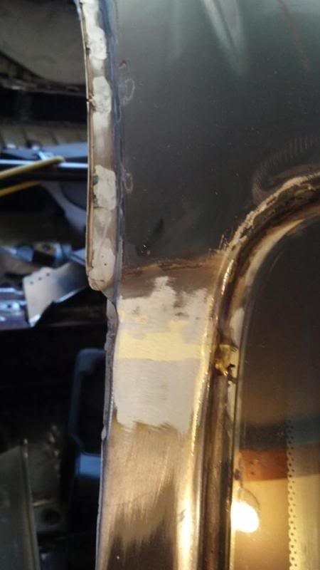

Finally found time to braze the roof skin on.

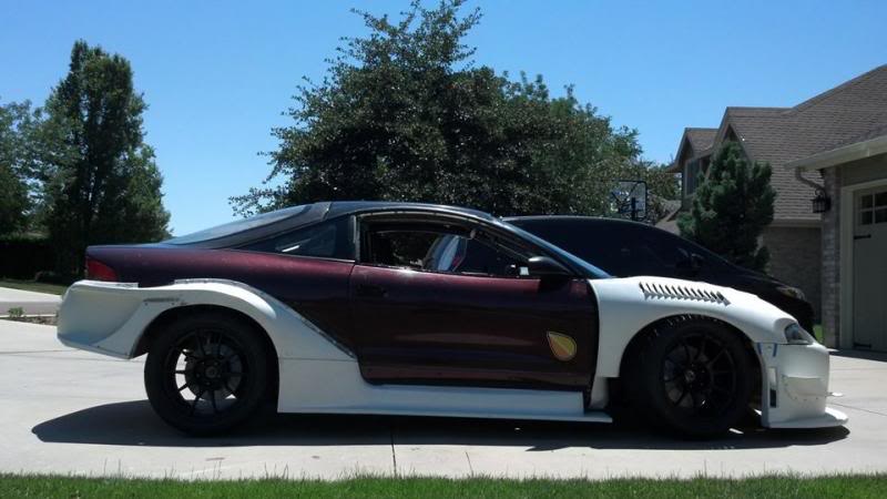

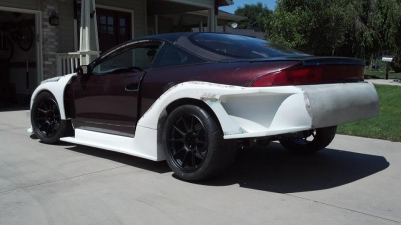

Aero bits where cut out .
Found out that my wheels fit perfect up front. No spacer was need and great clearance on the inside and no poke past the front aero bits. Super happy about that.

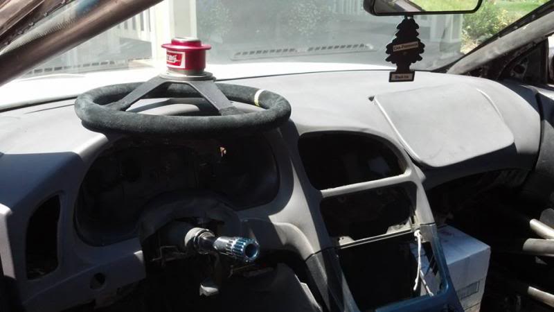

Suspension is all together and the car is on the ground with a good bit of interior in place and steering wheel installed for now. That will be changed up a bit at a later date but for now it looks sweet and turns the wheels. All that left is a quick toe adjustment. Should have my Longacre plate in the next few days for that.
It's a bit rough looking but overall I love the car. :) To bad it will all come apart again when it get to Texas. :ohdamn:

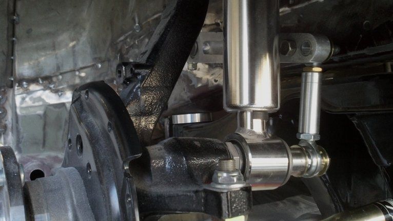

your custom rear sway bar end links are in single shear..... That's not good.... I'd be worried about that bolt failing since threads are stress risers and in cornering you'll be applying a moment to the bolt head basically.
can't wait to see this car done, looking good so far. I'd also be worried about scrub radius as that's what will kill steering rack seals/tie rod ends. Are you converting to spherical/clevis joint there too? I would highly suggest it to eliminate play.
http://www.circletrack.com/howto/ctrp_0511_install_nascar_style_sway_bar/OnUOTE=kayosfrawg;153uing to turn all that rubber? I think i remember reading that the stock rack has trouble with the super wide tires.[/QUOTE]
On the rack. It will handle the tires. Andrew's car is running the OEM rack and John's is as well. The pressure has to be adjusted a bit but that is about all. If it does not work out I'll look for a different unit.
Once we have the new uprights designed and built the tie rod ends will be changed out.
On the end links. yes double shear is always best but itis not always possible or needed.

Unfortunately those are two completely different designs. The design pictured in the nascar link has the pushrod in double shear, with the bolt fixed to the LCA via a nut. The only forces which will be acting on the bolt in single shear will be the swaybar. Most importantly, this design allows the threads of the bolt to be on the "free" end of the two supports and thus see no moment. Obviously since the two supports don't act as true pin connections there is some force in the threaded part of the bolt, but it is considerably less than your set up. Because the threads themselves transfer the force of both the swaybar and the shock/spring (weight, aero, and weight transfer) through to the upright in single shear, there is a large moment developing near the root where the threads are.
I'd imagine the bolt will see some pretty incredible shear forces + moments under acceleration out of high speed steady state cornering. This is definitely one of those better safe than sorry situations in my opinion. Particularly while the car isn't finished and all the designs aren't done.
Test fit of endlinks.
Also it would appear to me that in order to prevent the swaybar from having its motion restricted by the shock, a large spacer is needed. This only exaggerates the problem of moment at the root of the bolt.
That is simply a mock up pic.
The dampner is bolted to the oem stud. That will be welded to the knuckle. The bolt that goes through the rod end only keeps the strut from sliding off the stud and handles only the sway bar loads. Yes there will be a spacer but it is smaller. Again that pic was just a mock up. I had not adjusted the lower control arms. they where simple threaded out and some random left over spacers where thrown on so people could see where this was headed. Most peeps on this site have never seen this type of setup and I just wanted to share.
I didn't mean to be disrespectful or anything, its just something I wouldn't be comfortable with.
The build looks great otherwise. Can't wait to see it running.
I do not take any feed back as disrespectful . I appreciate it. I totally agree it is not ideal . I just wanted to give the best picture I can on what the current plan is. Heck it may change before the cat is done. Packaging is very tight and when this design came about custom uprights where not in the cards. Currently all I have to reply with is phone so my answers may be shorter than normal.
