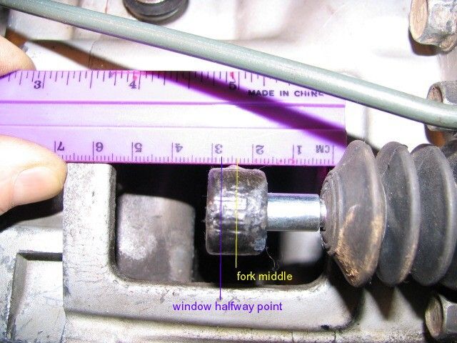

  • Have you inspected the position of the clutch fork like shown below?

Sorry for the late reply but thank you for your suggestions and yes I adjusted the master cylinder just how the video explained and unfortunately I did not change or replace the clutch fork . After adjusting the clutch still no gears will go in. Only first but you need to force it in .
