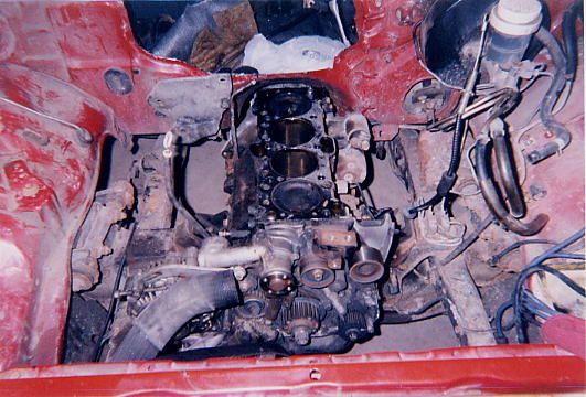

the G4CS is in its home, my DSM :hellyeah::rocks::thumb:
