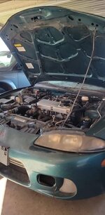

Got the car only had evap code and 02 sensor code. Added hose clamps on the loose vacuum lines and reattached a ground (will post picture of the ground that got reconnected) then I got the 02 sensor code and the fma code. Checked the vac lines I could follow. I dont have a vacuum diagram to check them all. No cracks or breaks that I could see and no loose fittings. Then I got the misfire codes removed and reattached plug wires from coil pack and plugs. I will be testing the coil pack this afternoon. The misfire code went away but it has a very rough idle and you can tell it's missing but not sending misfire codes anymore.
