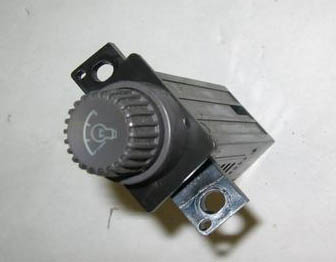

Did someone ever mess with the potentiometer on the dimmer switch? It also could be that it broke I grabed and extra one incase mine ever craps out or the bulbs are going out , what's your voltage at when the cars running?
This is for a 1g unsure what dsm your rock'n :rocks:
Here's a picture it's that little brown thing on my spare dimmer it's All the way to the right on mine

I'm not familiar with 2gs but what you can do is test the dimmer switches resistance if it stops increasing in ohms as you turn down the lights ( viseversa) or if the resistance doesn't change than you have a bad switch you can test this out of the vehicle although I do recommend you unplug the (-) negative terminal just to be safe when you remove it,

The 2g dimmer switch is not a potentiometer so resistance tests are meaningless.
To test dash lights, unplug the dimmer switch connector under the dash. It should be a 4 pin inline connector with 3 wires on it - black with yellow stripe, black, and green with white stripe. On the harness side plug, jumper the black with yellow stripe wire to the black wire. The dash lights should now go on full when taillights are on.
For dimmer functionality: When you find out just how expensive a new 2g dimmer is (which is different than the 1g one), you may decide to just stay with this fix (or go used).
