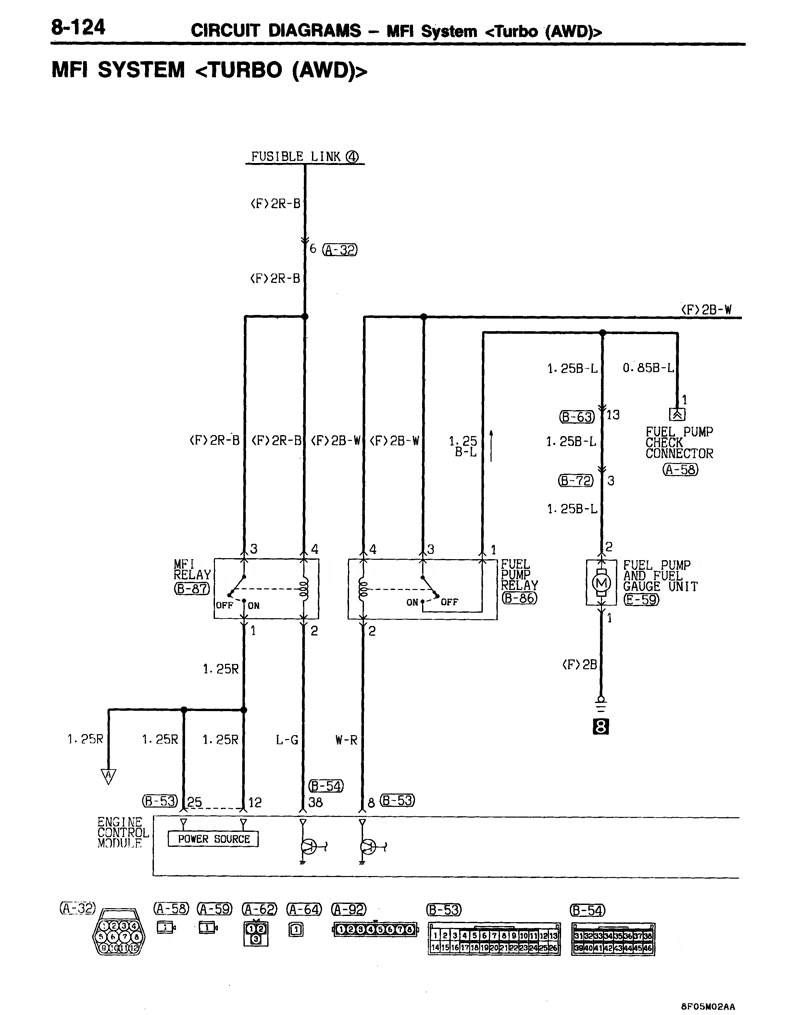

IF you need more info on the MPI and fuel pump relays,
take a loook at this nicely done write up by steve
it has helped millions of people :thumb:
Thanks that’s exactly what I needed So Iam not getting 12v on pins # 3 and 4 red/black MFI side but I do have 12v on fuel pump relay black/white wires #’s 3 and 4 it looks like I have two A-32 connectors under my hood how do I know witch one is correct?
if your not getting power to 3 and 4 on the MPI relay, check fusible link #4
check here for info on iidentifing 2g engine bay connectors
This is very helpful because I might have the wrong connection where a-32 goes. There was a similar plug that also fit. let me check and I’ll let you know. The fuse 4 is good so I think I just have the wrong plug, I’ll switch it and see how things play out.
