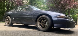

Very nice, looking really good! Any new numbers to share?
Thanks! Nothing new to share though. Still collecting parts for the new hotness. I sold the 40R and replaced it with an HX52.
