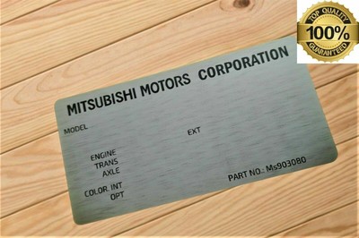

My plastic code plate, located on the left side of the engine, felt off due to the time.
I still have it, and want to make a new one.
The thing is that all the information disepeared, and I don't find
  • interior code
  • equipment code
  • exterior code
Do you know where I can find these ?
My car is a 2G eclipse GST, imported from the US (I'm in France) in 1996.
Thanks for your help !
Thibault

As it's an imported car, I need to do a full approval for the car, which of course starts by identify the car.
I have the VIN number marked on the right side under the hood and this is the only "non removal" proof on the car, but this is not stock apparently and has been added in Europe.
What I'm gonna do is just replacing the old stocker plate by an aluminium one, which I will rivet so that it"ll appear stock.
But in order to do that, I need the infos I miss the
  • interior code
  • equipment code
  • exterior code

Hi Steve, yes indeed, the picture I put in my post comes from the owner's manual, and there any information about the ext/equipment/int code, juste the picture..
I tried to find on the Internet, nothing..
The best would be to find someone having the exact same car to know what numbers he has.
Thanks for your help :)
