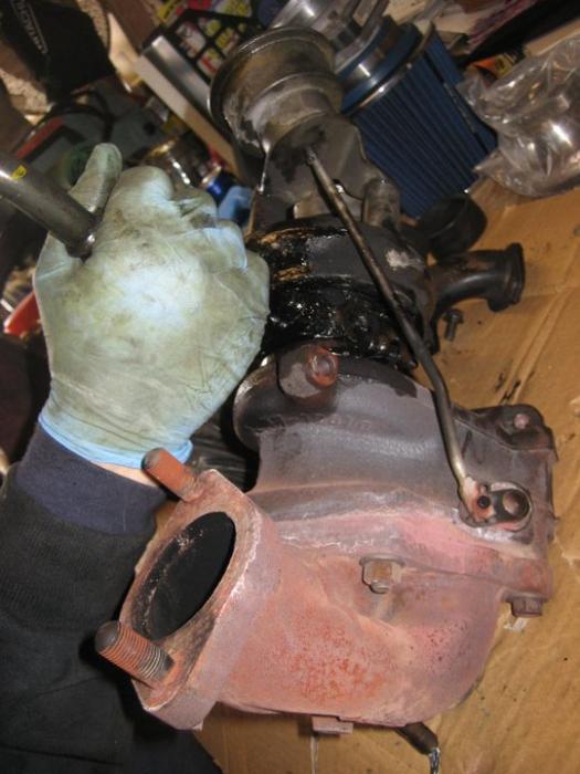

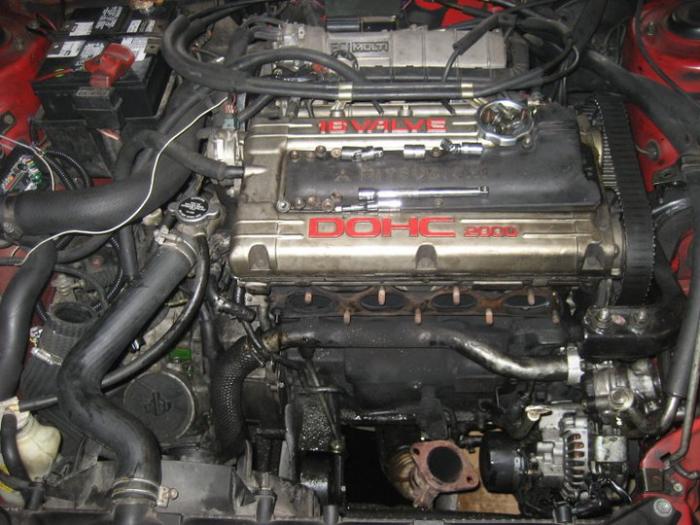

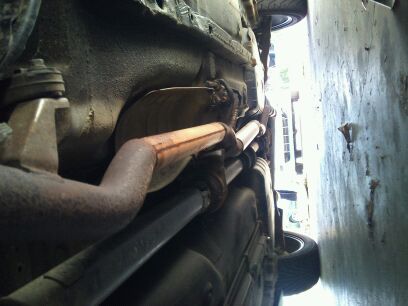

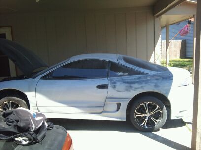

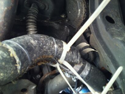

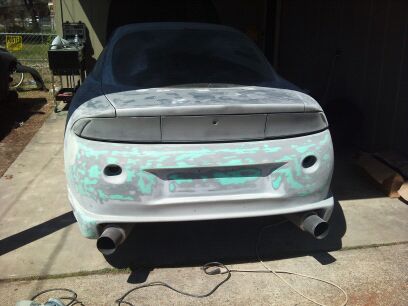

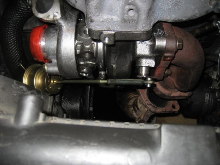

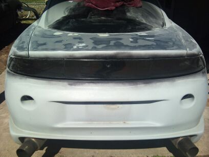

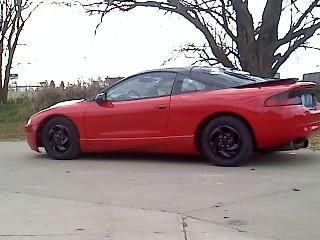

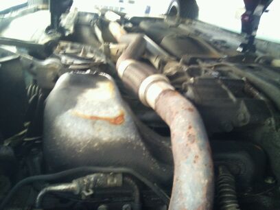

Well I just about finished up my 92 build using megasquirt 2 ems and the holset hx52. I wont be tuning it until spring, but all i can say is 4psi on this turbo right now, feels like a decent 16g car. :D
Here are some pictures:
There are still a few small odds and ends to really finish it but you get the picture!
All i can say is wow. Looks very nice. I plan on a hx40 swap this winter as well. Im corious about using the stock coils? Do you plan on a cop set up or anything?
PLEASE tell me, you arent dumping with no wastegate pipes??? For heavens sake. Does look nice though.
James
No worries, the wastegates won't be opening until spring when I start tuning which then I will have the dump tubes LOL.
Manifold is a JHR manifold (JH Racing)
Stock coils are perfectly fine for this setup.
Yes 10psi by 4800 is good with me. Leaves me with a nice long powerband.
Beautiful setup can't wait to see more pics and when you get this baby tuned up. I have an hx 40 in my eclipse and I almost done just a few tweaks tunning and I will be there. Good Luck and everything looks sweet
