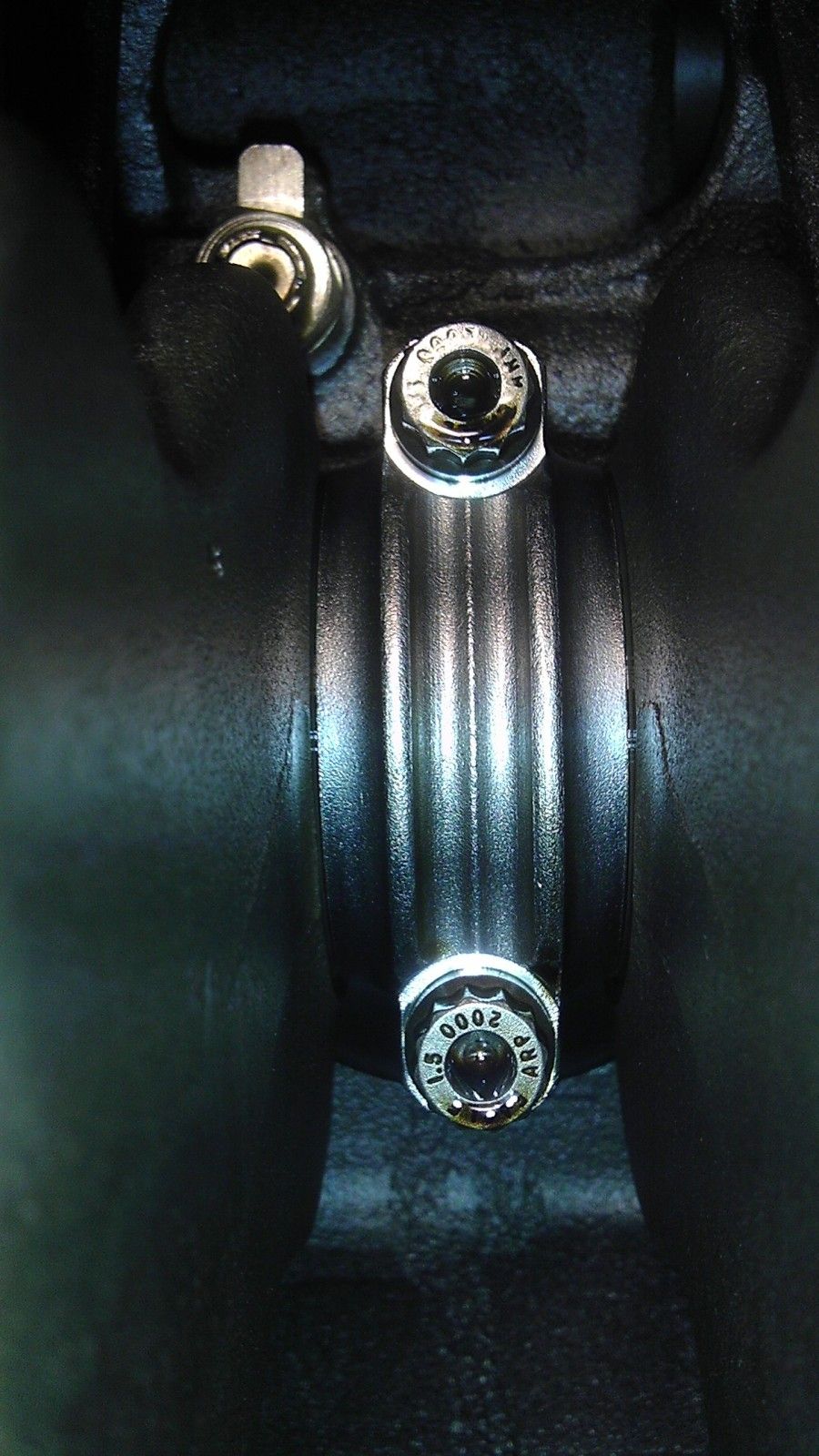

So I'm tired of the all to common honda swaps, been there done that. Time to try something new, I wanna stick with a 4 cylinder platform and I've seen over and over again, 4g63's braking records. So i wanna see for myself what all the fuss is about LOL. I'm not going for any records or 1,000 hp track monsters my goal is a simple 600hp weekend car. Luckily my brother kept his 97 red gsx after purchasing a 2006 lancer evolution, so i bought his gsx for a very cheap price.
Here is the list of what i have so far:
Head:
Mild port and polished
Brian crower springs oem retainers
Stainless valves bronze valve guides
Brian crower 280`s
Arp head studs
Greddy timing belt
Block:
Micropolished crank
Torque plated
Wiseco .40 (9.1 cp)
Eagle rods
Acl race main and rod bearings
Balanced shaft removed
4 layer cometic mls head gasket
Drivetrain:
Shep stage 4 tranny(welded diff.)
Rebuilt rear lsd diff.
Stock axles all around
ACT chromoly flywheel
ACT 2900 6 puck sprung disc
Turbo:
HTA gt3582
Punishment race bottom mount manifold
Fp 4inch turbo intake
Tial 38mm waste gate
Fuel:
Bosch 1600 injectors
Walbro 255
Bosch 044 external fuel pump
Fpr fuel regulator
F.I.C fuel rail
Electronics:
Aem ems
Aem uago
Other:
Jmf intake manifold
Slowboy racing short route intercooler
polyurethane motor mounts
Xs power dual stage boost controller
Apexi 3inch turbo back
Cop ignition packs
I mite be missing a few things and if you see anything wrong please let me know, this is my first dsm build so any advice would help thanks for looking

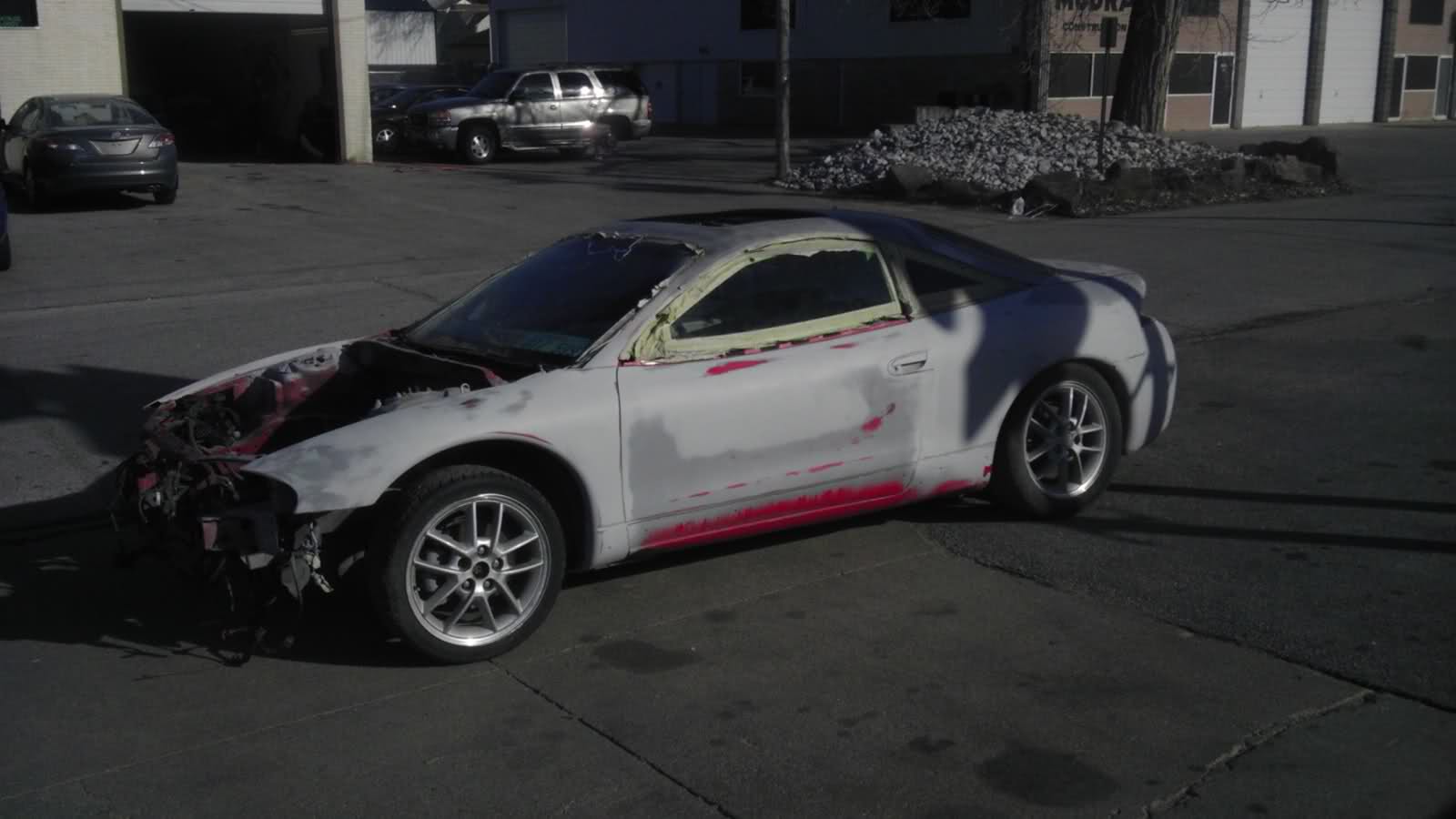

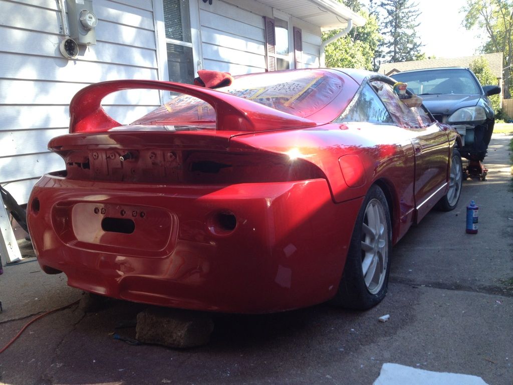

My old turbo hatch

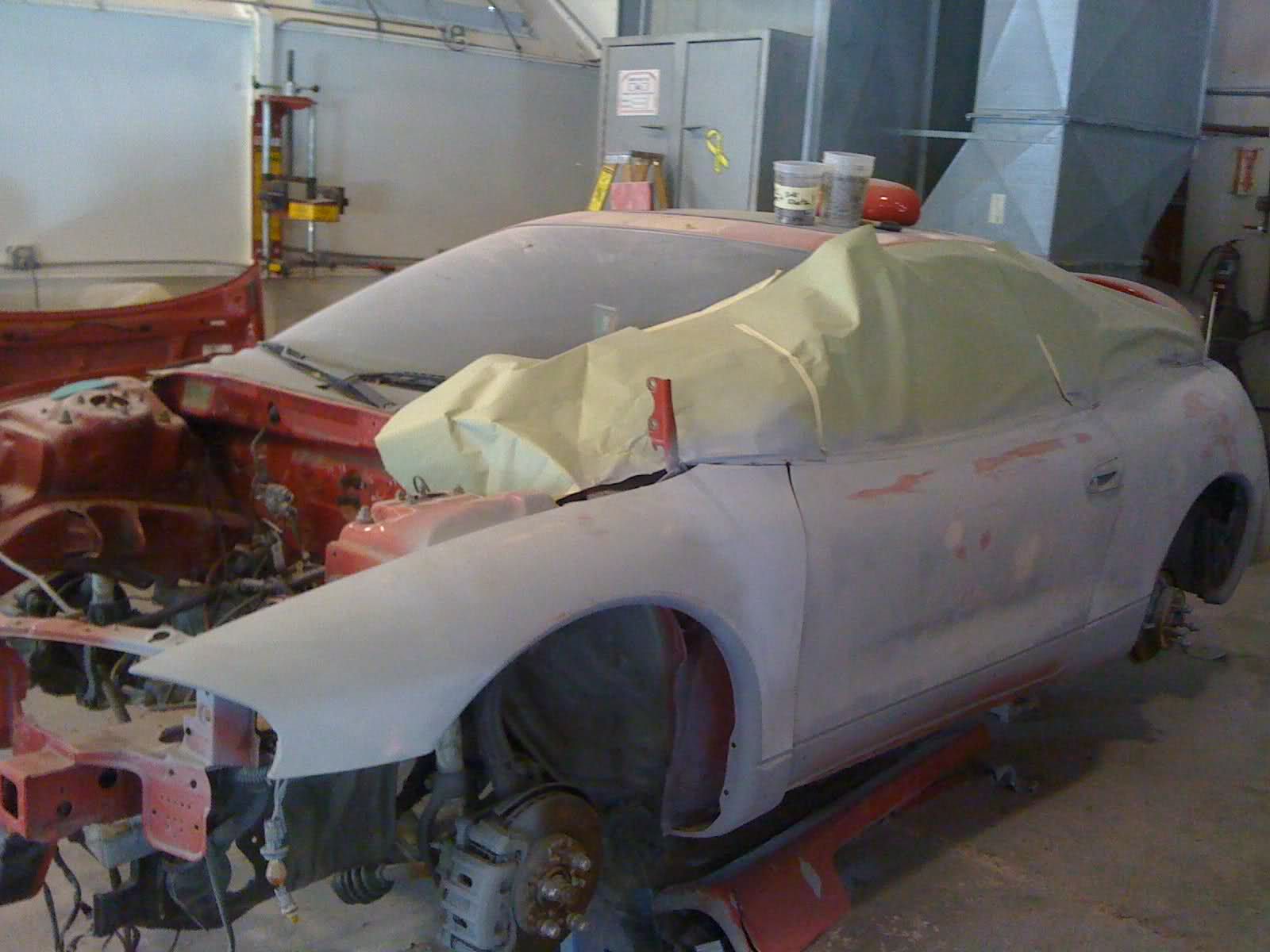

Picked up a 97 red 2g shell

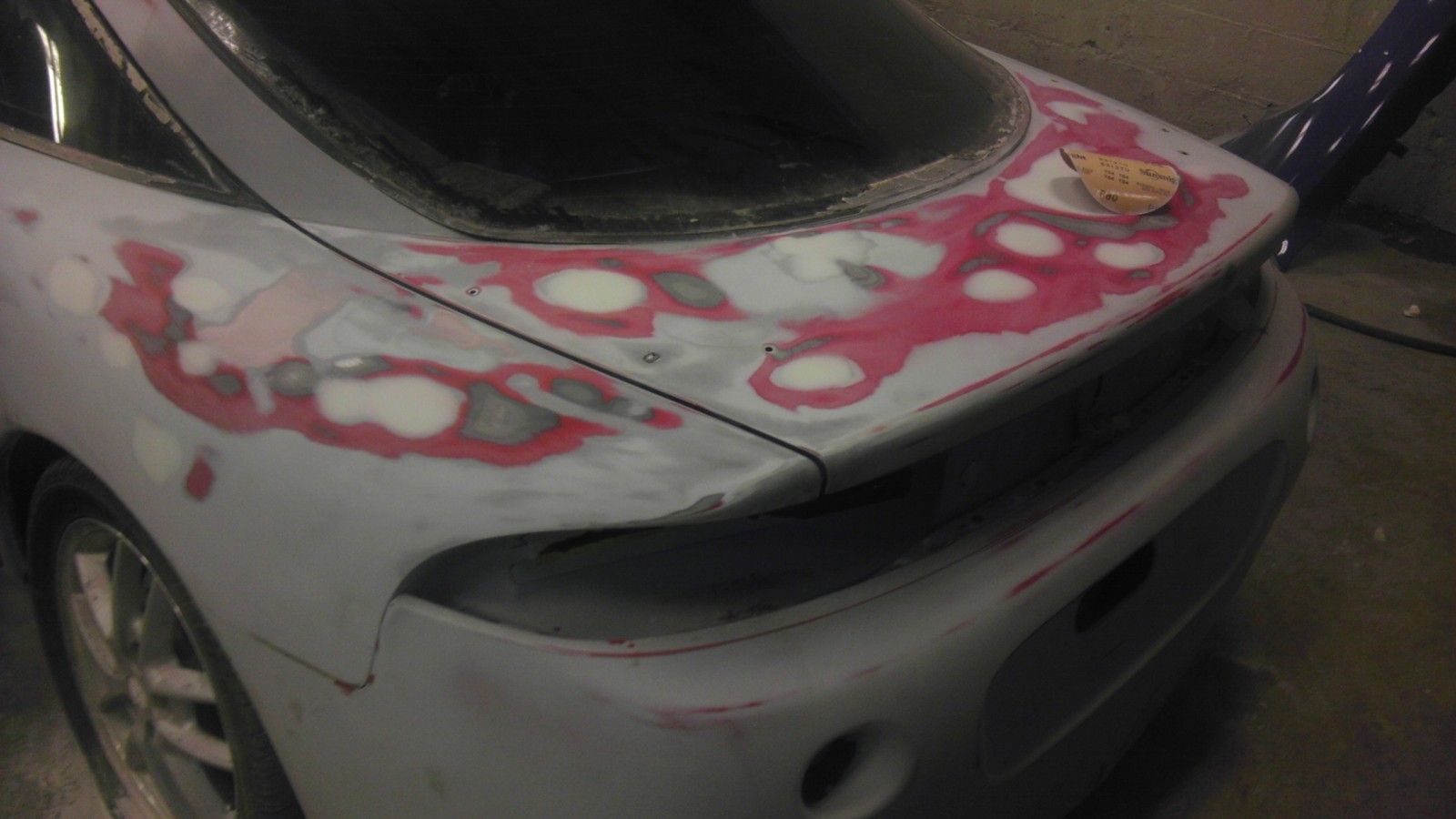

Some body work

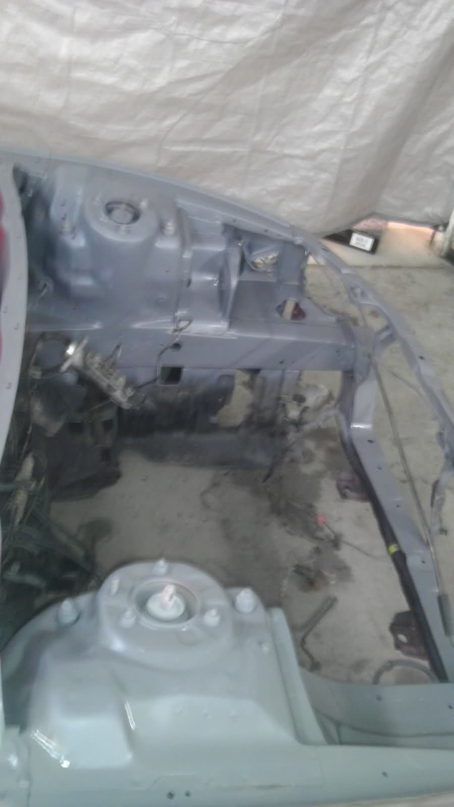

Stripped the engine bay and getting it ready for paint. I wanna shave off all the holes in the engine bay but i dont know which ones to delete?
Looks good man, just passed that stage myself with my 2g, although I did the engine and all before bodywork.
Hopefully your able to retain most of the stuff from your 1g and toss it into this motor
I"m here in omaha too, would love to see the car in person sometime, should be a nice build

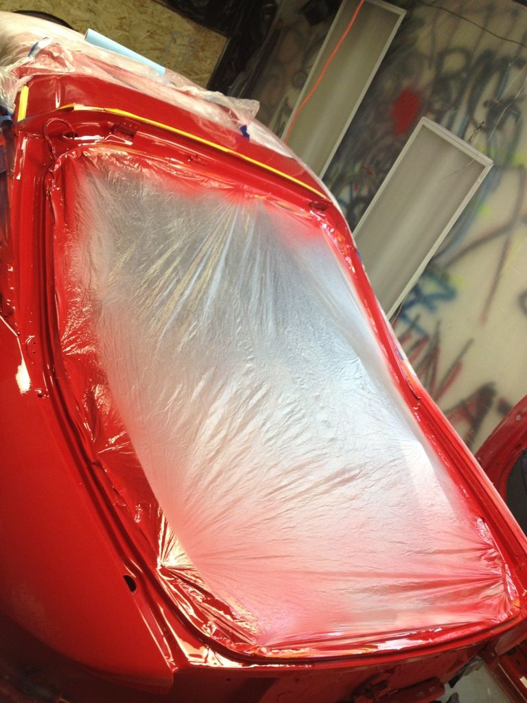

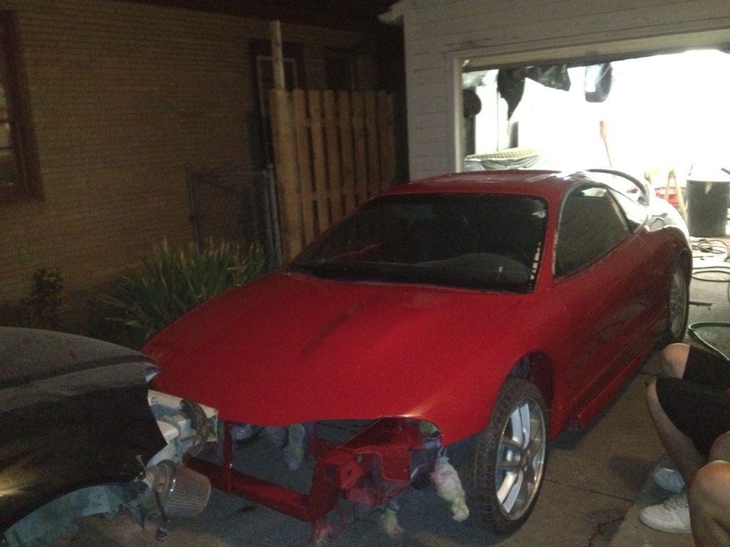

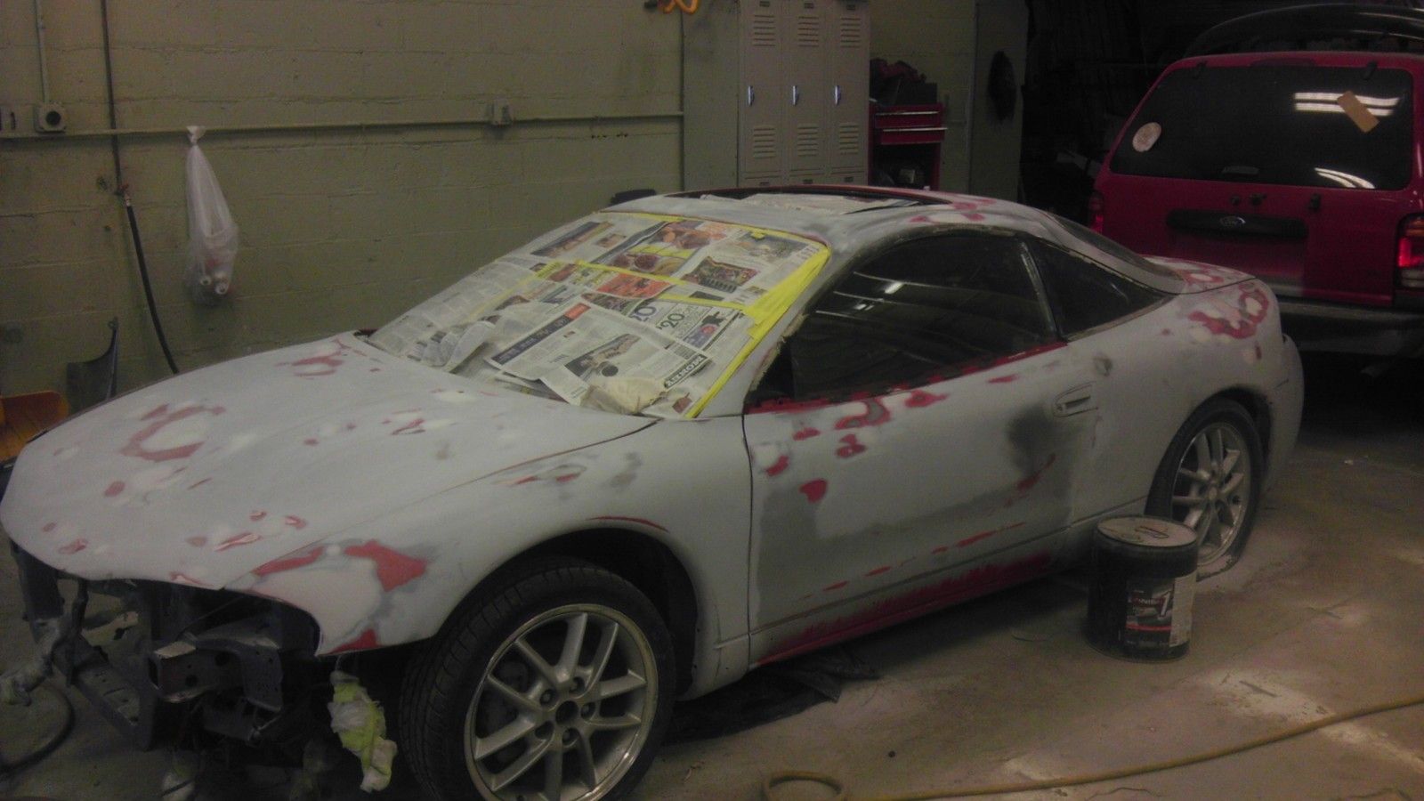

Here are some updates on my build. Been busy with work and school. Here are some updates on the body its self
Shaved off the antenna and rear wiper arm

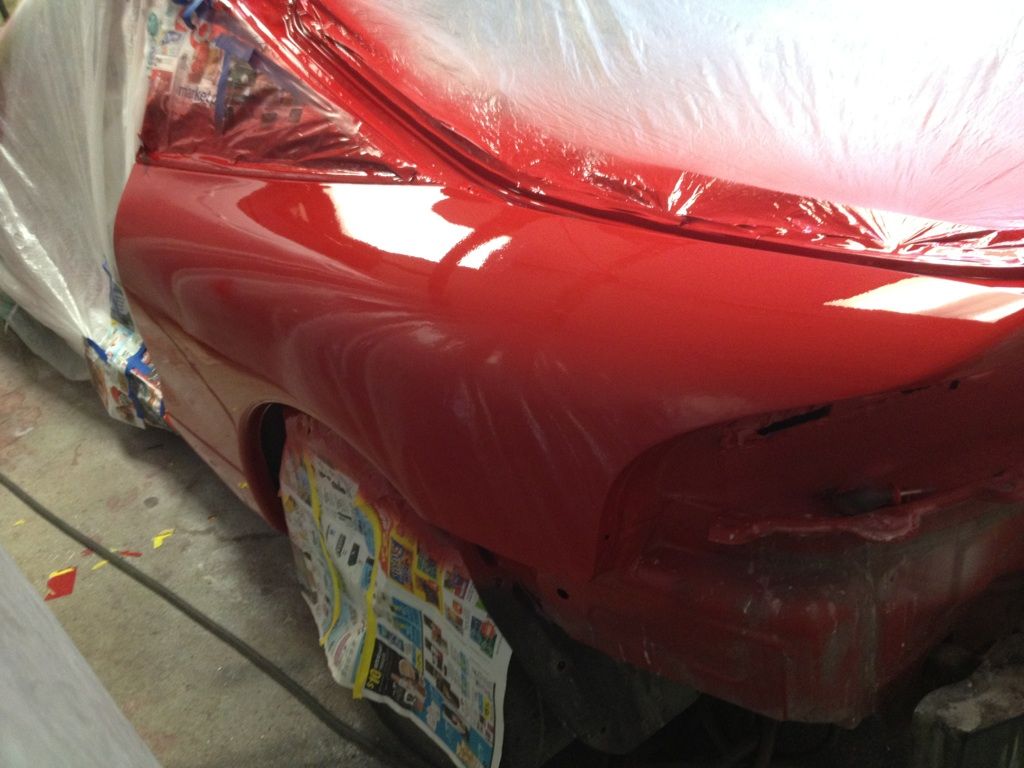

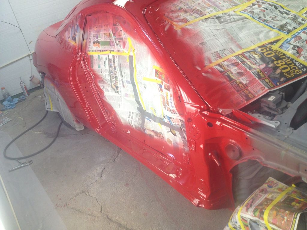

Rally red paint job

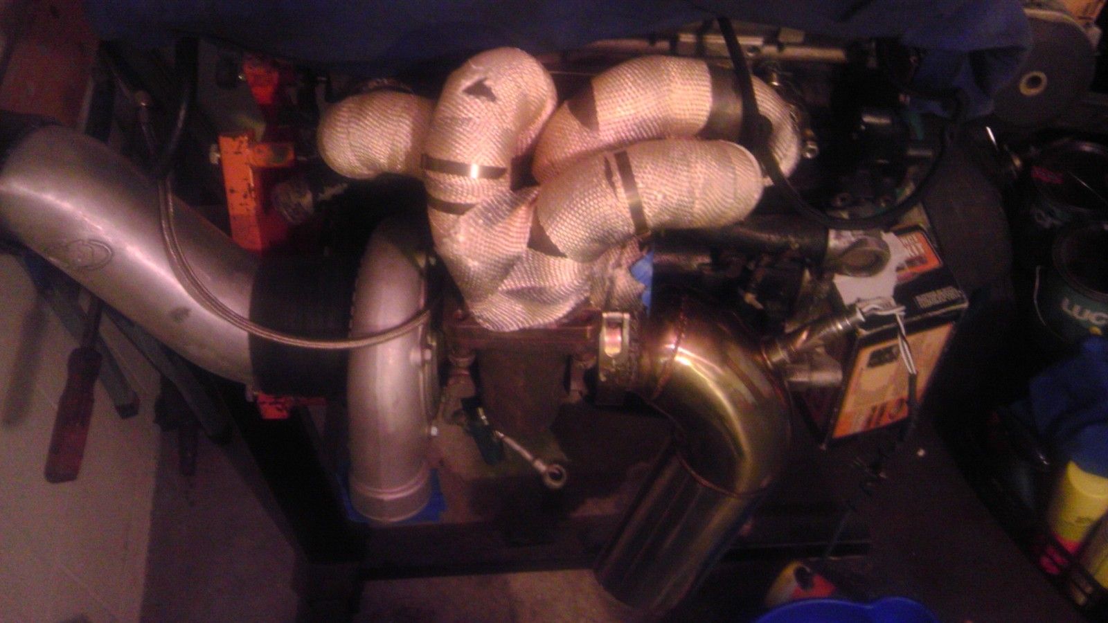

HTA gt3582 turbo kit

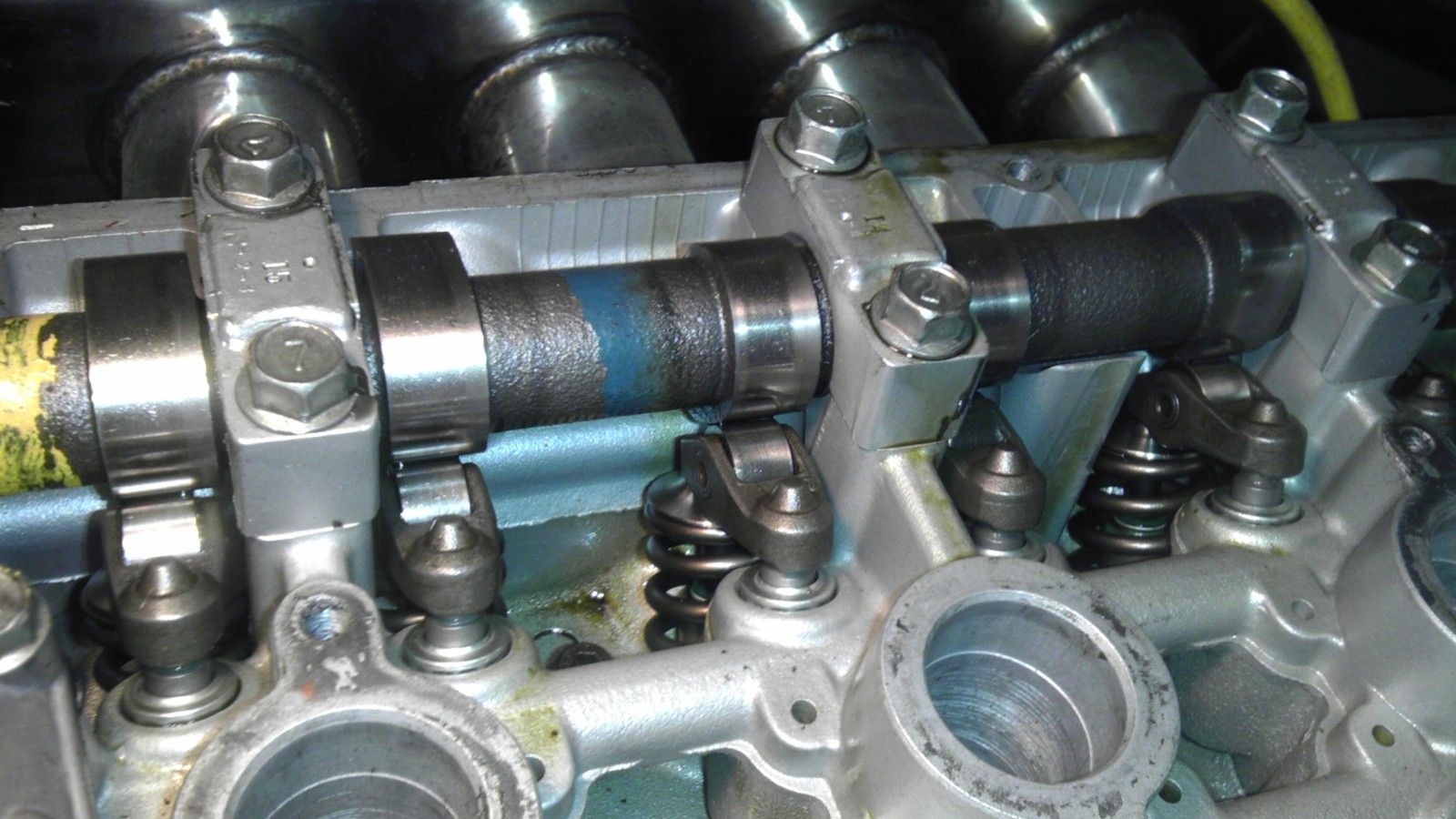

So I picked this engine up some time ago and its been sitting for about 4 years, counting the year ive had it. Looks good to me but my question is, can i fire it rite up when installed or do i have to do something to it for the long time wait???
