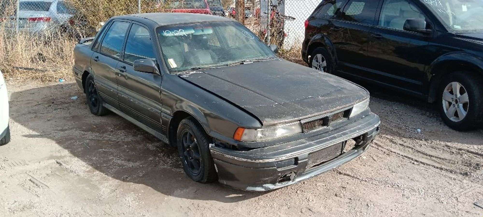

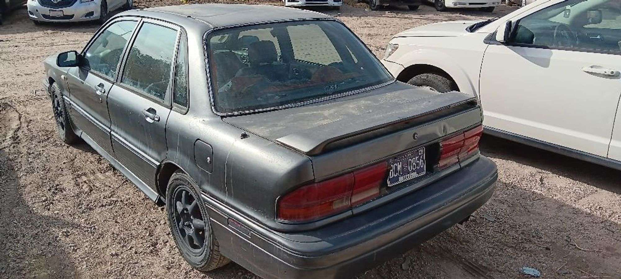

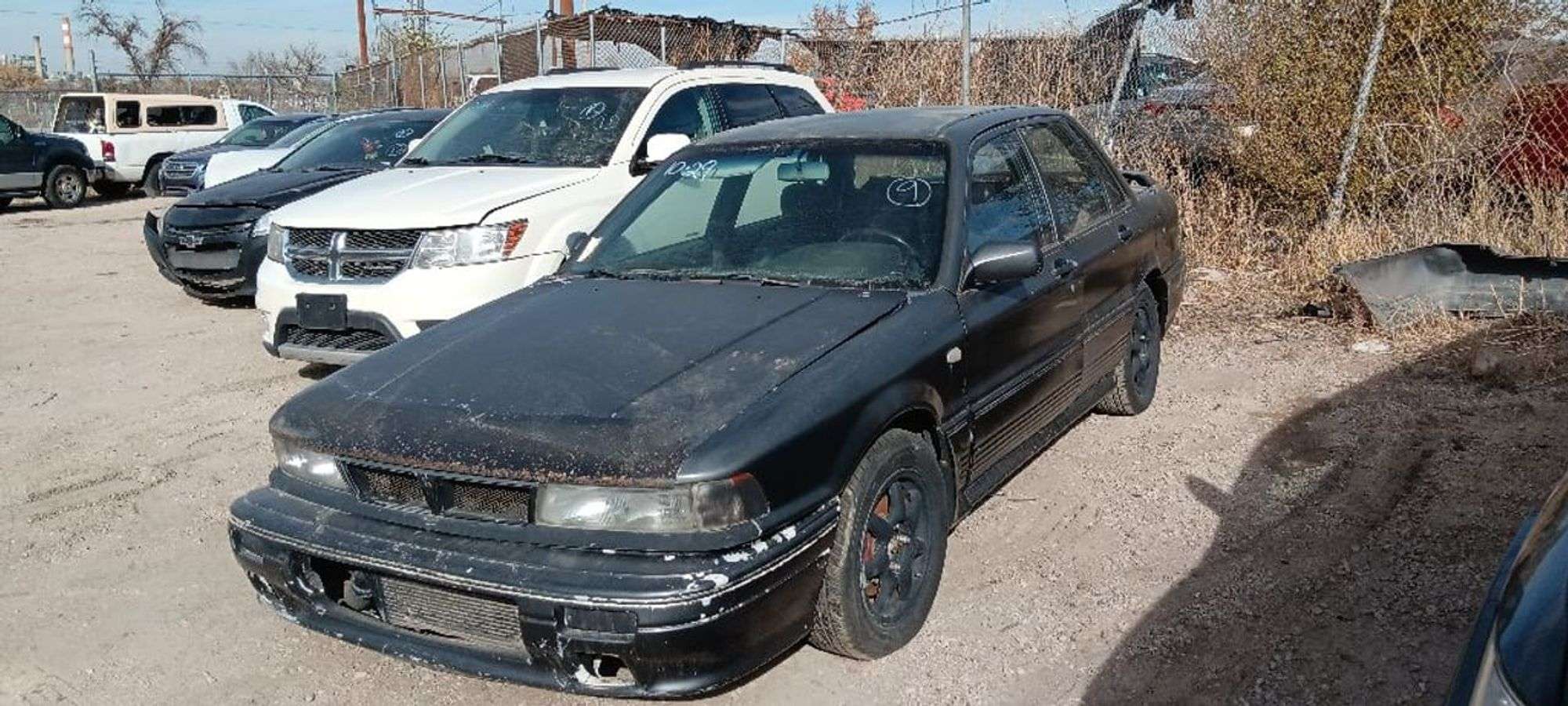

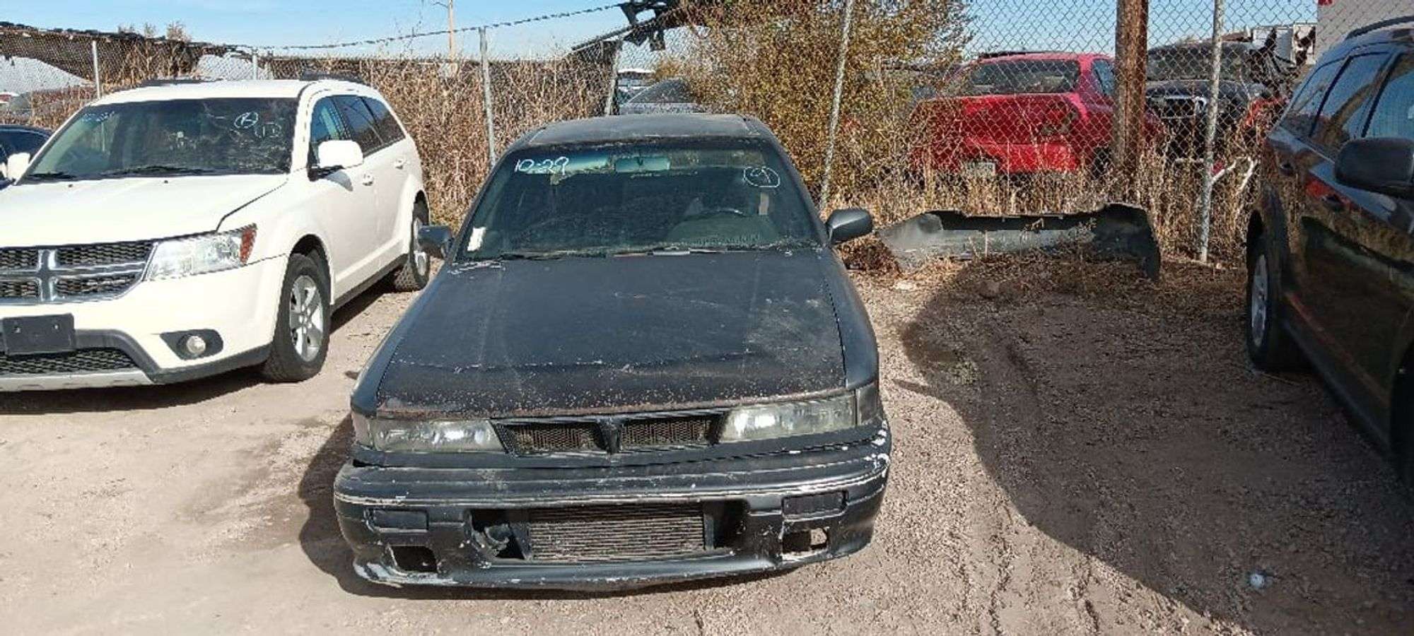

Everyone, meet Gary, the grey Galant. A poor abandoned Galant vr4 that was sadly, unloved. Picked up by a tow company, sat in their yard for a while and eventially sold to your's truly.
Initally called the sh!tbox, because that's what i was, I eventually became fond of this turd and started to call it "Gary"
It was grey, or rather gray. But both were a play on "Gary". So it stuck.
This was the first auction car i had ever purchased. Unprepared and unaware, i still managed to finagle this turd out of the auction yard without damaging my truck or trailer.

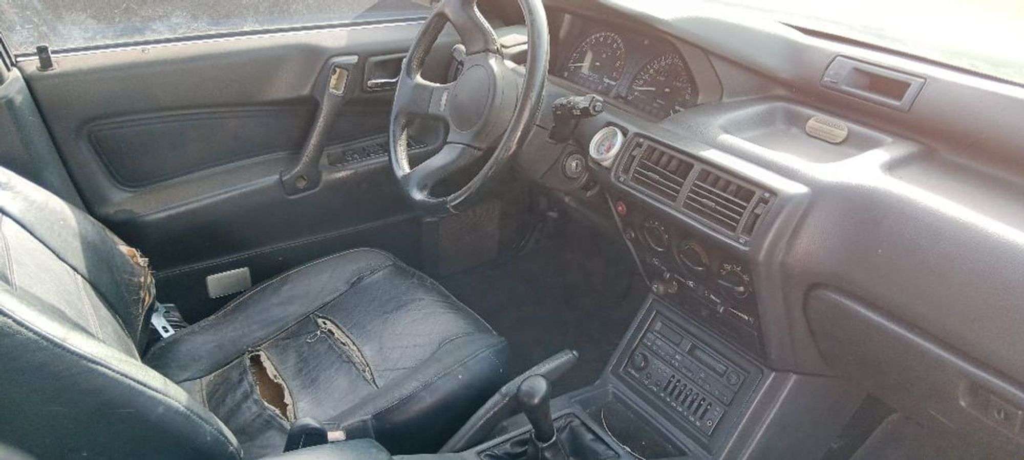

Once aquired, the inspection began. Sooooooo much sun damage.
The paint? cracked and worn, the rear seats? literally the fabric cracked, peeling, melted and well... gone.

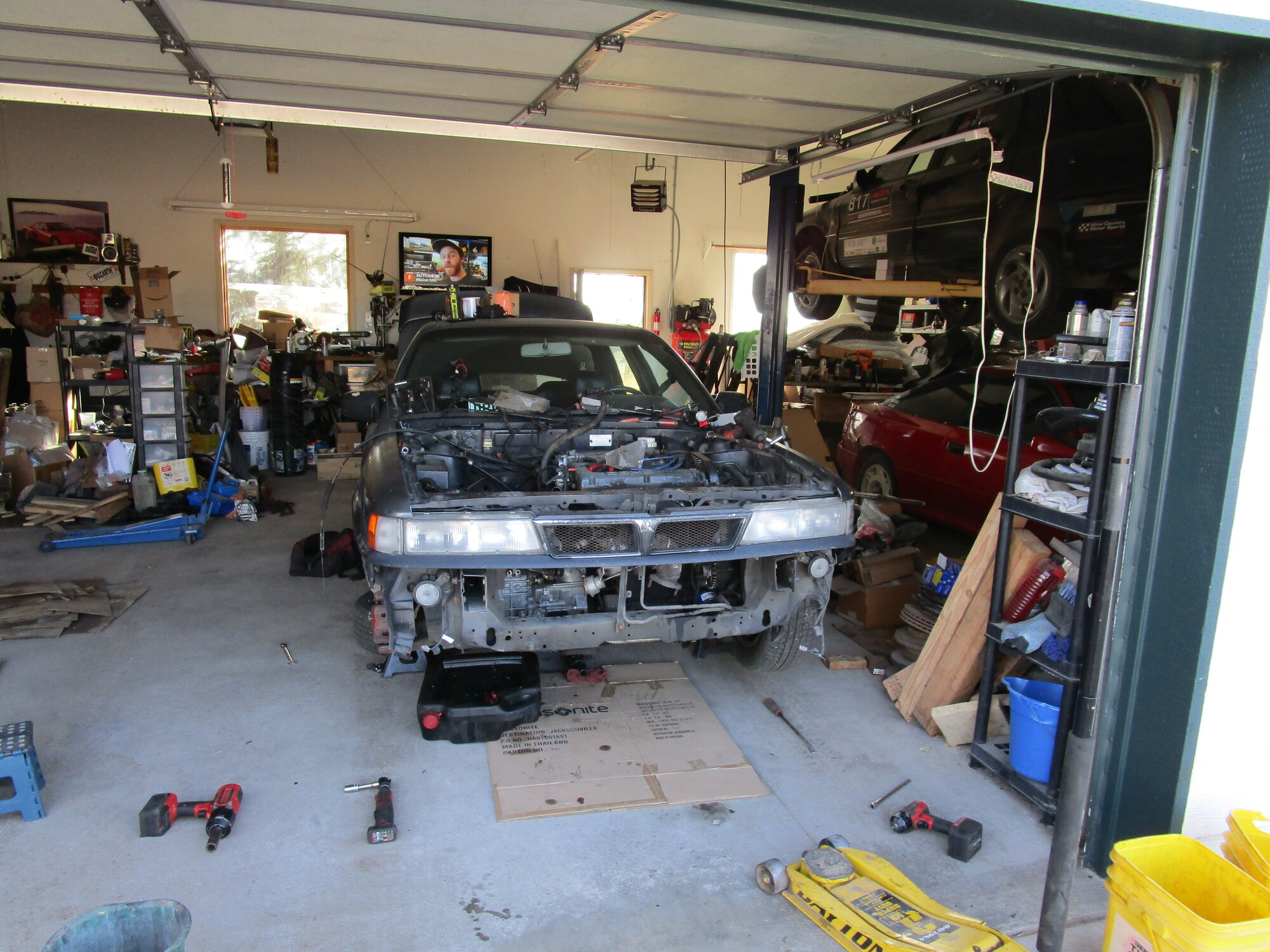

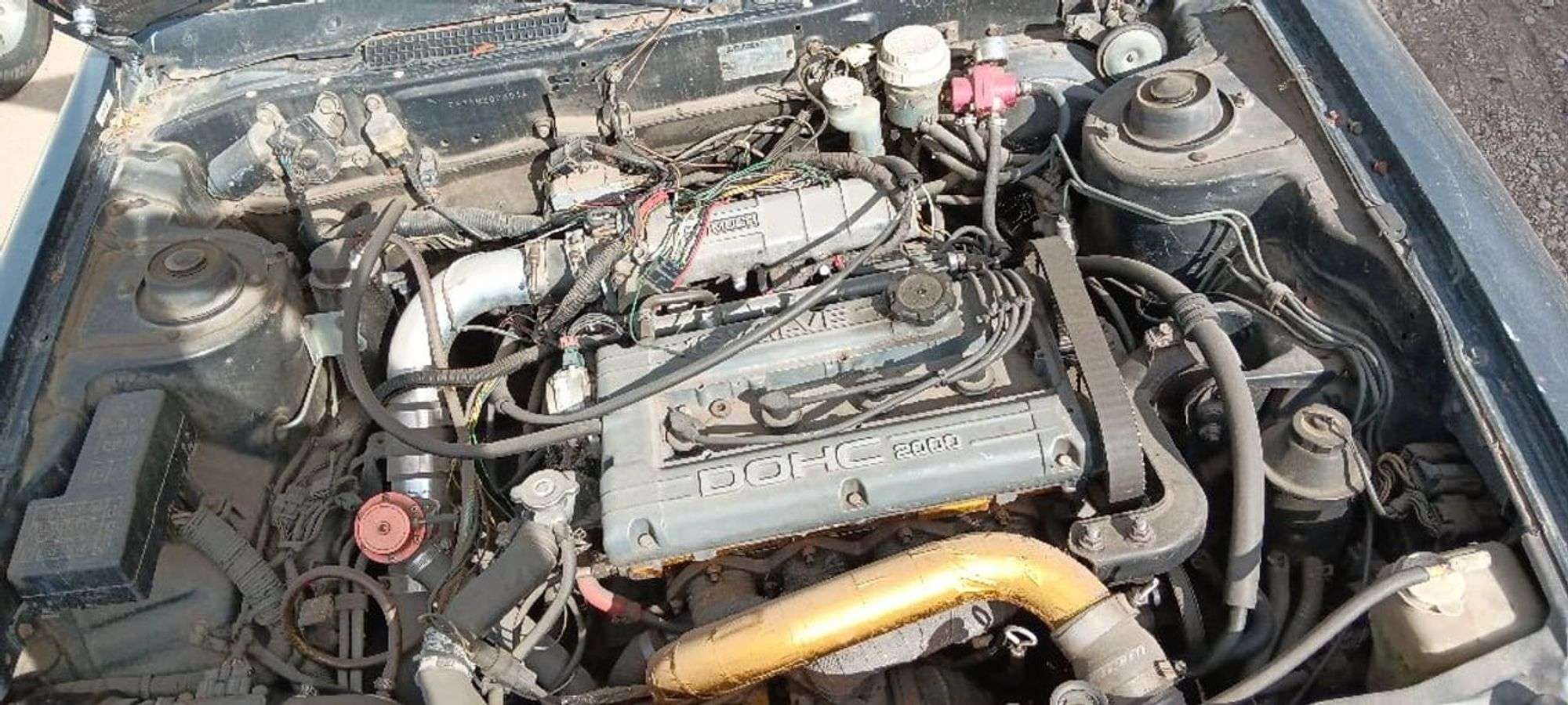

I didn't get the initial engine bay picture, but just imagine the typical 4g63, maf intake, fmic, no ac and battery relocation- good? Too bad, because that's all you're getting because i don't have true "before" shot. Only several steps in.

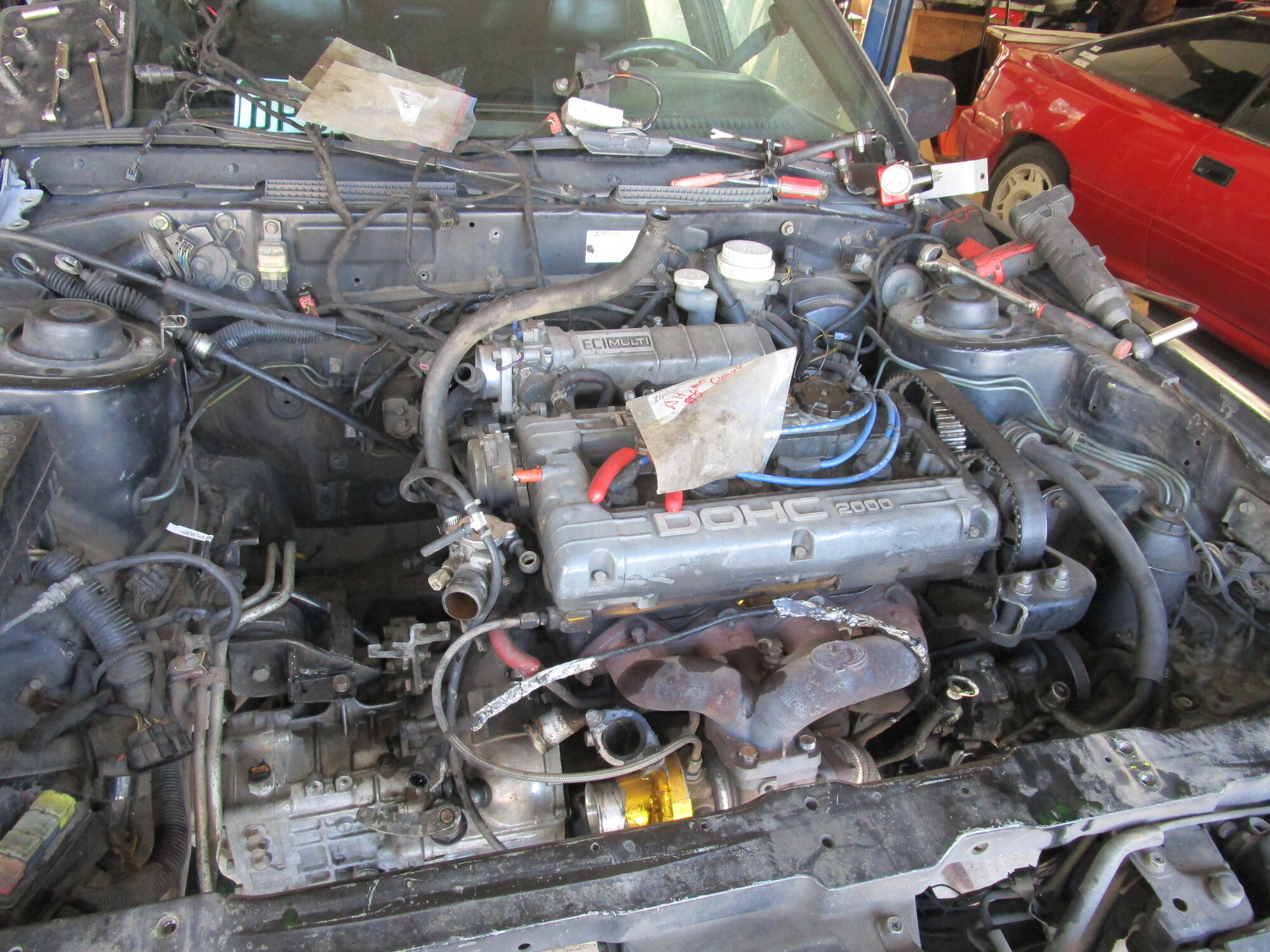

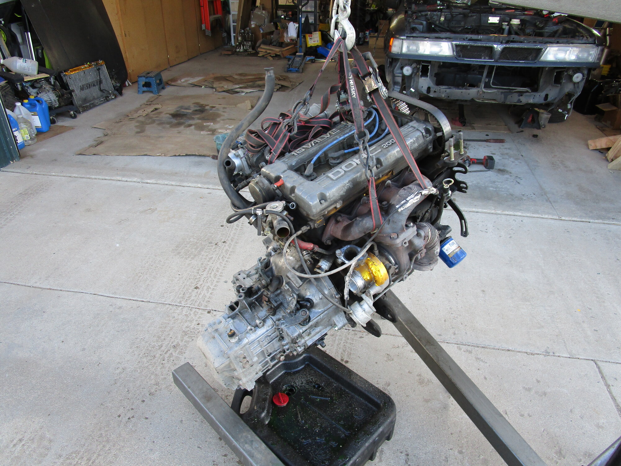

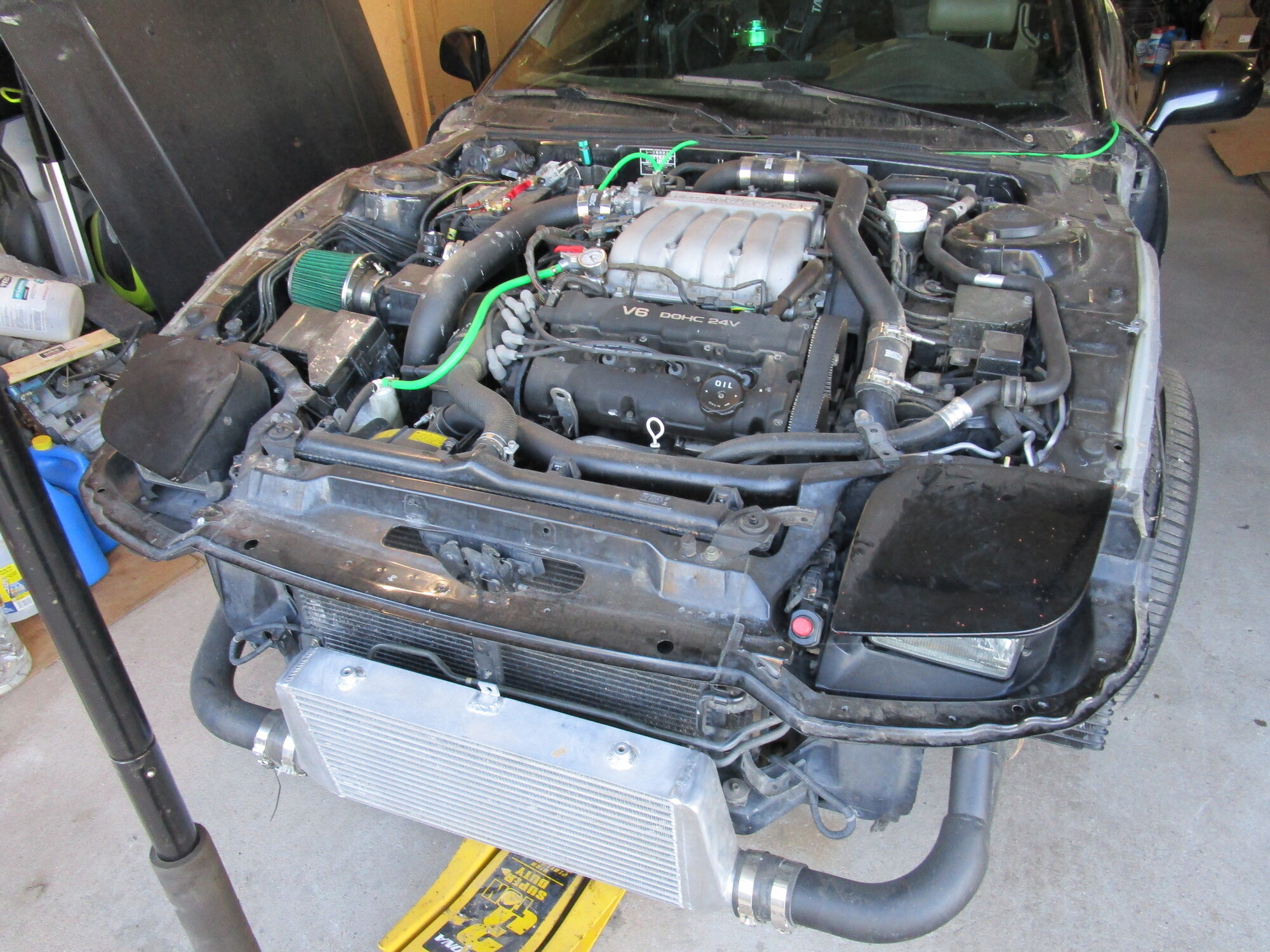

Take engine out. Get sneaky photo of 4g sitting outside and 6g still in engine bay, peaking over.

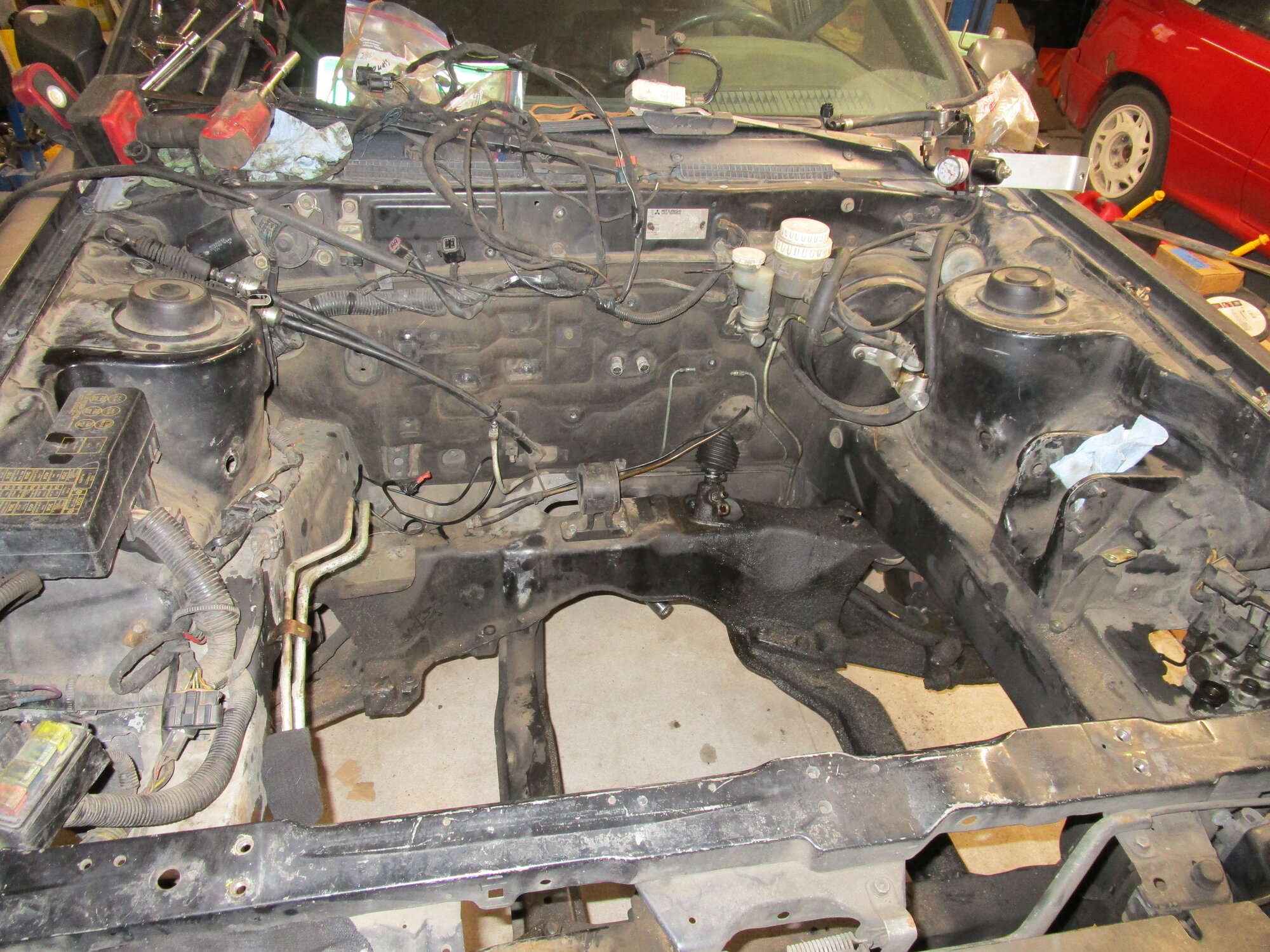

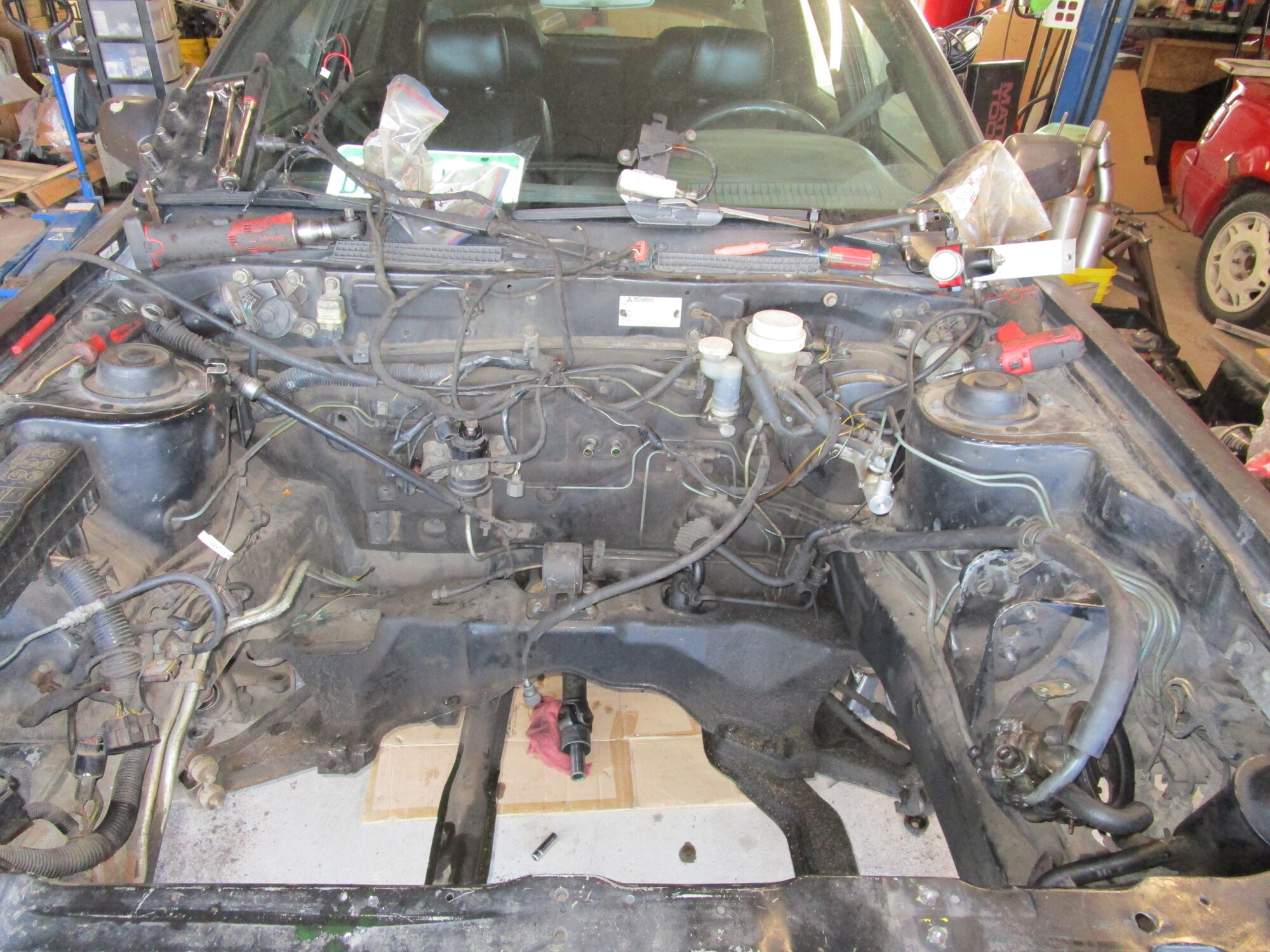

Take out ABS- the FMIC that the stealf has runs right where the GVR4 abs unit is. Good thing it does work. Custom brake lines are easy. Out it comes.
Then take out power steering. Two options- electric assist or make the stealf unit work.

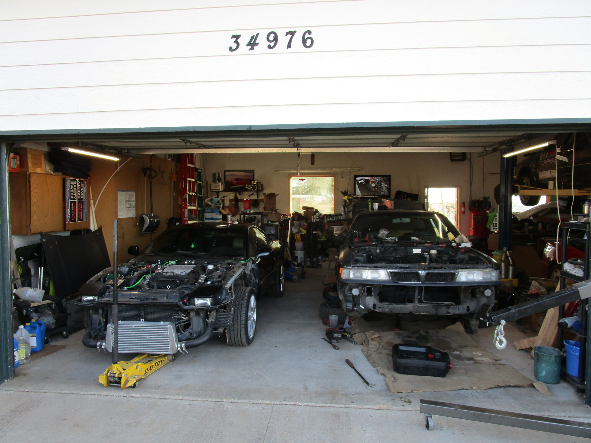

Get sneaky photo of two together.

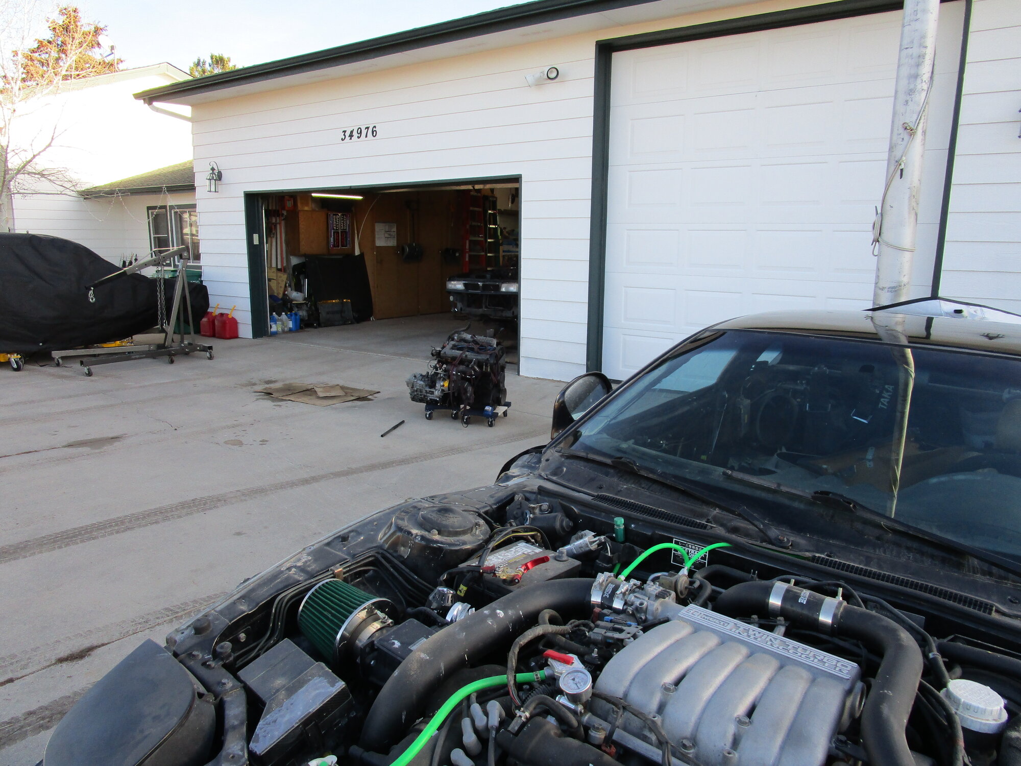

Take engine out of stealf.
Proceed to question life.

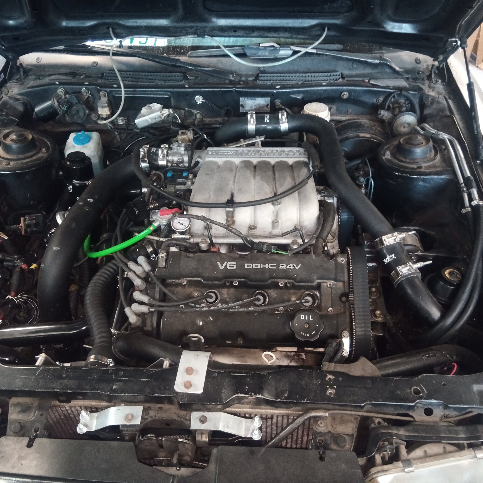

It drops it- not fits, it drops in. Tight, but doable. This is with the Getrac.

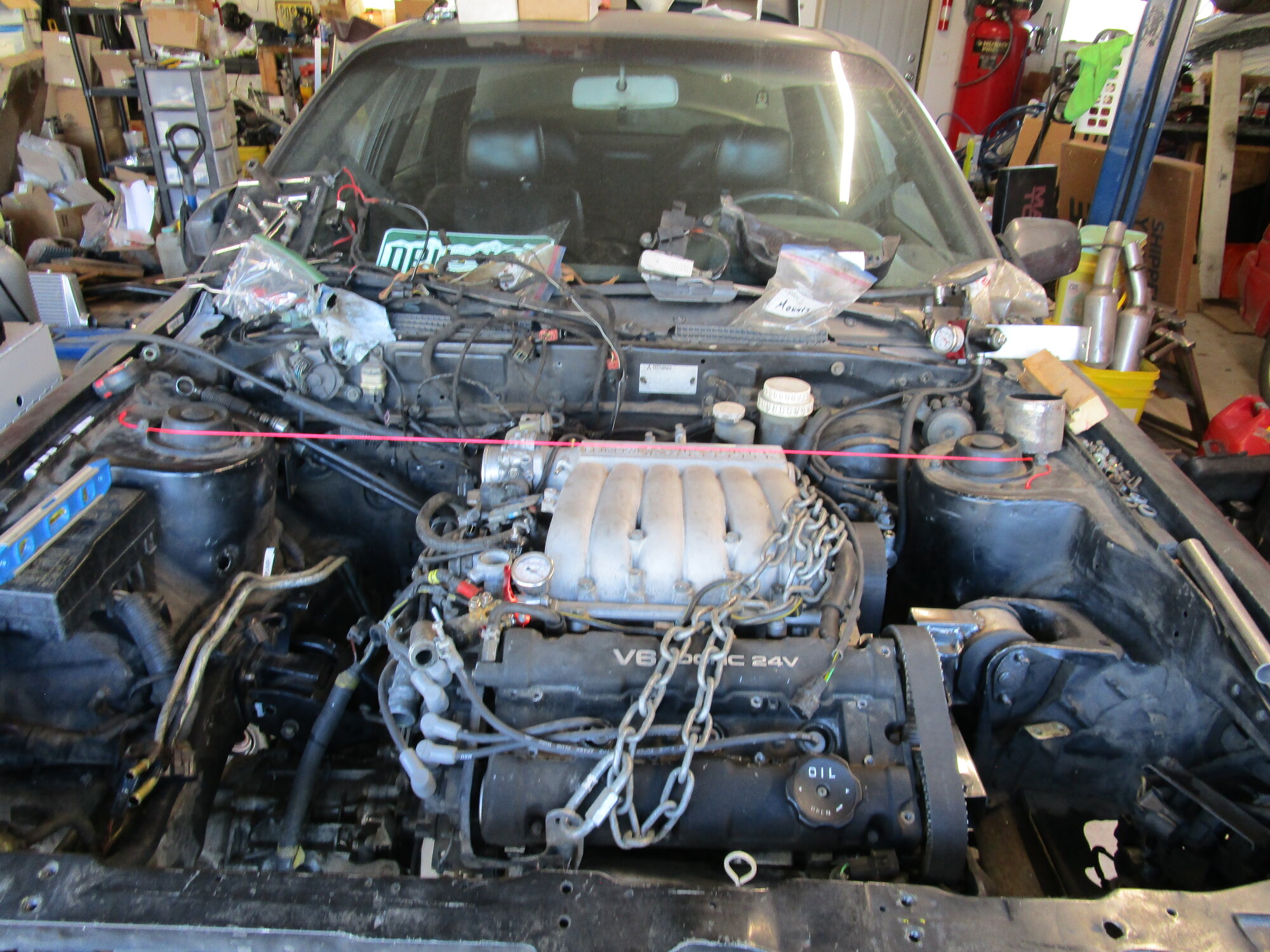

Shimmy around, add my trusty screw jack to one side, the hydraulic floor jack on the other. Get it roughly where it is supposed to be. Measure timing belt side to frame referencing rally car. I found a neat thing: the 6g rear mount bolt hole is just about perfect with the galant rear mount. The engine mount is fully up against the right of the mount, but thats ok, a small spacer or proper acetal mount and we're golden. Slam a bolt in.
I used a piece of string from one strut tower to the other to line up the engine parallel to the body.

I eventually removed the front crossmember and used some wood directly on the front engine mount bracket and lifted/lowered the engine to set tilt. I used a level on the radiator cap to set the engine tilt using my other examples. I eventually popped on the t-case as well to make sure it wasn't pointed up or down.
Then, made a driver side mount. With 3 mounts, we were able to remove the engine hoist and hang it for the first time.
Then, remove the engine for the rest of the mods needed to make this silly project work. Next time.
Somehow, it looks less cramped than a 3000gt engine bay.
Probably due to the fact so much is missing: The 3k bay would normally still have the battery, the clutch booster pipes, the evap stuff, the factory airbox, the giant fuse block on the pass side. Stuff that just isn't there or has been relocated. The galant bay feels like it's got more north/south length, but not as much east/west.
