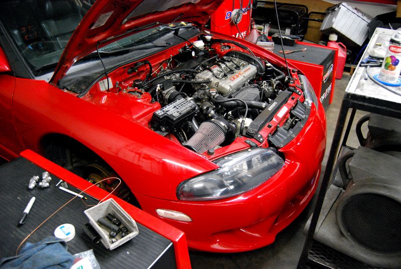

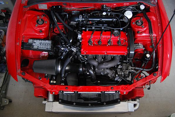

Gofer, i apologize if you covered this already. So one can remove the vertical bracket and the hood latch(obviously have to use hood pins)?? That would free up some much need room for a fan on my car. I know you have CF hood but could this be done on a stocker?
Of course. Same as a CF hood, you just cut/drill out the location on the hood you want to install the pins/latches. The CF hood I bought was used and already had the aero catch latches installed, I just had to locate the pins in the frame to keep them down. You can see the location of the pins in this engine bay picture, they're on the frame going over each headlight (they're anodized red).
One's just to the right of the hood support post and the other is just to the left of where the hood support post clips down.

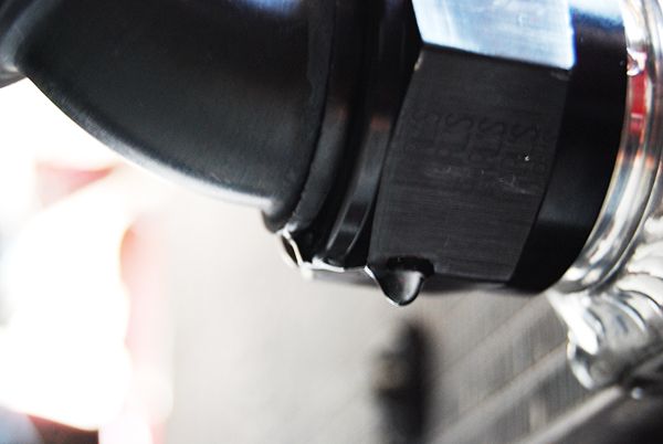

16JUN2013 - 20AN Fitting Woes

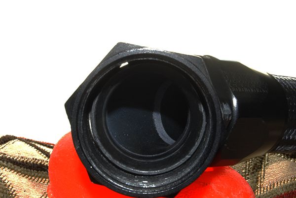

Unfortunately, things came to a halt soon after getting the AFCO radiator installed. It was great, it seems like every piece of the puzzle was falling into place and I was almost out of the woods until I filled the cooling system with water. Nothing but leaks and in the worst place it could be, out of the back of BOTH Earl's 20AN 45* fittings, so there was nothing I could do about it. The worst part about it was the cost, if Earl's doesn't cover these I'm out $180 and they're brand new.
I spun the hoses around with the straight fittings on the radiator and just for a sanity check I filled the radiator one last time to see if the straights would leak. Go figure, they held the water just fine so it was definitely the 45* fittings causing the problem... I held them up to the light and took a shot, you can see daylight through the backs of both of them. Great.
Initially I thought maybe the 20AN bungs on the radiator were the problem, maybe they were sealing to the inside of the fitting properly. I took some 1200 grit sand paper and smooth the radiator bungs on the sealing edge and tried again with the same result, a nice steady drip from the bottom of the upper/lower 45* fittings. F*CK!
I got on the phone with Summit, unfortunately they wouldn't replace the fittings because they have a 90 day return policy and I've OWNED (not used) them for over a year piecing together parts for this install. The offered to sell me new 45* fittings for $50/ea (down from $90) but I'd like to get them replaced for nothing since they were defective from the factory. I contacted Earl's and their sales rep said to send them and and they'd investigate the problem, determining whether or not they could be warranted or not.
In the meantime, who knew the OE upper/lower rubber hoses would work just fine? LOL

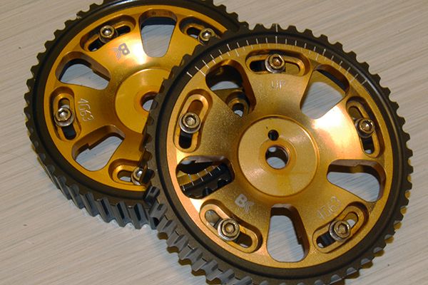

20JUN2013 - BC Adjustable Cam Gears
I had been meaning to get a set of these for a long, long time so I could play with timing advance and see if I couldn't get a little more out of my baby turbo. At the moment though, I've got no reason to pull the timing belt so, until then or I'm feeling motivated, they'll be a nice set of paperweights collecting dust on the shelf in the garage.
The sure do look nice though!

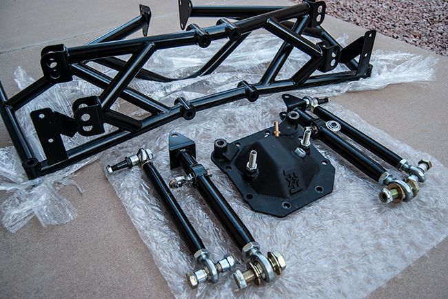

Back in Nov. 2011 Paul (99gst_racer) started asking for input on building 2g tubular subframes as he was going to start building them, he just wanted opinions from the DSM community on what they were wanting to see. I quickly subscribed to the thread and followed what Paul and the suspension experts on our site were proposing, really hoping that one day if he did ever build them I could get my hands on a subframe.
If you're interested, here's the discussion thread that Paul started --> Tubular rear subframe - Input needed
After several months of emailing Paul, I talked him into building the "street" version of his tubular subframe for my 2g and letting me R&D it. I did have one request though, I asked if he could build it to clear a F*F steel girdled rear diff cover and he agreed.
I'm just going to cover the install of the subframe that I started on June 25th, 2013 but Paul completed it and sent it out to me in Aug. 2012. Here are photos from the day I got it in the mail, along with the tubular LCA's, toe arms, and F*F steel diff cover.
Unfortunately, my move from San Diego to Phoenix was still in progress so I had to wrap this thing back up in bubble wrap and wait until I had space and time to do the install.
A few specs about the subframe that Paul built...
The stock rear subframe (with LCA's and toe arms attached) weighs in at a 58.7lbs where as this .095" 4130 chromoly subframe (with LCA's and toe arms) weighs just 26.3lbs. Paul's first 4130 chromoly subframe was a drag only version with a thinner (.065") 4130 tubing that weighed 3.3lbs less overall and doesn't retain the rear sway. This streetable tubular subframe saved approximately 32.4lbs.

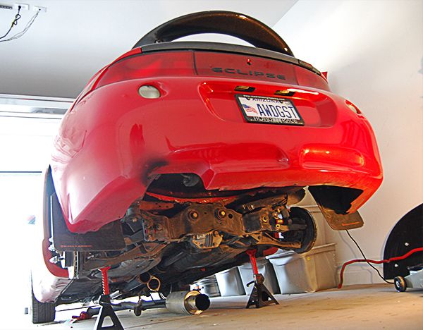

25JUN2013 - Chromoly Tubular Rear Subframe Install : Part I

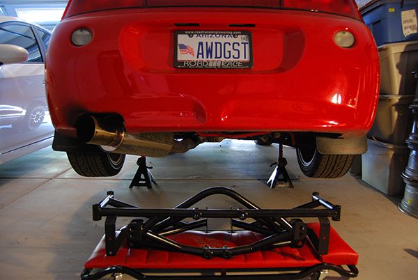

There wasn't much progress made the first day of the install, most of my time was spent getting the car jacked-up and organizing my tools/parts to complete the install so I wasn't digging through tool boxes and drawers trying to find stuff. Besides that, if you've never been to Arizona in June let me tell you that a garage gets pretty damn hot when it's 115* outside so it makes it tough to do anything to the DSM in the summer. So, with a gallon of water and a few wrenches I got to work...
Of course I had to take a picture of the subframe rolled up behind the car first to stay motivated.
The first day I spent out in the garage I made decent progress for just a few hours of work. I pulled the rear tires, dropped the back half of the exhaust, and pulled the rear sway bar before calling it a day.
